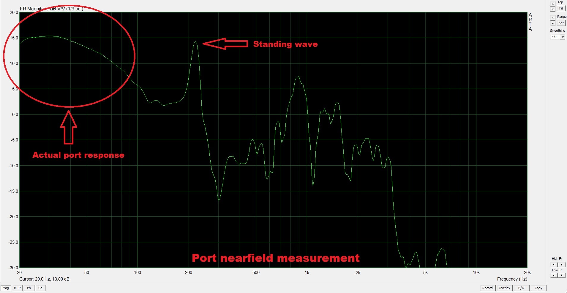

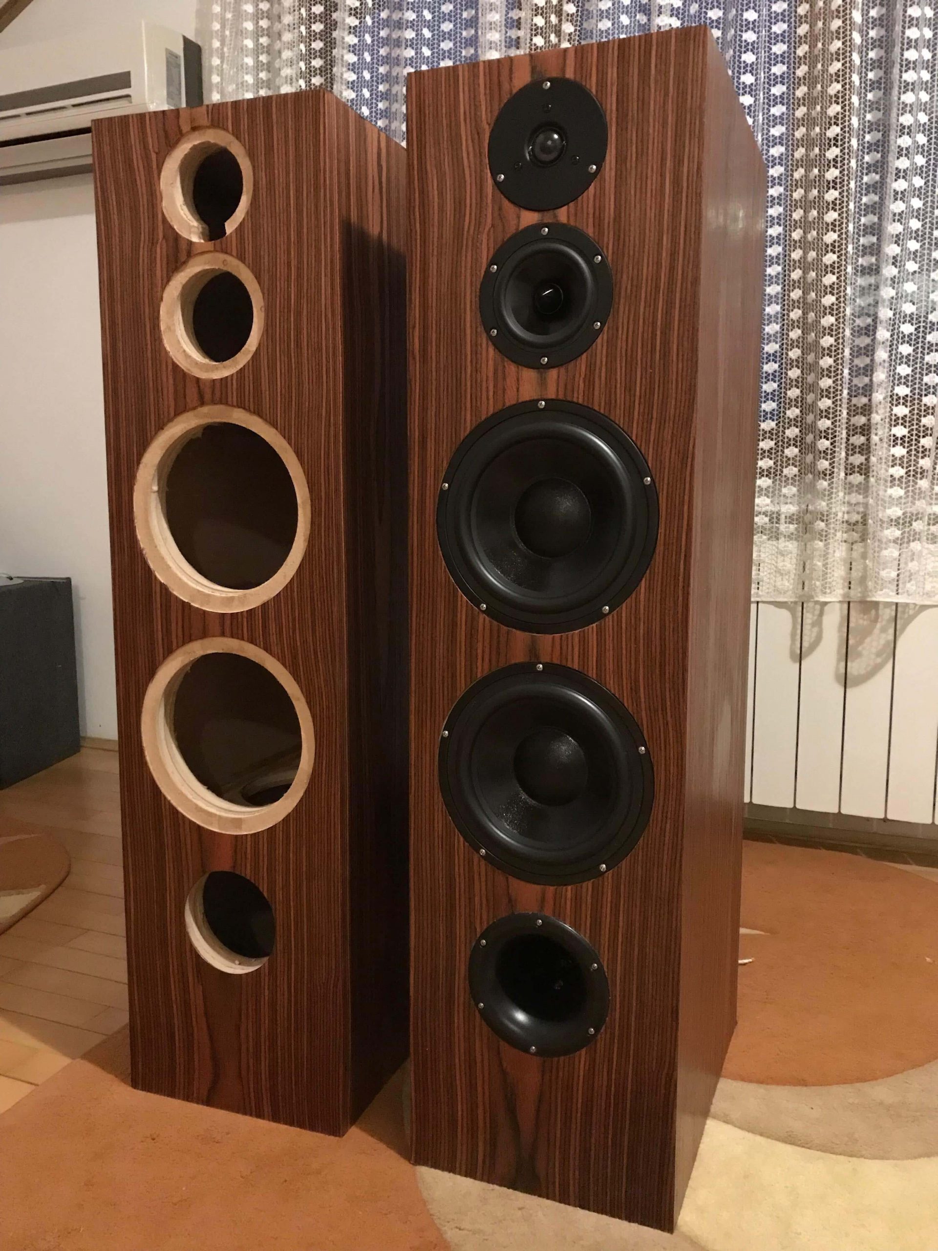

Right then. A ported cabinet acts like a pipe with 1 end open and a driver at the other and so would be considered a quarter wave pipe.
The trouble for me trying to learn this is that I then look a a different real world example and this position doesn't look to be supported:
Internal standing waves - How to eliminate them from loudspeaker boxes
Without reading the whole thing, it's a ported cab with an internal top to bottom dimension of 750mm/29.5" with a port near the bottom, pic 1. Pic 2 is the near field port response. The port is tuned to 25Hz.
If it's acting like a 1/4 wave pipe, then F(1) = 13,377/4*29.5 = 113Hz, F(3) = 339Hz and F(5) = 565Hz.
On the other hand, if it's acting like a 1/2 wave pipe that is closed at both ends, F(1) = 13,377/2*29.5 = 226Hz, F(2) = 452Hz, F(3) = 680Hz and so on.
And clearly the big spike coming out of the port is located at ~220Hz.
Can anybody clear up my confusion?

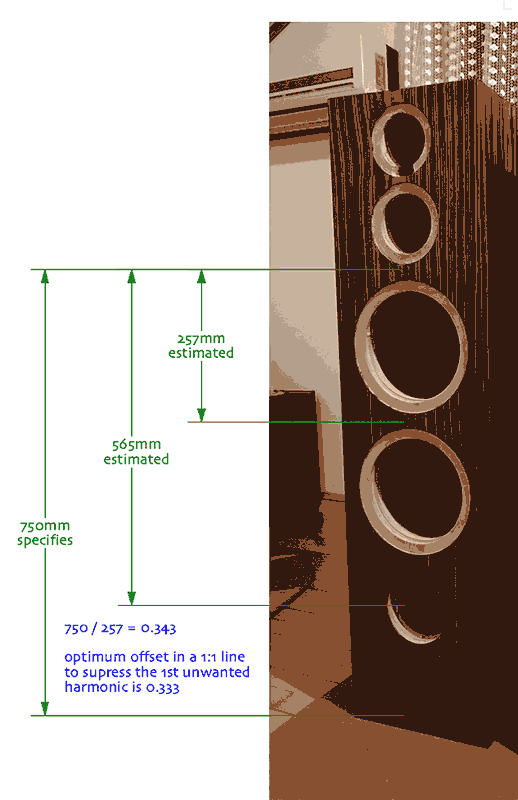

It is not that simple. A quick bit of estimation here:
attachment.php
The Zd of this (short) TL is about 0.343. The optimum Zd uses in a 1:1 taper (sttaight) line is 0.333. This offset is used to almost completely supress the 3rd harmonic, leaving the fifth.
Scott or Paul or GM would have to speaker to the other details like Zv that affect the eignmodes.
dave

Yes and no in that the TL modes damp the vent [a lot] more than a simple reflex, so can have greater acoustic efficiency an less internal damping when the driver/vent orientation is optimized. If not, then a secondary set of eigenmodes come into play and can cause a significant notch in the mid-bass when the vent is close to the driver.
Of course one can simply stuff a reflex box and/or its vent to achieve the desired damping, just won't be as efficient and in mine and many folk's experience it's an unacceptable trade-off WRT pace, rhythm & timing [PRaT], ditto when one wants to use [very] low power amps.
FWIW, these are the driver, vent offsets I use/recommend, i.e. at a pipe's odd harmonics: Z = ~ 0.217, 0.349, 0.424, 0.66, 0.714, 0.848
IME, simple fractions are only optimum for open pipe eigenmodes.
More to come as time permits if needed..........
Well, the measurement doesn't support this theory. The max output of the port is at about 25-30Hz. Even with the most optimistic assumption of the effect of tapering (which probably isn't there) and/or effects of acoustic damping (lowering the speed of sound) you won't get that low. Furthermore, the peak at 220Hz proves that, íf there would be a fifth order resonance, the output couldn't peak at 25-30Hz. The peak has a clear cause: the first order resonance is quite severe and the velocity knot at the bottom excites a lot of unwanted sound output through the port (assuming the port itself isn't about 80cm long 😉 ). Just my 2 ct. And the port probably is about 20cm long...
planet10, why suppressing third harmonic would be more important than the first at ~220Hz? With TL it would be since the whole operation is aiming for the resonance, but this is just internal standing wave of a box isn't it? With boxes the lowest modes are the most problematic since damping material inside the box is not so effective as with the higher modes. In this case best place for the woofer (or their acoustic center) would be in the middle if one wanted to kill the lowest ~220hz resonance.
