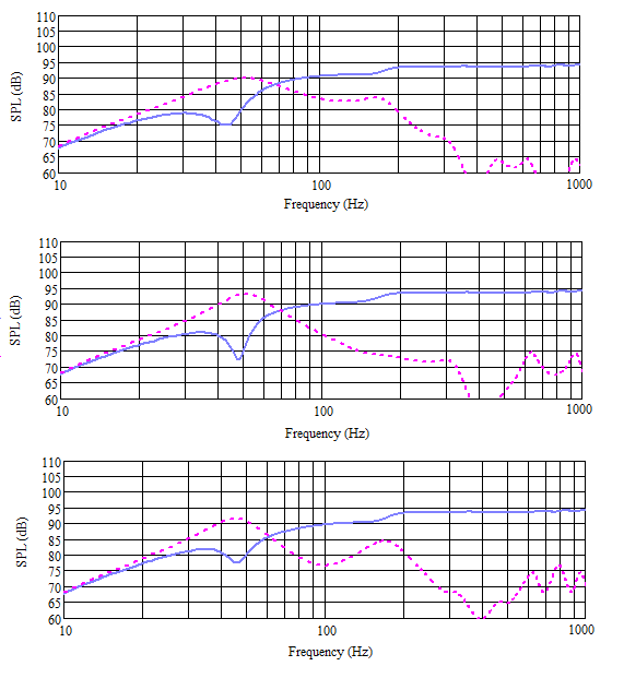

See the attached. This is an MLTL for a TB wideband driver. Lilac is the driver output, pink the vent / box output. For the three plots I've simply moved the location of the vent progressively up the enclosure. Otherwise same box, same vent dimensions, same damping: the tap location of the vent is the only difference. Upper plot = design location. Middle plot = halfway along the pipe. Lower plot = coincident with the driver. As you can imagine, the difference in the system response is quite significant.

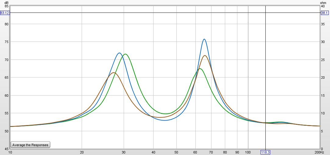

in my post #13 the graph shows the impedance curves for a 1 meter high floorstanding box, woofer placement is 75 cm up from floor:
green curve, upper port, 57 cm up from floor
blue curve, middle port, 37 cm up from floor
red curve, lower port, 14 cm up from floor
at about 140 hz there is some box related resonance shown, but i can not see where it comes from since there is no internal dimension that corresponds to that wavelength
I can see differences but what do the sums look like?? You can see the output following the Q/Notch if they sum the same how can you hear the difference??

What Scott posted was a sim from a custom box we are working on. So no mic.
Yes, having the sum would also be helpful, but it seems fairly obvious that the last 2 examples havea depressed upper bass. Right where many like a bit of kick.

WRT vent location, it's the internal tap location along the pipe that is being shown, which is what is relevant as far as the box load goes, assuming no additional boundary loading is applied (other external effects are a separate issue from the innate box load).

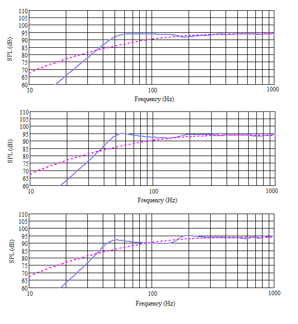

As noted, the system response is significantly affected; they certainly do not sum the same way. No surprises here for anyone familiar with QW type design. I didn't attach before because it was simply additional time that muggins here didn't have this afternoon (job of work to do -one day, they might even pay me). 😉 See attached. Same as above. Top = close to base, middle = half-way along the pipe, bottom = coincident with the driver.

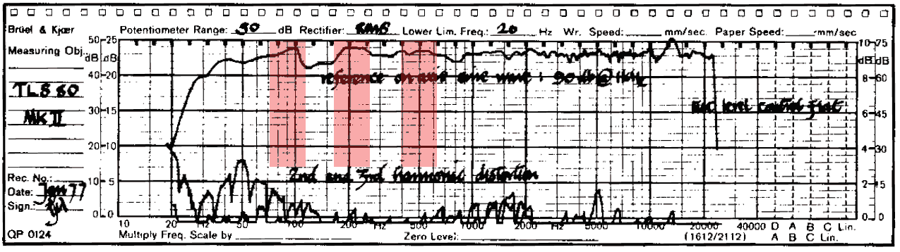

Anechoic measure of the FR of a TLS80, i have highlighted the peaks of the ripples in red. The dip below 200 Hz is exacerbated by baffle step — and the peak below is also lower than without BS. You can see in this end-loaded line that with no geomometric tricks (except for a bit of taper, to push the harmonics up), you can see that they ended up with some damping of the fundamental after they felt they had adequately damped the 3 and 5 harmonics.
