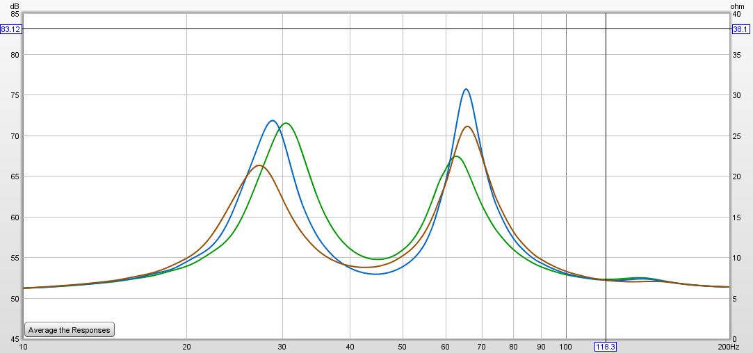

it sure do, if you have a test box then try different vent locations and run some impedance measurements and you will see that measurements will differs and some a lot

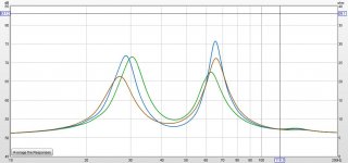

here is a box with one vent at three different locations

When we consider the case of wjat is radiating towards us from the loudspeaker as long as the 2 sources are less than a quarter wavelength apart it is as if they are coincident.
But in an ML-TL the placement of the vent, Zv, is a factor in the shape, intensity, and placement of the harmonics, which has a direct impact on the bass response and ripple.
My Wonder, and Mr Fahey are talking about the former, celef the latter.
So it does matter.
So it does matter.
