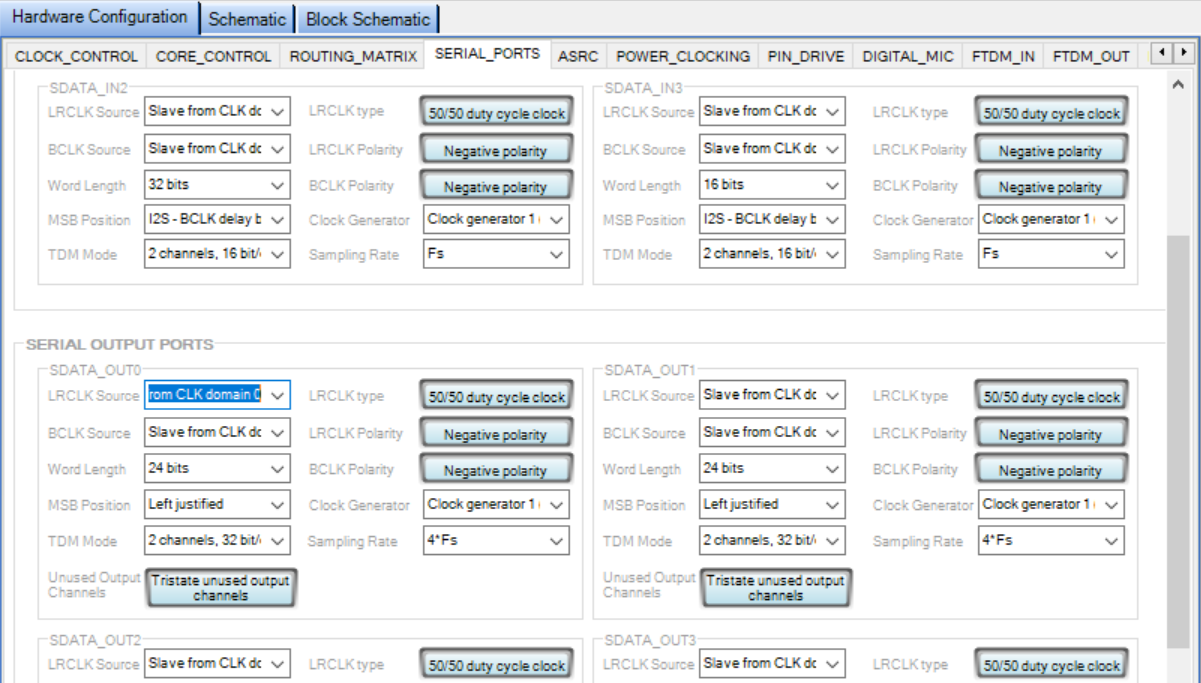

Have you configured the I2S input/output ports for your task?Anybody have idea what I have doing wrong?
Take the project sigma studio from this thread and see how I configured the I2S ports, in this project the I2S port output is clocked from the BCLK frequency at the I2S input. ASRC is also used there for the input and output of the I2S stream.
https://www.diyaudio.com/community/threads/3way-dsp-amp-adapter-for-dante-aes67-board.426074/
Thanks, I am not, probably neither is configured correctly, sigma studio is realy confusing, whatever I set its always seems analog instead of digital. What I need is simple 10 band parametric equ, one input and one output, not need mute, volume, asrc, just that 10 band equ and simple i2s input and i2s output. or at least something very simple, just input and output, neither I tried is working, probably because of wrong configuration in sigma studio. And have no idea how to debug since I didn't included pinouts for adi usb device, thinked that things will work on first try but seems I was very wrong. I have only i2c option left for comunication with adau1462. Unable to understand sigma studio, even unable to get on the net any simple i2s example flow in-out with external mclk.

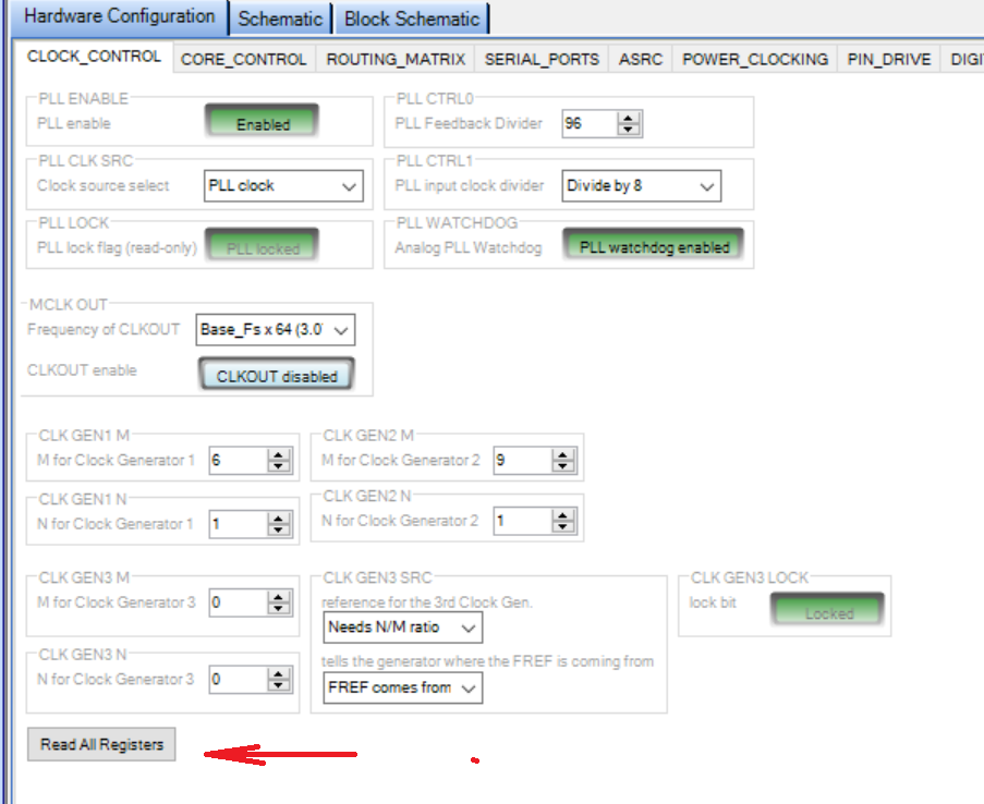

To begin with, I would advise you to get a connection between Sigmastudio and ADAU using a USBi programmer.I2c comunication is working, reset circuit too, but no pulses and have no idea right now what to try : (
This is necessary to read the ADAU settings, there are a lot of settings inside the ADAU that can lead to a negative result. Without USBi, you will not see how ADAU is configured, i.e. you will not be able to see and understand the reason for the ADAU not working in your case....

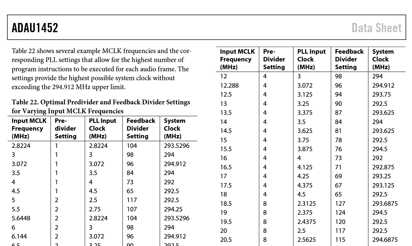

I don't know why you need a master clock if the adau has ASRC, but as I understand it, in order to use the master clock without ASRC, you need to supply the master clock to the adau clock pin, and this requires settings inside the adau.

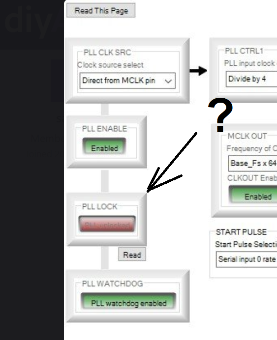

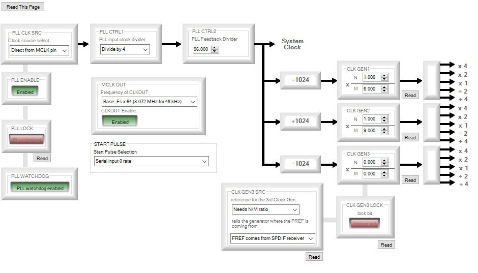

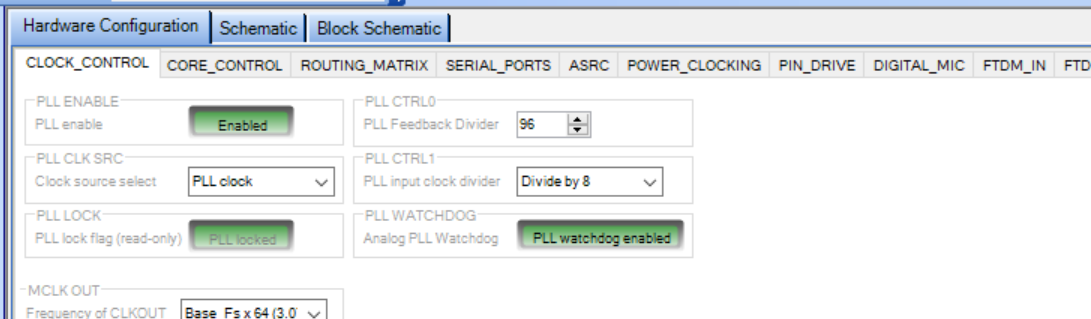

My mclk is 12.288, and I set clock source "direct from mclk", and per table looks like my clock is correct? Than something else is missing. Have no idea how to setup i2s source, there is some clock domains which I not understand what that mean or how to configure them, for example what mean clock domain 0, clock domain 1... clock domain 4... etc, unclear : (
Since there are four I2S inputs in the ADAU, for the I2S slave reception mode you can clock I2S data from different BCLK inputs, in other words, if your BCLK clock signal comes to the ADAU BCLK IN0 input, then you need to specify domain 0 in the port settings.for example what mean clock domain 0, clock domain 1... clock domain 4... etc, unclear : (

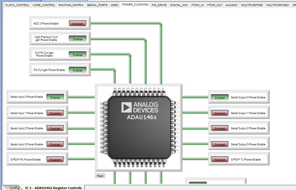

Power clocking seems diferent in sigma studio 4.7 , I have enable that serial 0 input and output, but nothing is working. Today I will try hack our pcb and add somehow ipex connectors on i2c line to connect with USBi, no choices left for debuging : (
Seems sigma studio have bugs? For example I see that trace on pictures is all green even when something is disabled? Or this window is for real time work when USBi is connected? Do I need to send all that commands after default_download?? For example this function default_download configures adau device:
looks like 0xF650 command for serial ports enable is missing in default_downloaf routine generated by sigma studio?

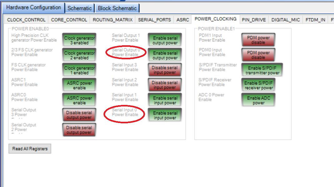

Sigma Studio seems to remember the last state of the registers in ADAU, to find out the current state of the registers you need to press the read button.Seems sigma studio have bugs? For example I see that trace on pictures is all green even when something is disabled? Or this window is for real time work when USBi is connected? Do I need to send all that commands after default_download??
I don’t know how and when these settings are transferred to ADAU.
I'm checked now default download, this is what is does:
This:
addr: 0x70, regAddr: 0xF050, len: 0x2, values: { 0x1D, 0x11 }
is responsible for power clocking, for example writing 0x1D11 to the register 0xF050 defines the whole power clocking output scheme, in our case as like on my power clocking window that things is allready done from function default_download, excatly what sigma studio generated during linking project. So in my case something is not good, maybe adau died too when all 3 comtrue died? Or I missing something in sigma studio, realy have no idea

This:
It could be anything you want. From bad soldering to incorrect ADAU settings. Until you see the actual ADAU settings, you can guess for a long time.So in my case something is not good, maybe adau died to when all 3 comtrue died?
- Class D
- Direct Digital Power DAC (DDPD)
