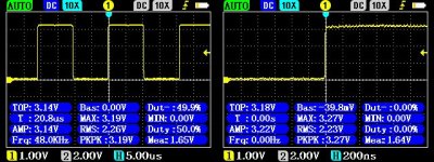

This is my lrck pulses, till before adau inputs, nice squares, wth is going on with adau! I'm shocked that an simple thing is now night mare!

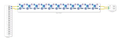

I didn't even notice that these were the asrc buttons, I thought they were some cubes, only when I click on the cube does the asrc configuration window open! Could that have been the problem? It seems to me that everything has to go through asrc? What need to select on the right side inside serial output ports configuration?
