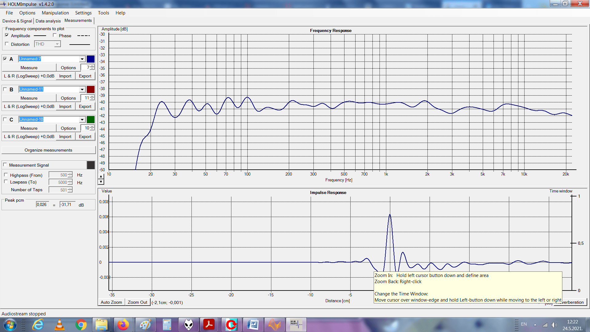

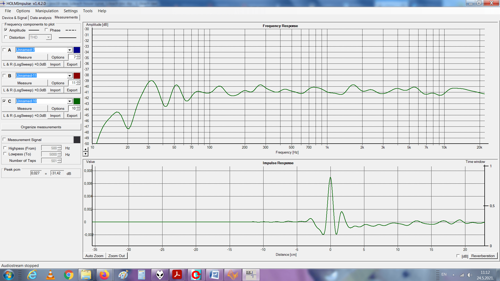

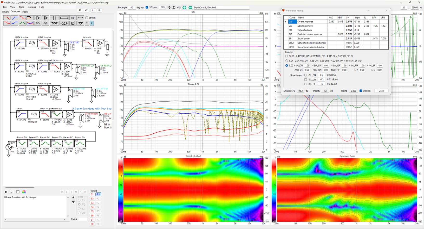

I wanted to have this cardioid vs OB discussion. Before I was doing these OB explorations, I was doing cardioid explorations with ABEC models generated by mabat's ATH software that produced directivity files I could use in Vituix. It was frustrating in that cardioid could neutralize the front wall but did very little for the sidewalls. That isn't the entire story because there are room modes to deal with but its an important part of the story.
I agree with Juhazi on "Cardioid avoids..."
But I'm back to the floor reflection this morning. Here are some images that show the difference between my bottom 15" woofer crossed over at 100 Hz vs at 300 Hz, where it overlaps the middle woofer in the 100 to 300 Hz region.
The dotted overlay trace is the room response for the woofer overlapped with the mid. It looks much more benign to me in the overlap region. On the left edge, you can see how much bass I lose from reducing the U-frame depth from 300 mm to 80 mm - just over 3 db at 30 Hz. I think if I go this way, I should expect to need subs. Lower woofer playing to 300 Hz is the formula for reduced floor response and seems worthwhile, even if it costs some bass.

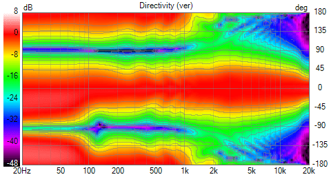

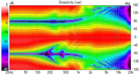

Here are the vertical polar maps for the two cases:
first the woofer low passed at 100 Hz
and now the woofer low passed at 300 Hz

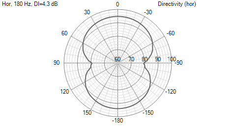

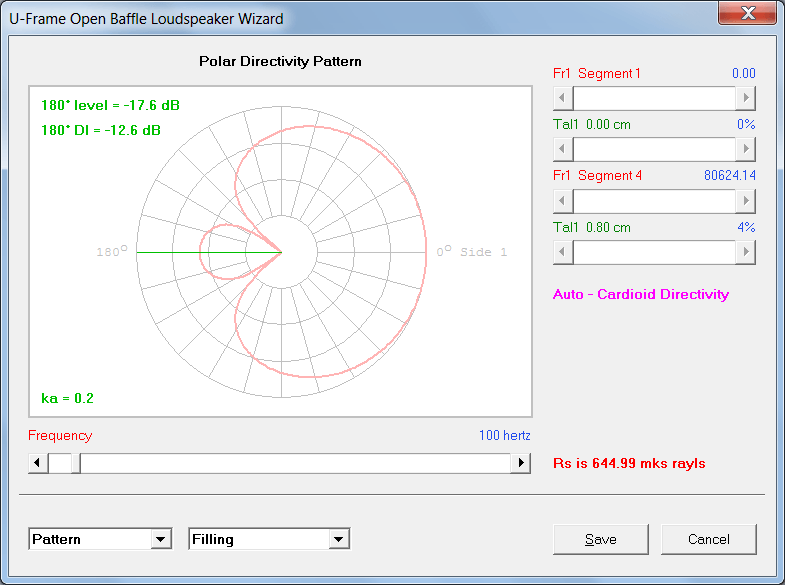

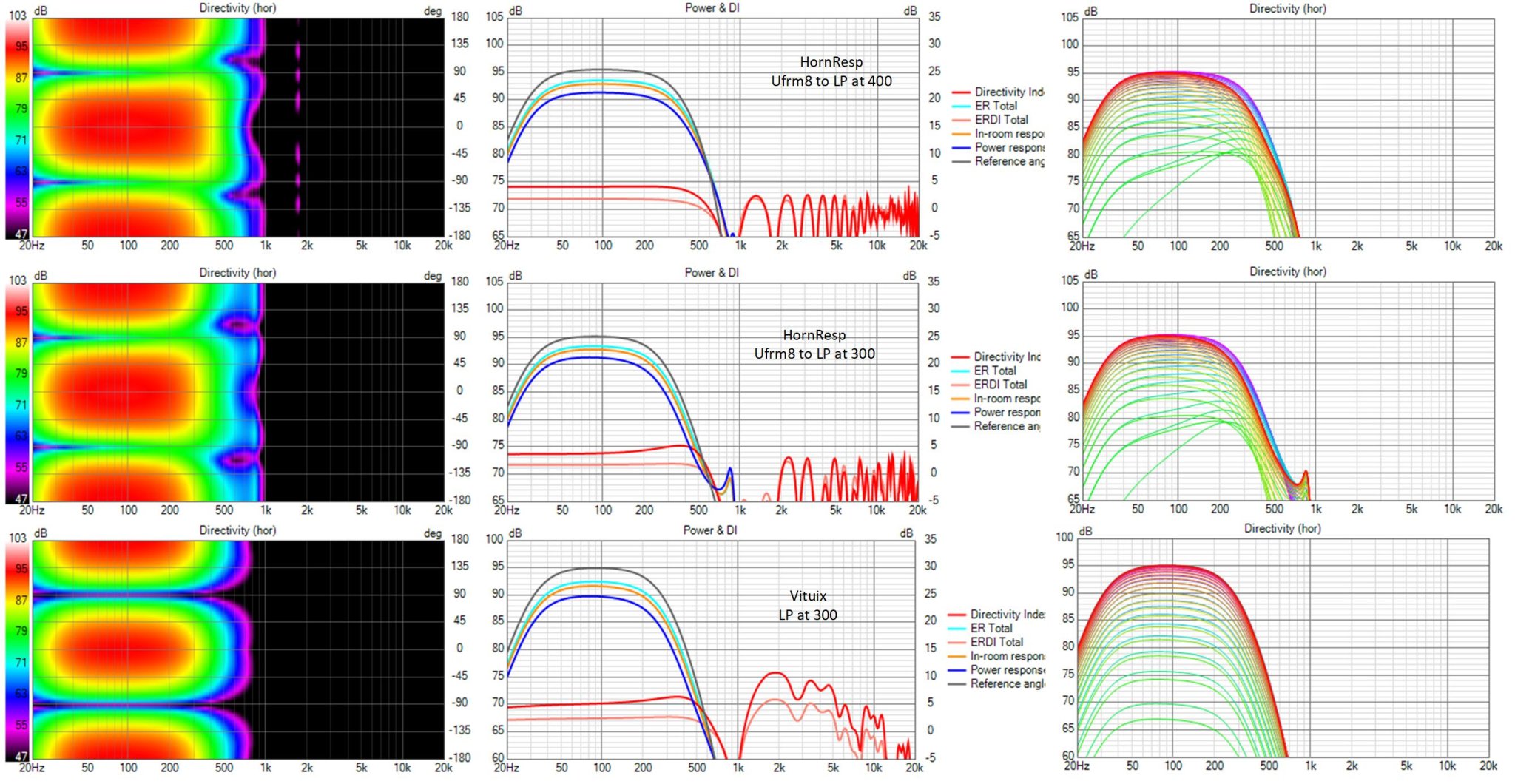

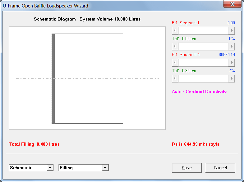

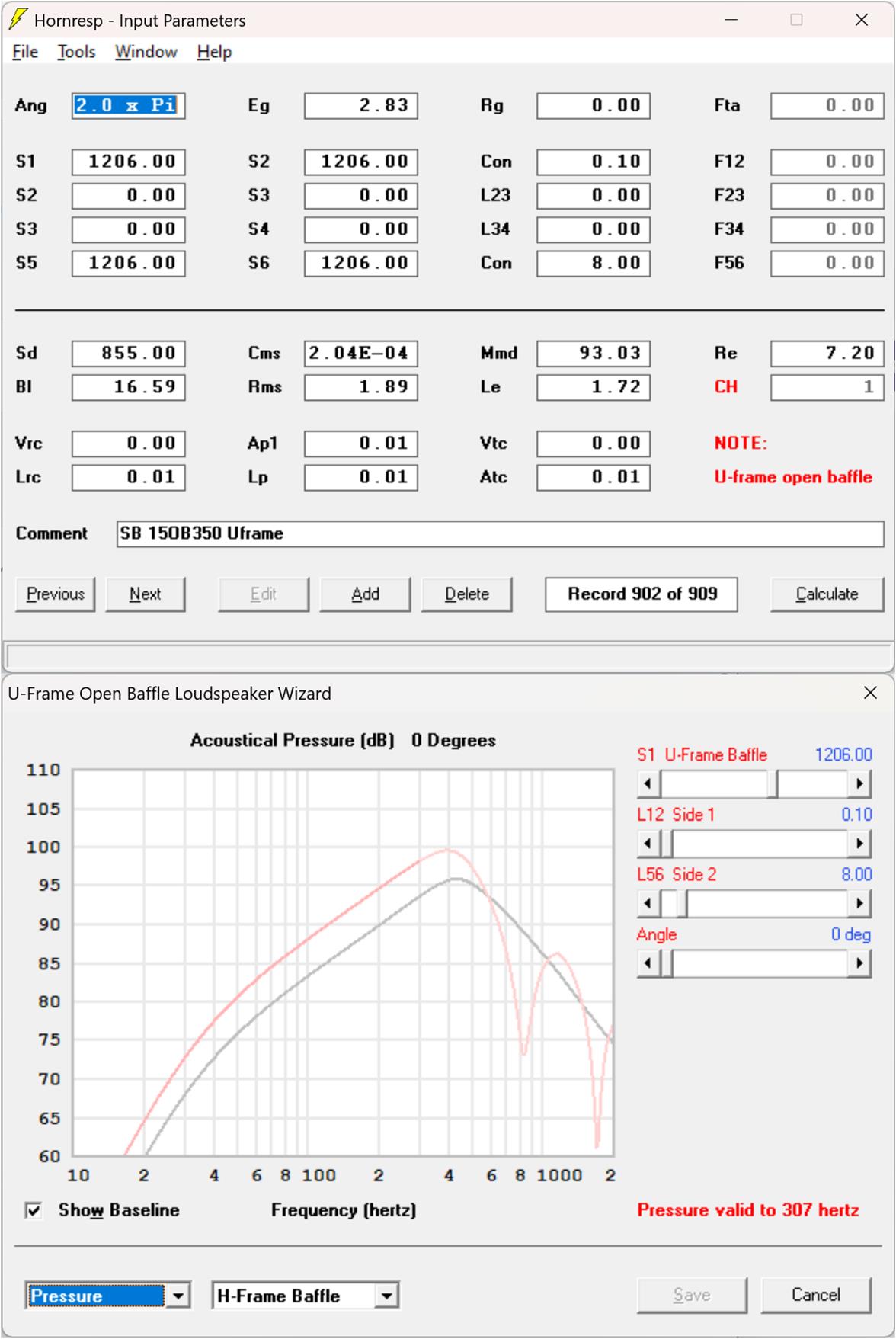

I went back to HornResp to confirm that an 8 cm U-frame was good to 300 Hz. To do this, make an input screen like the top half of the attachment, then open the loudspeaker wizard, set the depth, go to the pressure screen where you can set the off axis angle and click F9 to export. Does this 18 times at 10 degree steps and if you have named the exports appropriately, you will have a set of polars you can point Vituix at.
I did this and got a surprising result in terms of system polar response. The FR, PIR linearity is not quite as good as using the simple vituix model for the Uframe, post #48, but the PIR with reflections enabled, shown dashed, is much better.
This is a lesson to me to take the trouble to export directivity from HornResp when/where I can.
Looking at the Horizontal line chart of the system sim, its clear that the Uframe is exhibiting cardioid-like behavior.
This isn't a total surprise as it was reported by Kreshovsky in his article on the U-frame woofer system:
"The U-frame is an unconventional open backed woofer system. A correctly designed and damped U- frame woofer
potentially achieves 6dB greater on axis sensitivity than an H frame dipole woofer with the same bulk dimensions
or foot print. The U-frame woofer does not have a dipole radiation pattern, but rather a cardioid* like pattern."
"The undamped U-frame reduces to a dipole of length D/2 only as the frequency approaches zero."

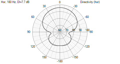

Here I compare the HornResp model results to the Vituix model results. The differences are subtle which is why I at first didn't think it was necessary to go to the trouble of laboriously exporting the polars from HR. I'm now crossing the Ufrm8 at 400 Hz for incrementally better floor null reduction.
by contrast, the undamped Uframe, HornResp generated directivity plotted in Vituix
first the Uframe playing by itself
then the Uframe in system, showing some attenuation to the rear
Where is that greater sensitivity coming from?The U-frame is an unconventional open backed woofer system. A correctly designed and damped U- frame woofer
or foot print.
If we go back to the fundamental basics, the only way to get more out of a dipole, is to make it less dipole.
A perfect dipole will have a perfect dip at 90 degrees over the entire freq range.
So the only way to get more output, is to make the source work harder, or make the path lenght between front and back bigger, so the cancelation isn't as strong. (aka, making it less of a dipole)
The total output of that only depends on the path length distance.
The only nuances there are a U-frame and a h-frame, is in the transition area as well as the standing waves. One open end vs two open ends.
Although, that last part is not significant with frame that aren't deep compared to the Sd (or height and width of the frame rather).
Calling that difference in small transition area more sensitive, is a bit a stretch.
That is basically the equivalent of saying that a system with a higher Q factor has an higher sensitivity.
That is not how sensitivity is defined.
A damped passive system can never get more output either, since the backwave is just being absorbed.
Or another way of looking at it, there is no compliance to kick the pressure up. (system order and f3 both go up and will be compromised)
Only acoustic resistance to attenuate it down.
