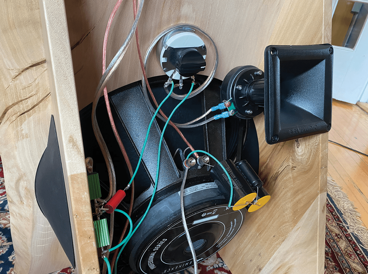

I take it that you have read the Audioxpress article about the Live Edge dipoles. This was published a couple of years ago, and is now available online.
For the interest of followers of this thread, they can read it here:
https://audioxpress.com/article/you-can-diy-perry-marshall-the-live-edge-dipoles
I find it quite interesting- equal parts of engineering, equal parts of marketing, which perhaps reflects Perry’s professional background. It should pique interest in OB. Good job @perrymarshall

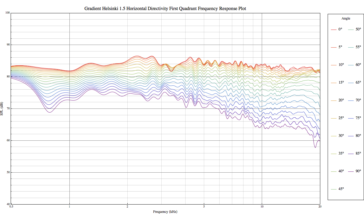

The Gradient Helsinki achieves very nice polars using a dipole woofer, cardioid midrange and waveguide tweeter
The placement of the woofer is quite odd; the dipole null points towards the listener (mostly)

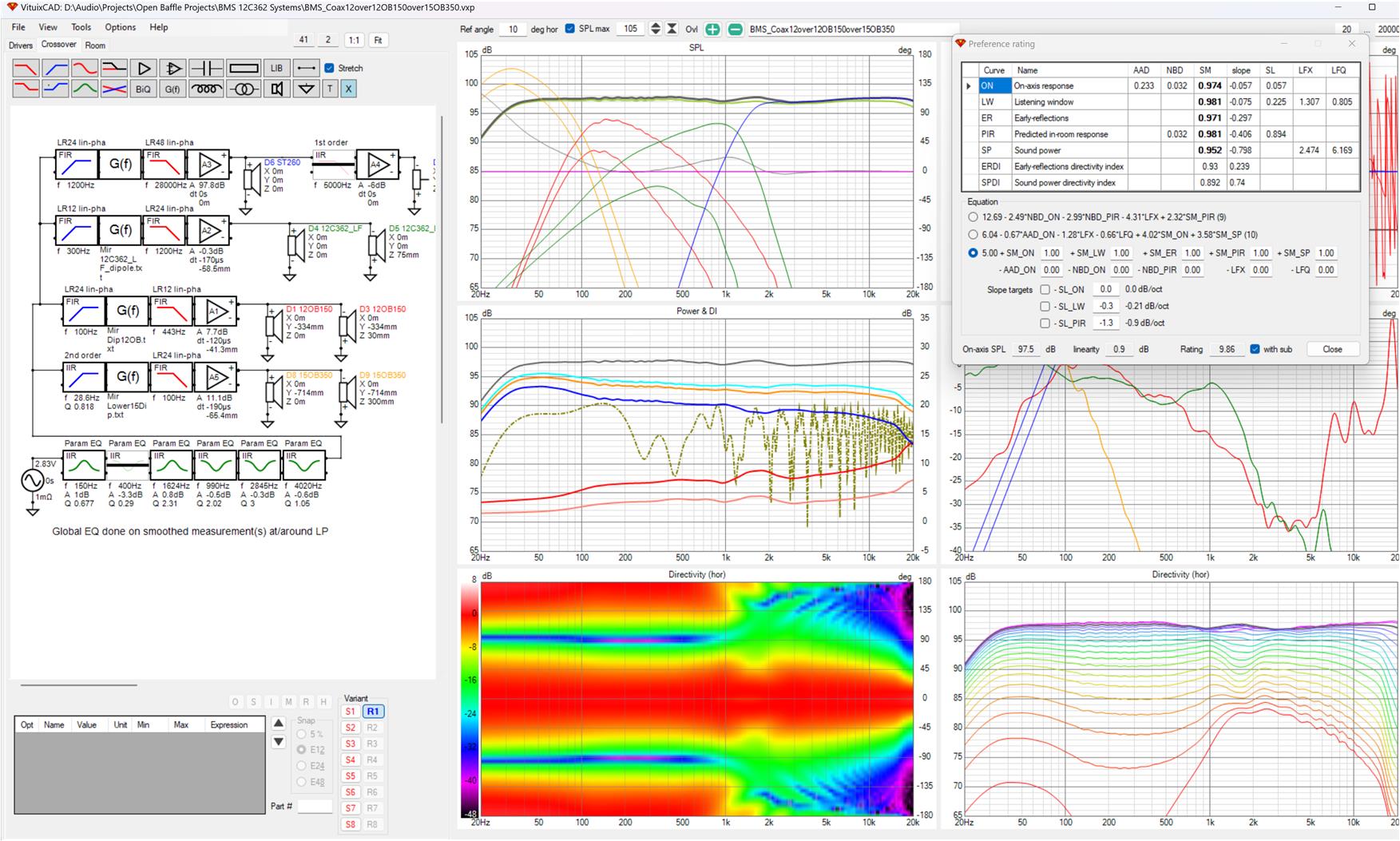

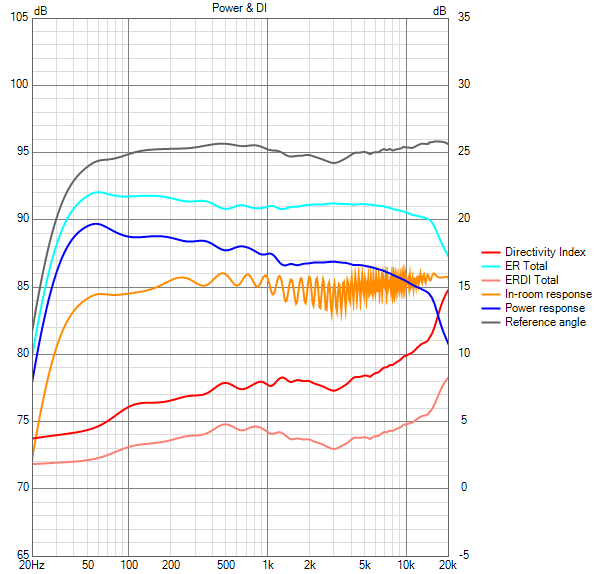

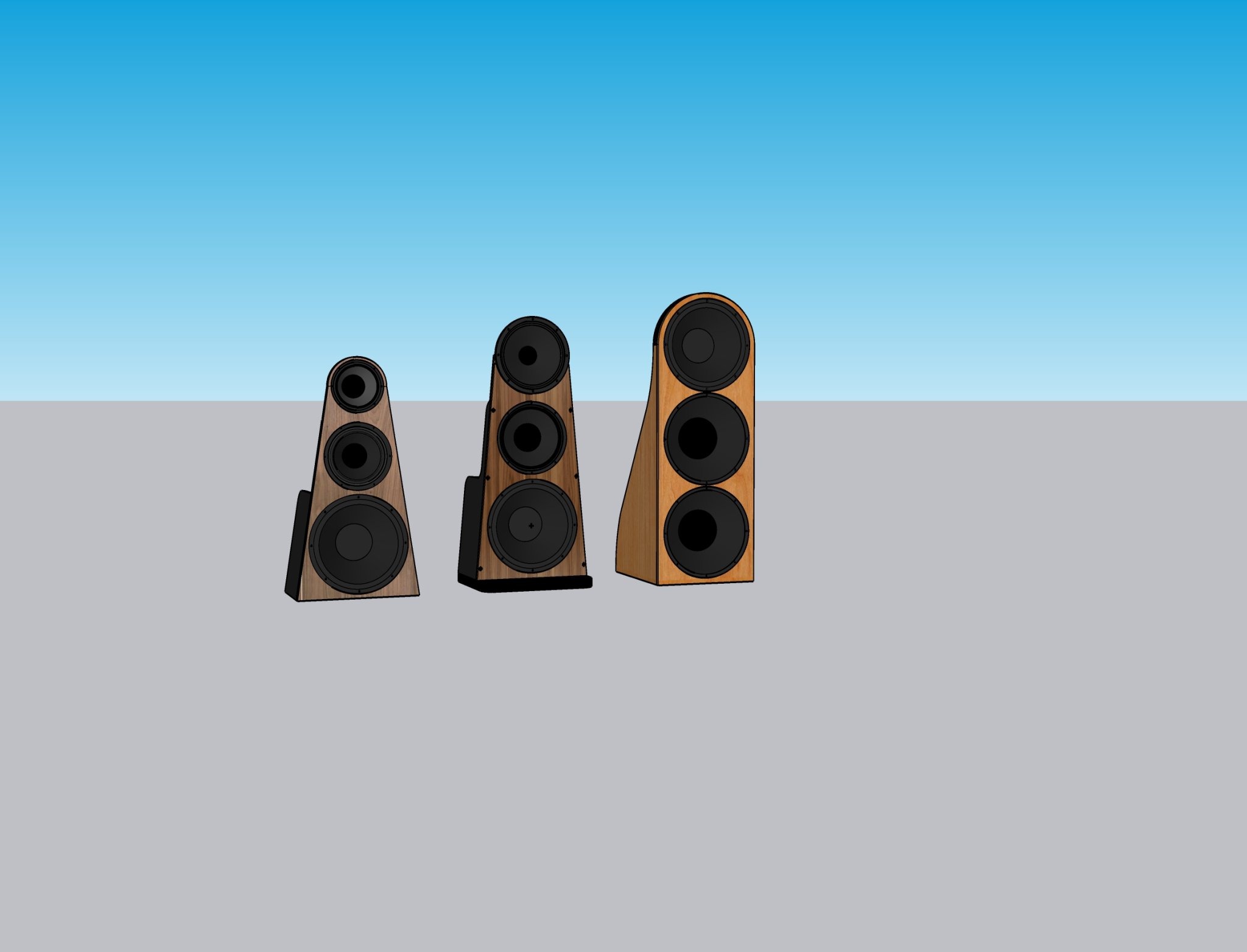

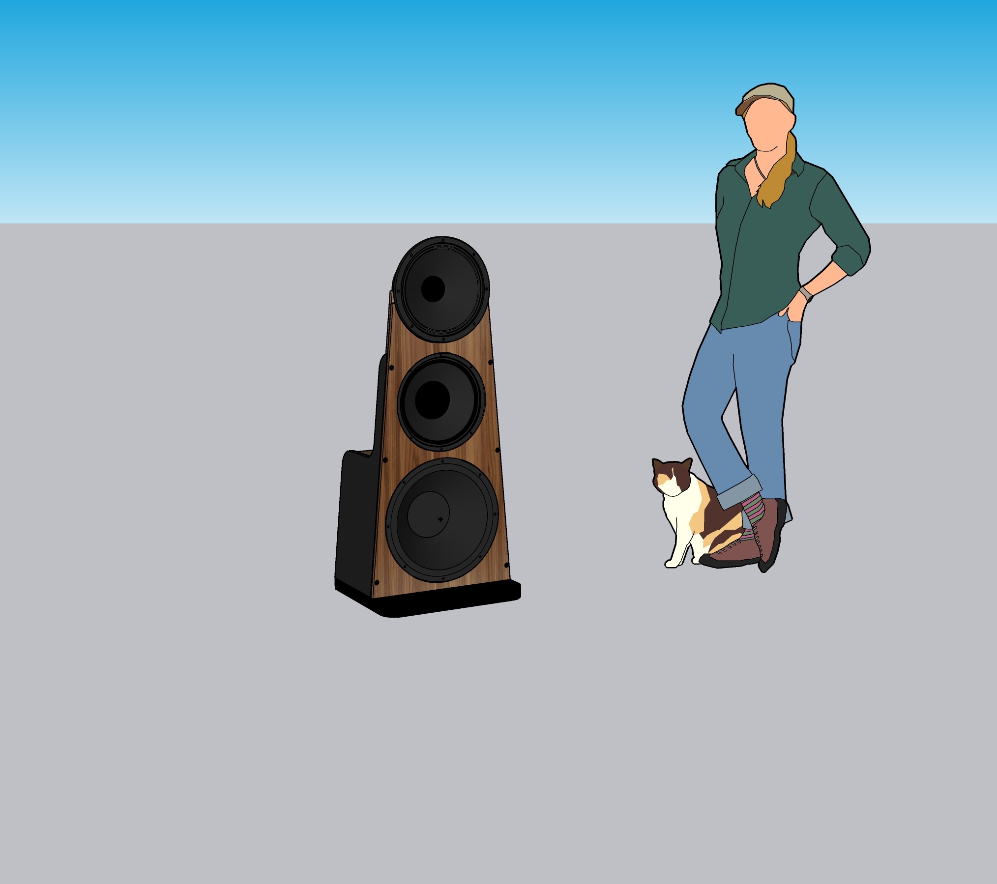

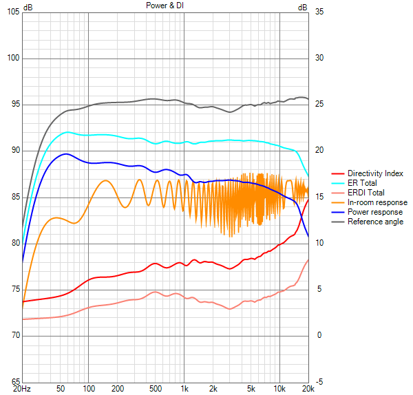

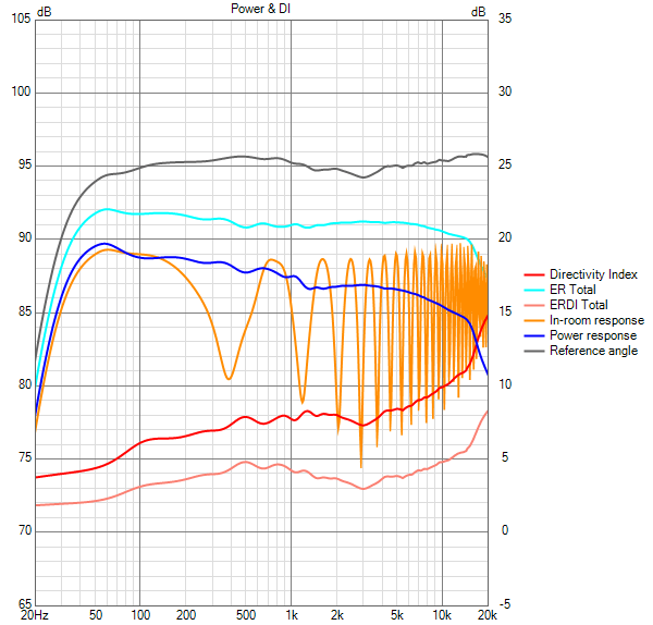

There was another driver configuration I studied that is worth showing. I started with the premise that triple15's were too big and also too heavy and also that I needed to taper the baffle down to a smaller coax to get smoother response through the XO to the coax CD/tweeter. The next step down started with the BMS12C362. My attention was drawn to this driver by @airvoid. Its CD response is smoother through the top octave than most others.
The first attachment is Sketchup image with a 1.6m tall person for scale.
Next the Vituix screenshot. The linearity isn't quite as good as the version with the 8" tweeter. However, I was quite enthused with this response and only scaled down to the 8" when I saw that this one looked cramped in its intended space. The difference in linearity is solely due to the size of the coax - smaller coax permits narrower baffle which in turn allows smooth dipole response to extend higher.
