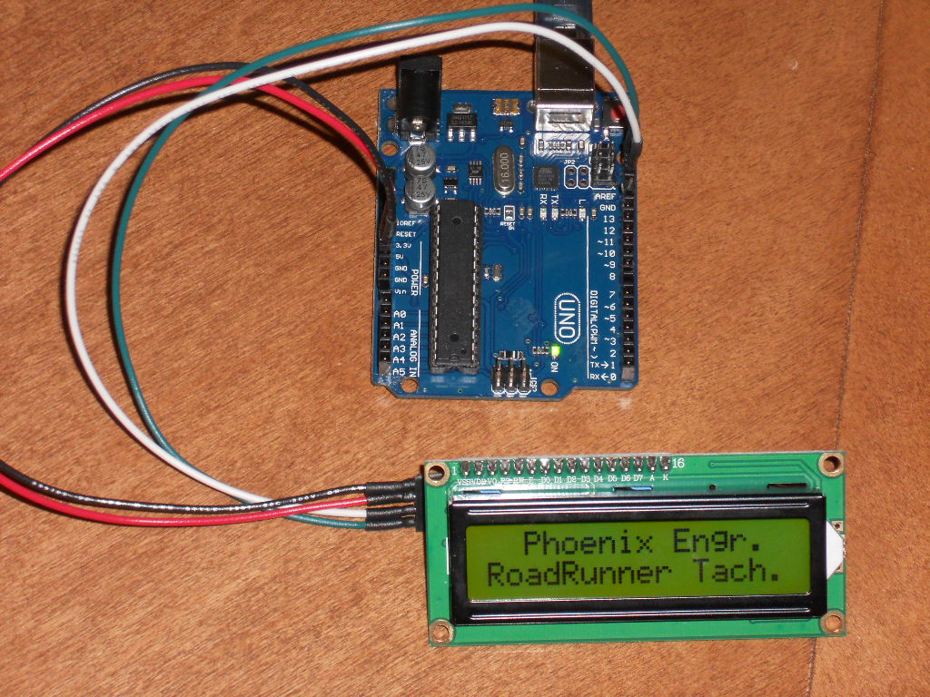

I just received my Uno R3 and an I2C LCD board from a vendor on e-Bay. No documentation at all on either one. I tried the Arduino example file "LiquidCrystal_PCF8574"; nothing, stone dead. Fortunately, I know a fair amount about these LCDs (for 20+ years, I've been writing assembly code for LCD displays from 1x8 char modules up to 320x240 graphic displays) so searching the web for ~4 hours, I was able to uncover a number of things. First off, when the display powers up, the first line should be all blocks (5x7 pixels for each char, all on, i.e. dark). The second line will be blank. Turn the pot on the I2C board until you see this character pattern on the display. Without the pot adjusted for the proper contrast, I saw absolutely nothing on the display, so even if it was working, you would have no way of knowing that.
Next on the list is connection to the Arduino. 5V and Gnd are self explanatory, but SDA and SCL are not. Most pages on the web that I uncovered had these to lines going to A4 and A5. On the Arduino reference libraries page, they list the standard library files that come with the IDE. Click on WIRE for a description of hardware connections to the I2C device (it varies with model and rev #). On the UNO R3, there are dedicated pins at the far left of the 18 pin header (left of ARef) as viewed with the USB connector on the left edge of the PCB. The pins are labeled SDA and SCL on the bottom PCB silk screen.
The e-Bay listing said the I2C address is factory set to 0x20 although it could be changed to any value between 0x20 and 0x27. Another paragraph said the factory setting was 0x27. Tried all 8 values still nothing. Got the data sheet for the 8574 and traced the connections on the PCB and used a voltmeter to determine the address. All address pins were HIGH which would indicate 0x27. Still nothing.
Time to get the DSO out and do some troubleshooting. Logged the logic states of both the SDA and SCL lines over one communication frame. Back to the data sheet. The address scheme looked right, 7 data bits, one R/W bit with the address set to 0x27. The master (UNO) sends the 9th clock pulse with the SDA high and looks for the slave (LCD) to pull the line low as an ACK. This was not happening. The data sheet shows two versions of the chip: PCF8574 and PCF8574A; the "A" version uses address 0x38-0x3F. With all the solder jumpers open, that should make my PCB address 0x3F.
Recompiled using this address and surprise, it worked. Only took about 6½ hours to get there. How on earth do you guys deal with this?
One thing I have yet to find, is a list of functions available in the PCF8574 version of the IDE library. The on-line reference only shows the standard (serial) library functions and I've already noticed some differences. The 8574 example file runs the LCD through its paces, so a lot of them are shown there. Anyone know where I can find a complete list?
Never mind, I think I just found it. LiquidCrystal_I2C.h has a function list, although the object creation syntax is different in the .h file from the example code. The syntax in the Arduino source file for my display looks like this:
LiquidCrystal_I2C lcd(0x3F); //* create object lcd with class LiquidCrystal_I2C and address 0x3F
lcd.begin(16,2); //* 16 chars x 2 lines
There is also an error in the PCF8574 datasheet. The address diagram shows a 7 bit address for the PCF8574, and an 8 bit address for the PCF8574A version. This is incorrect; they are both 7 bit addresses, the 8th bit is R/W for both devices.

I've been playing with the Uno for a couple of days now and think I have a tach version very close to the RoadRunner.
It uses the timer2 interrupt to generate a 16 bit count. The timer resolution is 32µSec, so the display is only 3 digits right of the decimal. In order to have a stable count, I had to disable Timer0 which is used by the Uno OS for millis(), micros() and delay(), so do not call these routines or the board will get hung endlessly as these routines no longer function. If you must use a delay, use delayMicroseconds() as this does not use timer0; because of the timer2 overhead, divide the expected value by 3 (delayMicroseconds(50) produces a 150mSec delay). You can also use the built in mSec delay. The global variable MSEC is incremented every 992µSec by the Timer2 interrupt routine and can be used to measure time in mSec.
I toggle PB2 (digital output 2) everytime the Timer2 ISR fires. If Timer 2 is interrupting at exactly 32.000µSec, the output at pin 2 would be 15,625 Hz and RPM would equal to: 1,875,000/COUNT. Because there is a slight overhead in the ISR response time, timer 2 is running at ~32.02µSec so the numerator has to be adjusted. This is stored in the source file as constant CALIBRATE and should be equal to the frequency at PB2 x 120. You can also tweak this number in small amounts to offset any frequency error of the crystal.
The LCD routines use I2C interface, so you will have to adapt them if using serial or parallel interfaces (some of the syntax varies between control methods). The tach will flash a disc icon whenever the sensor trigger is active; the icon will be displayed for a minimum of 250mSec and will remain on as long as the sensor is active (useful for manually testing the sensor). If no trigger is received for ~2.5Sec, the reading is blanked (--.---).
I used the Hall Effect sensor from the RR and the display tracked very close to the RoadRunner tach display. You can build your own sensor using this PCB: RoadRunner Sensor PCB
The tach will also average the display reading (the serial data to the PSU is not and SHOULD NOT be averaged) if constant AVERAGE=true. If you don't want averaging, set this constant to false. You can also change the number of readings that are averaged; practical values are 2-8. The tach will not average the display for the 1st 16 readings in order to fill the array with stable readings. The built-in LED will be illuminated when averaging is applied. The 16 reading count is reset when the platter stops.
Video of the basic operation (I turned the backlight off as it washed out the display): Arduino Uno Tach

Woah! Digging deep into lower level stuff that I even thought to look for. Nice!
There's a lot more assignment going on in your interrupt handler. Is this less of an issue for delays due to the use of the higher priority timer and lower level interrupt handling?
Are you actually using digital pin 2? I'm a little lost on the "pinMode(2,OUTPUT);" line. I currently have that pin attached to my LCD with the crazy wiring, but could easily shift it up. Of course this may be moot once my own I2C LCD shows up. (EDIT: I see your comment above)
Funny how all of the threads I encountered about float values not printing properly with "Serial.print(RPM);" never once mentioned using the second parameter as in "Serial.print(RPM,3);".
Fascinating. Thanks very much for sharing this! I'll try to adjust for my own LCD and give it a try soon.
