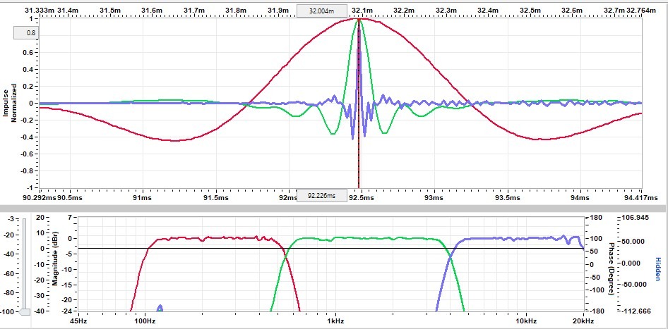

Here's the sections of 3-way unity horn using 96 dB/oct linear phase xovers at 550Hz and 4000Hz.
The 3-way is designed for use with sub, so the low section (red) above, has a 100Hz lin phase high pass in it. (same 96dB/oct)
Slight impulse pre-ring is visible in full speaker below, which will cancel when combined with complementary sub)

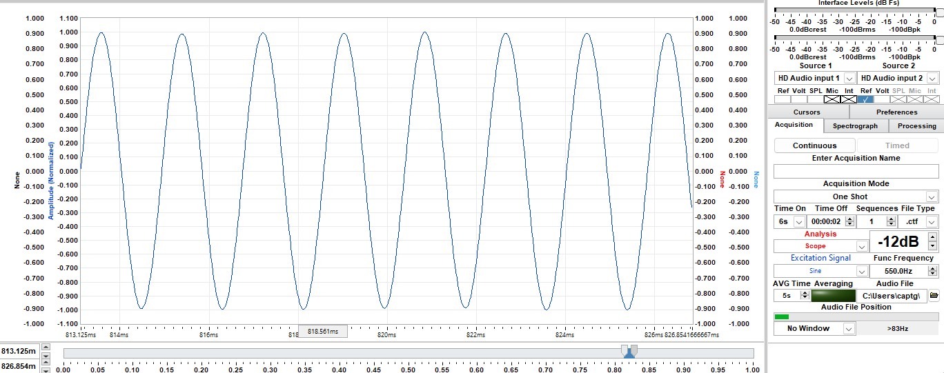

Can't take an impulse of a sine wave, but can put a scope on it.
Here's 550Hz on-axis, two 10" lows, and a compression driver, using stated lin phase xover.
40 degrees off-axis, near the edge of the 90deg conical horn pattern, looks identical.

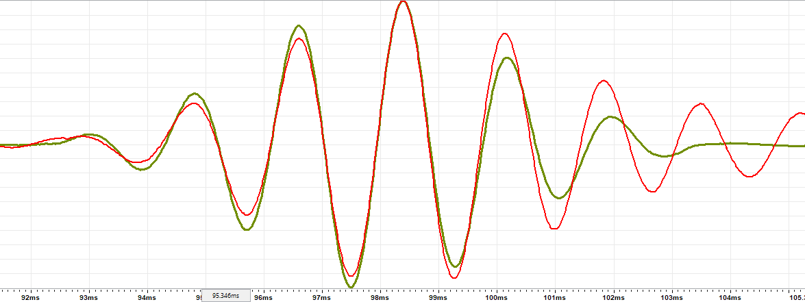

Guassian wavelets are an interesting test for crossovers, as they at least show some differnce under speaker rotation.
Here's a 550Hz wavelet. Green is on-axis, red is 40 deg.
I really don't know what the post wavelet ringing in the 40 deg is, maybe diffraction ?? (conical horn has 90 degree H pattern)
But I don't think it has anything to do with the xover.

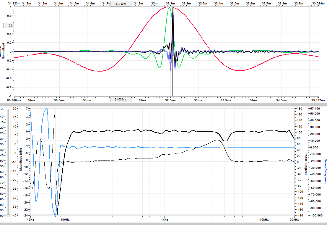

Assuming so, here's a 0.125ms delay on the VHF section (4kHz up)
Black impulse is summation of all 3 driver sections. And lays on top of the time delayed VHF impulse.
In mag, phase and group delay below impulse, phase is referenced to full speaker impulse peak, which equals VHF peak. Blue is group delay.

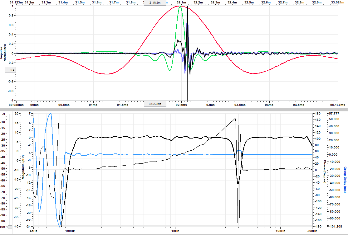

Here's 1/4 WL delay (0.0625ms)

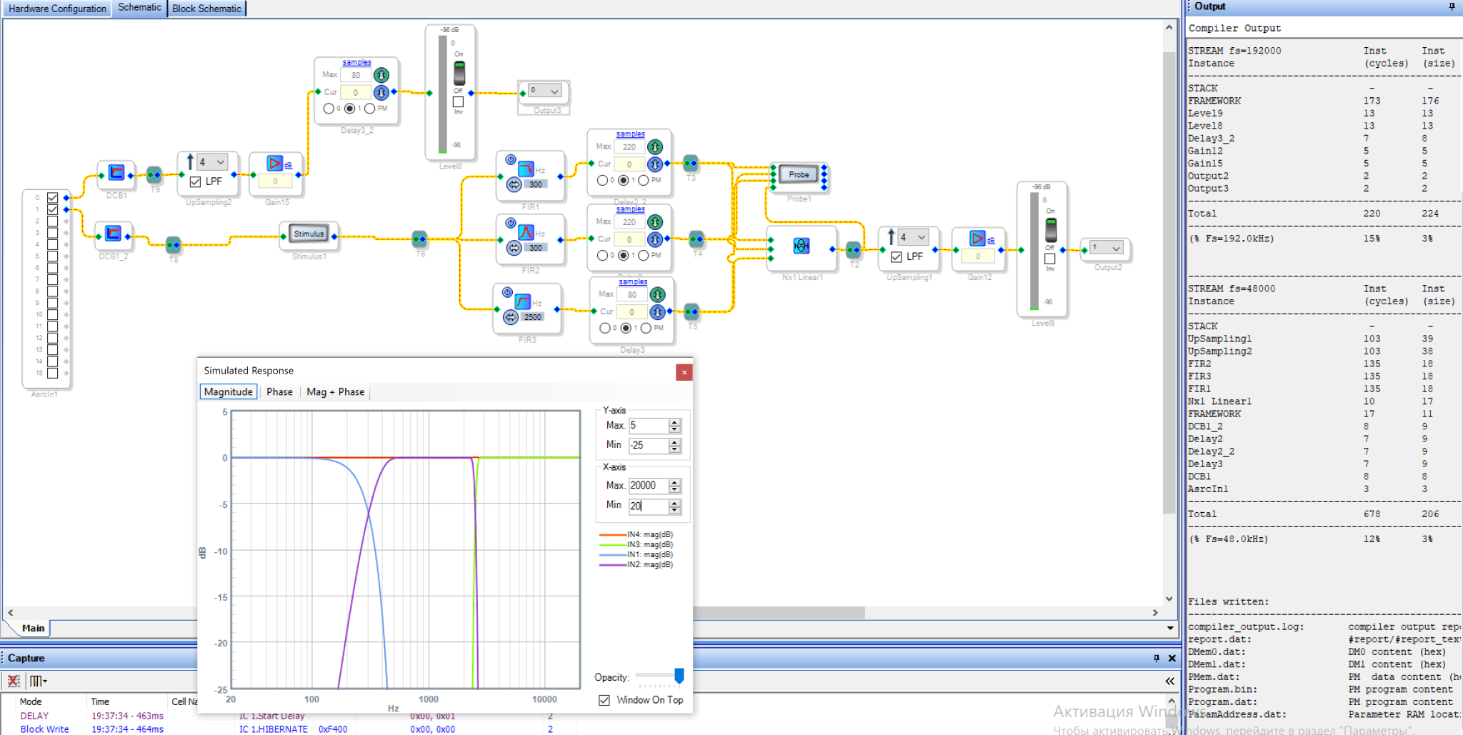

I have a DAC with DSP on board.
I'm putting together this circuit.
As you can see from the figure, my first channel is direct without an FIR crossover.
I divide the second channel into three bands using an FIR crossover, then I sum the three bands and output the result to the DAC output.
Here is a file for REW in which there are real measurements of each DAC channel according to the diagram. Tell me which of these measurements passed through the FIR crossover, and why you decided so.
