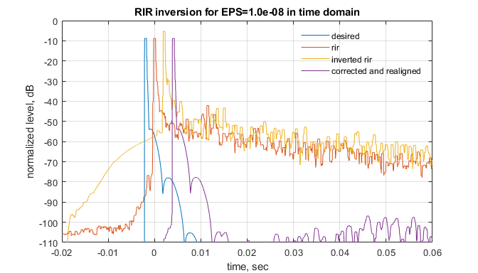

The graph shows the original spk+room IR as blue, The correction filter (which is indeed a reverse of the original IR) as red, and the result of correction as yellow. The closer the peak of correction is to the middle of the correcting filter, the lower ||err|| will be, if everything else is the same.
I apologize for the pathetic explanations, it is easier for me to do things than to explain how and why I've done it.

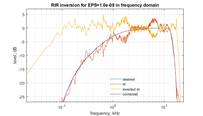

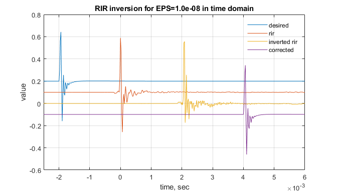

Let me show a less abstract example, and I hope it will help. Let's take a planar tweeter (AMT-920), and measure it in a room from 0.5m. Then, could we prefilter the signal in DSP by an FIR so that on the output it behaves as its idealized version? Yes, almost. a picture is better than a thousand words:
Here you can see that giving ample lookahead to IR inversion allows for longer but lower pre-echo (-110 dB) and some room echo dereverberation.
The last picture may also explain why Dirac is a scam. It's a lot of noise about nothing, totally ignoring the fact that an ear is not an omni.

First, it looks like from the linear scale impulse responses, that your desired & corrected target curve for the AMT-920 is IIR/minimum phase.
So you're using FIR to replicate IIR? Correct?
That would make sense to me, considering I think you are showing this example as a proxy for a full-range "system example", in which case I know we would not want a linear phase high-pass filter.
What is the high-pass target...looks like maybe a higher order Bessel?
And what is the low-pass target? It's so steep I'm thinking it almost has to be linear-phase???
Do you have a handy phase plot of the corrected results?

Yes.1) So you're using FIR to replicate IIR? Correct?
Correct, Theoretically, we can use it but practically, AFAIK, there are no benefits to using a symmetric FIR. Using traditional LR4 or minimum-phase FIR appears preferable. Keep in mind that DSP implementations of IIRs tend to suffer from many numerical problems; we have to convert an IIR to a cascade of low-order state-space sections, etc. It took Sirrus Logic about 10 years to finally produce good anti-aliasing IIR filters.2) ..we would not want a linear phase high-pass filter.
first order, it matches - more or less - the driver without non-idealities3) What is the high-pass target...looks like maybe a higher order Bessel?
It's a 4th order Butterworth. it matches - more or less - the driver without non-idealities4) And what is the low-pass target? It's so steep I'm thinking it almost has to be linear-phase???
No, I don't. Matlab's phase plots are of questionable value.5) Do you have a handy phase plot of the corrected results?
Thanks for all that. I should have seen first order matches, but the FIR generator i was using starts with 2nd order (made for live sound).
And can see the fourth order Butterworth fits well too.

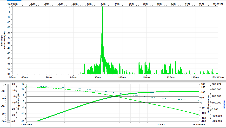

Here's the kind of ETC I can get from a B&C dcx464 coax CD, using the HF section as my proxy for a speaker system.
With an IIR high-pass target, faintly seen as blue under the green magnitude trace.
So in comparison, your proxy speaker ETC look awesome to me !!
(I do have a lot of in-room noise no way to get rid of)
