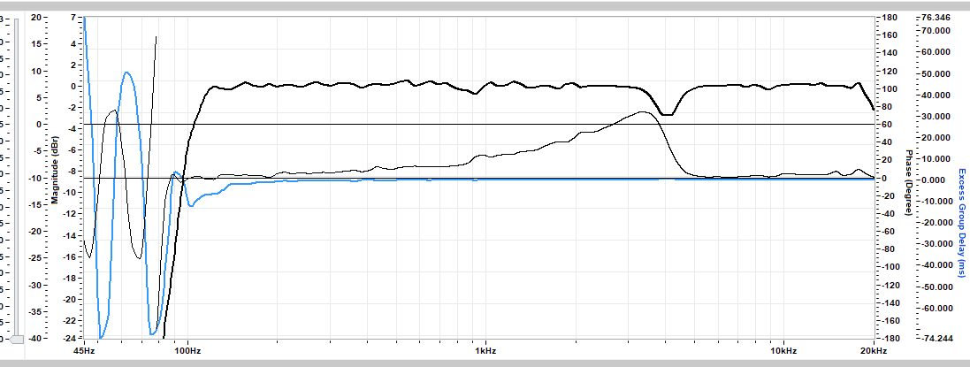

Here's same 1/4 WL fixed delay, same 1/24th smoothing
but blue is now Excess Group Delay...what we really want to see imo.
Note it needs the sub to complement and flatten it at low corner

so the group delay axis is too coarse in mark100 group delay

Group delay is related to phase delay. Derivative
So there clearly must be group delay
You do understand I promote linear-phase speaker tuning? Yes?
Which has flat phase and therefore no group delay?
