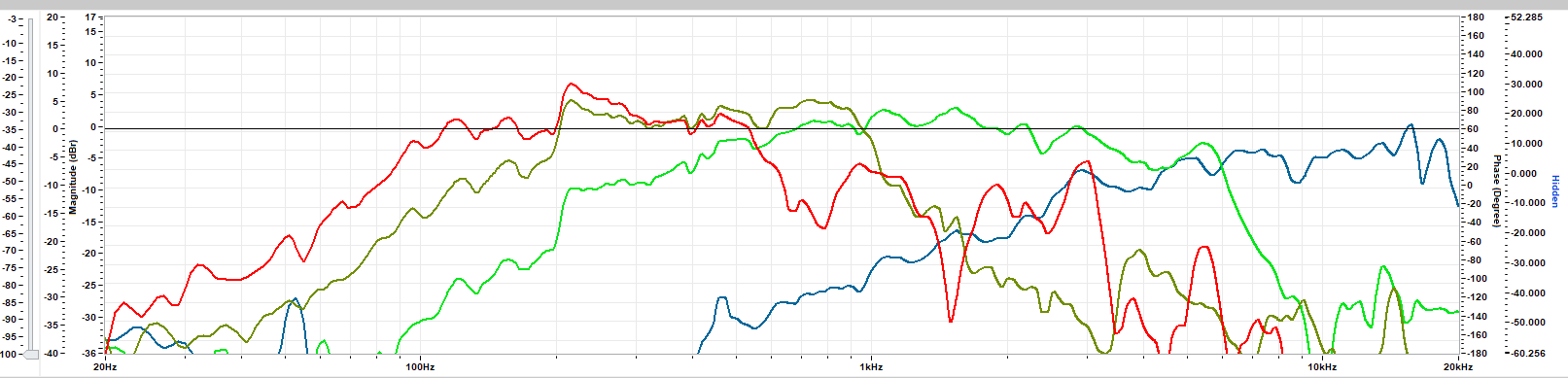

For grins this morning, I timed how long it takes to do the following on a 4-way synergy designed for 100Hz up, .... that had no processing in place.
So tasks were:
*Make raw measurements of each driver section. Red low, dark green mid, light green HF, blue VHF.
*Choose xover points based on raw meas. (I already had 100, 250, 750, and 4000Hz in mind...could have chosen others, polars determine final points)

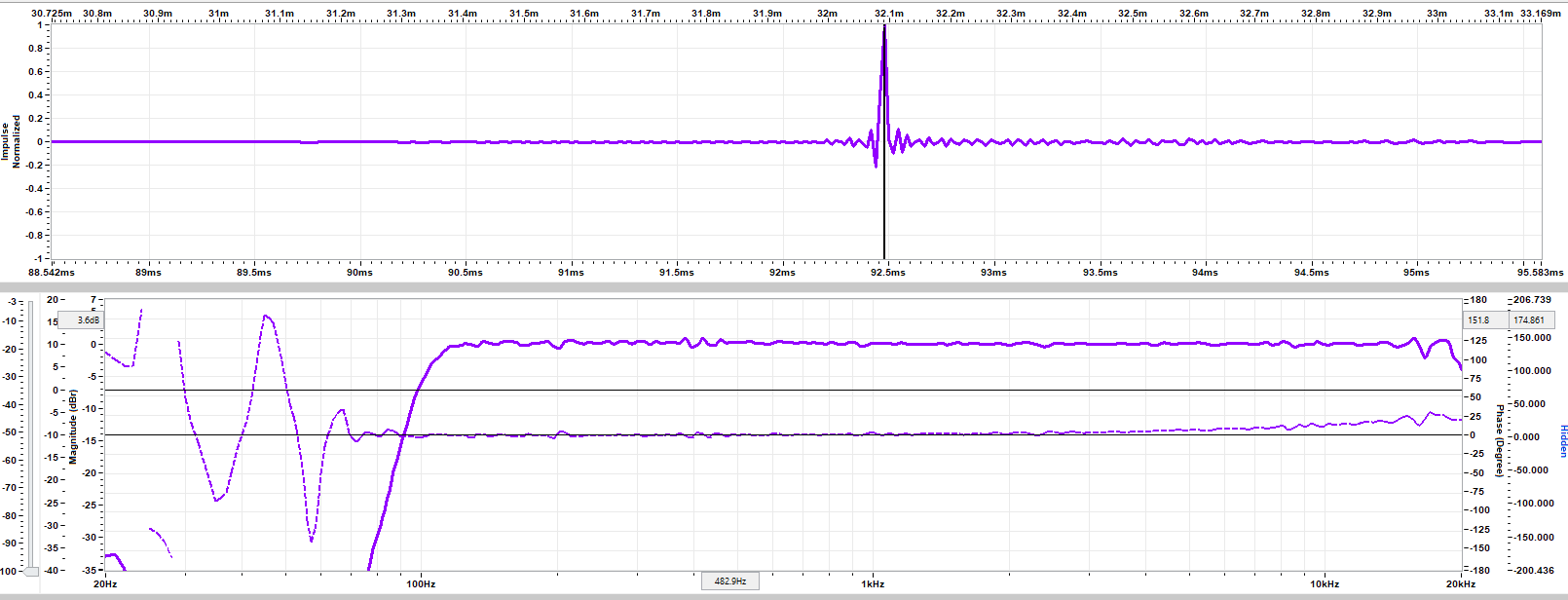

*Make FIR file for each based on those xover points (used my standard 96 dB/oct lin phase xovers). Let file file relative handle levels too.

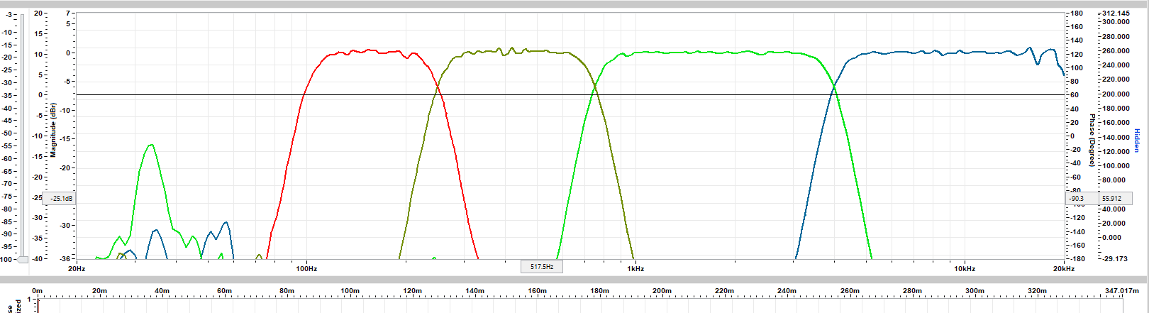

*Measure each driver section post FIR, to verify FIR filters in-band responses and xovers.

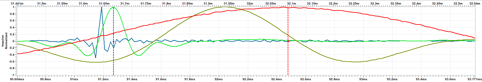

*Input driver sections impulse peaks time differences to determine delays to insert into processor. .
All channels are delayed to low (Red), which is the last to arrive. For example using HF.
Red vertical bar is at impulse peak. Blue vertical bar is set at HF (Green) peak.
Difference 1.208ms, is what HF gets as delay in processor.
* make final measurement of entire speaker to verify.
OK, elapsed time to do all the above.
22 minutes.
Now this was just a single mic position 2 foot indoor tuning. Not at all the outdoor, off a deck, 3m multiple vertical mics, and spinorama that it takes for optinal polar confirmation. (Tha't where all the work is imo/ime).
Simple 1/24th smoothing on all sections. No windowing, no noise reduction, no yada.
