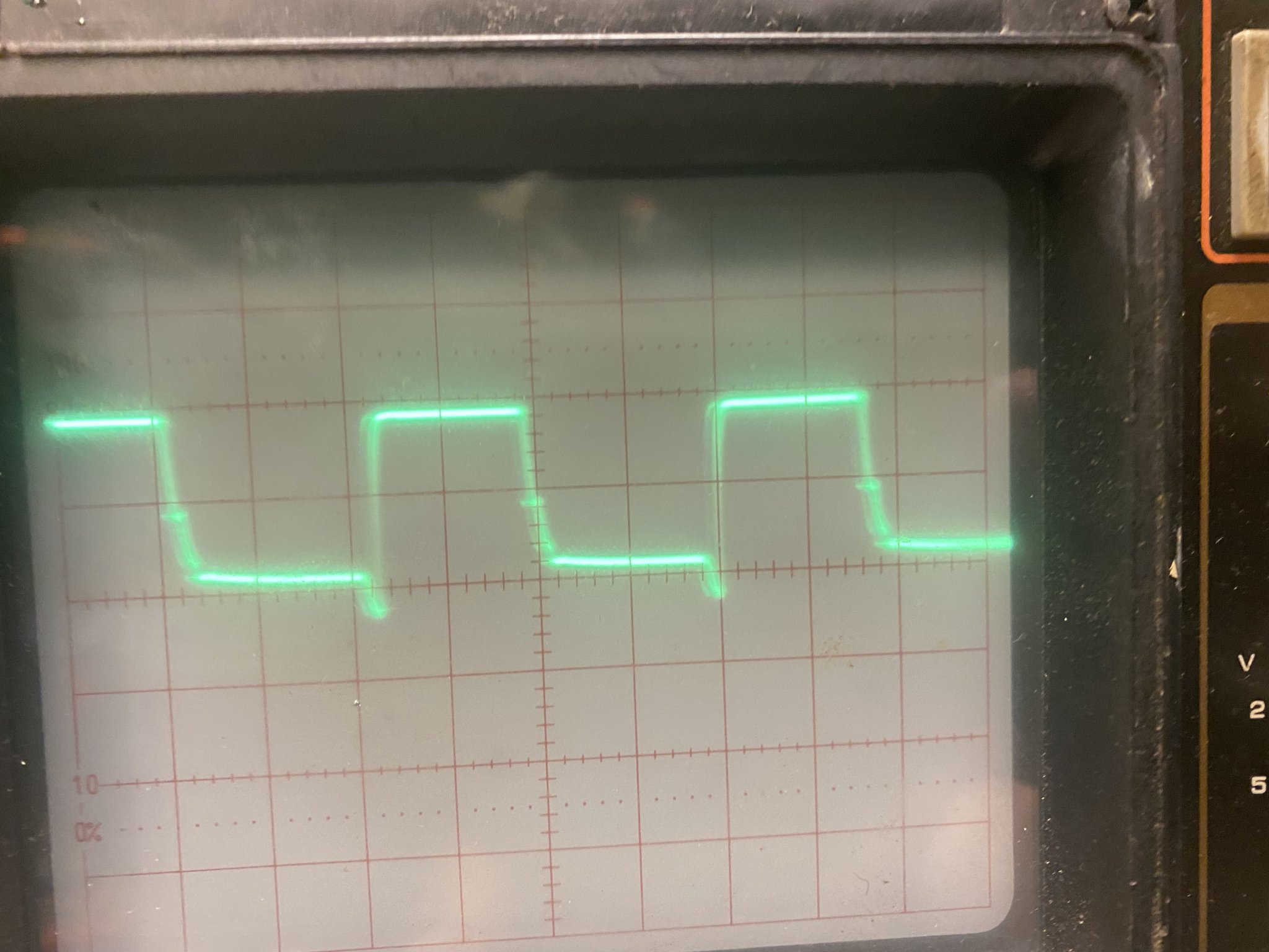

There are 2 pnp and 2 npn driver transistors per bank of fets
so 3 fets have 1 pair of drivers the other 3 fets have another set of drivers .

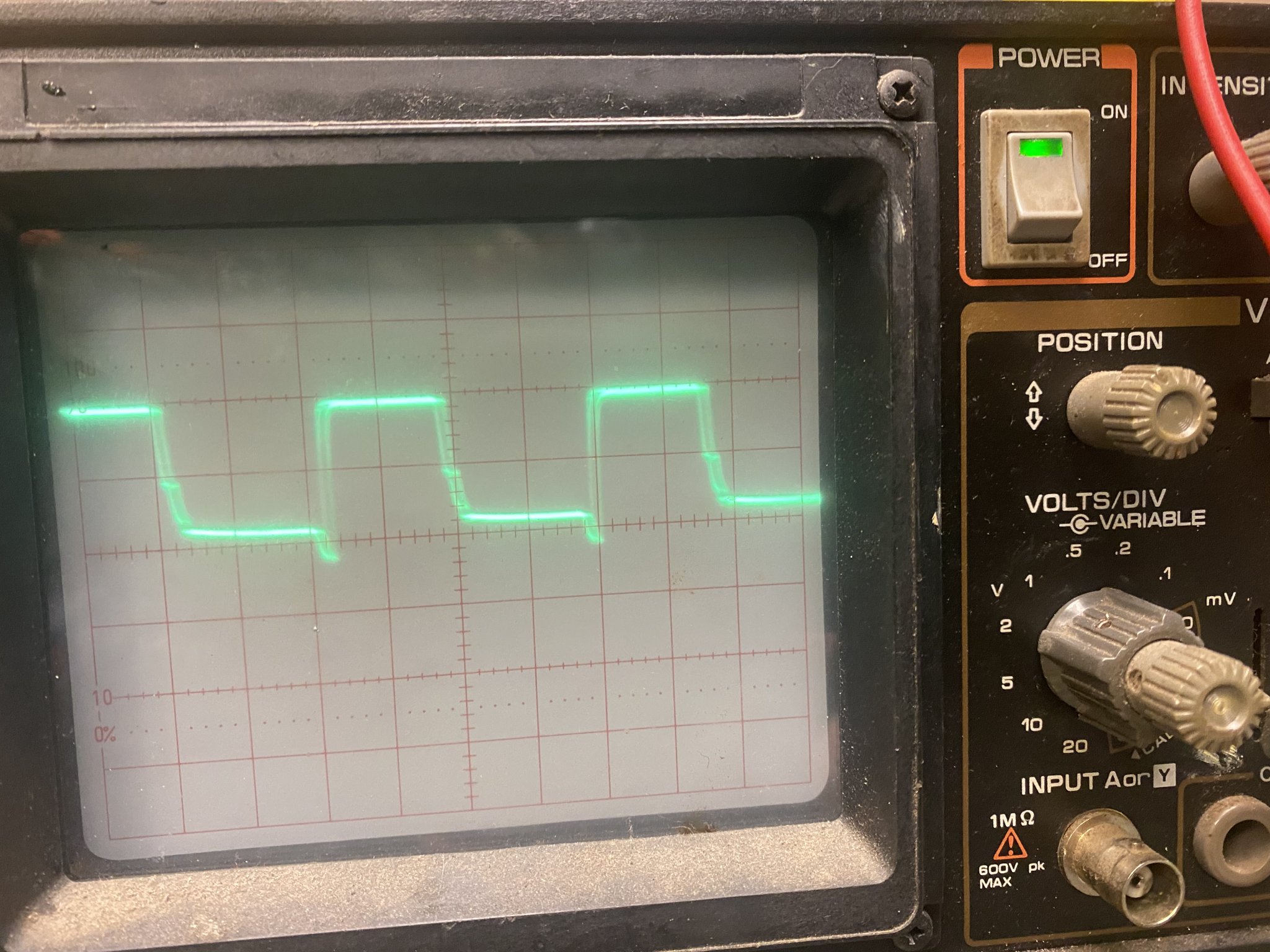

So I’m having issues with both sets of drivers or a transformer is shorted or something .
The drive signal looks good with a loading cap but as soon as the fets are installed the drive signal goes bad .
here is what I get as far as resistance
Q9-Q9A 94.1 ohms
Q9-Q9B 94.1 ohms
Q9A-Q9B 94.1 ohms

Q9-Q12 is 1.020K ohms
These readings match all of the other banks of fets as well .

There is a 1N4148 in series with a zener diode for each bank of FETs. Lift the 1N4148s and try again.
I removed the 4148’s
I still get 93 ohms from gate pad to gate pad on Q9,Q9A,Q9B and 1k ohms from Q9 to Q12 this is how it’s supposed to be I’m guessing since all of the other banks have the same measurements

Do I leave the 4148’s out of circuit and put the fets back in circuit and look at the waveforms ?
Ok I replaced the diodes and it fixed the problem . Thanks greatly appreciate it .
