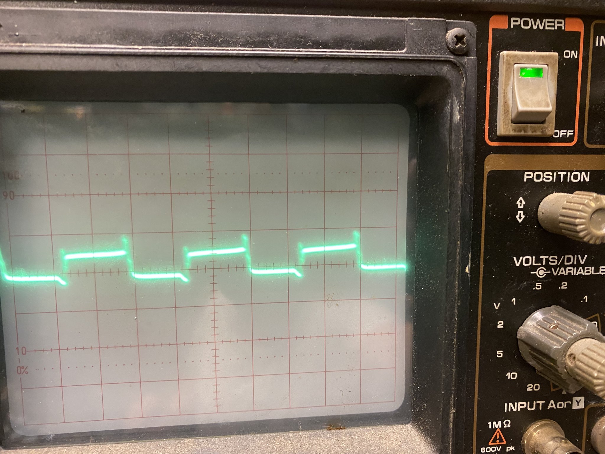

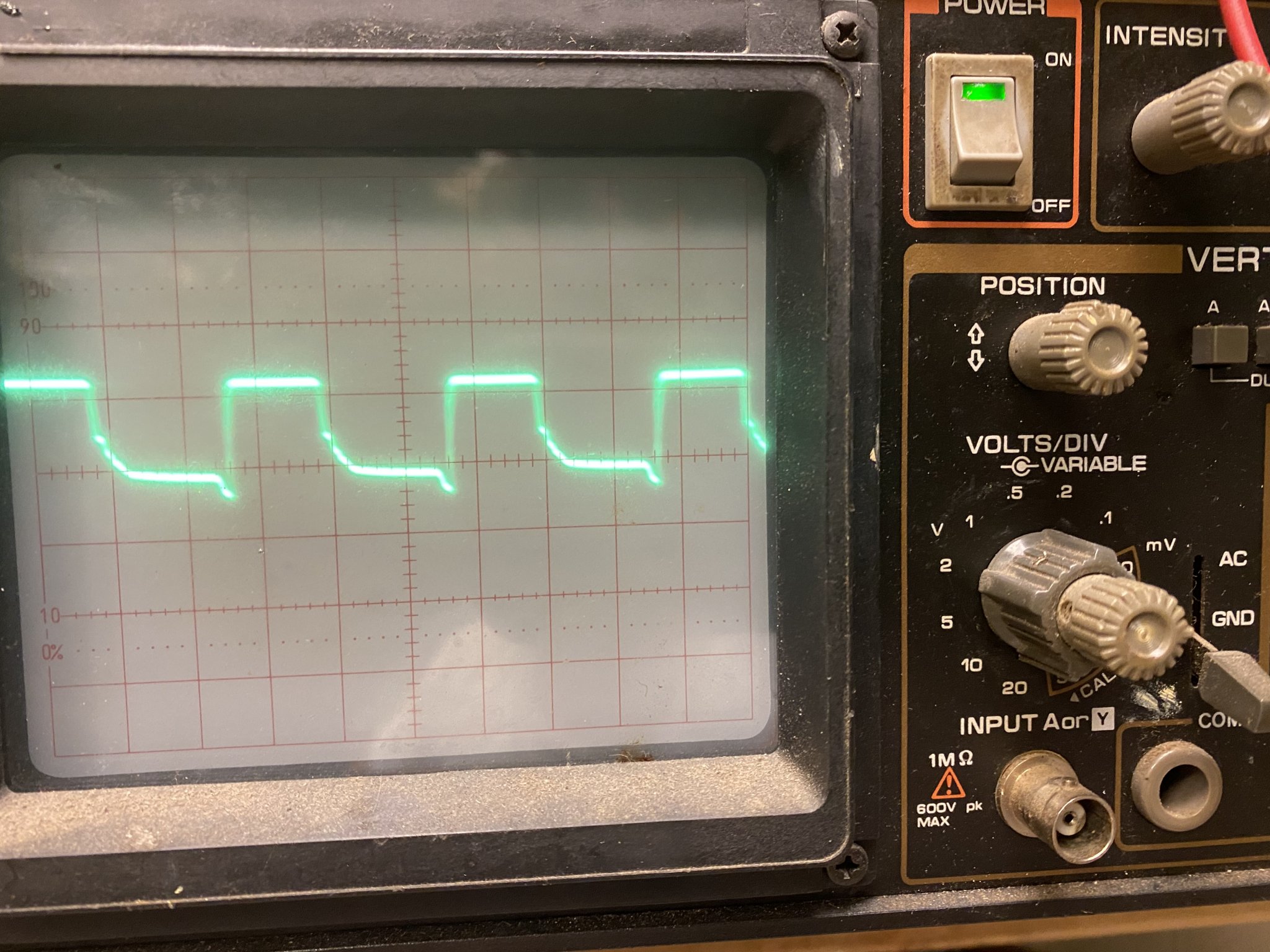

Something is right with the drive to 1 of the banks of fets .
Pic 1 is 1 bank of fets pic 2 is another bank .
Pic 2 the fets get hot after about a min
scope set to 5us .5 volts div

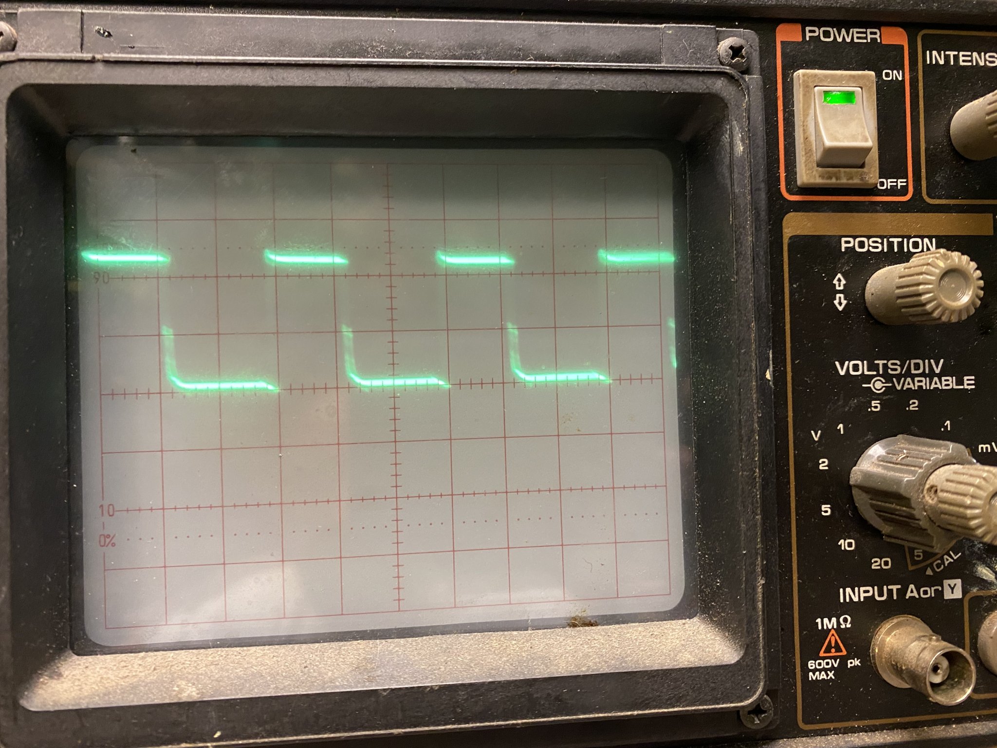

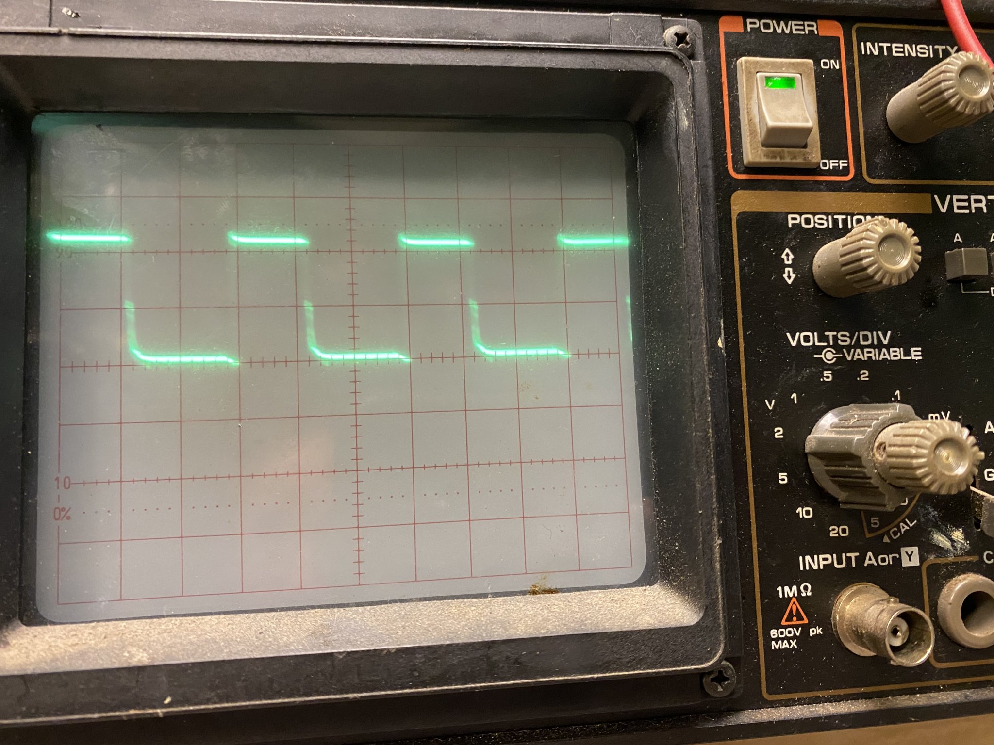

What's the DC voltage on the collectors of all of the NPN driver transistors? Check all 4.
What's the amplitude of the drive on pins 9 and 10 of the driver IC?
You likely have defective driver transistors. I'm assuming that the previous waveforms were taken from the emitters of the driver transistors.
The waveforms I took in the beginning were on the gate leg of the fets only 1 bank of fets has issues . Not sure why it is everytime I switch drivers in amps I always end up with defective ones
