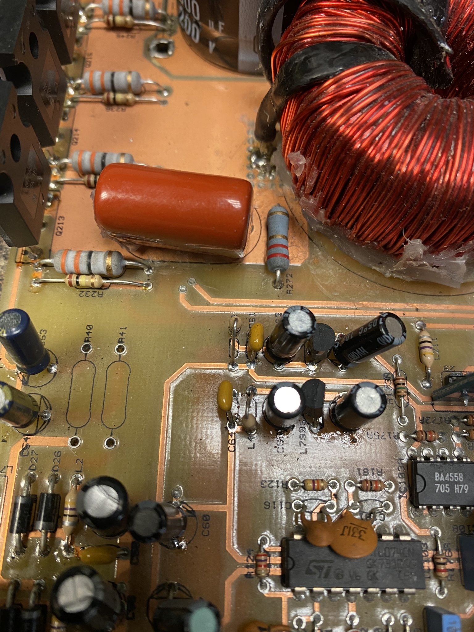

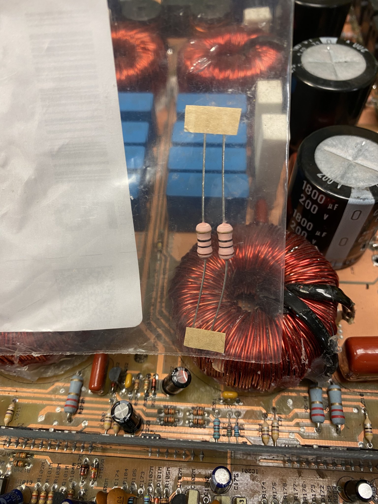

Now I’m working on the output board of this amp . There are 2 10 ohm resistors R40,41 They are 2 watt resistors .
I ordered resistors without checking the package size and they sent me 10 ohm 2 watt resistors but a smaller package size resistor . Would these resistors still work ?

2 last questions on this amp .
the original thermistors on the output board had broken leads at the body of them .TH1,TH2 I forgot to order them so I’m gonna see if I can pull some off a junk board . Do I measure the resistance at room temp for the correct value ?
And I replaced pretty much everything on the output board even the audio driverboard is brand new .
Im kinda scared to power the amp up since if I overlooked something I can blow outputs almost instantly.
Is there anything I can do to prevent this from happening if I have an issues somewhere
