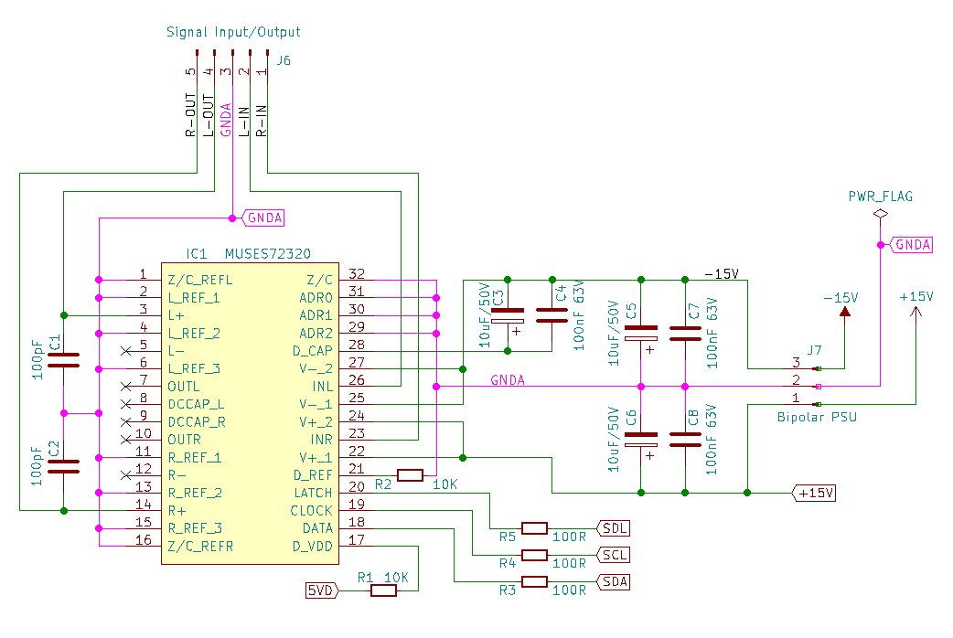

About the AGND -> DGND topic again:

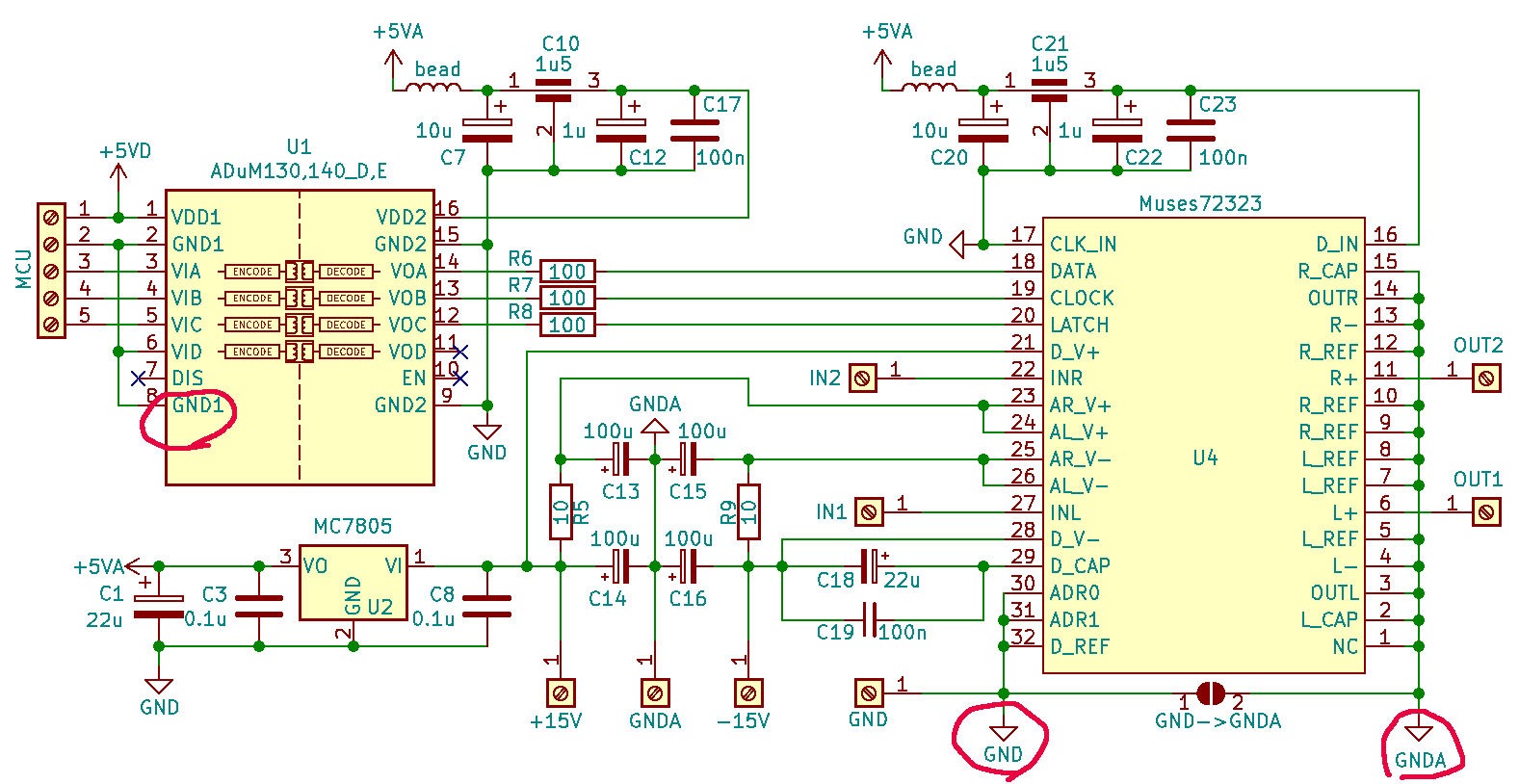

This is my schematic so far. I have dedicated +5V and +/-15V regulators in my PSU. I have 3 GNDs now (marked in red). "GND1" will be joined with the mcu. Looking at the schematics by meldano, lalaina and others it seems that if no isolator is used GNDA is separated from GND, but if the Muses IC sits behind an isolator GNDA and GND are joined (hence I put a solder jumper in between GNDA and GND). I guess it depends on how "dirty" we consider the digital block of the Muses IC, right?

Thanks for the hint! Yes, at the end of the day all GNDs must be at 0V, be it via the chassis or connected elsewhere. I still don't understand the difference between closing the jumper (with a solid connection of course) or joining the GND of the 7805 with GND1 at the dirty side of the isolator, because I don't know how the Muses IC works internally: does it use digital VDD only for the logic and the analog path is fully isolated? Do the +/-15V supplies only power internal gain stages or is the output signal affected by the quality of the +/-15V even if we always turn off gain settings? In other words: does the attenuation happen separately from all the logic like with a relay attenuator?
it's really boiling to just one fact, then one can decide what to do with own OCD:
- are Digital GND and Audio GND galvanically isolated in MUSES chip itself?
if yes, do with your own OCD whatever you want
if no, choose where to make them physically connected in circuit (think DA chips and tying those two at specific pin of DA chip itself)........
I can't check the fact, because I didn't found the fact in datasheets (maybe I didn't read them thoroughly) and because sole MUSE chip I have in possession I got already soldered and it'll keep collecting virtual dust ............
edit: while I was typing, jpk (finally someone) wrote the same thing

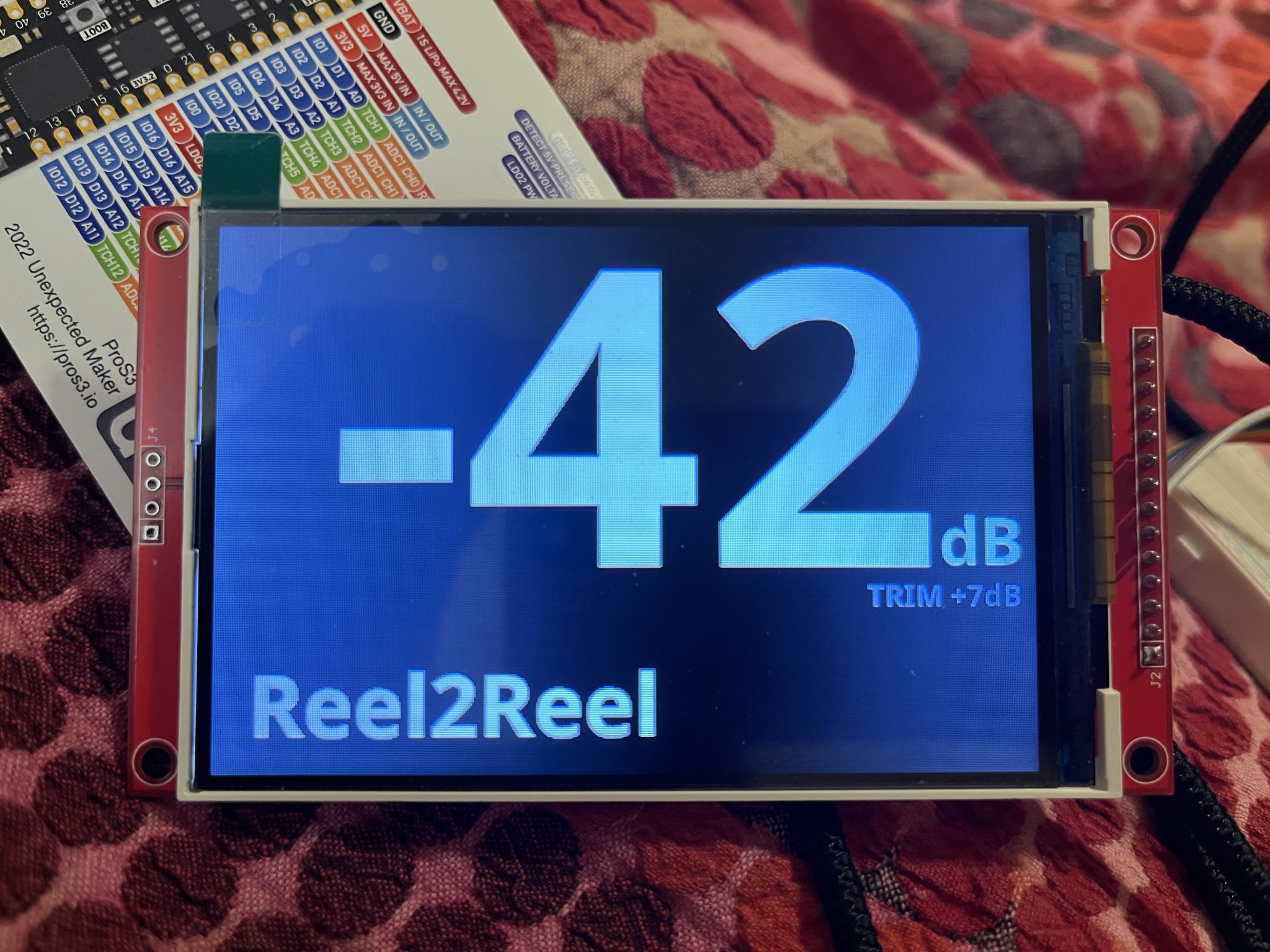

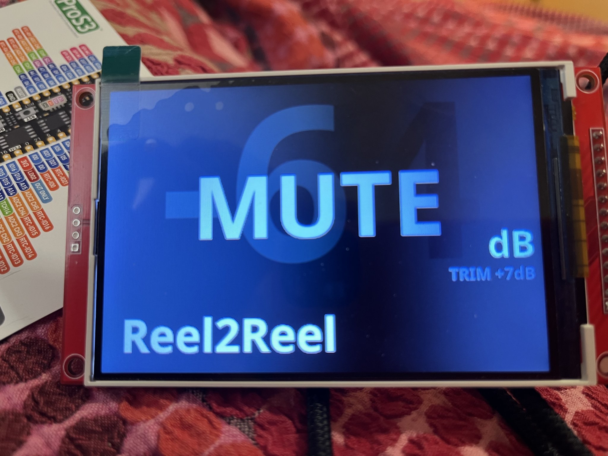

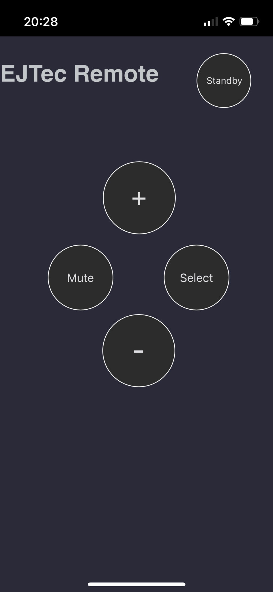

This is what I had been working on. You could select the source name from a list, a trim for quieter sources, a balance that would trim the left or right channel down proportionally, auto dim the display, choose the display colour and simple web app. I had not started on the hardware side yet but was planning to have a 12v trigger and a relay that would ground the speakers (anti pop). I spent more time trying to display the album cover being played on PiCorePlayer than anything else and lost interest. I will have another go, like I posted before I could not get a touchscreen to display so I will get another one as it is probably faulty. I was fairly happy with the user interface it was looking and working better than some high end stuff that is out there.

maybe I'm wrong but I've only wrote that in the jpk schematic there is a conceptual mistake. There is no ground connection for the 7805 besides the jumper. That, for my point of view, have no meaning. Why putting a jumper when need a stable connection ?
That being said, I totally agree with you.
PS: all ground pin on Muse chip (D or A) are galvanically isolated between them
thus confirmed - then no need of isolating anything, just have separate audio and digital PSUs, connect digital GND to chassis/safety GND, lift audio GND from chassis in some of usual ways of controlled lifting
if building gadget without safety GND (double isolation standards), then improvise with isolator chip solutions or whatever
OK, thanks for clarifiy! The Muses72323 even has separate +/-15V pins for digital and analog: so do I need another dual supply?
@Zen Mod
The jumper is only there to illustrate the possible connection - it's not the final schematic. Also there is a screw terminal at GND of the 7805 that was intended to connect somewhere else in case the jumper stays open...

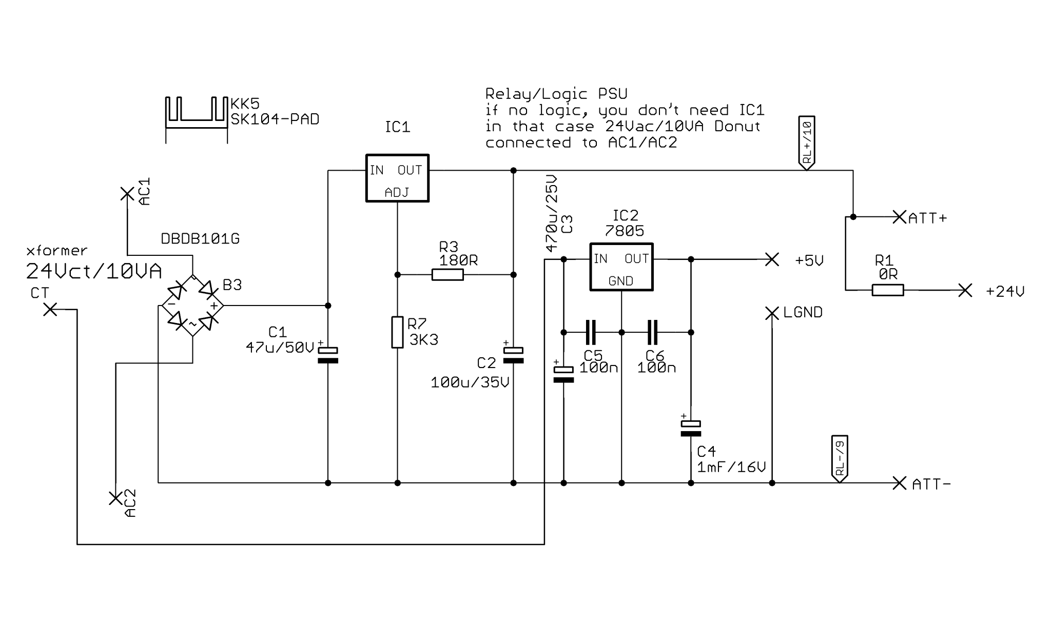

As I don't intend to sully His Mightiness' IP bipolar supply by taking any feed off it to drive a digital input (horrors!) just for the sake of convenience or to save a few cents in a project of the IP's quality why not simply use a dual-rail, separate PSU for all the digital components and leave the IP bipolar supply to do what it was intended to do? 🙂
In previous projects with microcontrollers controlling DACs I've always used the above approach - one rail for the 'dirty' microcontroller and IR, display, relay coils etc and the second, separate (no CT), rail for the 'clean' side of the isolator and DAC. I can't see any reason not to do the same for the MUSES. Second, 'clean', rail for digital in/D_REF on the MUSES and VDD2/GND2 of the iso chip. And grounding is as ZM outlined with NTC.
I don't have my 72323 in hand yet but @mvaldes has confirmed the digital and analog grounds on the 72323 (presume same on 72330 but worth checking) are galvanically isolated so above scheme should work. Audio grounds (L_REF, R_REF etc) I'd ground to the IP's 0V. Unless HMZM advises a better scheme...🙂
Unless HMZM
as I wrote earlier, that's exact recipe I'm using in my Iron Pumpkin and few other concoctions
audio circuits having own Donut & rest of PSU, while small 10VA Donut dedicated for relays and logic circuitry (based on Arduino Mega 2560 Pro, I need plenty of relays to command)
nothing fancy, simplest possible
edit: IC1 is LM317, ignore error in note - IC2 is not needed when logic is not used in particular project)
