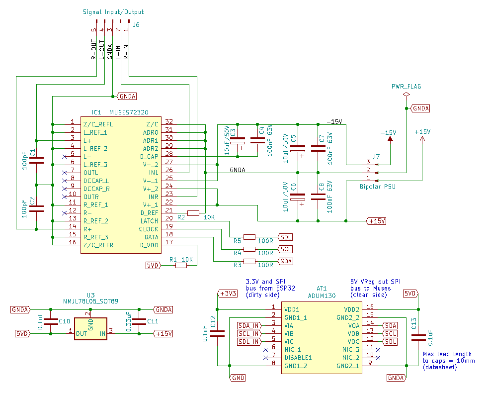

Hmmm….you’re grounding the digital MUSES pins to the analog supply of the IP. I, personally, am not comfortable with that. I’d prefer not to ground the MUSES digital grounds to the analog grounds. Especially as MUSES went to the trouble of galvanically isolating them according to @mvaldes. I’d go to the extra trouble of keeping that galvanic isolation in a project like this.
You show 5VD as standalone but I’m assuming you’re deriving that from the +15VDC of the IP supply - again personally, I’d make that an independent PS and ground that PS and all the (right-side) MUSES digital grounds to that and safety earth. But that’s just me….🙃
I appreciate your comments. What I posted wasn't the complete schematic. The one below also includes the 5V regulator and digital isolator. Feel free to look it over and post your comments. At the moment the Vreg and digital isolator is on order. I should have it within a few days then I can check if it works as drawn.
It's all pretty much experimental. I'm making changes and testing on breadboard as I go along. Only when I'm happy that it's working 100% will I order boards from the fab house.
PS. Right now 5VD (probably not named correctly) on Muses pin 17 is powered from the ESP32 which runs on either USB or an external power source.

To be honest, I haven’t paid a lot of attention to the 72320 as I intend using the 72323. Assuming your 72320 Out’s (to the IP) are not the Gain outs then your schematic should work. A few comments/queries -
  • Why are you using caps on the audio out of the MUSES?
  • I’d consider incorporating 47R, good quality, resistors in series with the audio outs.
  • From memory, the ADum1300 does have level translation so your use of different level supplies (3.3VDC in and 5VDC out) isn’t an issue but a quick look at the 1300’s datasheet just to confirm should clear that up.
  • I don’t know what maximum current output the ESP32 can provide to auxiliary devices but I assume you’ve checked that and are within the current max for the devices (ADuM, display(?), IR rcvr(?) you intend using.
  • Again from memory, the 72323 has three pins connected to the bipolar positive rail and three pins connected to the bipolar negative rail - does the 72320 only have two pins each rail connected?
So, all that said and aside from my aversion to grounding the MUSES analog and digital grounds to the IP’s 0V rail along with taking the 5VDD supply from the IP as stated above, I’d think that should work. But, in my humble opinion, it’s not an optimised implementation for the MUSES/IP project. I’d buy a small donut like ZM said and use your on-order regulator with that for the clean side and that’d allow you to redo your ground scheme to allow separation of the audio ground, the ESP32 and it’s auxiliary devices (the ‘dirty’ digital side) and the ‘clean side’ MUSES digital 5VDD requirement and isolator VDD2 and VDD2 GND. Would only require the purchase of a small xfmr.
iirc the 72323 has pins for digital +5V, digital +15V, digital -15V, analog-R +15V, analog-R -15V, analog-L +15V and analog-L -15V. As soon as we join the three +15V and -15V pins together we are likely to get digital noise into the analog part, right? So if we separate AGND from DGND we should also separate digital +/-15V from analog +/-15V, no...?
The ‘digital’ part we want to separate ‘from the rest’ is the potentially noisy digital control logic signals. MUSES appear to have gone to the trouble of isolating this and therefore requiring it be powered by its own PS - the 5VDC D_IN pin 16 and grounded separately by D_REF on pin 32. Hence also the use of the isolator on those logic control pins. I suspect you are looking at pins 21 and 28 and seeing the reference to digital power supply plus and minus but they are not part of the control logic according to the diagram on page 7 of the datasheet.
No, I’m not using gain on the Muses (although it’s external opamps). In my opinion there is no point in using gain if it’s used with the IP which already has built-in gain.
You’re raising very good questions, which I’ll happily answer.
Because Wayne used caps there in the Pass Labs XP-12 preamp. There is a picture in post #2. Many other users’ schematics also show it, so I though why not.
After discussing those resistors with Zen Mod, he suggested losing them when used with the IP.
Done and confirmed.
On full brightness, the Waveshare 2.4” LCD screen draws 14mA. The other devices draw even less, so all good I think.
Correct. Only two pins for the 72320.
Your aversion and concerns about not using a separate transformer to power the Muses data block are noted. However, the voltage regulator that I’ve ordered is made by Nisshinbo Micro Devices, the same company who manufactures the Muses chips. One would think that they approve of using the two products together in the way I intend to do. BTW, this specific voltage regulator was suggested by @mvaldes who seems to have a lot more electronics knowledge than I and he’s also built a Muses attenuator (and used the same regulator and digital isolator). See post #124.
Part of the fun of diy is the design decision-making process, thanks for answering the queries.
I will likely use an external LT3045-based PS for the two digital rails - certainly overkill but I have it on hand - the best reason. The Analog Devices LT3045 datasheet shows a noise spec of between 0.8uV and 2.5uV at full load (500mA) and ripple rejection of 117dB. As compared to the MUSES NJM78L05 datasheet which shows ratings of 70uV and 69dB.

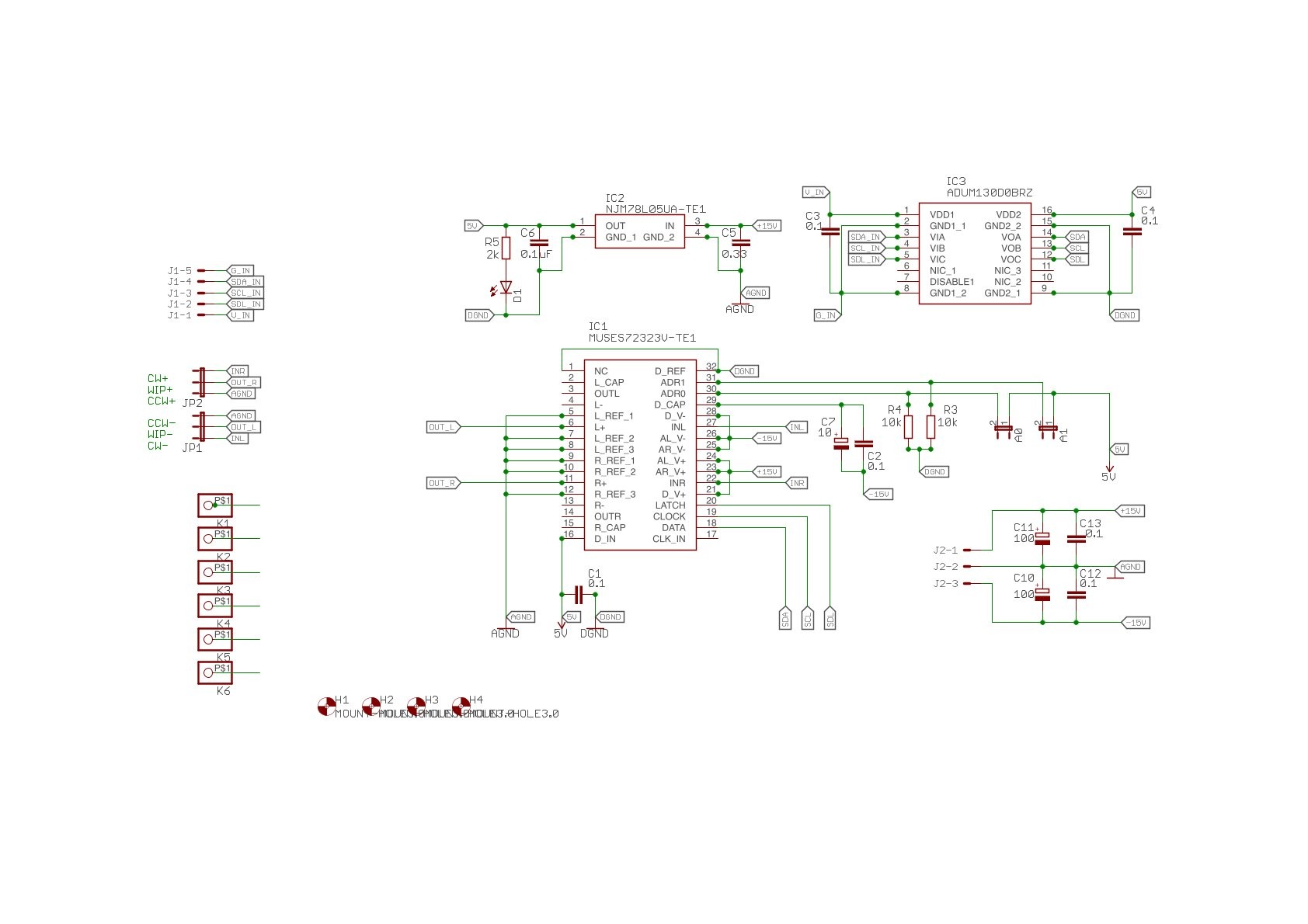

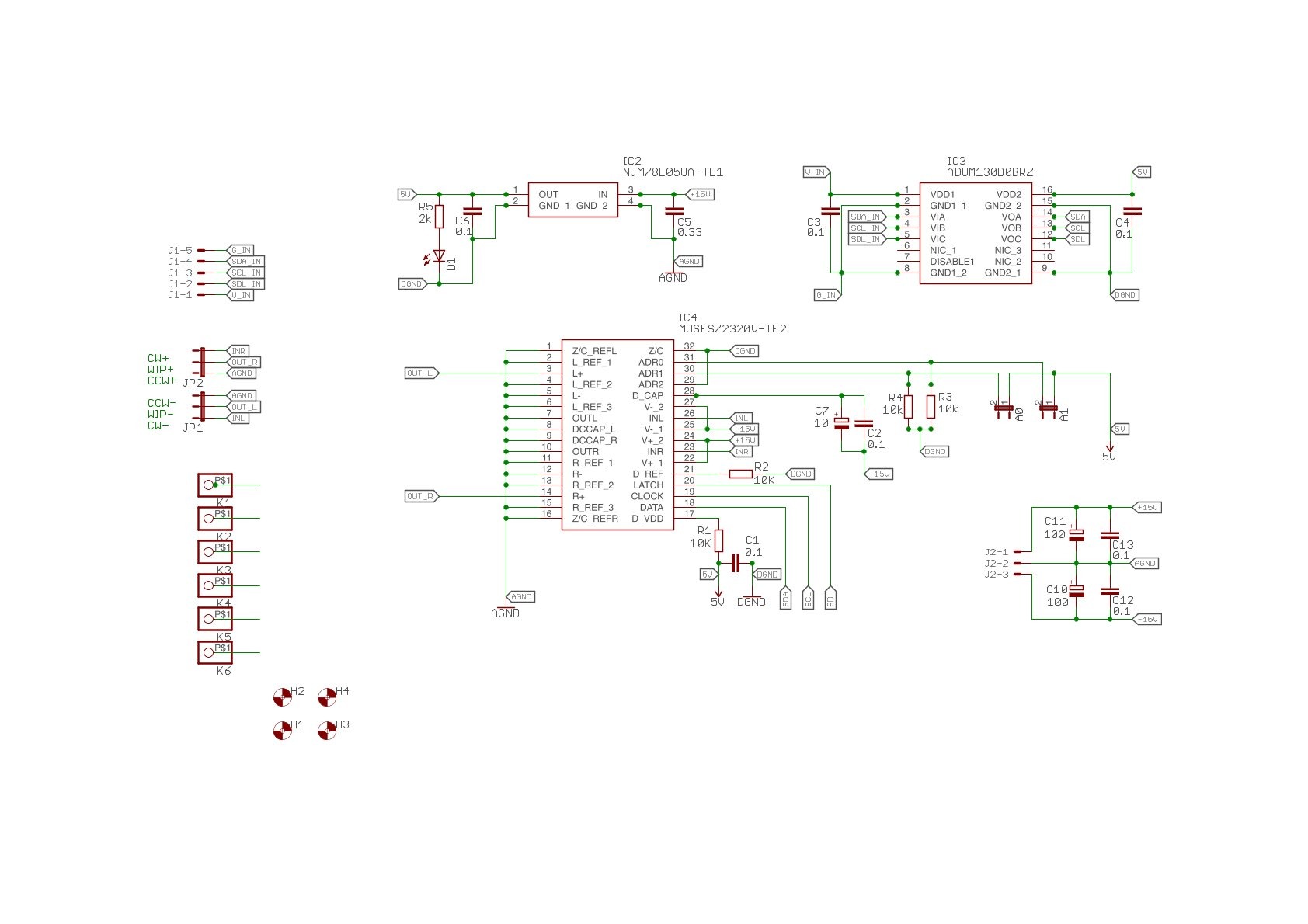

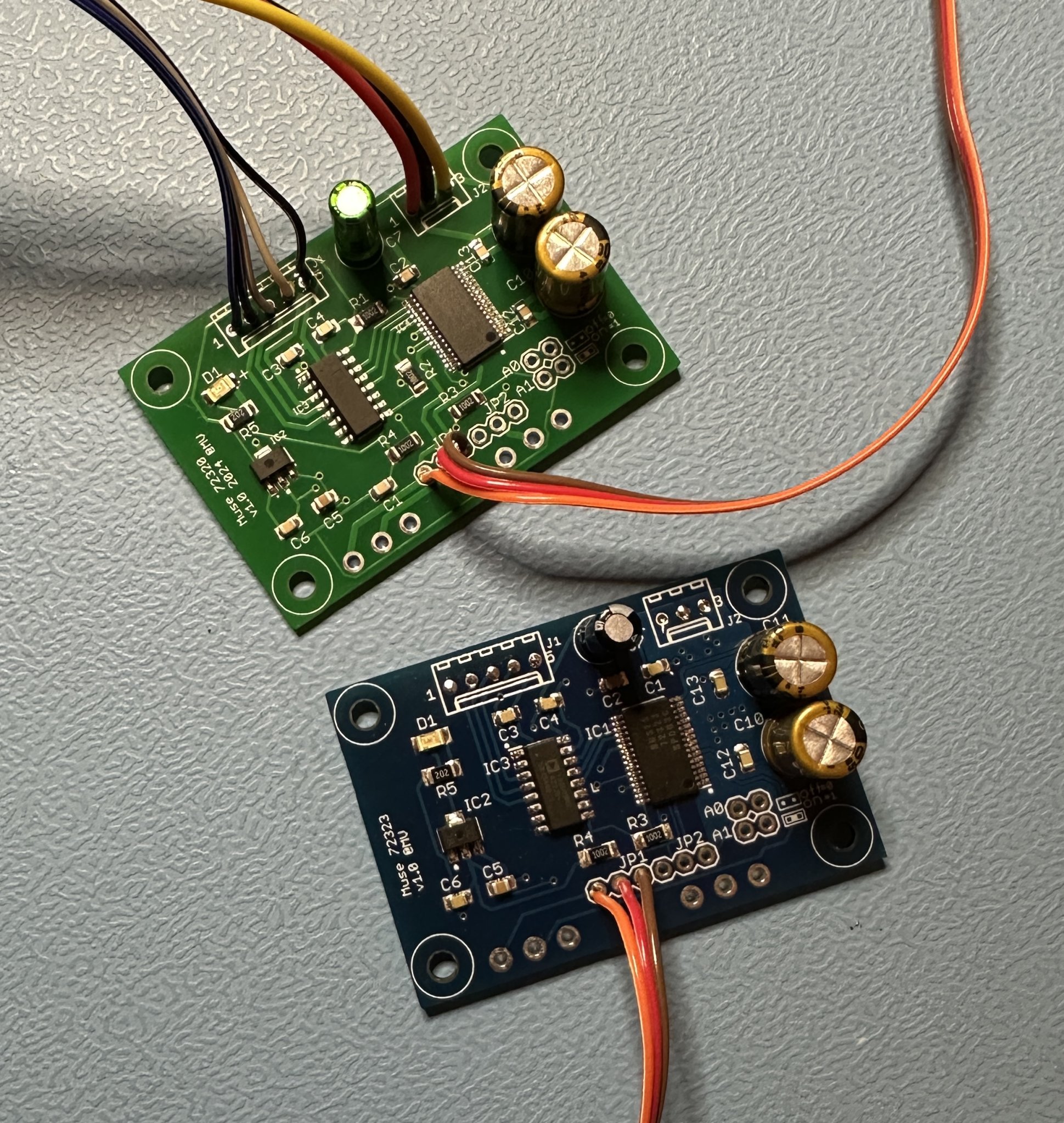

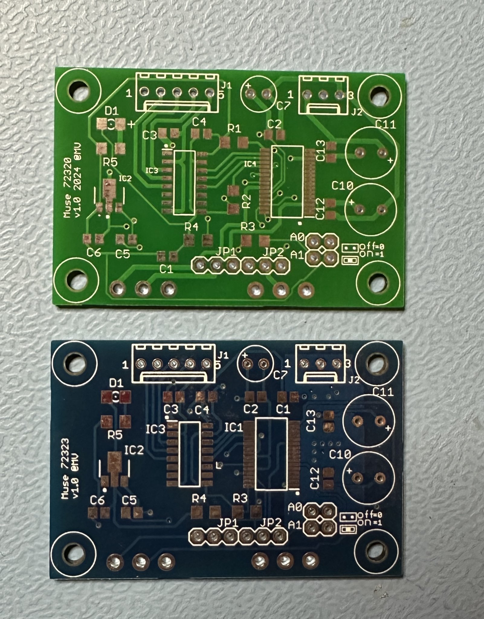

After my previous posts I received some messages from members with questions regarding my boards.
Here are the schematic and Gerber file I made for the muses 72323 and 72320.
They share basically the same logic, so there is a digital isolator for the microprocessor control signals and a 5V regulator to derivate the 5V for the Muses chip from a +15/0/-15 analog power. I choose this solution because I made these board to use on my IP and also for other projects.
I still have some board available, if someone wants them send me a DM.
Michele

Excellent, @mvaldes.
It looks like the signal's in/output correspond with the spacing on the IP boards. How do you mount the Muses boards vertically on the IP boards and how is the connection made? Can it plug in and out?
Now I understand your logic with the isolator and 5V regulator. By using that, no external power supply is needed for the Muses because both the binary 15V and 5V required for the Muses digital block are sourced directly from the IP boards. Also, any MCU & screen can be used. Your design is very flexible. It can be mated to a simple Arduino MCU and OLED screen, or alternatively, a fancy high-res LCD screen requiring more RAM, in which case a more powerful MCU can be used. The only external power needed would be for the selected MCU and screen.
Also, with provision being made to change the Muses chip address by jumper, one MCU can control two of your boards for balanced IP boards.
