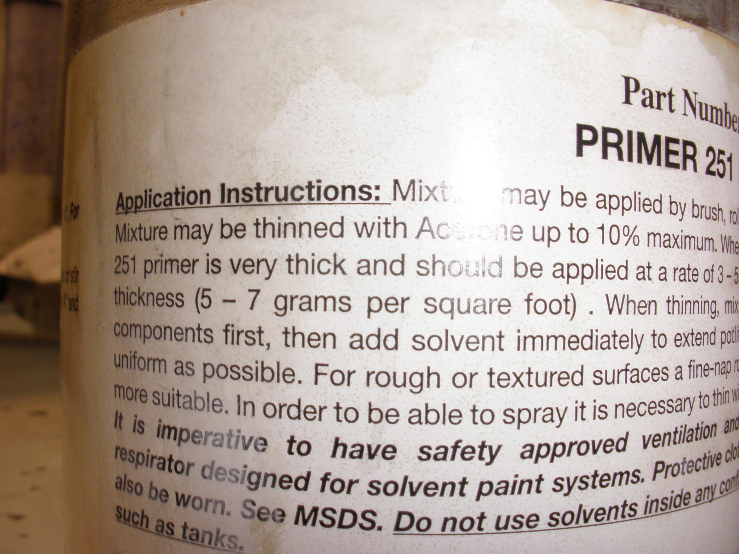

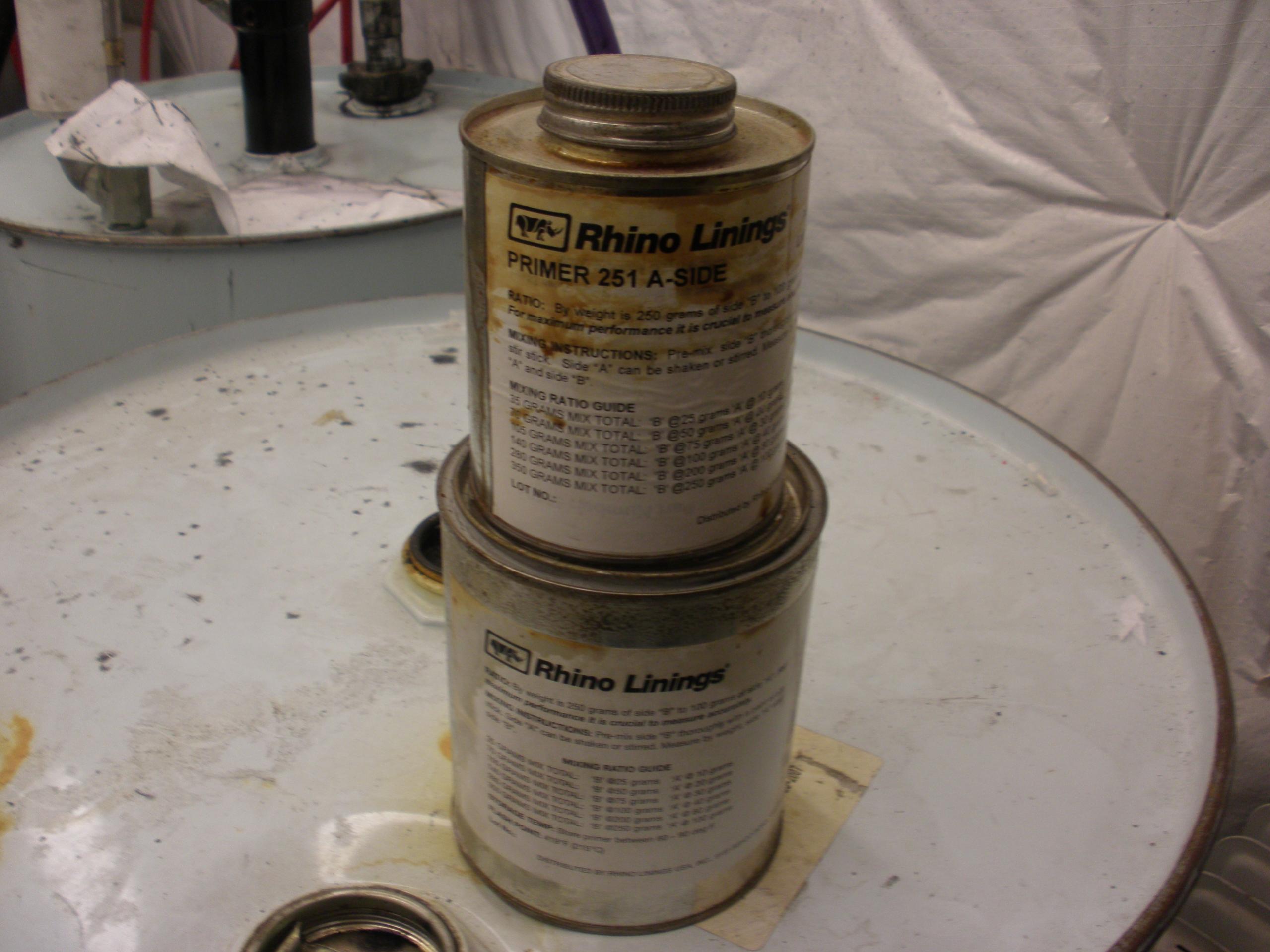

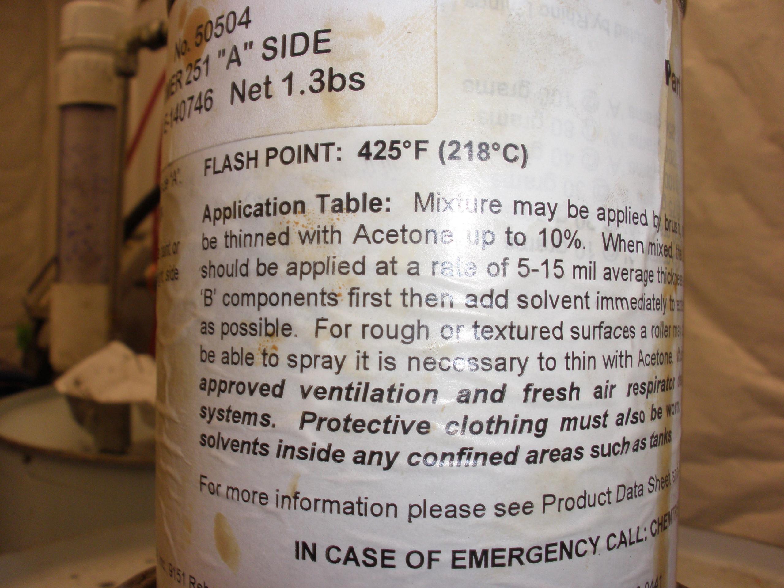

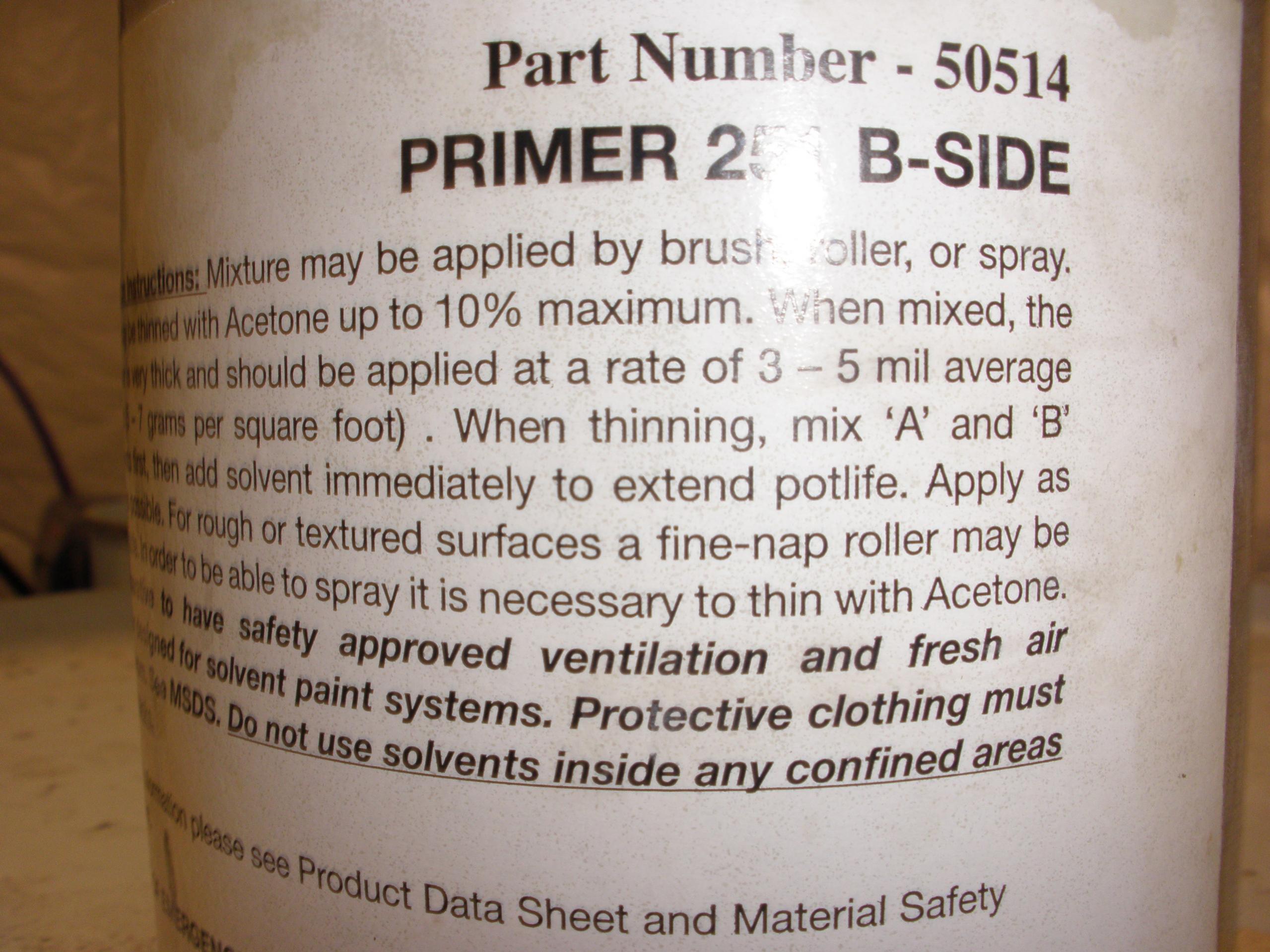

This is what i will be using to coat the stats, it is a two part mixture, but will show off the steel panels as it will be somewhat clear. No, i am not using 2000psi, just a regular paint gun, diluting the mix with acetone, not only will it bond better to the metal, this was designed specic for bare metal and as you read, the coating will be @ 10 mills, and very, very smooth as i was concerned anout the 3m tape sticking to rhino lining(the black stuff).
i am getting so close to finish, makes me feel a little giddy.
but here are the pics, i had to take two as the cans had the labels wrapped all the way around.
please let me know what you think. Mav

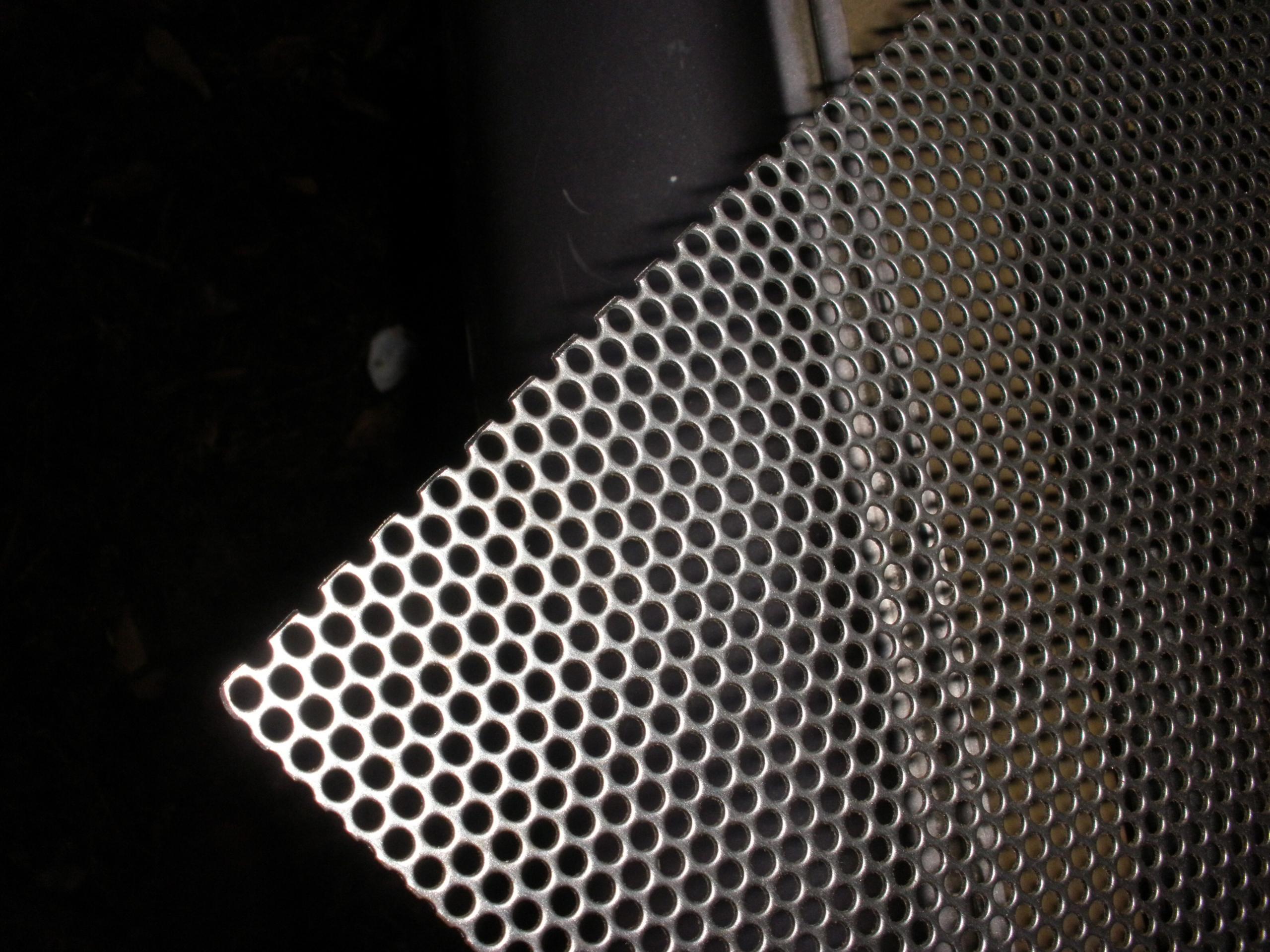

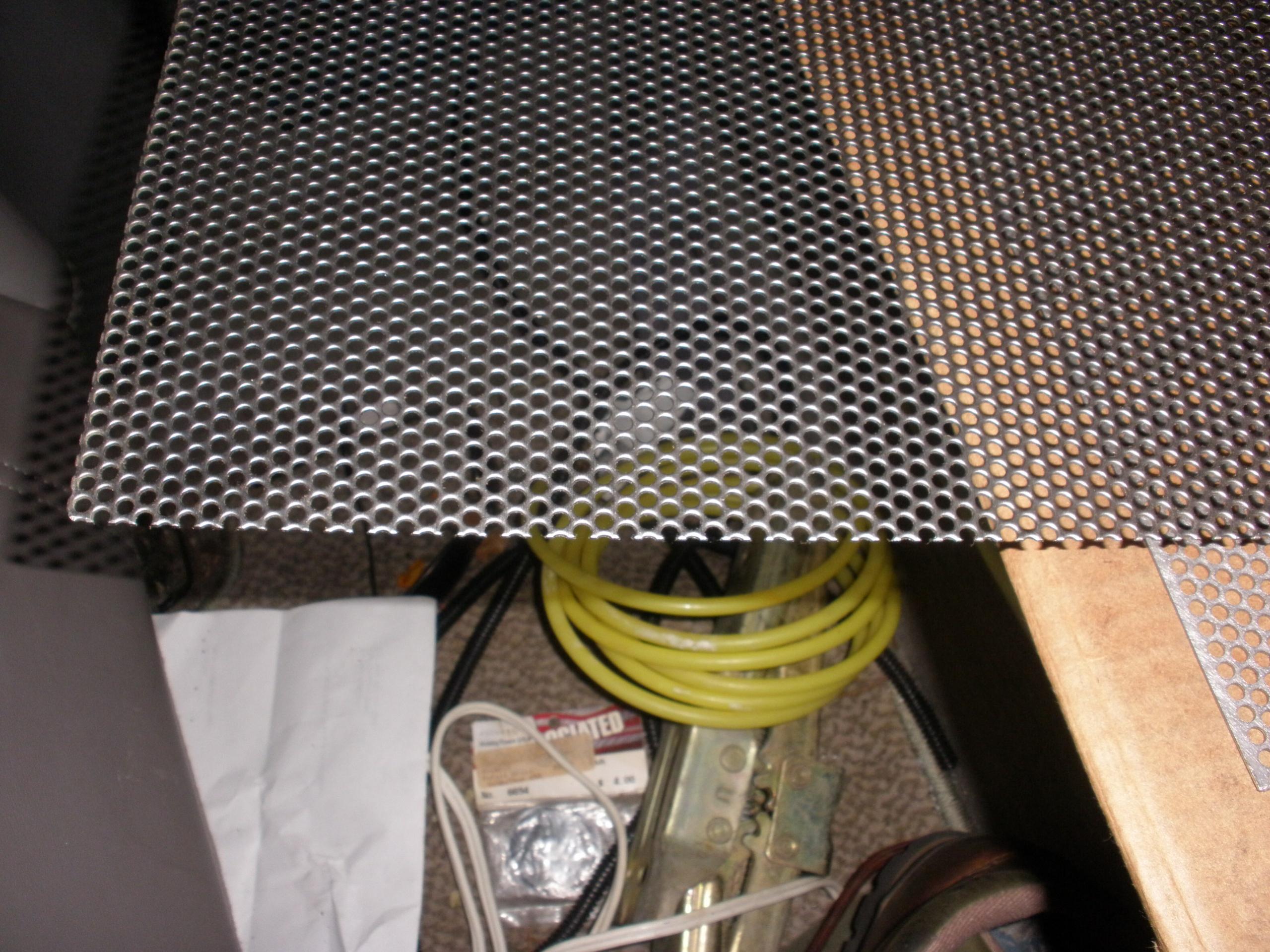

Thank you Calvin, I understand that your words are worth gold on building ESLs. I meant grinding them, which i about to leave and do that now. just so i understand 100% the left side og this pic is what ALL sides and edges should look like.

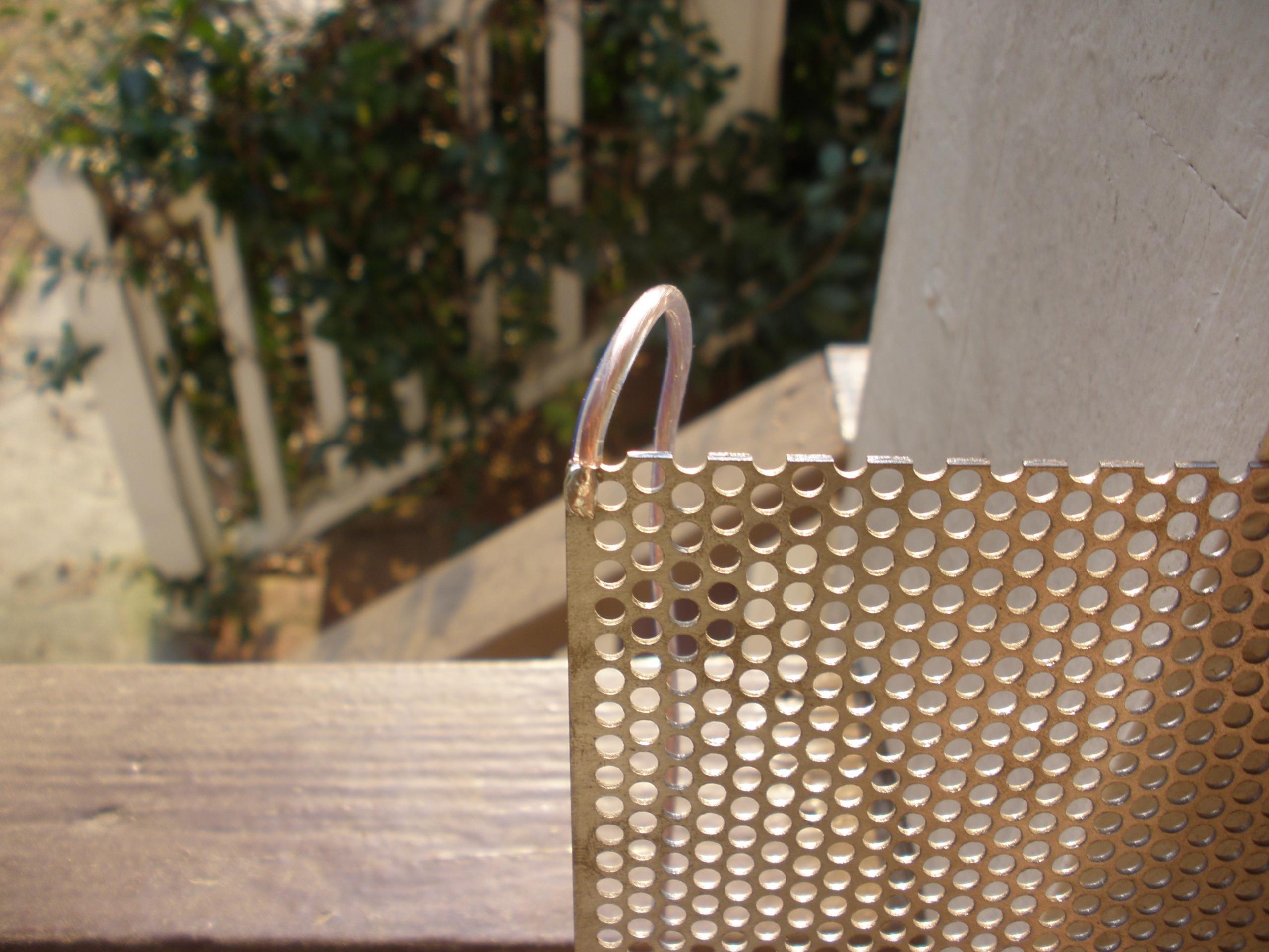

I cleaned up those edges as best i could, since they are stagered, a little more difficult than i thoght. It was getting late so only took one pic, will have to resolder all contacts and smooth the edges from grinding, other than that, what do you think? good to go?

Now that you've ground the points off those stator panel ends, a little smoothing over with sandpaper will ensure you've got the best possible edges before coating. It's a good thing you posted those pics and Calvin stepped in to help out. I think you're gonna have some really nice sounding speakers!

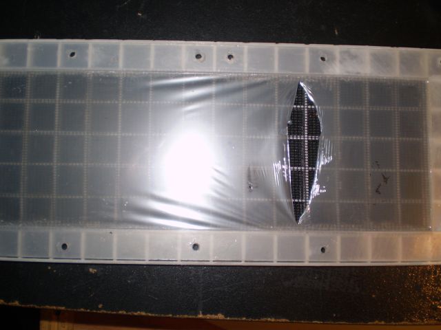

Here is what happens when you hold it in one spot for more than 2 seconds at 4 inches diatance.note the pinhole from an arc over.Gonna give them 2 or 3 coats of clear acrylic enamel.
This will also be my first chance to try the new crystal clear lichron spray coating for the diagphram.

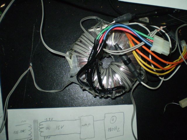

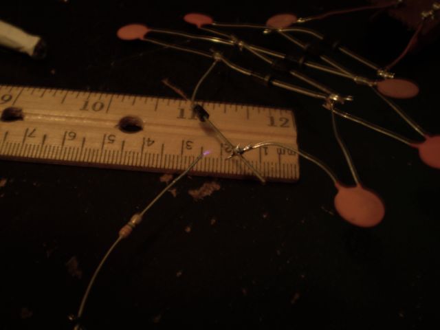

I finished my bais supply and tried stacking transformers.
Works great!
I can get fullrange at a low level and down to 200hz with 18 turns (1:77 ratio) and 400hz with 9 turns (1:154 ratio)at full power.heck I have ten of these things tomorrow I'll stack 1 or 2 more.I'm hoping 3 will get me full range at ful power (100watts) but 4 will defintely do it.
Also just as I suspected the ratios of the two identical transformers were not the same.
As much as 10% difference was found between the two of them.
Luckiley all of the windings are seperated from each other and could be wired with a balanced eqeal output per stator.
This might have been the cause some peculiar happenings that caused me to get out my heat gun in the first place. jer

Calvin, i posted the wrong pic, not sure if you caught it. The stagered edges on the panels have heen ground down, difficult task as they are stagered holes. I like the link, a picture is worth a thousand words.

the two part primer for coating is essential, i have used this before(not on stats) but there is no way you can go wrong, one coat, one finish, @ 10mills, perfect from what i have read.

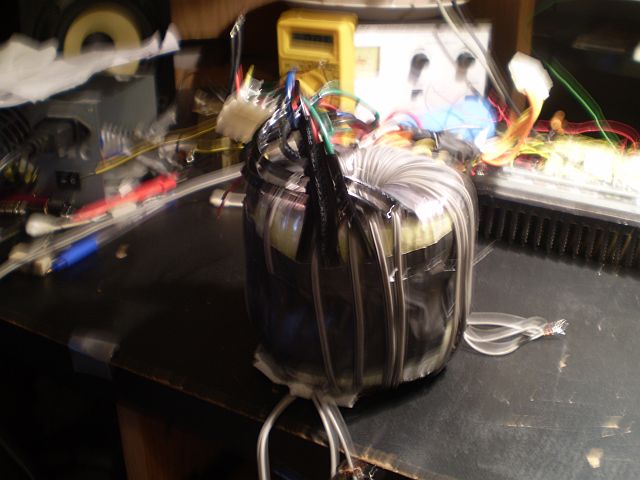

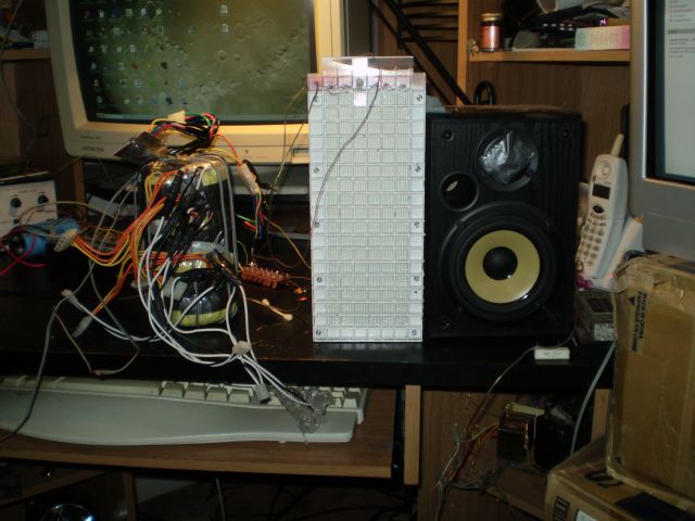

Super incrediable, clean and balanced sound out of my latest creation,ur, configuration i mean.
Quadstacked transformers good until 150hz-180hz at full power.
Measured 160:1 ratio with 10 turn primary at 1 volt .
Somtimes I measure 130:1 at a higher voltage this may be due to losses within the transfromer itself.
The esl is run fullrange and I'm using my mixer as a makeshift crossover taking out all the highs out of the woofer I can with the parameteric eq"s it has.
I havn't tested at a high volume yet ,as i will do that tomorrow. jer

coating the stats tomorrow using the two part epoxy from rhino, excited and and hope i have enough. i will have to dillute it a bit w/acetone but that is the material is very thick. Will be posting a panel or finished panels tomorrow, coated diagphram and all, arc testing before assembly and pray to GOD that everything is spec.

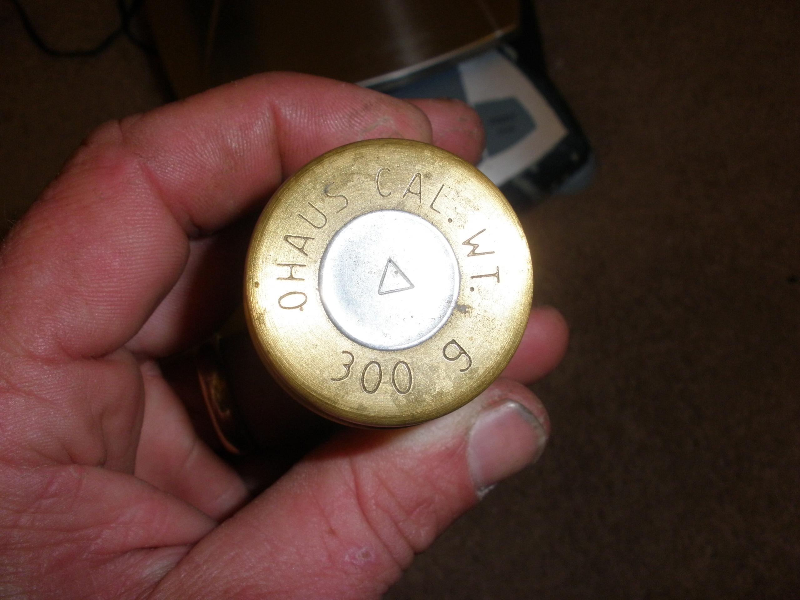

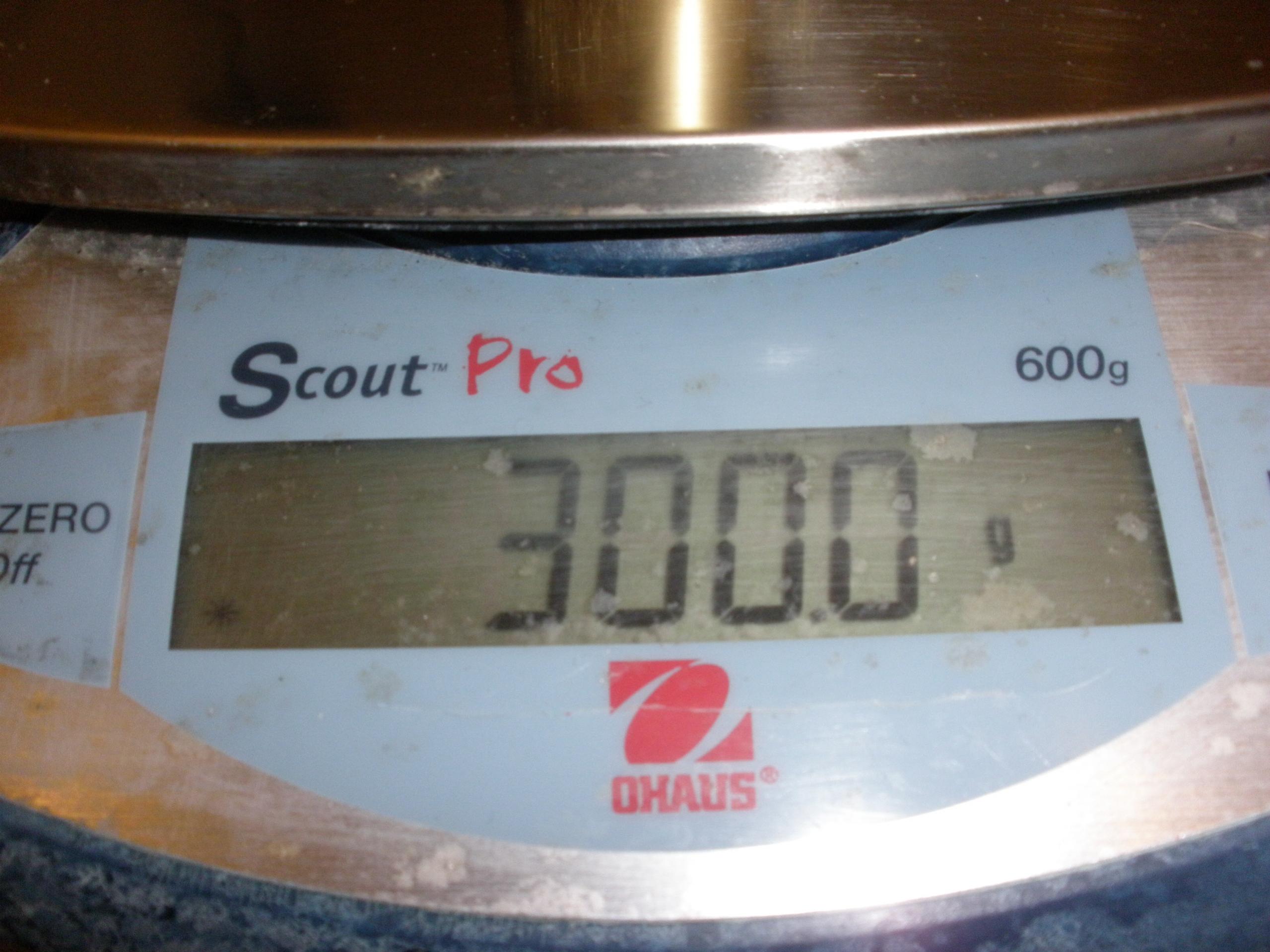

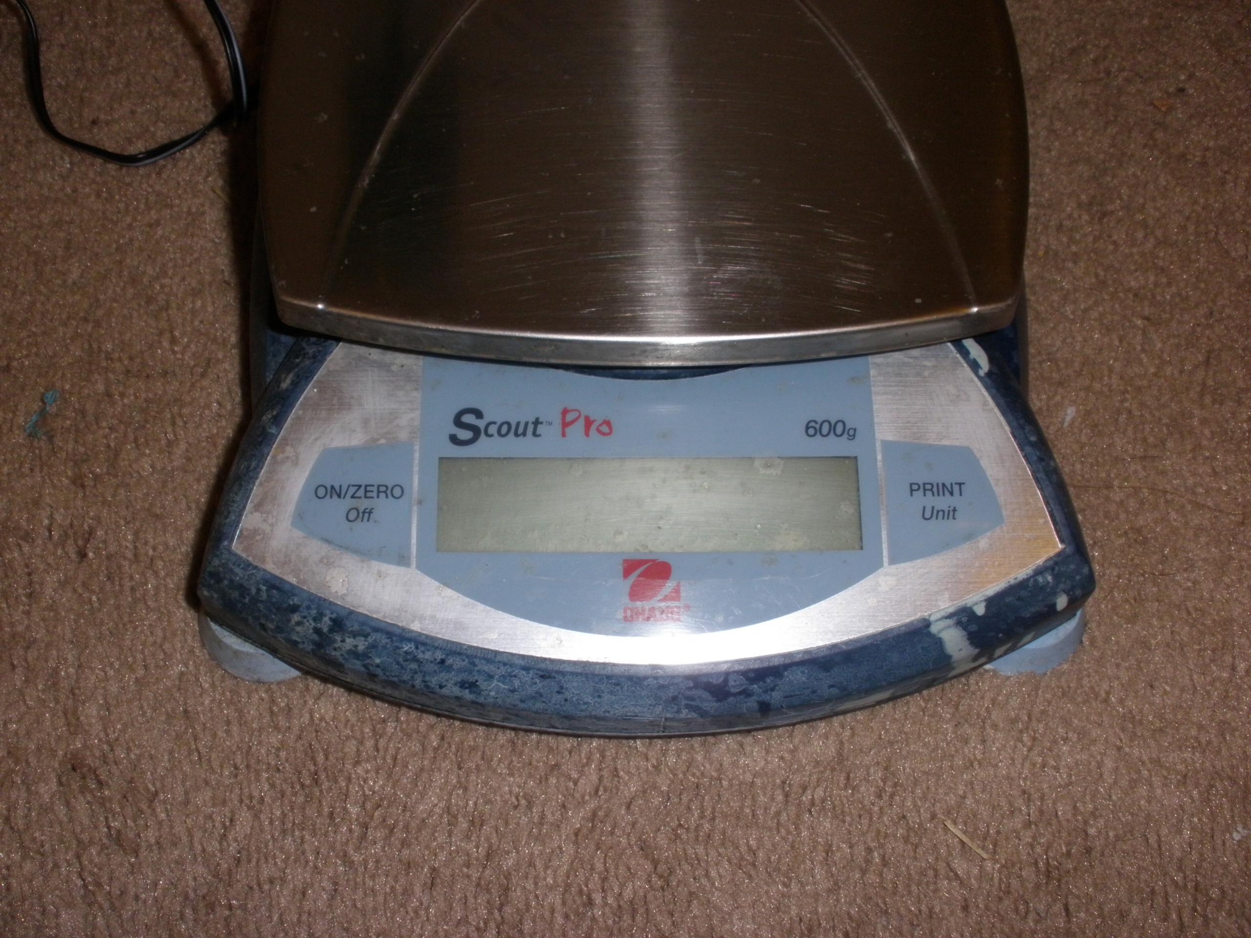

of course some more pics. this is the meter I have to use for the apllication, yes it is dirty, that is why we are one less employee at work. but, there it is and maybe useful info for others.
dead accurate, thats 300grams of machined copper and steal. not off a bit.3
stay tuned
