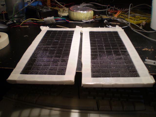

yes,I had considered using those at one time and had discovered that parts express had some larger rectangular ones.I'm not sure if they still do.
I think I'll try the same process I used before but instead of powder coating the screen,
I'll use one coat of etching primer and several coats of clear acrylic as a don't think I will have to have such a heavy build as i did the first time around.
Because you can only have a certain amount of bias per stator spacing.
Anymore than that they will just arc anyway and the excess paint will just close up the holes to much.
Also using a clear instead of a colored paint should give me better insulating factor than my first ones did.
As I was pushing the envelope of having to much bias voltage anyhow.
I'm going to make a small sample one first to test with my new bias supply and see were it leads me ,and to see how much paint thickness will be required. jer

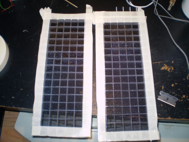

Got a little some thing done today. jer
Ger, great looking, how do they sound or are you still trying to find a larger amp?

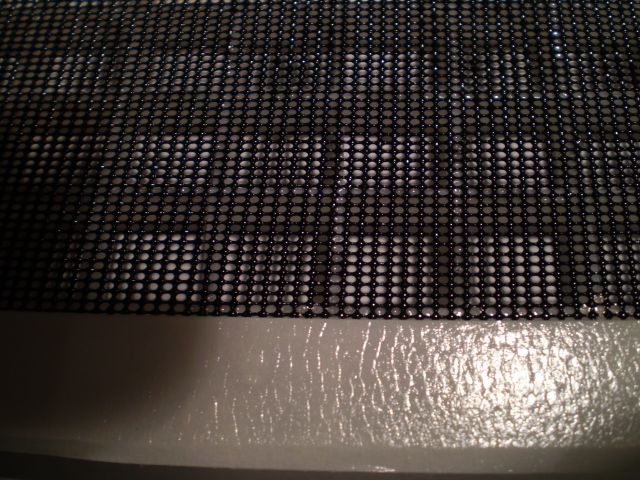

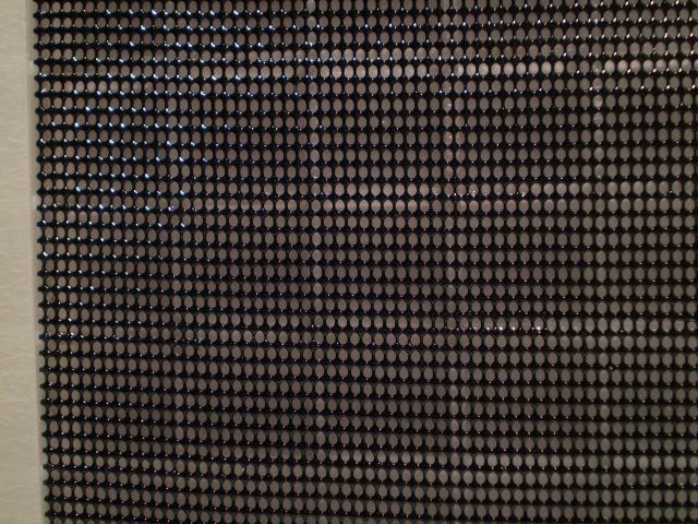

These are the best sounding and most efficient smaller size ones I have made so far.
Due to the powder coating I have a higher insullating factor and more open area.
I just sprayed them with 5 coats with 6 swipes each and both sides with clear acyrlic.
They seen much environmental abuse in the last seven years.
although they still worked there was one week spot on the stator that burned a pin hole in the diagphram before I finshed it off with heat gun.
It still played wih that big gapping hole in it, just a little rattley.
So I decided fresh'in them up a bit.
The d/s on these were .068" and I have some material that will get it down .054" or .0475" and .039",as this would gain some 2db to 4db more efficiency but the thinner d/s will limit the low end excursion.
Won't know how much until I try it.

The diagphram is only 3.375" wide but to wide to try some .06 mil mylar and .5 mil kapton that I have, as that material only 3"wide. jer

the last pic is perfect looking, same thing mine look like only mine are silver. still tossing around an idea of putting a small light behind the stats to show what it is and look at the charaterics of the diagpghram while playing, i had a " puck" light in mind.

mav, they are 9.75" x 3.25" active area,standered 18 x 13 per inch aluminium window screen and about .040" to .050" hole size. jer
