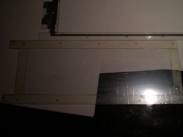

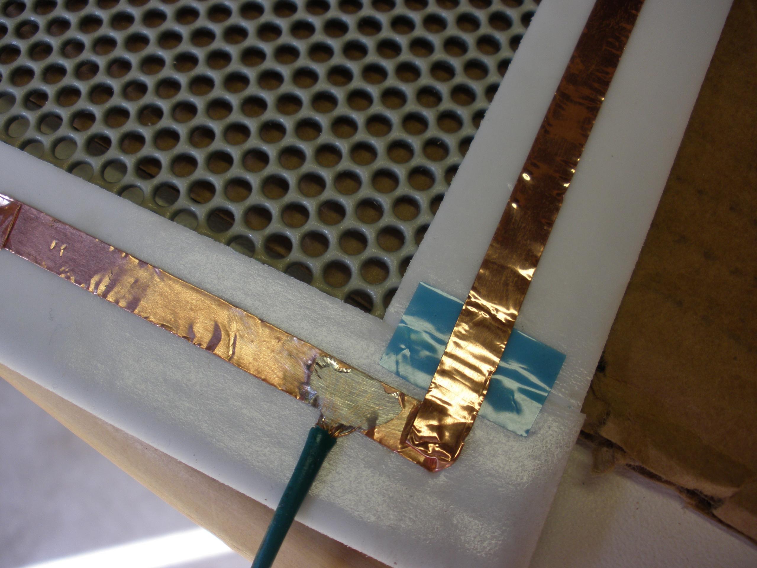

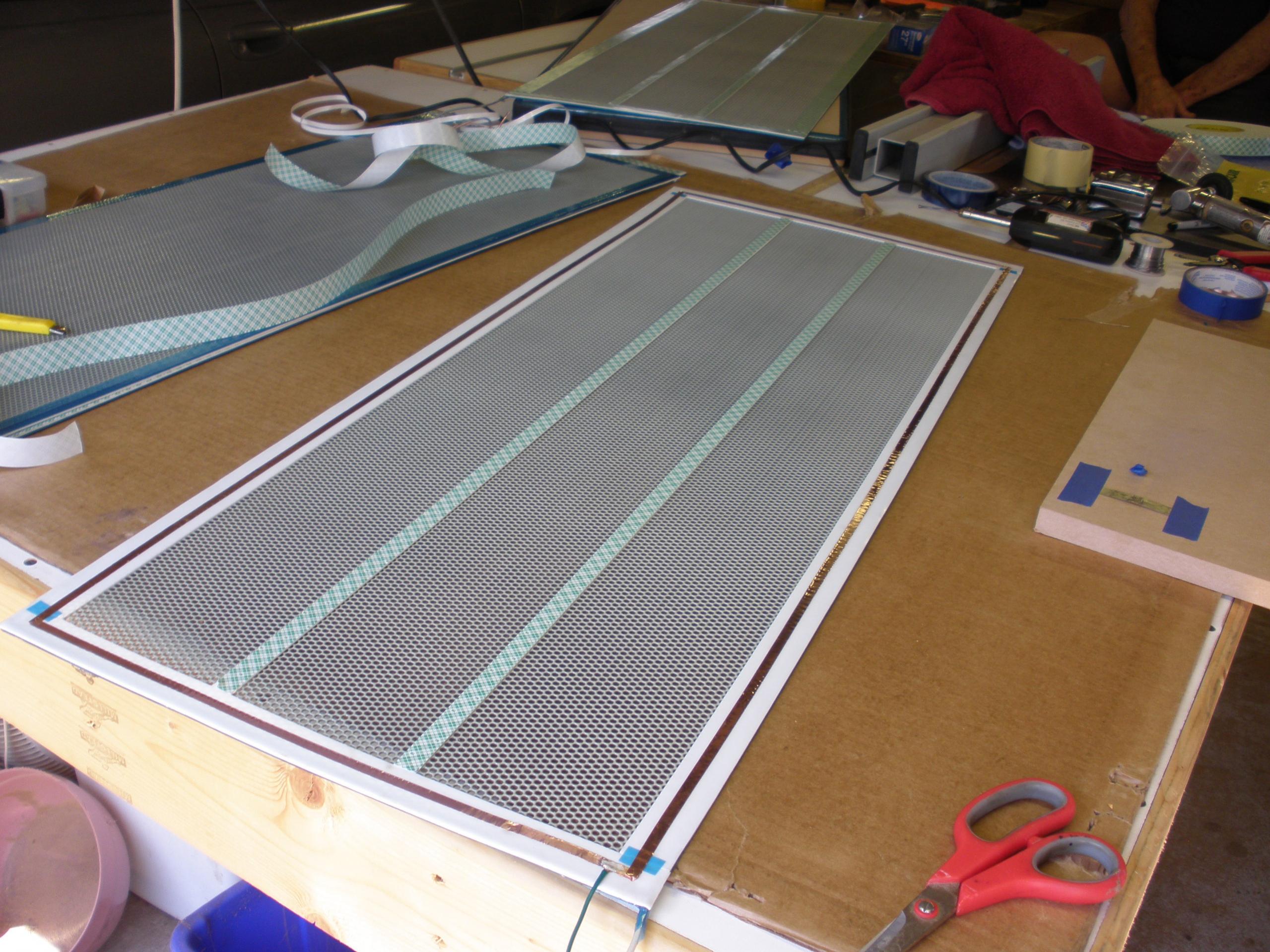

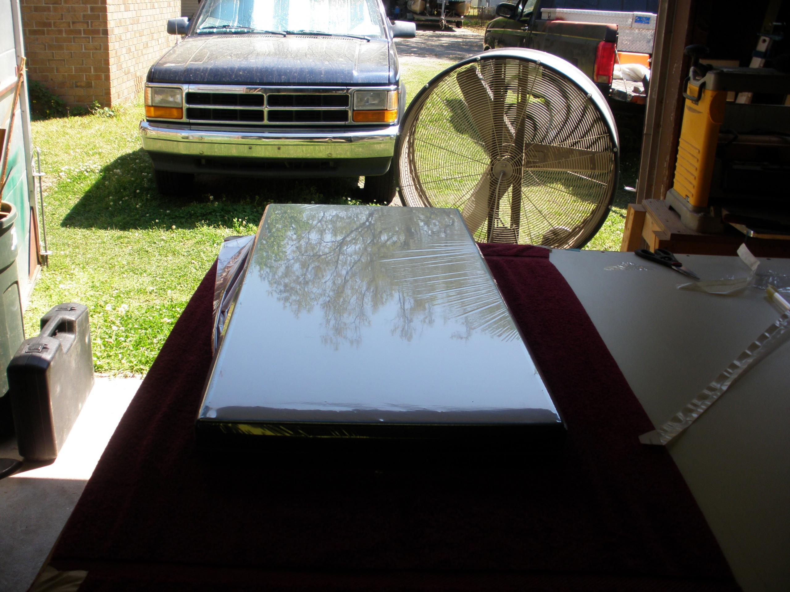

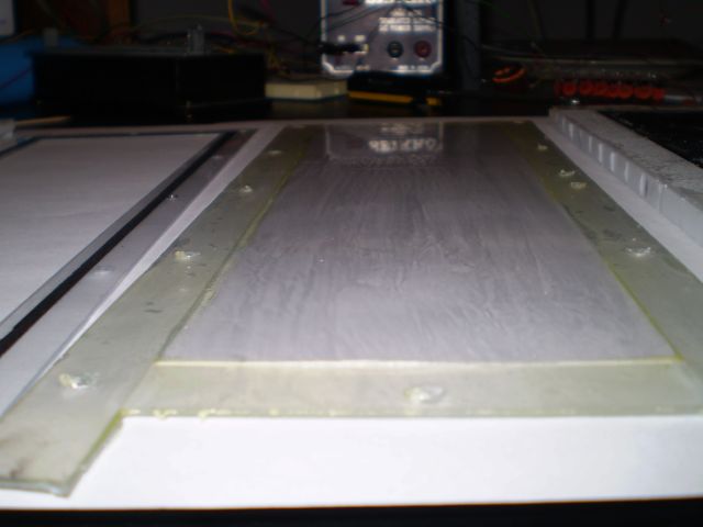

Got one little panel refurbished today. jer

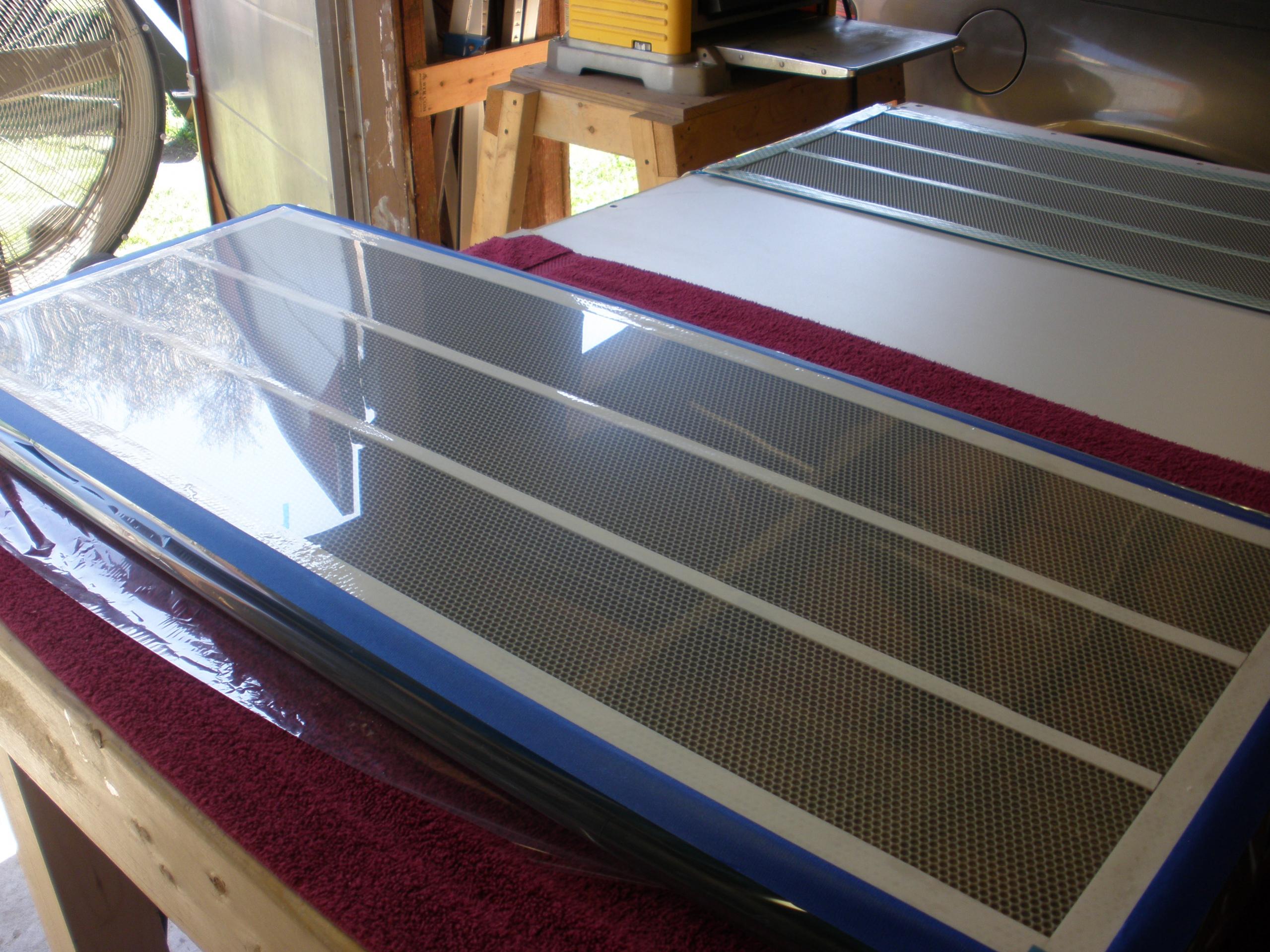

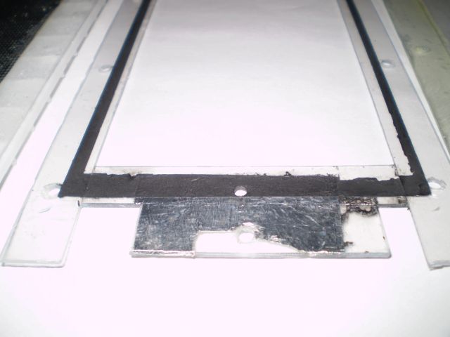

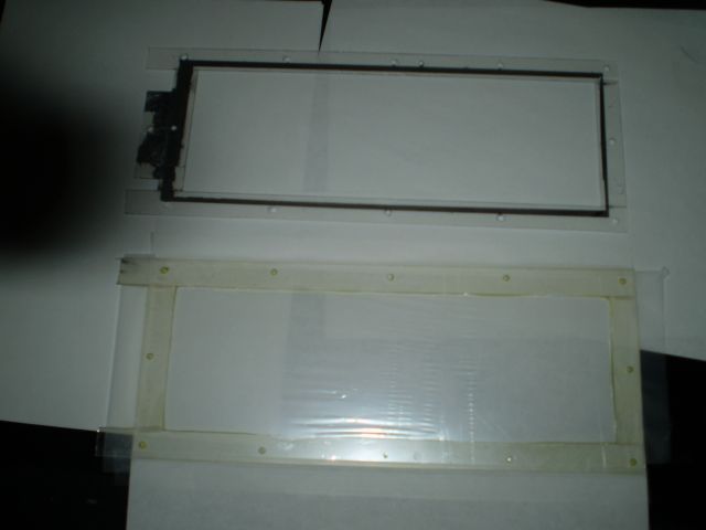

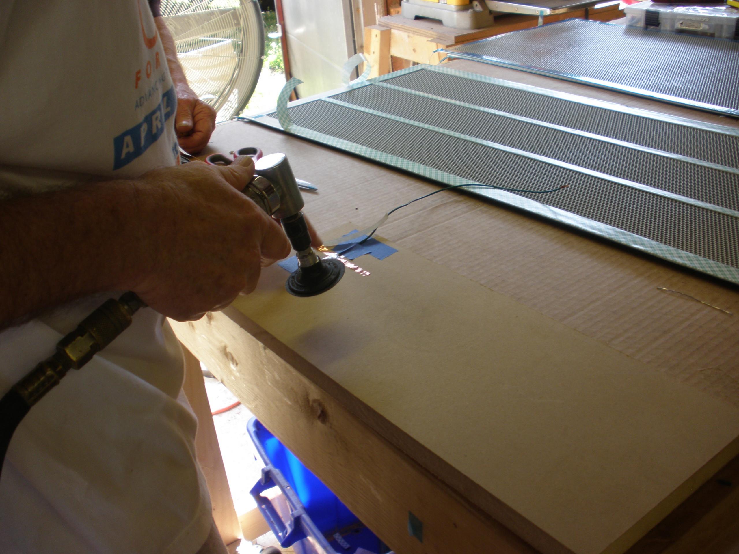

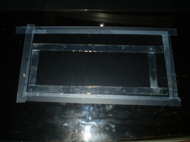

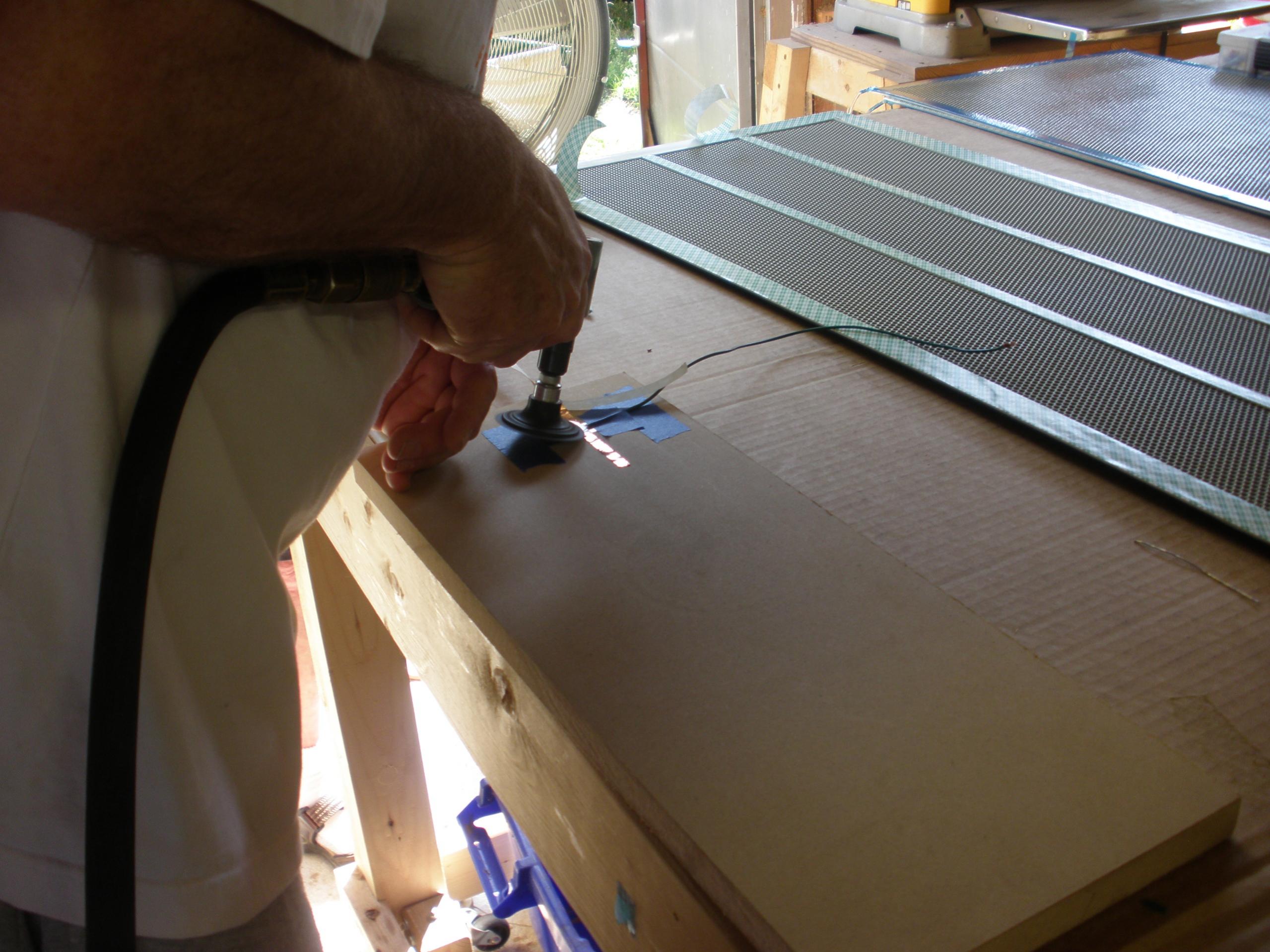

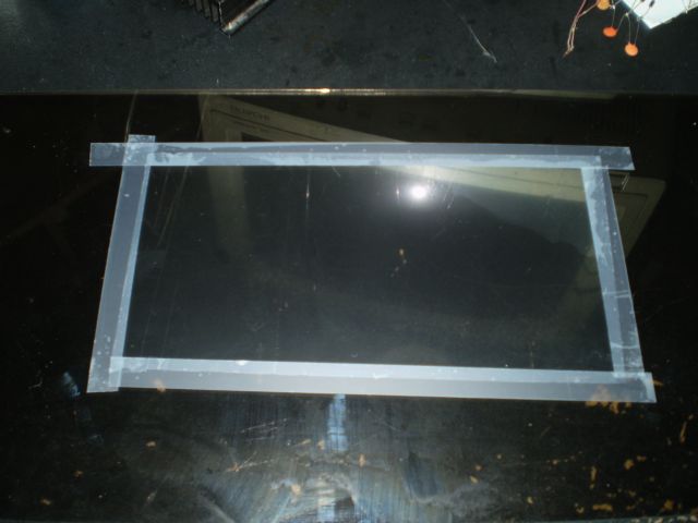

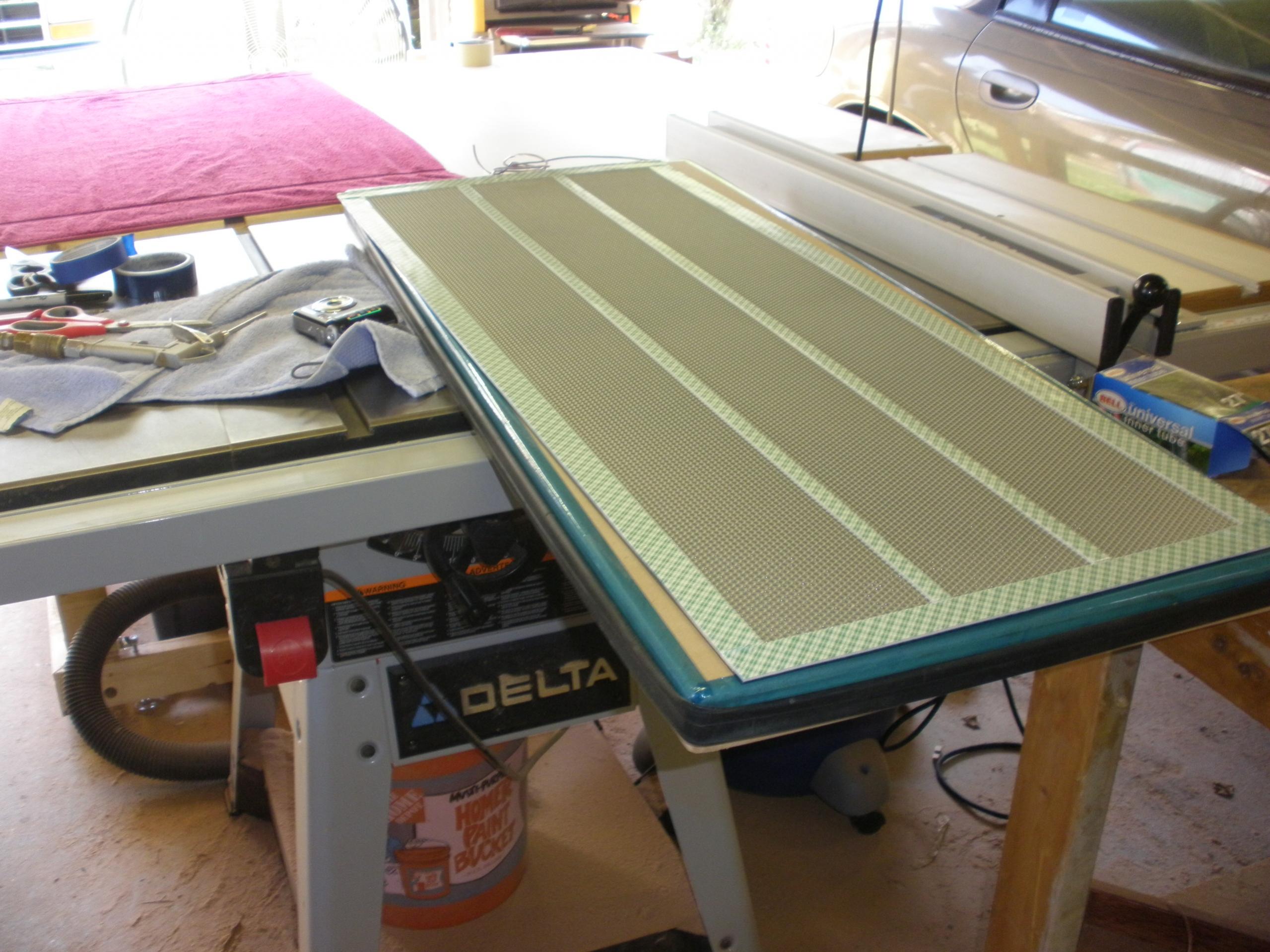

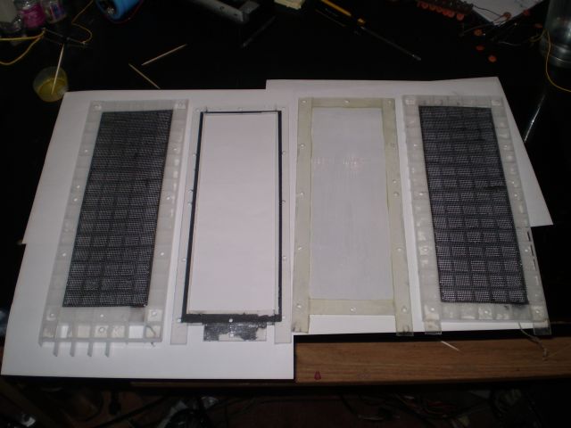

more pics, i have come to realize that the smallest thing is themost importnt, coating. it might look right or be perfect, however, there are some hick ups if you will a moment will pass with frusrtation only to find that something so small can take away your dreams of the perfect panels. Here are some more pics, i have not given up hope.
start ti finish, and yes, there was a problem, which can be fixed.
😱I have a long week ahead of me, i hope everyone learned something, i sure did. I wish i was a wealthy person, i am NOT, so going to la la land, hope everyone a great Easter! wish i could say the same.
I did anticipate some problems, but as mentioned, it can be repaired, just wanted it right the first time.

i guess i should have left the stat supports there, well, frustration can play havic when trying to diagnose the hick up.

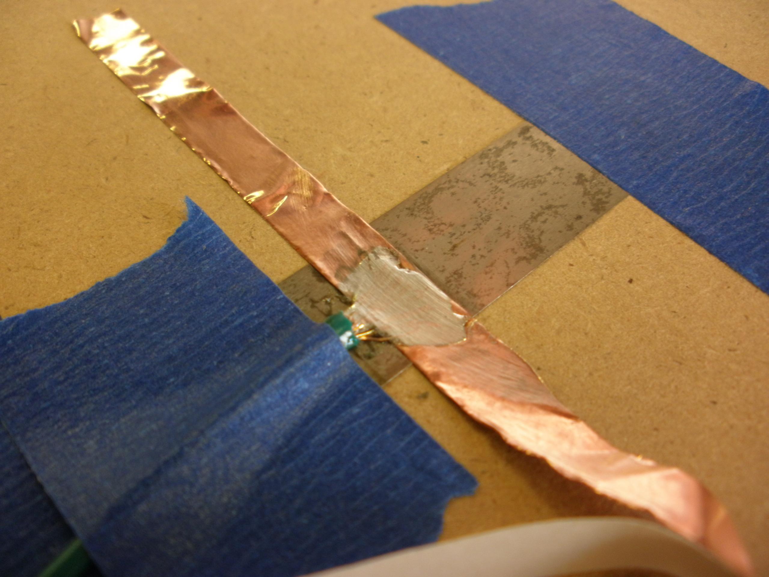

Spoke with GER, he agrees on the coating, Licron. someone let me know or CharlieM.,

try this, www.techspray.com/staticcontrol.htm .licornT is product number 1755-10. you want "licron crystal " product number 1756-8S .jer

😉 unfortunate things tend to happen for a reason to me. however, ordered a rebuild kit and Charlie ordered Licron coating, this will be interesting i must say and cannot wiat.
Does anyone have any input of the life of Licron? the panels will never be in contact with UV light, all windows in my house have been tinted with refective, 99% uv resistant. I am very unsure with dish sope, so Ger, i hope you nailed this one as you have allways done with all my questions. So from China, Michagan, Savannah, from everyone, even Australia, Germany, and i think Britain, so many thank you's.
the licron cost around 40 USD, for an aresol can which should be plenty to do the rebuild.
I am very fortunate that Charlie found some more .0006 film, enough for both stats, hoo raw! He has is own life and is taking the time to help a complete stranger build these, its so hard to accept and he will not take any kind of payment for his talent or work that he has done for me. I reaaly want to share that here, i am 32 going on 33 years of age, never in my life have EVER had any person or persons help on anything custom in my life.

Mavric,This is my report on licron http://www.diyaudio.com/forums/planars-exotics/109789-esl-diaphragm-coating-7.html post#350.jer
