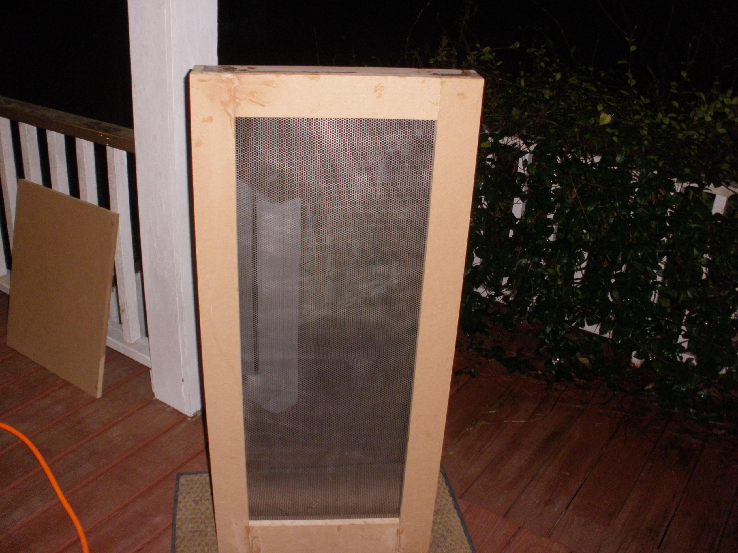

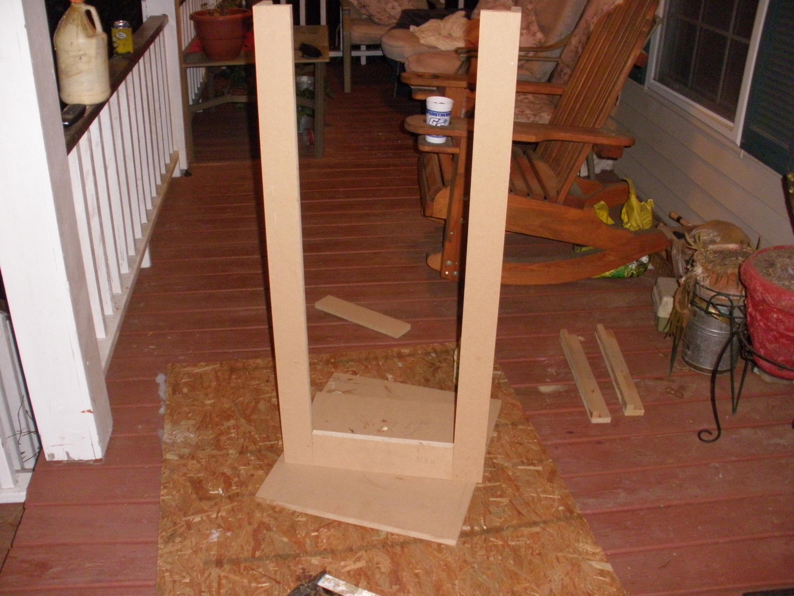

bringing the router home today!! TL will built this evening. Stat panels will come along as well, i will post pics.

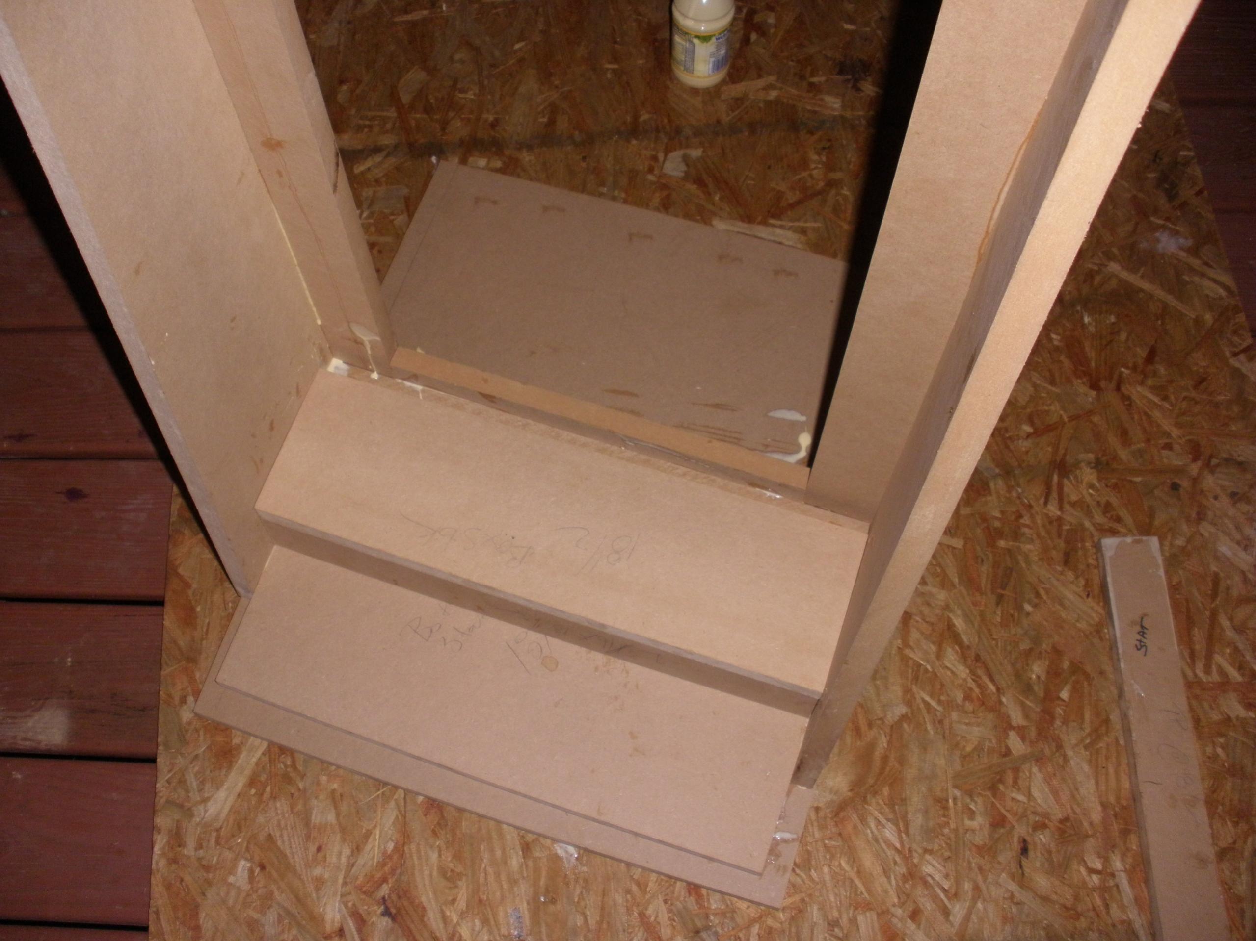

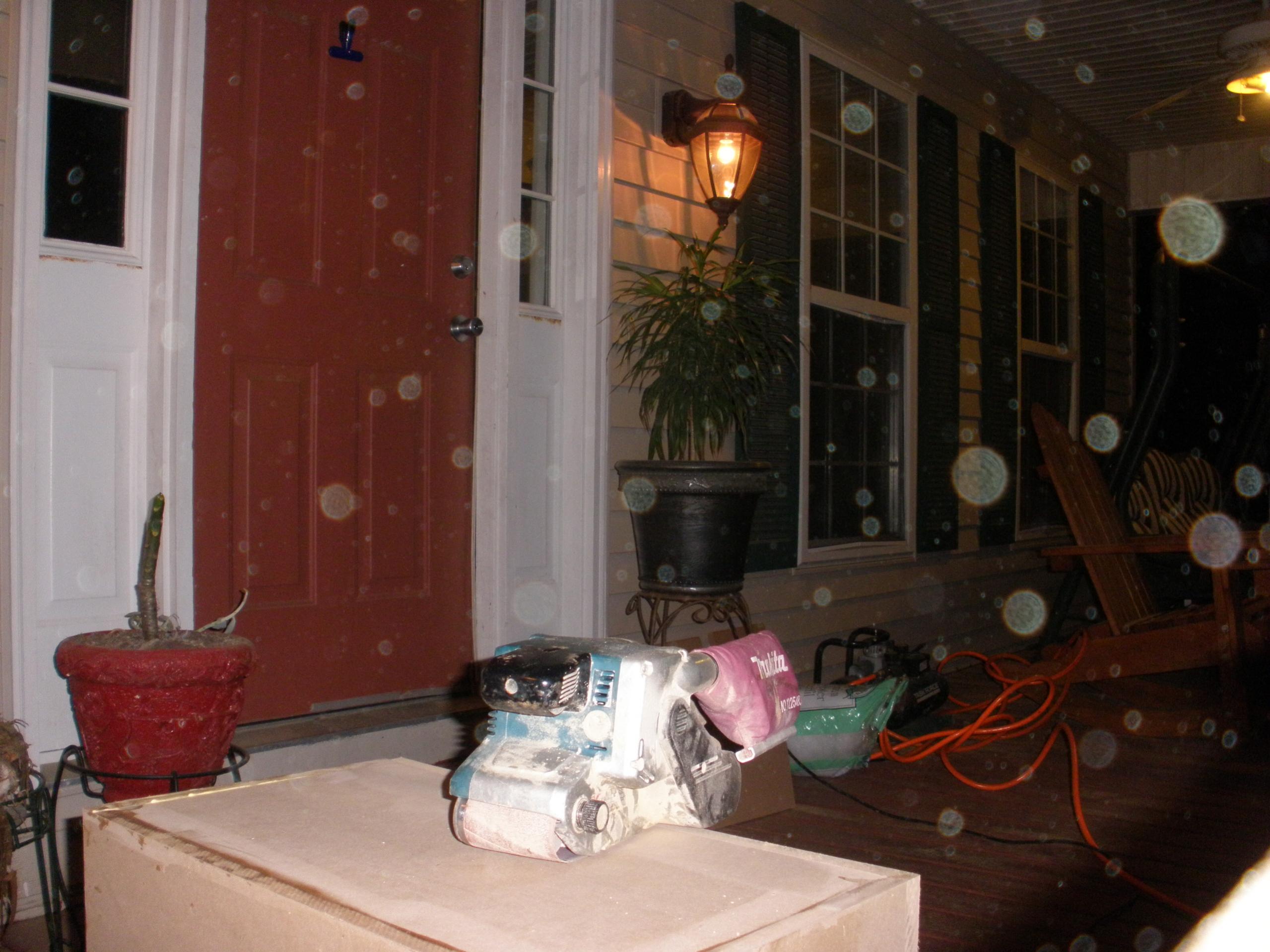

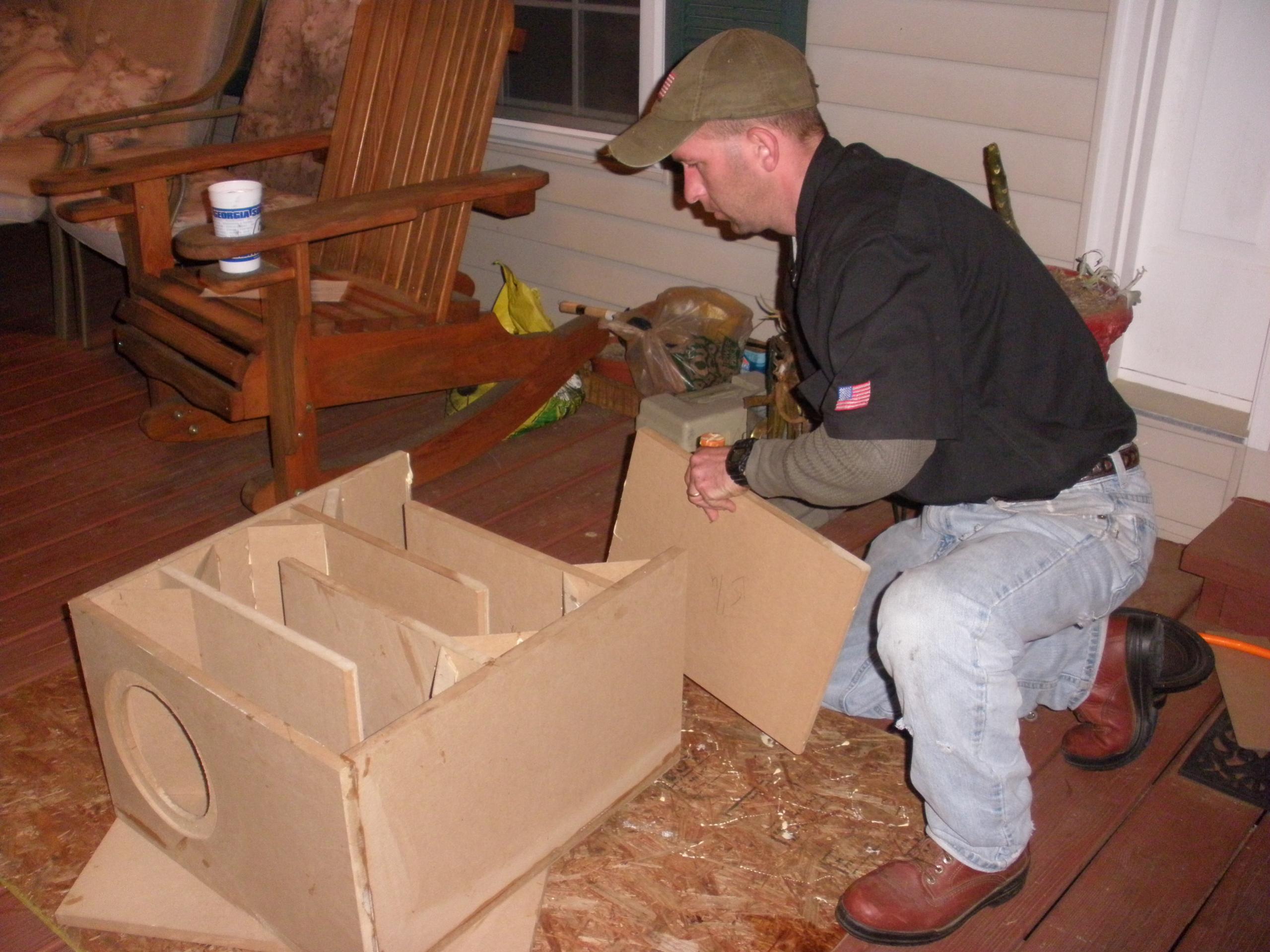

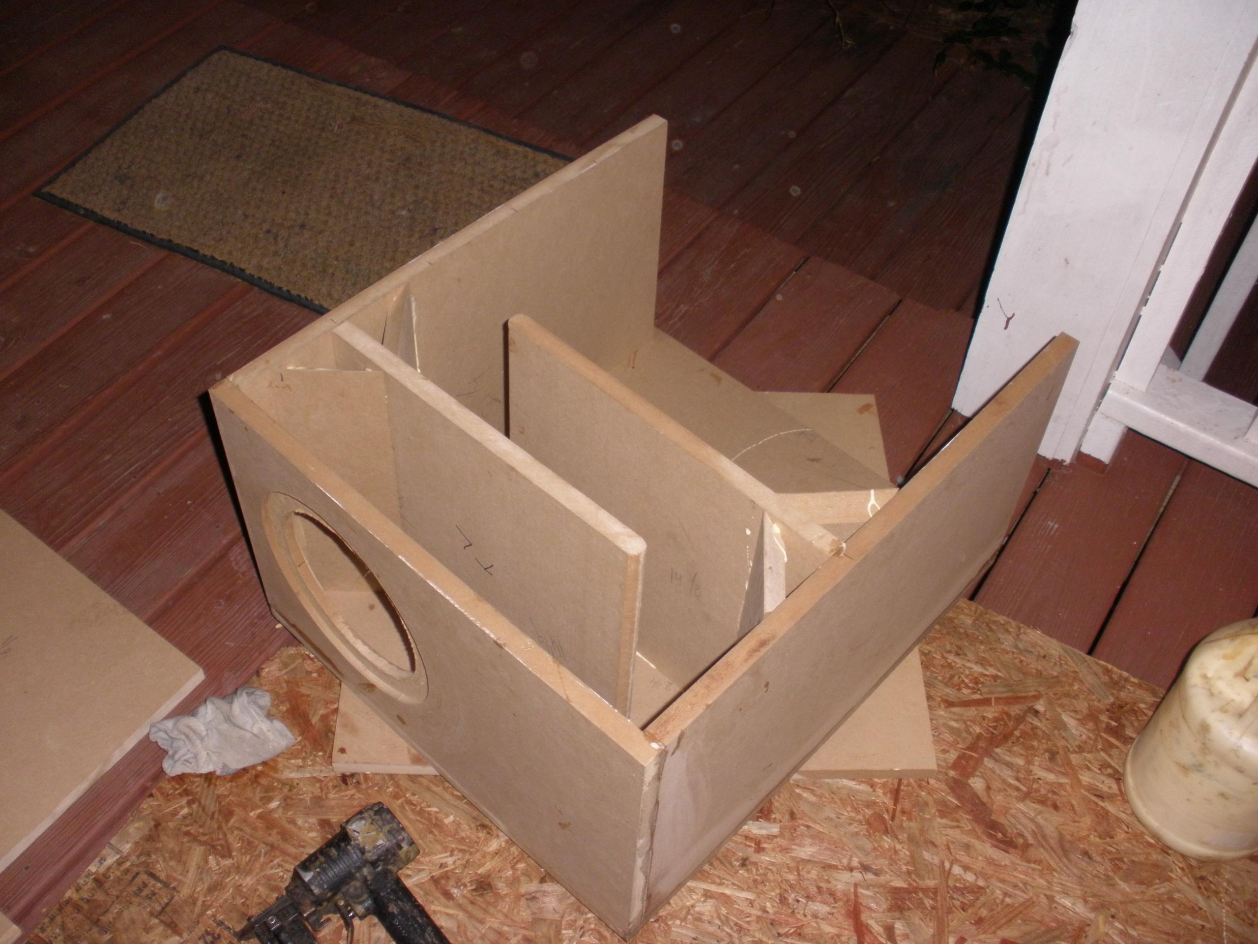

here are some more pics, went ahead and got everything else, nail gun, glue, belt sander, forgot jig saw for terminal cup. check it out
again? some more pics as request per member. something has a bad hick up, having a hard time posting pics.

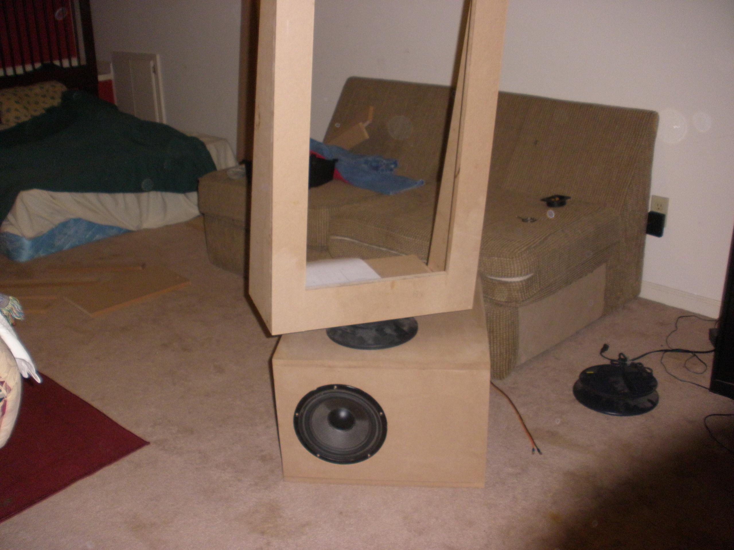

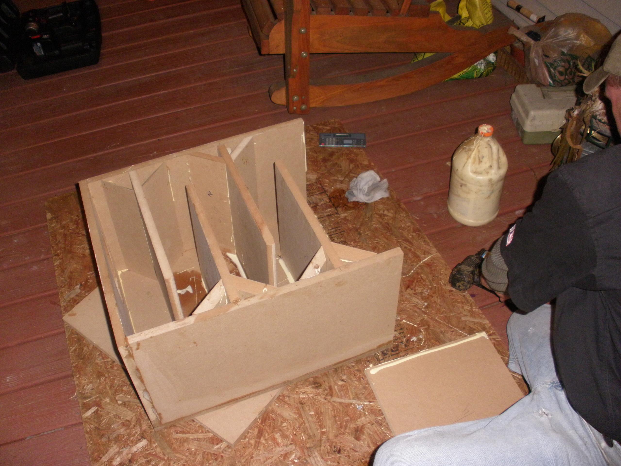

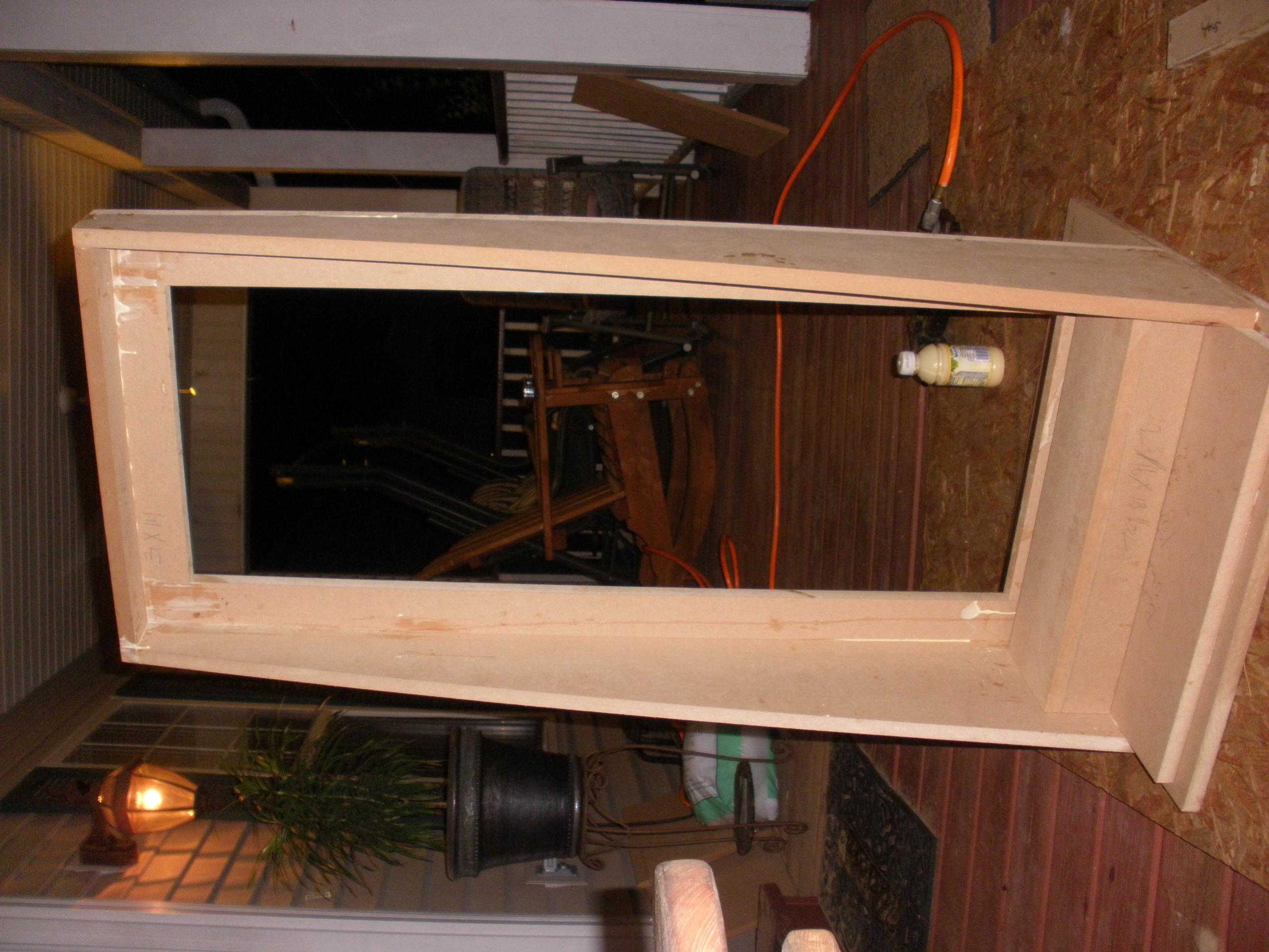

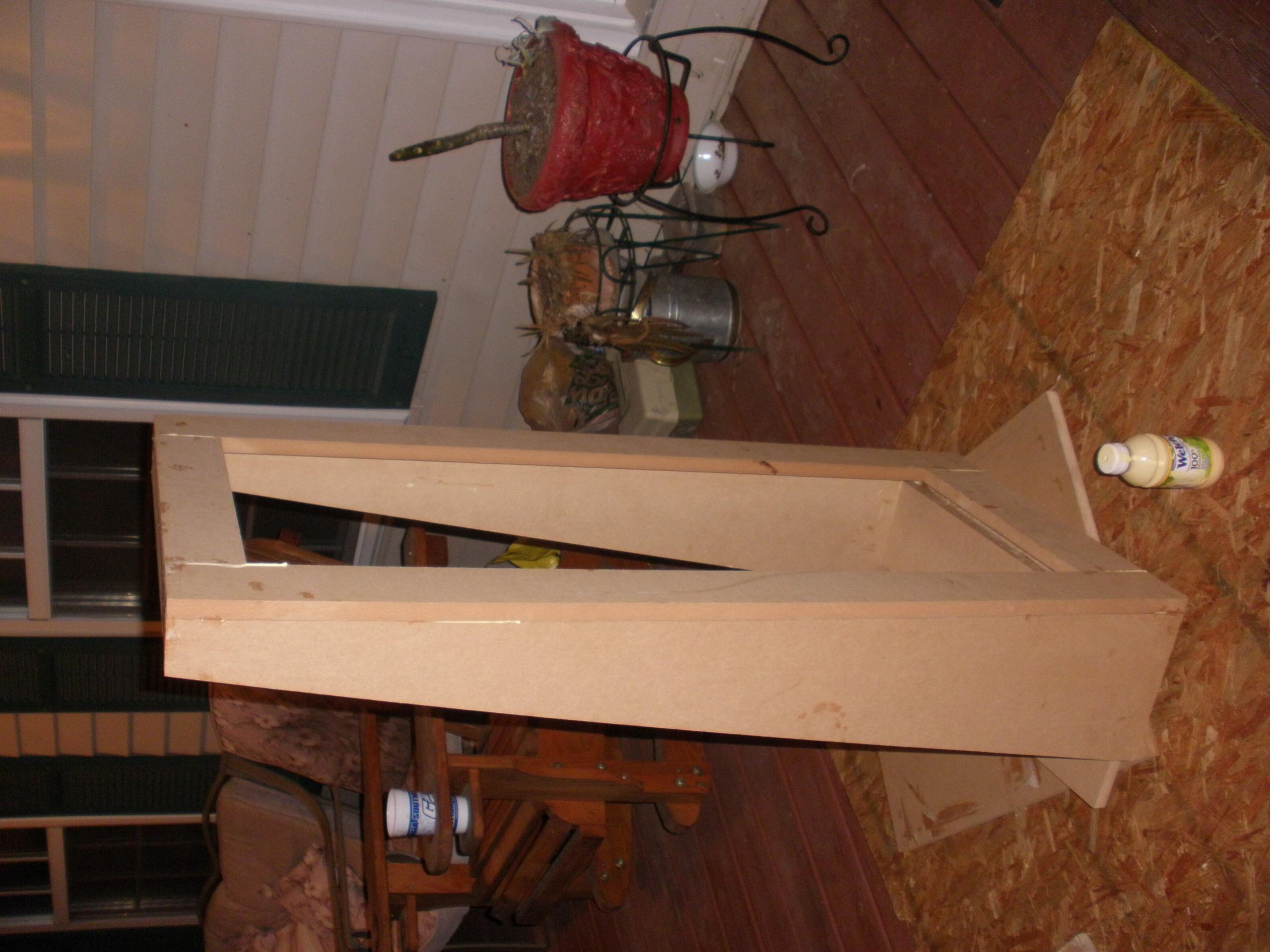

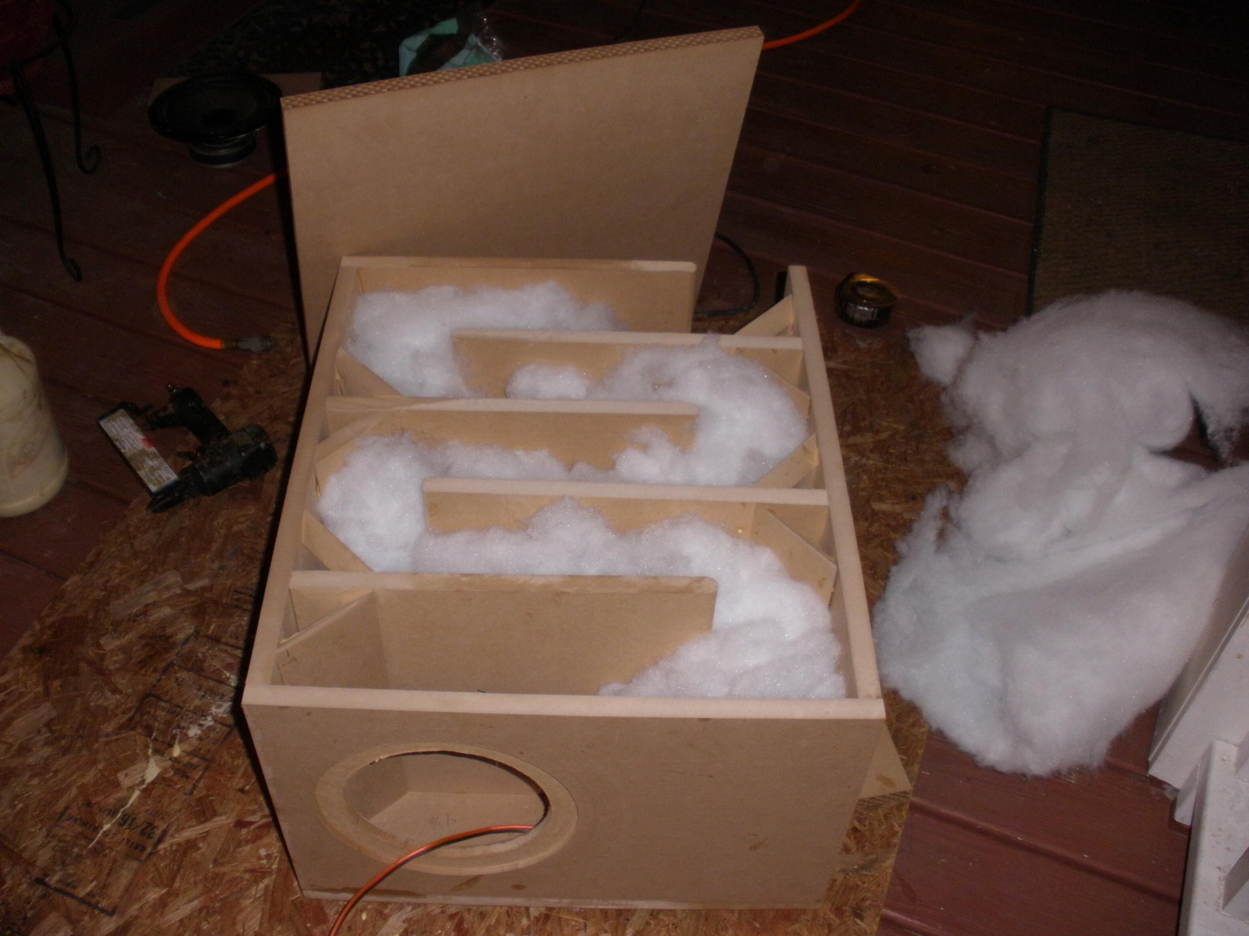

i think it going to rain today, but here are some more pics. I am not going to router the out side untill i finish the stat housing, since it will me mounted on top, i do not think it would like right. one down, three to go.

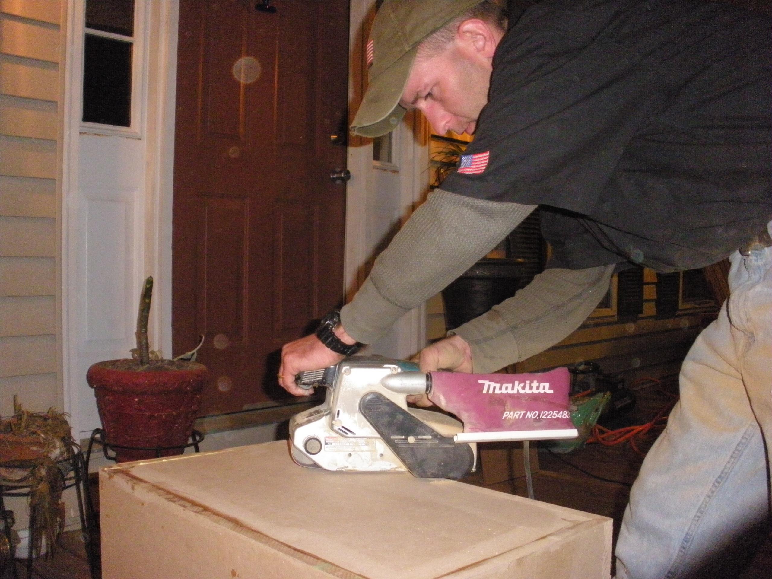

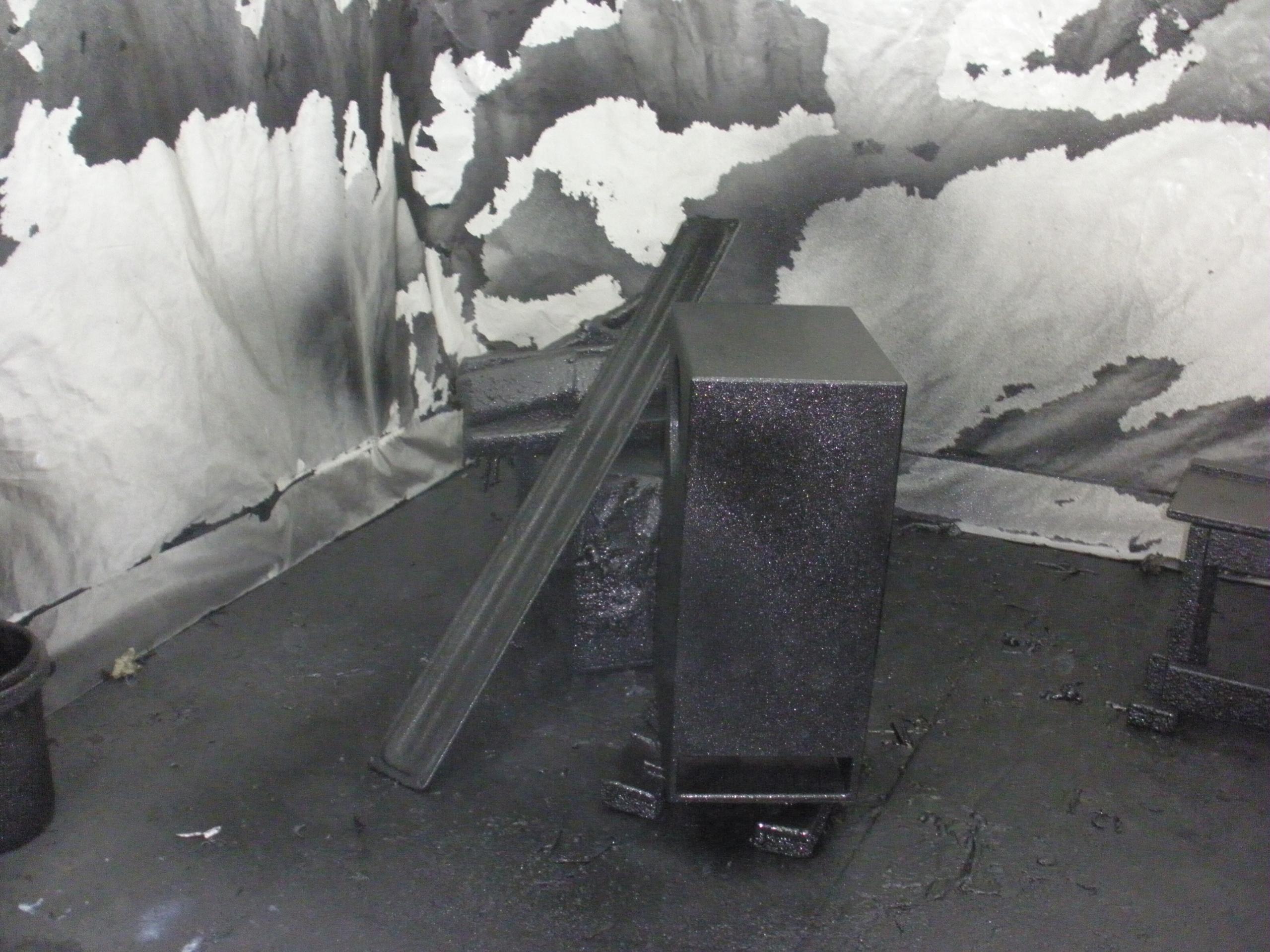

another build, ran out of belt sand paper, so they are just what you see, fantastic i think. I agrre with Charlie on everything but now this, these will weigh around 200lbs, and will have to carry them to work for rhino lining, fun?? as a drive a coupe. fun.

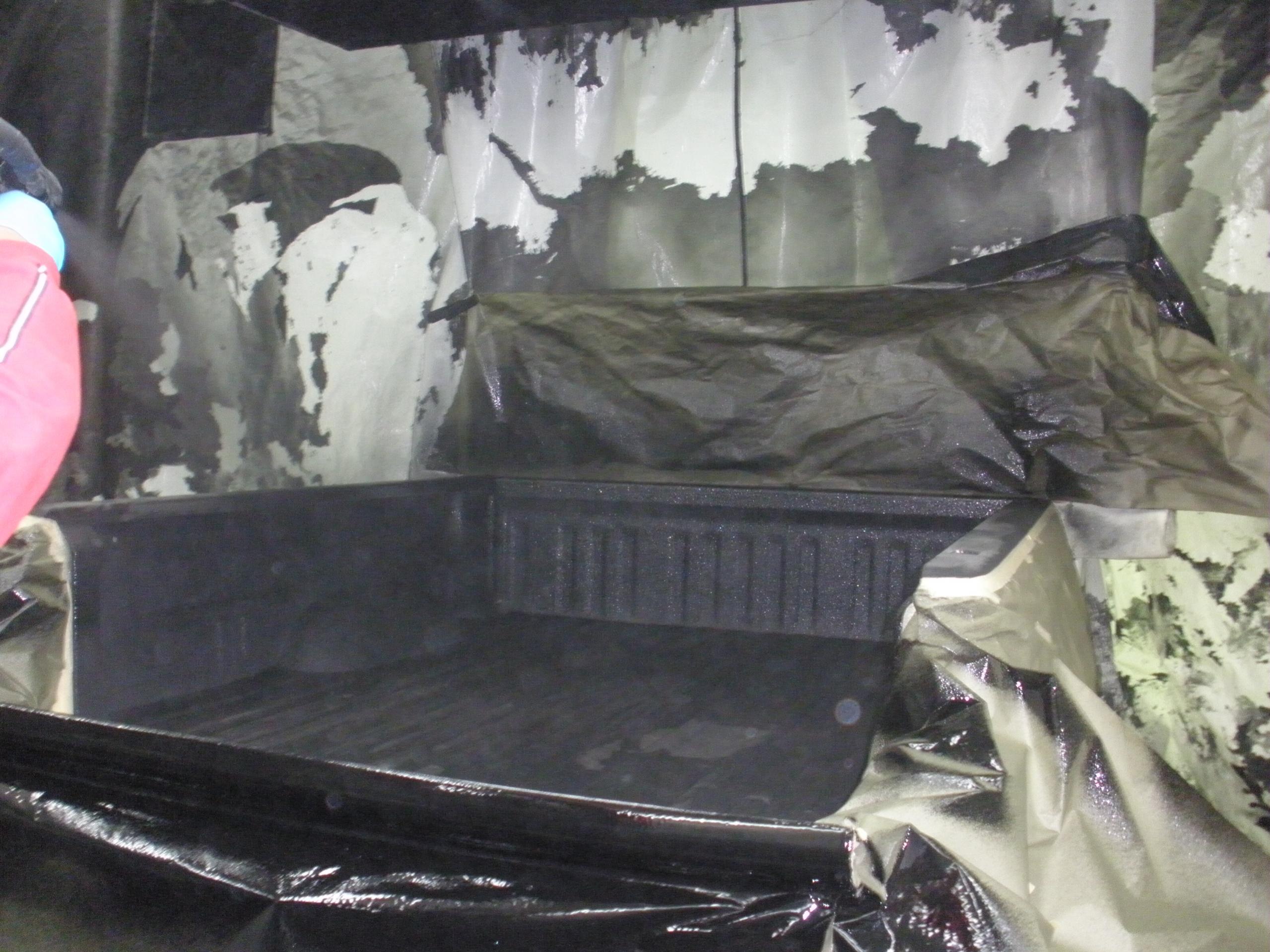

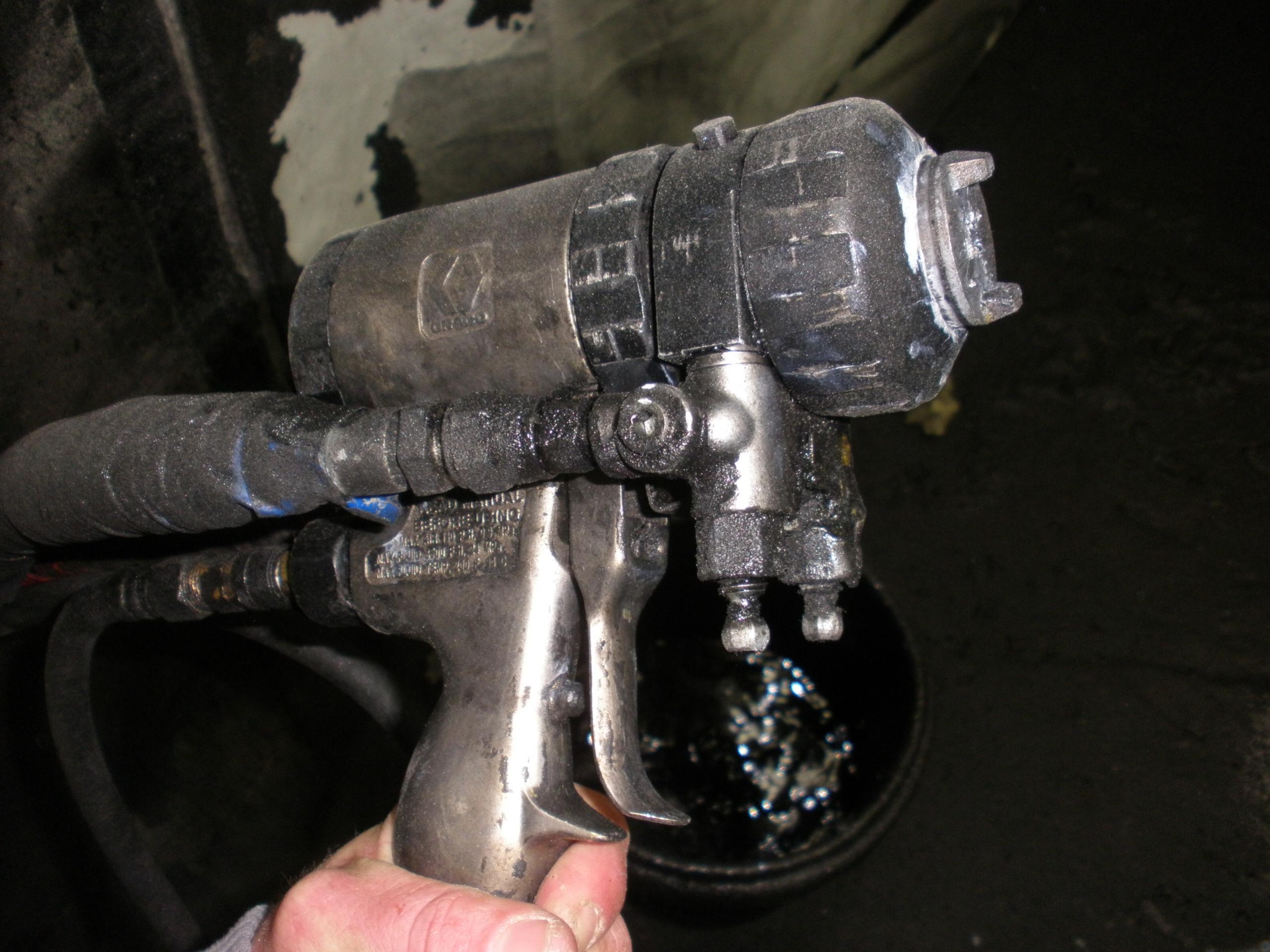

The next post is a quick shot of the rhino spraying and gun, yes it is messy, but we have something that makes it look new.

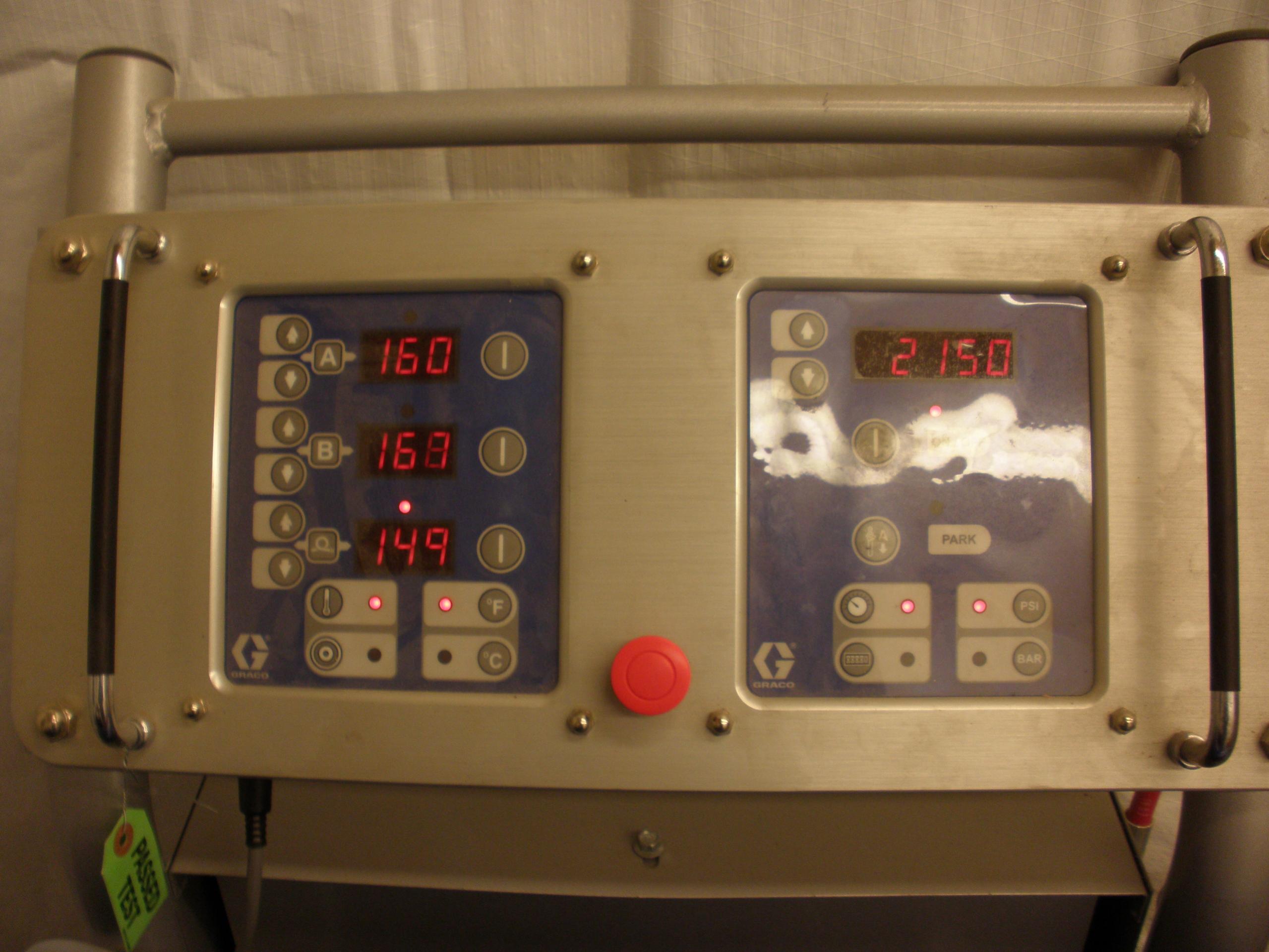

a little idea of rhino, i am wearing a HAZMAT suit, my boss is very brave. You can see the pressure gauge as well as three temps, those contol the temp of the entire length of the hose from machine to gun, around 50', its pretty neat.
allso tried a pics of the shiny part on the box, allmost mirror.
I guess i will do some more tomorrow, any thoughts or suggestion are welcome. Mavric

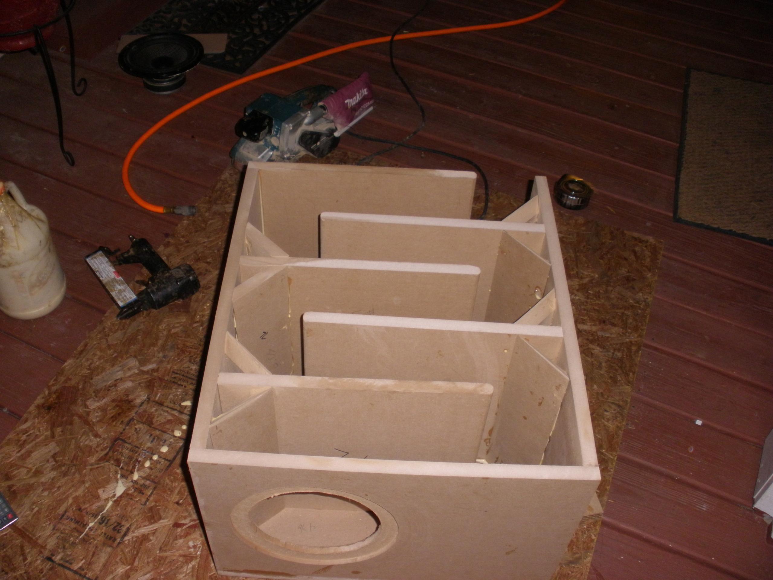

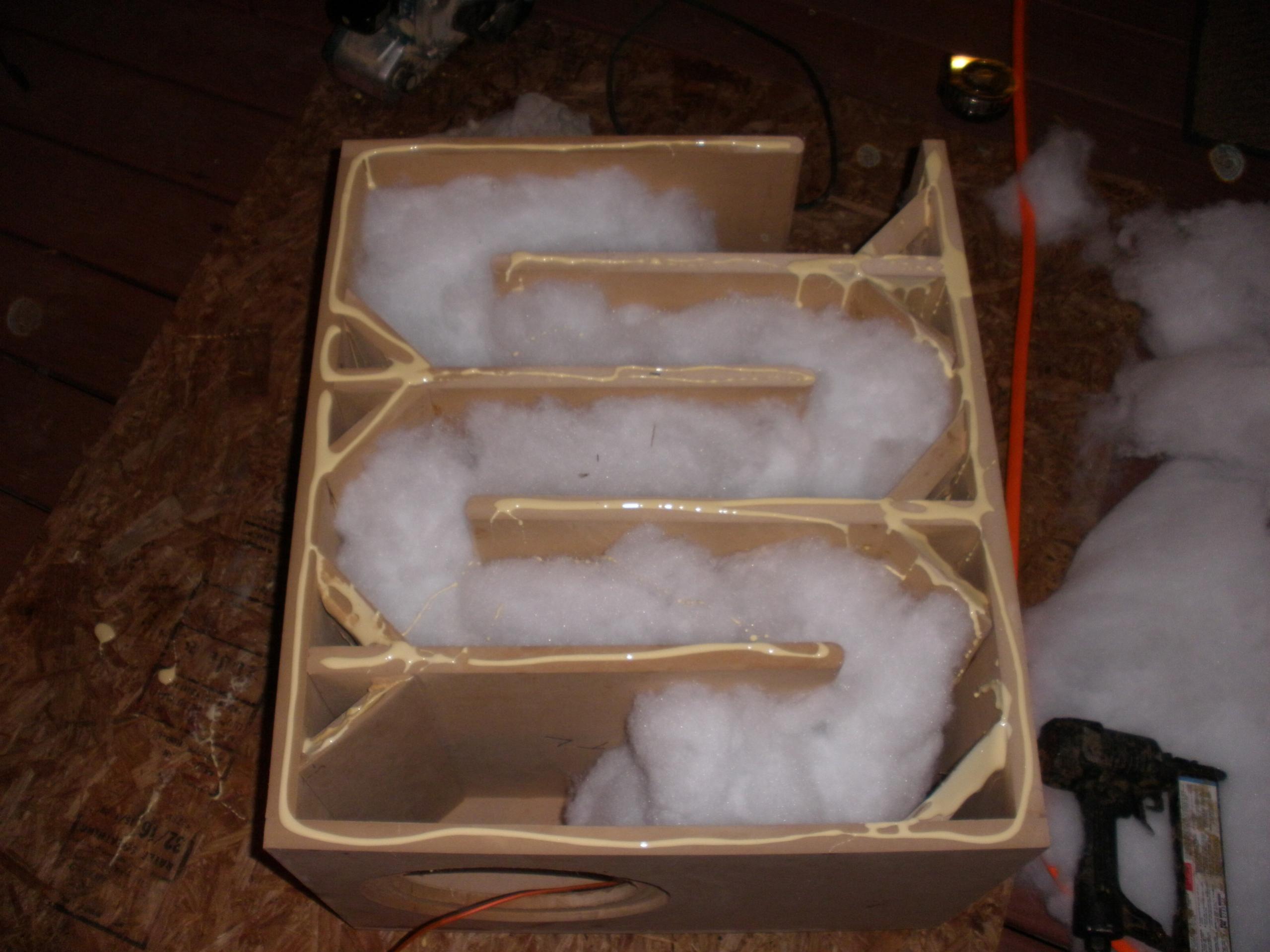

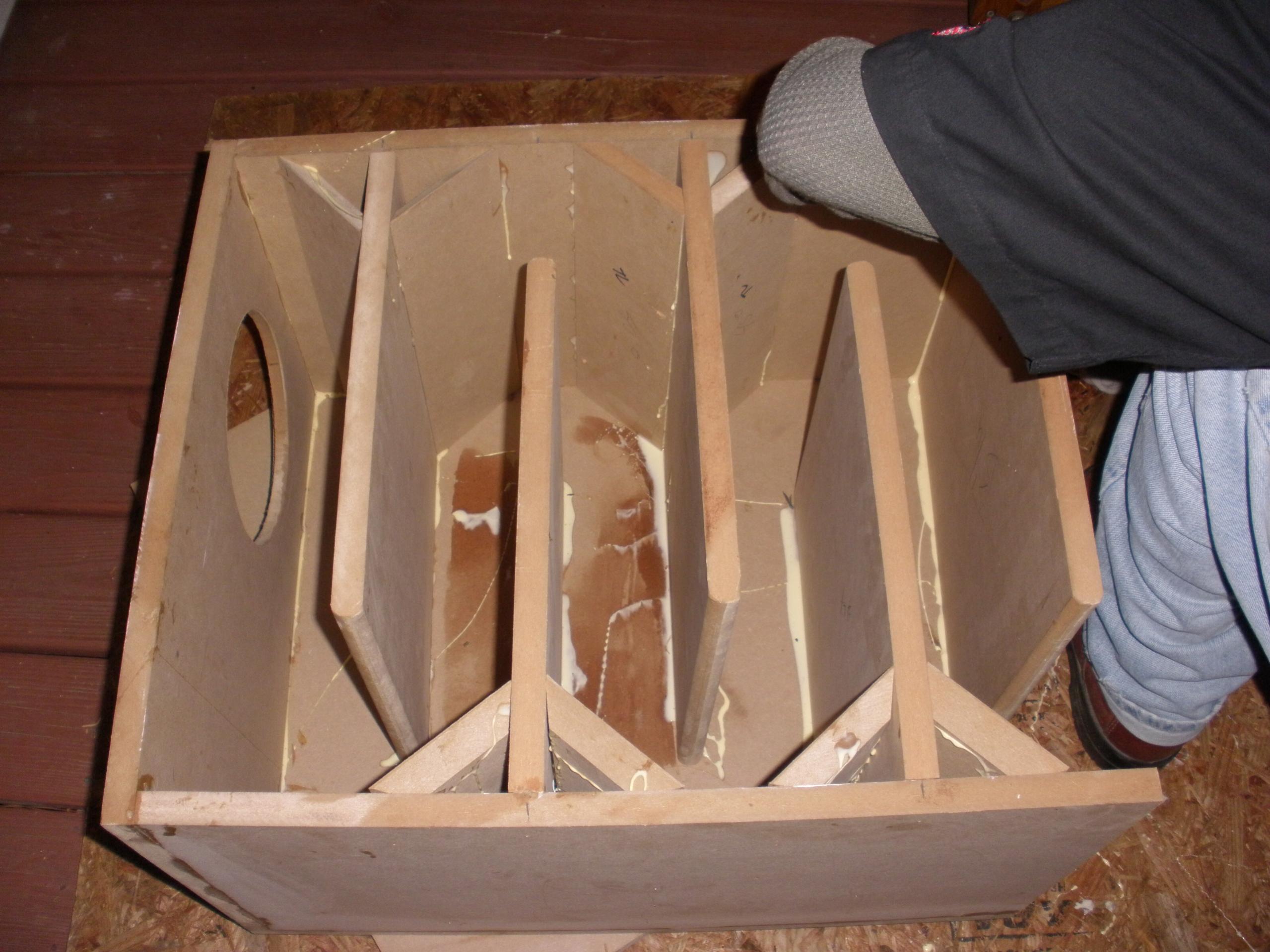

not impressed at all with the TL. tried it last night. it will deliver a low bass note, but no mid bass what so ever. I like rock, heavy metal, what ever..no rap period.
the stats are so much easier to build, so, those will be be primarry.
as i said, thats why i want it to be removed if needed, or use something to place the stats in a way to focus the sweet spot.
the TL has a few issues.
>low bass at or around 20hz is mind blowing
>mid bass at or around 250hz is not realy present, there is no "snap" or " punch" that i am looking for.
>this was tested using a sound sweep, i can play single notes as well as multiple notes for a given time.
>I do not have the electronics to display a graph, so i go by ear.
> i played Beethoven, syphony#9 i believe. at low and high power sounded awful, untill a really low note was played. so i turned the TL around with the port facing me and the driver in the corner, fantastic.
> however, i was using my cross over and sweeping from time to time, but it just does not sound right, given i have no data on my divers as they are old and i am trying to use what i have.

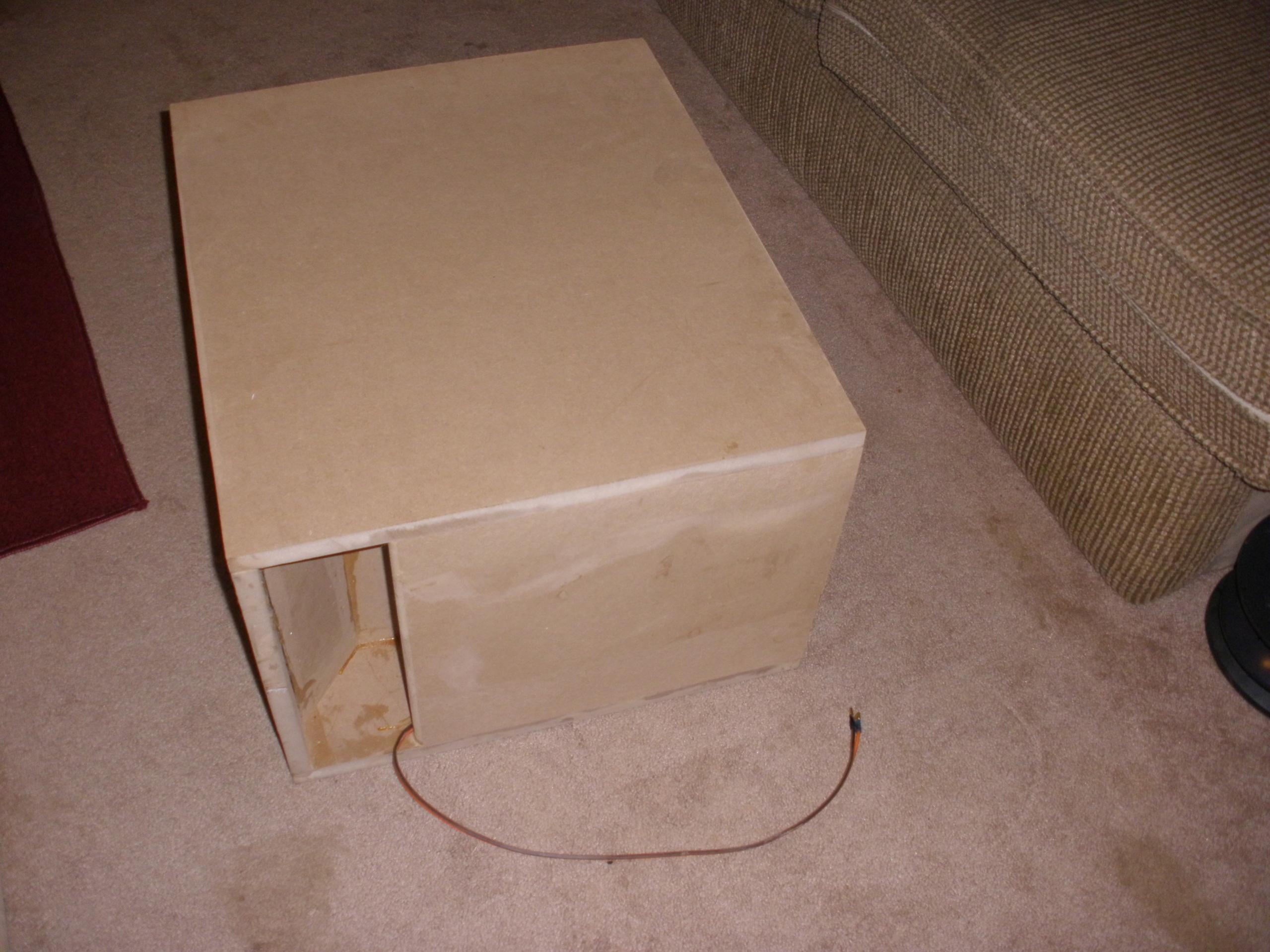

as the stats need to be near or about ear level, i will use the bad one as a stand and put two drivers in the other using a folded horn design, (parts express had the knock down kit), i purchased it, and does exactly what i wan"t, i am ditching the 5 1/4" driver(s) and using the same box volume for my 8" .

> as far as the TL, Mav has another sheet of MDF to work with, or, if someone has advice on altering the other i have not built yet. (Steve ,Liqudsonic) if you catch this delema, what would you do?

The crossover that you are using is an active 24db per octave filter which means you will hear next to nothing above the selected frequency.
Very much diffirent than the 3db,6db or even 12db passive crossovers that you are used too.
There is not alot of sound characture below 200hz .
If you sweep it backup to 500hz to 1000hz or more it will magicaly re-appear, poof sha zam! jer
