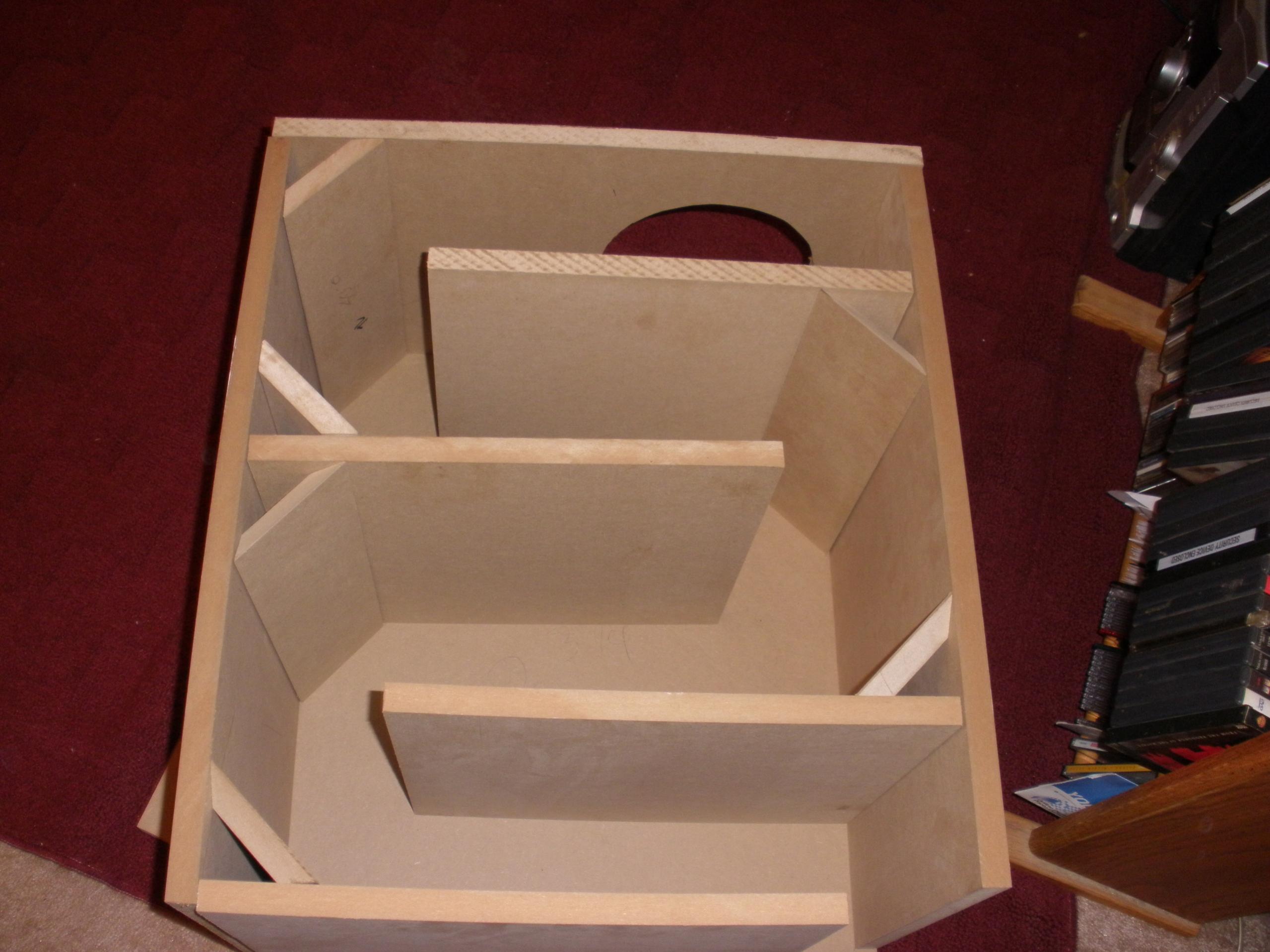

yes i do get some vent noise,but only at extreme excursions and is not too noticable.
when i built them i was shootin for .75 cu ft but screwed up the dimensions of the side panels and that cost me some volume for the port volume.the inside volume is .679 cu ft and with the speaker and port it is some where between .60 to .65 cu ft.
that drasticaly changed my port length for my target frequency of 28hz to 30hz as i wanted a 3" port diameter.so then the next best was 2.5" pvc as i couldn't find any 3.5" or 3" pvc.then i discovered that a pringles chip can was the perfect diameter but was too short by about 2 to 3 inches.
This being a sub for my 1984 f-body car, it had to be sturdy and cobbling very thin walled cardboard tube with tape was out of the question.so then, i also could not find any thin wall 2.5" pvc,so this cost me a .5" in diameter.which is quite significant as you know.
so my port ended up 2" diameter and 13.5" in length for my target of 29.5 hz or there abouts. it was the first sub i have ever delt with and i am very amazed at the extreme lows and never expected so much performance out of a 8" speaker. jer

please take a closer look at this TL, notice the distance between the vent, or shelf board spacing, from smaller to larger as the chamber lenghthens, \ \
>14"
>14.125"
>14.250"
>14.375"
a little asymetric, howver, it will load up the diver in a small enclosure and unload progressive to the end. Tuning is aprox, 32-35hz @ vent. not including that these enclosres will be "corner loaded" back firing against the corner in the living room. thats why i like this as well
i can allways cut off a little of the back to raise tuning to compensate for corner loading the enclosure. as well as the TL being removable, one sub may work fine, on the other hand, two may perfect being bi-amp,

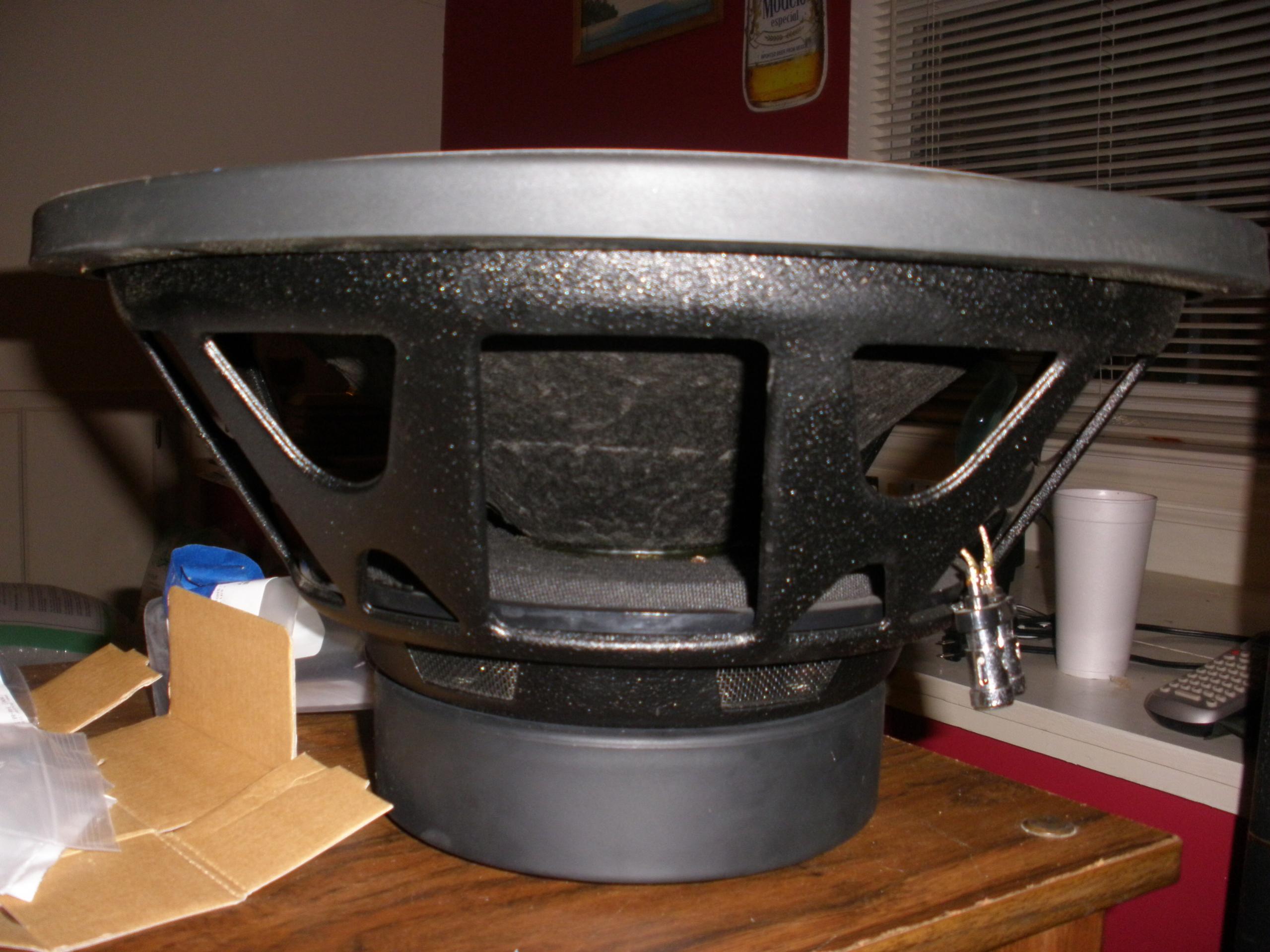

posting pics of the sub/mid- bass driver later, very low Q' , listen in for more new pics, gotta work.

Hi Mav
Quick question before I post something you might want to consider, is that TL box glued up yet?

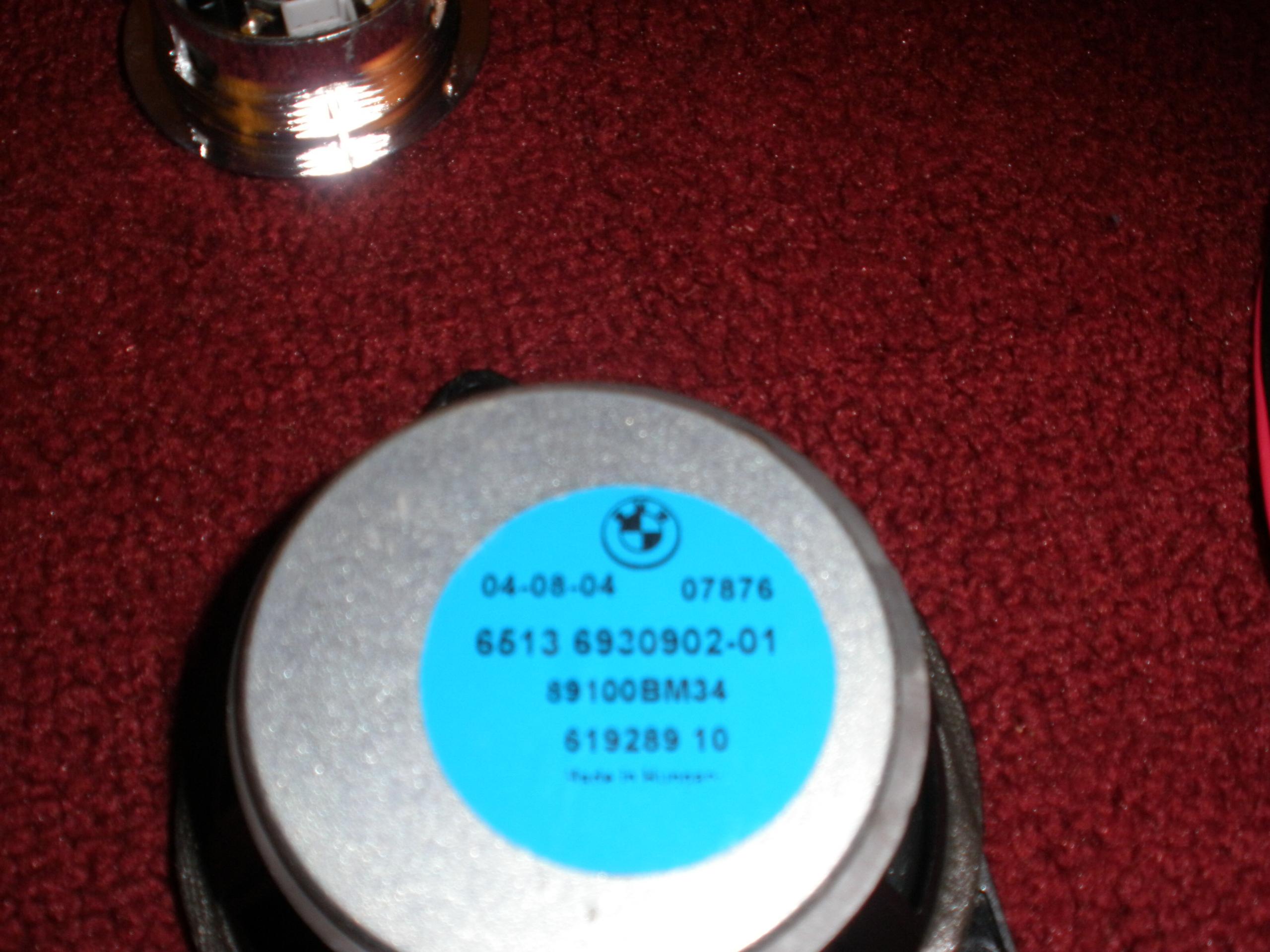

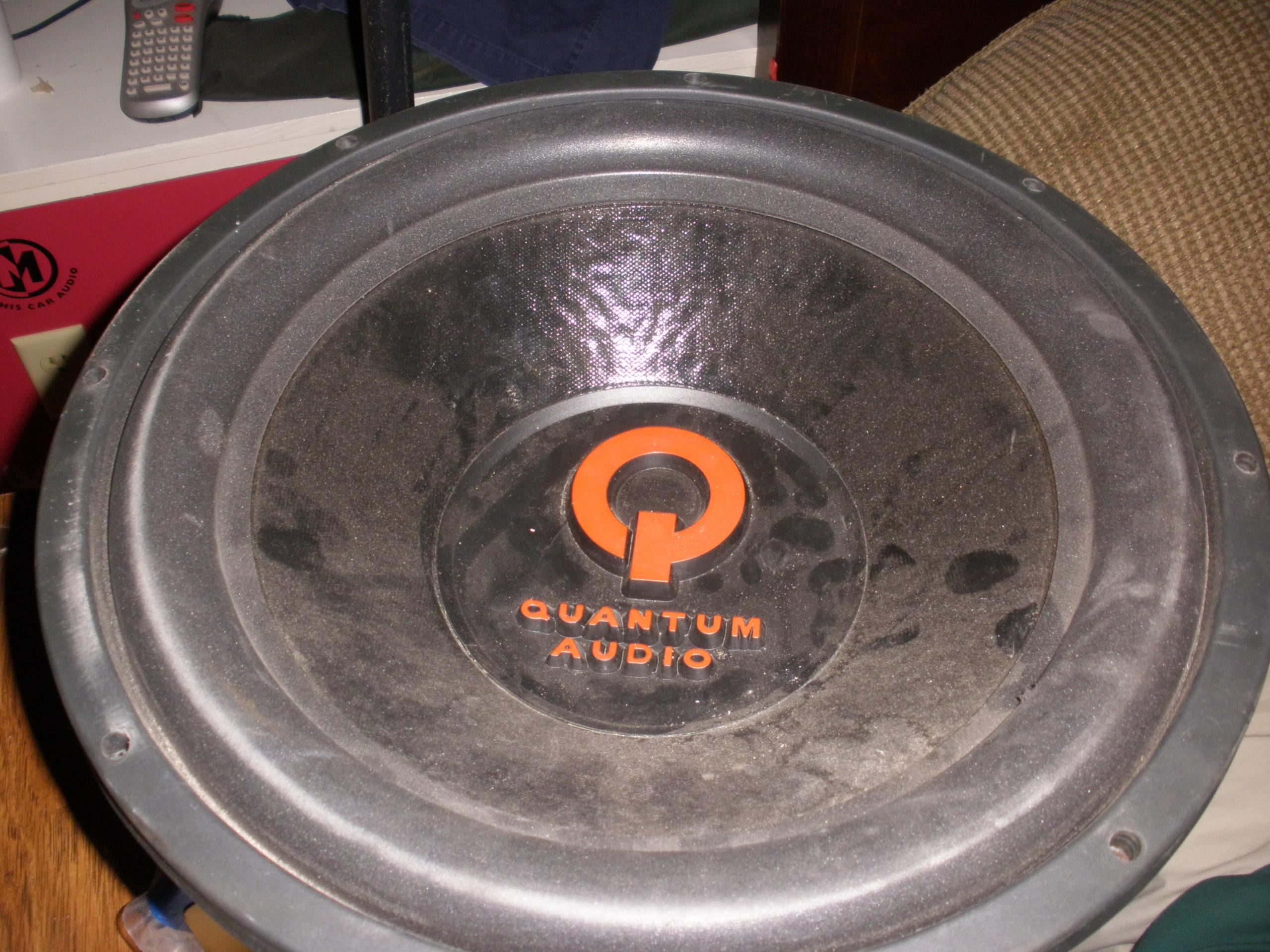

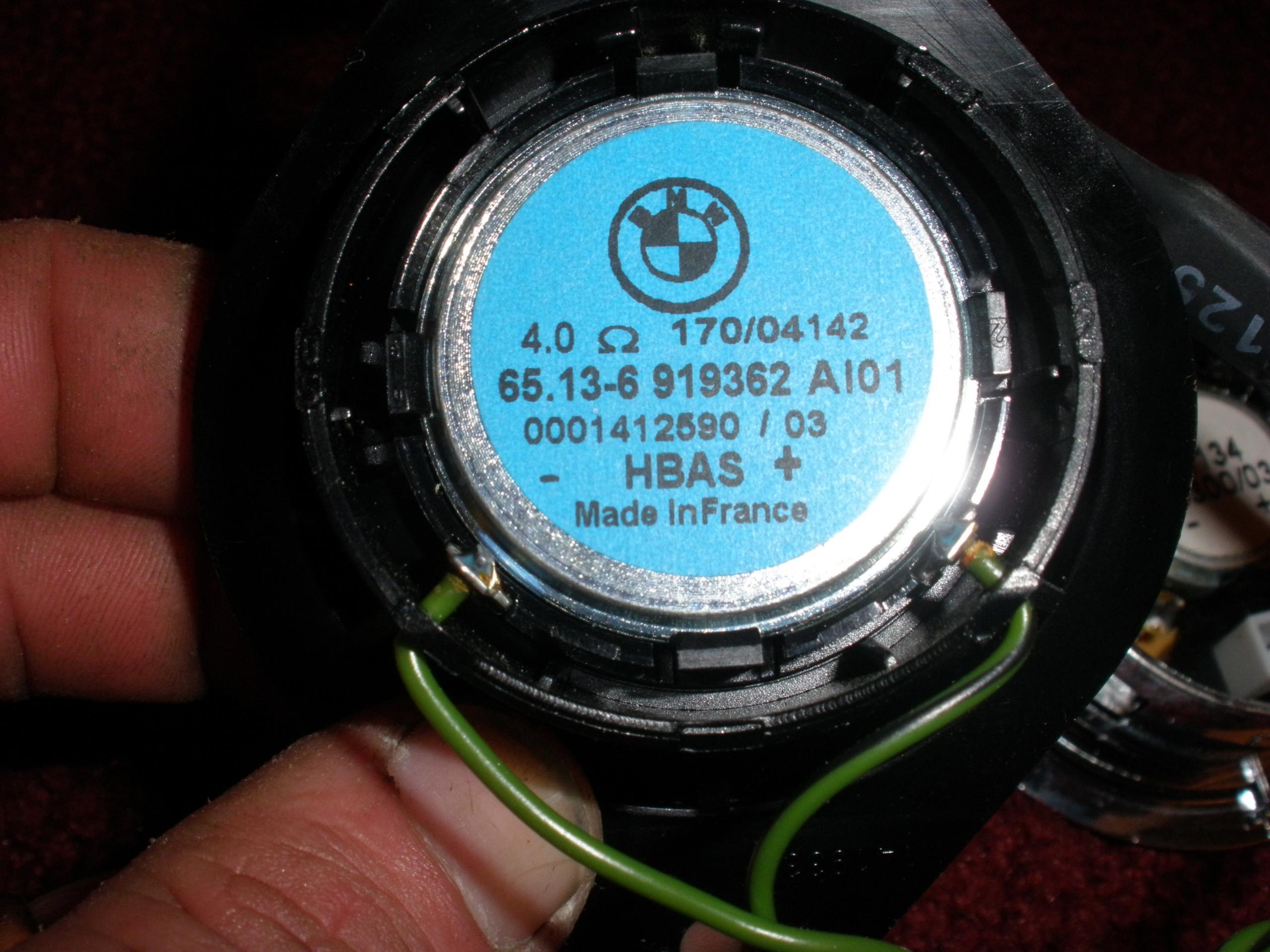

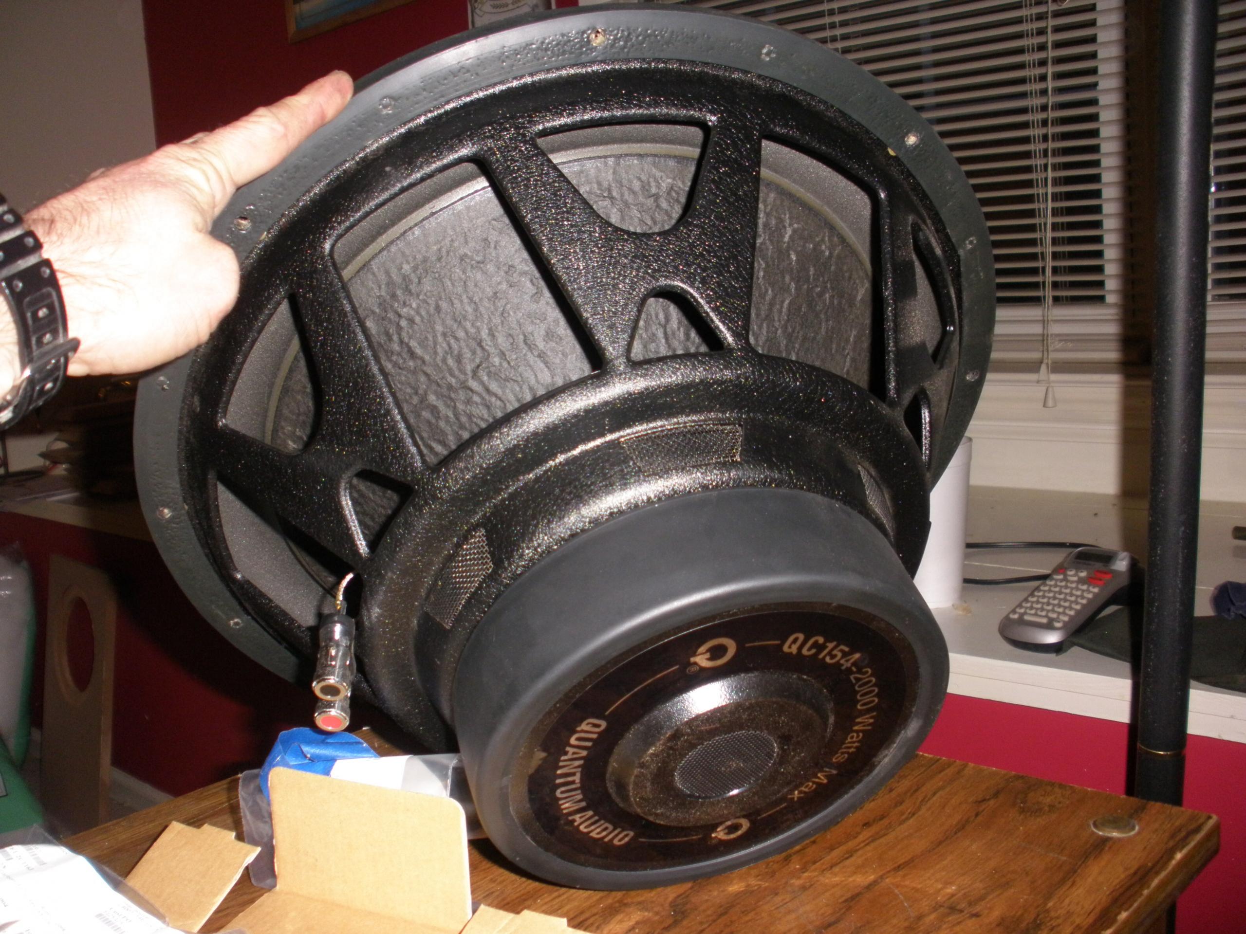

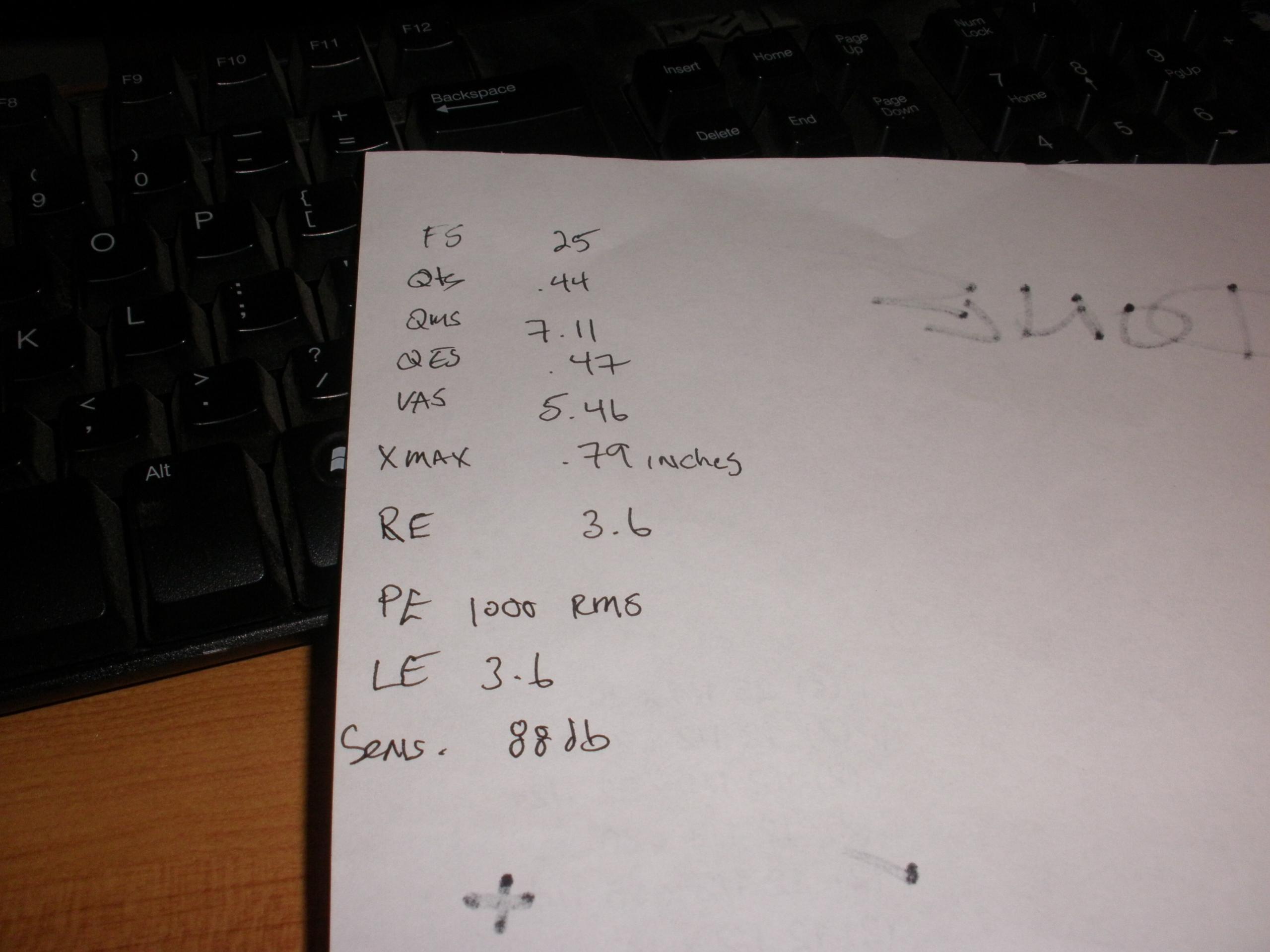

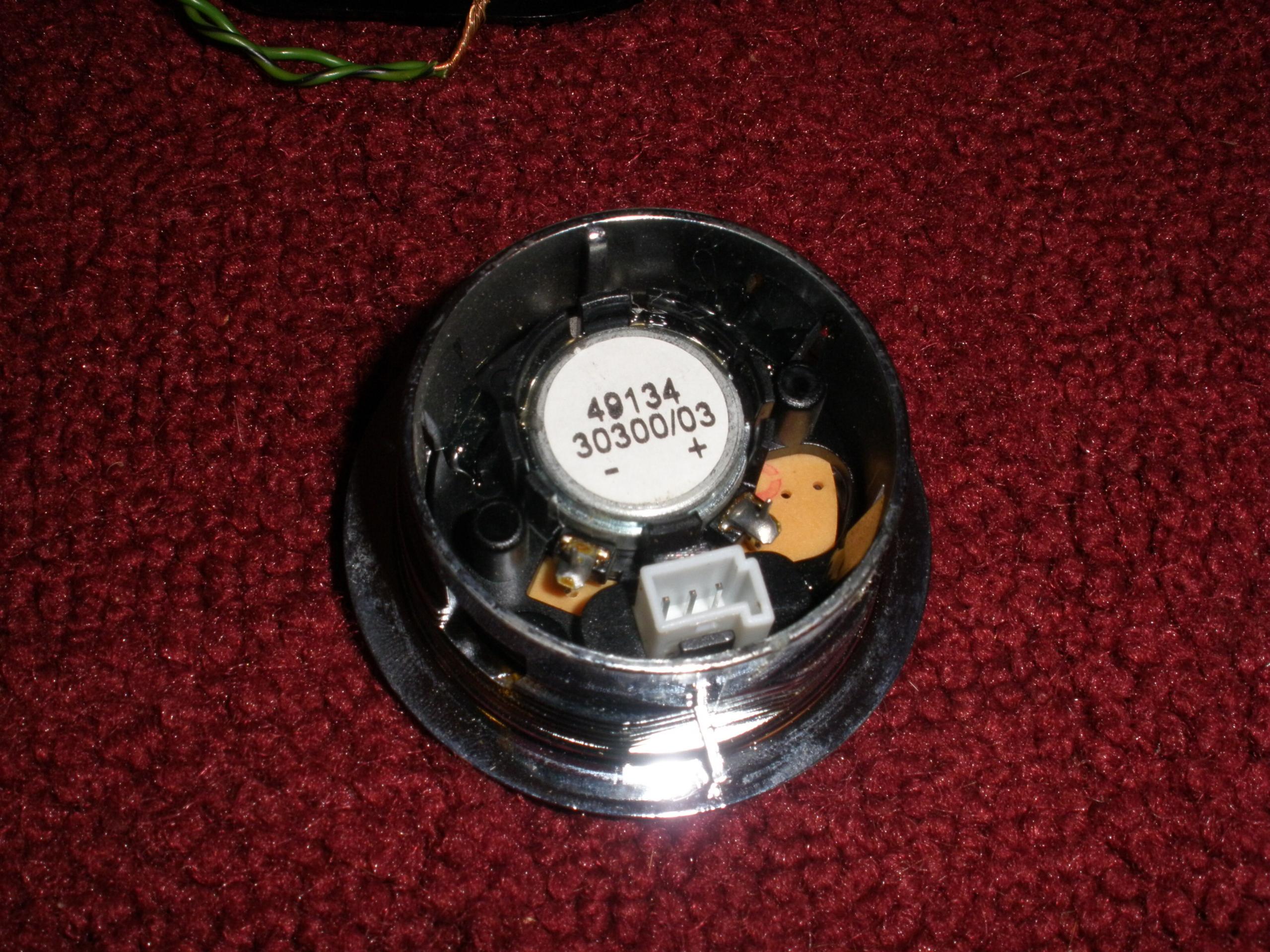

Got a free bi today. the specs and maufacture will be in the photos. It was free and i may use it along with my stats, or sell it. Enclosure suggestions please. I allready have an amp for this thing. this is the cheapest brand sold here in south east Georgia, howver, this one might be old and better, there is a three inch coil, and the rms specs i found have never ever been true, a good 400-500 rms amp, which i also have. thinking around 4.5 cu.ft. bigger, more efficient, like a said, this is a free bi. here are the pics. thanks Mav
oh yea. single 4 ohm
Don't mean to complicate things, but...
Hey Mav, take a look at this paper done by Martin King, especially the part about mounting the driver further down the line. Hopes this helps and not hurts, all the best bro

so just reverse the enclosure? load into a large and discharge into smaller, correct? I will wait and look for the link. thank you Steve.
hi mav,i copied down the specs and i'll throw them in to winlsd and see what i come up with. looks like an awsome sub!do you have two of them? jer

Hey Mav
http://www.quarter-wave.com/TLs/Advanced_Models.pdf
Above link is the only way I could get the info to you.
Your earlier post asking about driver in larger end of t-line is correct because loading it into the smaller end going to larger end is a HORN... totally different animal! LOL
BUT, the main point I was trying to get across is to have the driver mounted 1/4 to 1/3 down the line instead of at the very beginning, this way it is much easier to tame the ripples in the frequency response when it comes time to do the stuffing. Your enclosure cuts that you already have will allow you to do 1/4 but not 1/3, but that's OK as 1/4 should do it.
All you would have to do is reverse the dividers that make up your line, and that would put the driver about 1/4 way down the line since you have 4 separate "lines" folded into that enclosure of yours.
I'd be glad to talk to you via phone to explain this further, because I am terrible at typing in these posts and keeping everything focused, as there are about 20 different REASONS why I am promoting this way of completing your TL, but that's up to you bro.
Cheers, Steve
PS If you read this article I linked to, don't worry too much about all the math and such, just get the general concept of it and look at the graphs.

Great idea!
Mav,
As you know, your box was copied from a similar box and drawn up on the fly in about 10 minutes with practically no forethought. I had a look see at Martin J. King's TL calculator and the math is beyond me but his ideas on driver placement are clear and compelling. I think you should go with Liquisonic's suggestion.

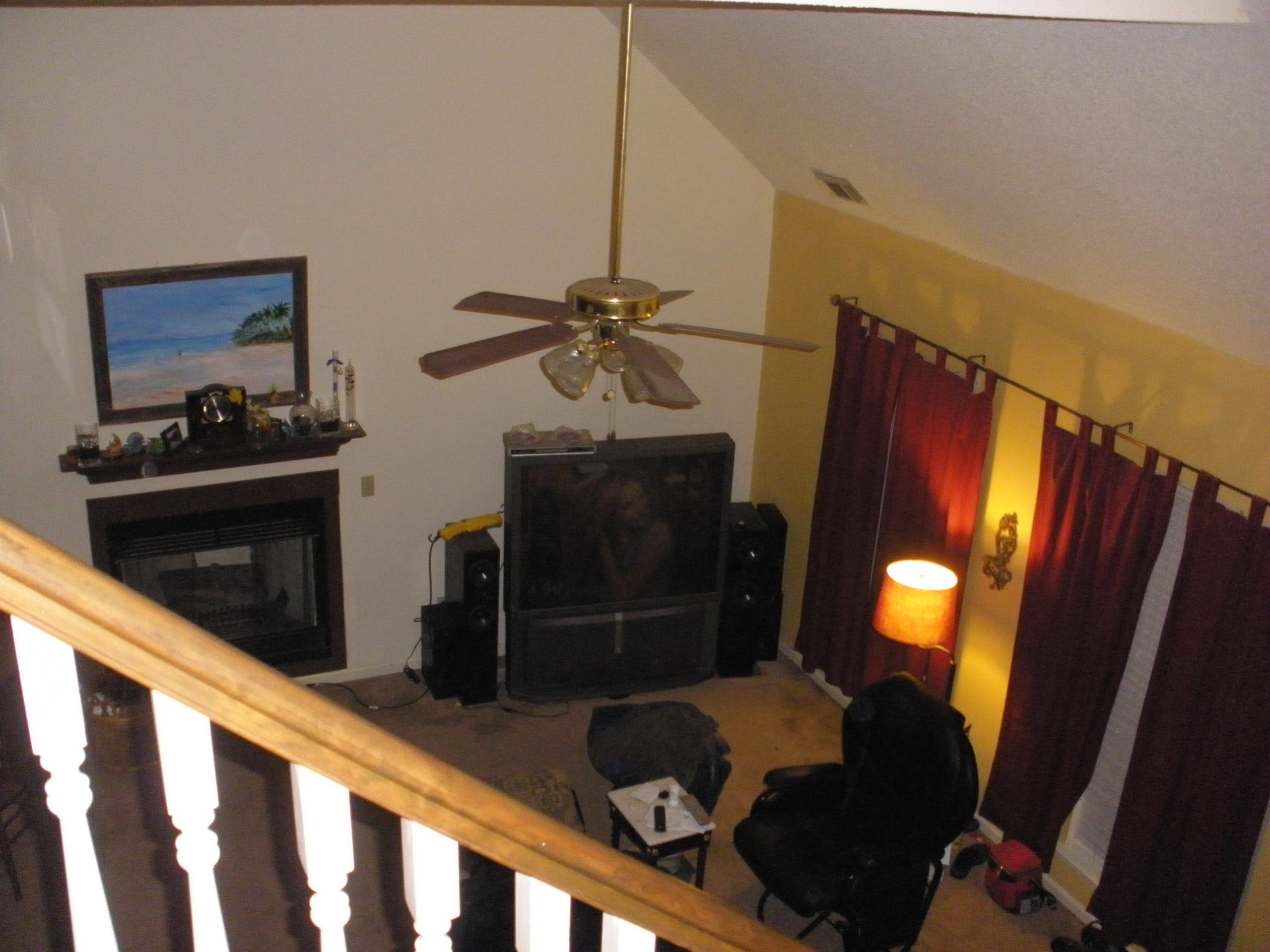

i think i posted my living space, the whole thing will change. TV centered, not in the corner. the sheir size of these will probally go from feft to right and shift seating backwards, cant wait!

Thanks Charlie, that was redone very quick, you and CAD seem to get along very well! so just reverse the lines, router all shelf pieces, so it as smooth as it can be, 1/2lbs per cu.ft. stuffing, and i still need to post pics of the terminal cups.

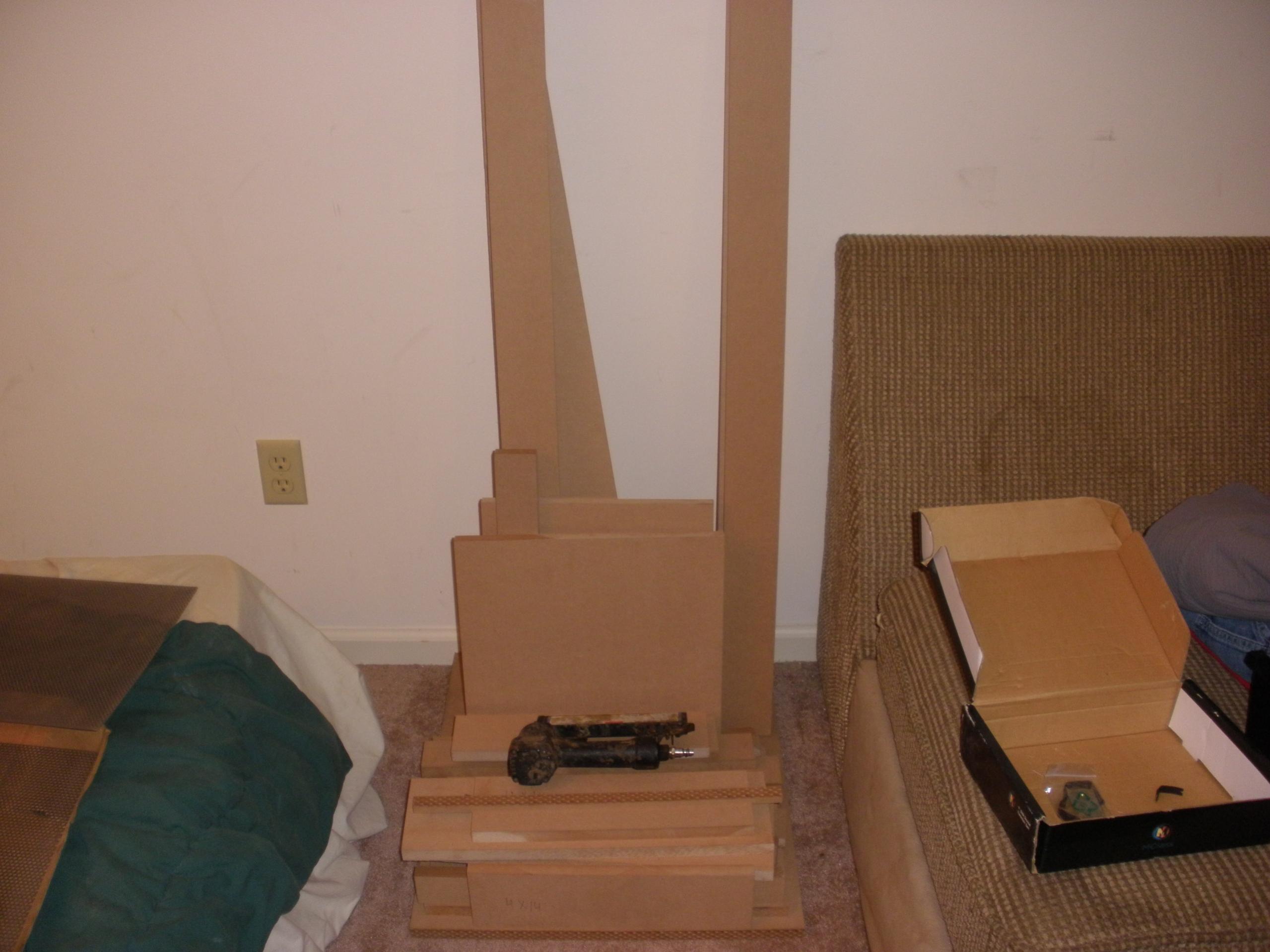

Building this weekend, use Liqidsonic's advice on the enclosure. I will post pics as soon as i can, watching PAC MAN boxxing Saturday night. weird clieche, after the boxing match, the next day, Sunday, build the TL. I hope you guys are right as i will try it out.
Thanks in advance, i know you guys are right.

Mav
"I hope you guys are right" umm... uh oh, better explain myself here.
Nathan, you DO know that using a TL is an attempt to"match up" with the "smooth" response of the ESL, don't you?
A TL can go very low in the bass octaves, but is by no means a "sub" ie. thump, punch, bump, etc. as it will reproduce none of these characteristics, in fact, a "sub" will sound great paired with regular (dynamic) speakers, but along with numerous others that own/listen to planers, these "subs" will stick out like a turd in a punch bowl! LOL
A TL on the other hand will sound like it is merely "present", providing support for the bass deficiencies inherent in an ESL or other planars.
Charlie, are you hearing me? You, as a jazzman, should be able to back me up with these points eh?
Enough typing for now, but Mav, if the bass from the 8" drivers don't provide the "weight" you desire, you may just have to opt for the 10" in short order.
Hope this makes sense to you all.
