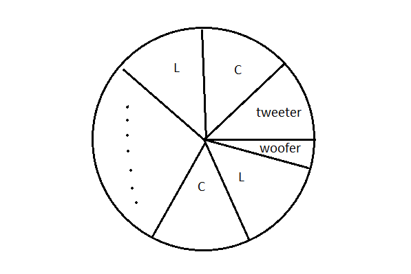

I drew this picture to illustrate to other beginners and help them visualize how the master "combines" the acoustic and the electrical crossover:
For a quasi-LR4, the two drivers are in phase because they are always 360 degrees apart and therefore come full circle. Both the tweeter and the midrange participates in the phase shift, but they meet somewhere near 180 degrees to complete the circle. For example, the tweeter could go 190 degrees forward and the woofer -170 degrees. If they do not meet at exactly 180 degrees, no harm done, it just isn't a symmetrical LR4 on the graph. Phase symmetry is highly unlikely to be audible and should be low on your priority list.
Each low pass reactive element always goes from 0 degrees at 0Hz to -90 degrees at infinite Hz. Each high pass reactive element always goes from 90 degrees at 0 Hz to 0 degrees at infinite Hz. At exactly the crossover frequency, the phase shift has to be somewhere in the proximity of +/-45 degrees.
Both Butterworth and Linkwitz-Riley are 45 degrees at the crossover point. So it takes 8 reactive elements (4 inductors + 4 capacitors) to complete the circle if the acoustic phase shifts of the drivers themselves are the same.
But you can use the Chebyshev alignment. On average, in my experience, you can shift about 60 degrees with each reactive element. It is only a ballpark and it is impossible to give an exact figure because each situation is different. You can go back to 45 degrees or even less, or be aggressive and get more than 60 degrees.
The acoustic shifts are measured, and they are known. If each reactive element shifts 40-70 degrees there are only so many ways you can divide the remainder of the pie.
This explains the "order" of the electrical crossover and how it combines with the "order" of the acoustic crossover. Combine != add and 1 + 1 is not necessarily 2 in this process, but the pie chart helps you visualize what is going on.
