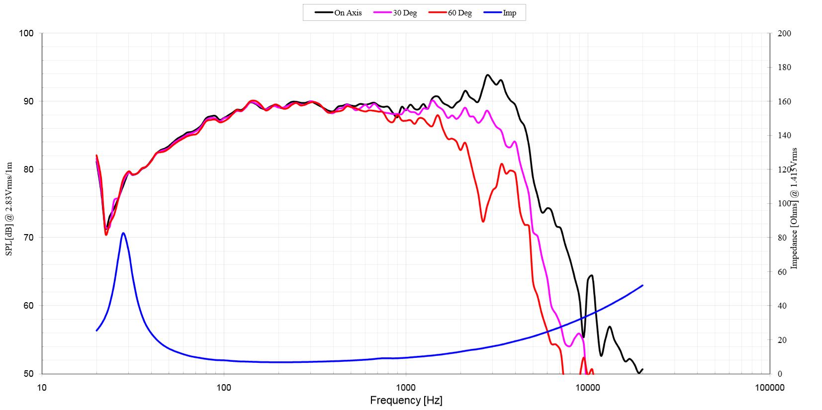

As AllenB correctly describes, the SPL data for the 8" proves that a crossover under 1kHz to a dome tweeter is necessary for a smooth controlled directivity, a consistent polar response. With a crossover at higher frequencies, the listener will experience a confused SPL and soundstage as the 8" beams its energy over a narrow polar pattern to the listener, while the tweeter spreads its energy over a wide polar pattern around the room. confused soundstage

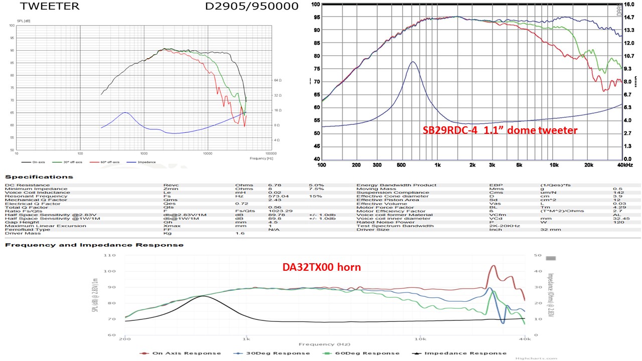

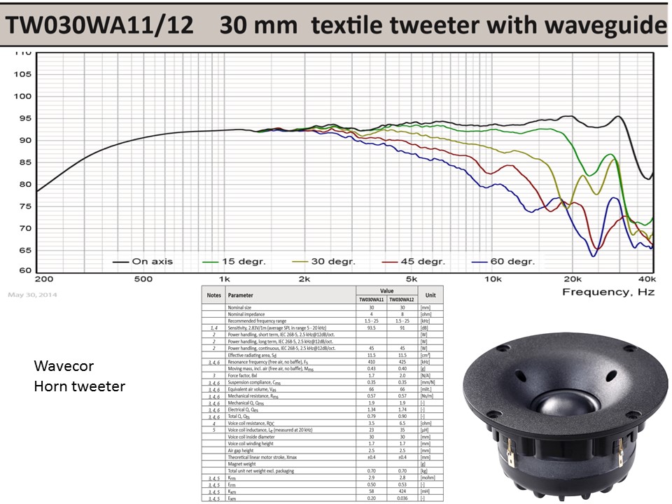

Just one look at the ScanSpeak D2905 datasheet confirms that it required a >3000Hz crossover and is not suited for crossover to an 8" midbass. The 1.1" dome on the SB_Acoustics SB29RDC-4 has been used with 1400Hz LR4/LR4 crossovers with 8" midbass... not perfect but an acceptable compromise. Tymphany(Peerless) also sells a horn loaded 32mm dome tweeter DA32TX00-8 which has been used with ~1600Hz crossover frequencies... where the polar pattern of the DA32TX00 horn just matches the early beaming polar pattern of the 8" midbass.
So, find a robust tweeter which supports a low crossover ~1,400Hz like the SB29RDC-4 to reduce the 8" beaming effects. OR... accept the 8" beaming effects and find a horn loaded tweeter with a polar pattern which matches that 8" beaming polar pattern at ~1400-1600Hz crossover frequency. Same goal, a smooth controlled directivity function through the crossover.
