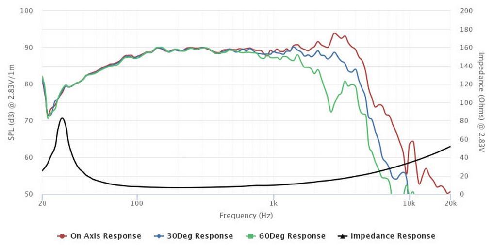

An amusing afternoon looking at the Peerless 830869 8" Nomex woofer.
I've got one for about the usual 30 Litres of reflex for this Qts 0.38 woofer.
It's definitely not a nice woofer for 3kHz crossover, but I'd start here with something based loosely around that old KEF tweeter filter.

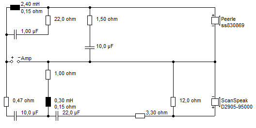

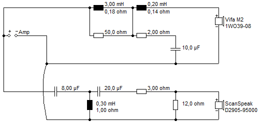

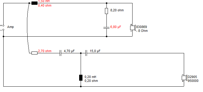

Well! Excuse me for the late, I'll tell you all about my experience. My project comes straightly from a "New Vifa Tower" by Murphy Blaster realised some years ago. That sounded very very nice, the mid region was wonder but not the bass one, so I started to try changing woofer and crossover, just to begin learning something about, strongly helped by Boxsim by Visaton and frd and zma files traced from manufacturer specs.
I'm an "old beginner", studied architecture and not electronics but "transfer function" is always in my mind..! So before of all I put New Vifa Tower in Boxsim and realised a certain agreement between the real model used as reference and its virtual simulation.
That system used a Vifa 8'' woofer (M21WO39-08, which has a wonderful response) and a ScanSpeak D2905-9500 (in reality Murphy talked about a "Scaspeak 9500", so D2905-9500 was my supposition), with a 3rd order crossover configuration. Its response in mid and treble region was very very good, and the cross-point was at about 2 Khz, and this proves what was said by Scottmoose. In particular, tweeter never had any sound problem.

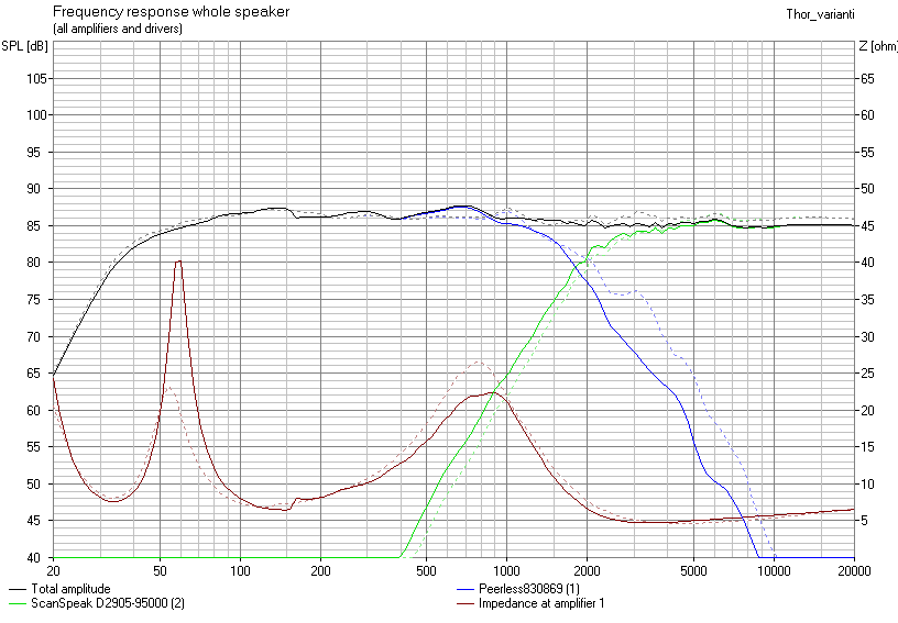

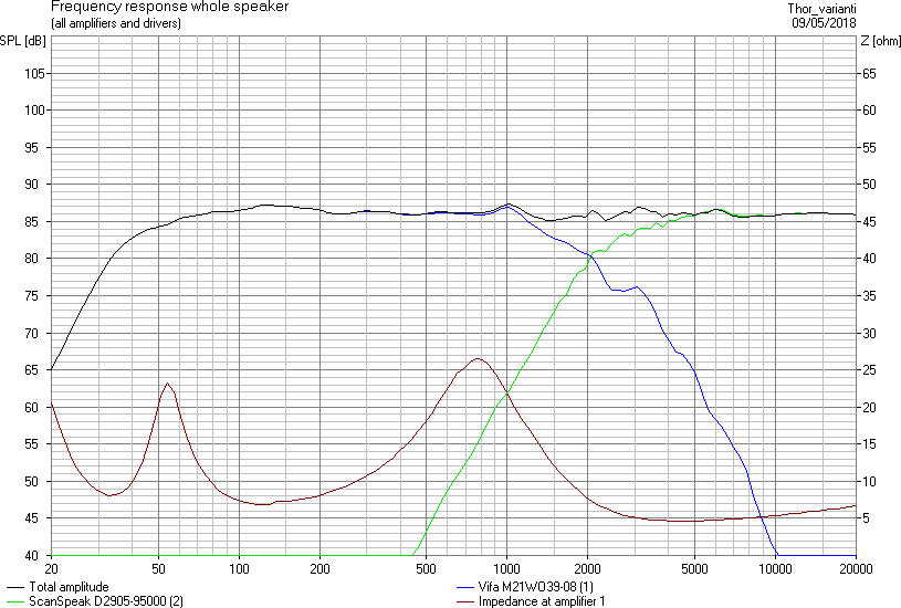

Here simulation of that New Vifa Tower:
Since I love the mid-bass response of Peerless P830869 I tried to put it beside D2905-9500 I already own, and in effect, cutting it highly, trebles was very "aggressive" and unpleasant, probably due to its peaking in 3 Khz region. So I discovered that the best way to shoot down breakup was inserting a RC in parallel to the baffle-step big inductor, and so Peerless was fixed well.
From this point, problems appeared to tweeter. Cutting it high it sounded thin and clinking; cutting lower it sounded with a quite "metallic" taste; cutting even lower trebles was better but "ssss" and cymbals are in big evidence, even lowering trebles level....

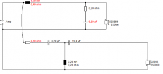

Here simulation of the last stage overlyed to New Vifa Tower.
In effects, cross-point is just a bit down 2 Khz (say 1.85, proved by some real measurement in domestic ambient), 10 uF is the only way to avoid metallic response but.... it's still not good, quite sibilant and brilliant.
Where do I go wrong?!
@System7: thank you but how do you manage 3 Khz breakup with 1.5 mH coil? and why don't you reverse tweeter polarity?
@ Cyberstudio: no need to apologyse, as you can see I'm less than a beginner..
@ Jonathan Bright: yes, is certainly a "black art", I'm just wondering about..
@Michael Chua: 1.85 Khz
@Linesource: thank you for your alternative tweeter advices
@all: what does it mean "beaming" and "lobing" please..?
