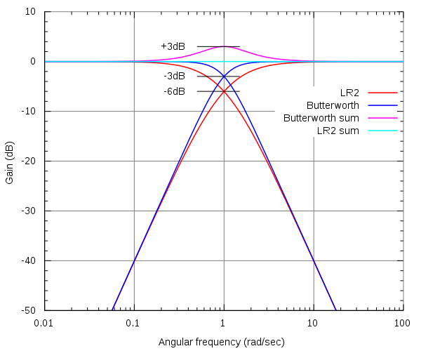

Here's the familiar phase-aligned BW2 and LR2 frequency responses, courtesy of AllenB:
The BW2 looks bad on frequency response, but conceals a secret. It has overall flat power response and flat impedance. Both good things, IMO.
And we can fix the frequency response with a 90 degree phase shift in a crossover by mucking up the time alignment between the two drivers.
This is what the BBC did in the LS3/5A speaker by stepping the bass back on the baffle. A surprising solution that worked for a lot of people. Harbeth still do this:
This is not to advocate Butterworth. Linkwitz-Riley has strengths too. I think the debate will rage on, unless we concede both solutions have strengths and weaknesses. Let's not go into lobing and combing and distortion here either... 😱

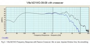

Using an 8" woofer with a 1" dome tweeter is quite challenging. I recently did one with a HiVi M8a and believe or not, a HiVi TN-28 tweeter ( Junco-II ). I actually crossed them at 1.5kHz.
Prior to that, it was a vintage Vifa M21WO-39-08, again with a TN-28 ( Junco ). The M21WO has a nice frequency extension so I was able to cross higher at about 3kHz. It's not the ideal cross point but my intention was to get something running so that I can hear how they sound like. Surprising, the Junco sounds pretty good on-axis.

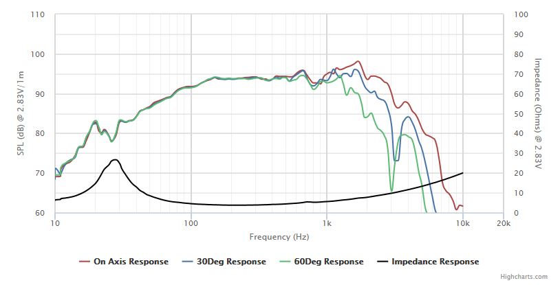

That Vifa M21 has many variants with different sized magnets, surrounds and impedance. But is also remarkably similar to the Peerless 830869 we started with.
Your 3kHz crossover (attached Image) must be just a coil and a bit of impedance correction at a guess. I always find a negative polarity 3rd or 4th order tweeter filter works well with that on a flat baffle. This is what KEF did with that 8" plus 1" combo. You take your beating on 3kHz breakup from the bass unit and a glaring dispersion mismatch. It's not too intrusive IMO.

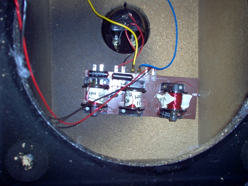

One of the best 8" paper plus 3/4" mylar speakers I have ever heard is this Wharfedale Shelton XP2. 6 element BW3, I reckon, but I couldn't unglue the crossover to be sure. It can be done.

Yes, there were a few versions of the M21 but I think the one with the strongest magnet is the M21WO. It is a wonderful woofer. It's a shame it's discontinued.
The FR plot of the M21WO is 2nd order electrical. So is the TN28. I am sure I can cross the M21WO with the CAT378 at probably 1.5kHz.
