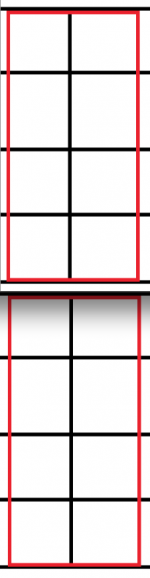

The light grey line is not a simulation of a stack of 8 horns, it is a simulation of one circular exit of 8 times the area as one simulated cabinet.
To come close to that in half space, a stack of 8 would look something like the diagram below.
And the TH would have to have the entire frontal area as an exit.
I have not seen that type of TH or stack in the real world.
It's true that you don't see it often but it's easily possible. Put the mouth on what is usually the bottom, lay them on their sides and stack them and then the full frontal area is the mouth. See Bill Fitz's THT (low profile version) for an example of how this is done. It's a front loaded horn but you can do the same with tapped horns. It's the pic near the bottom of the page.

Once again, if you plan to stack from the beginning these are trivial details. If you don't plan ahead it's almost impossible to get anything resembling a good result.
But even if the mouths are on the side you can get a lot better approximation of a circular exit than the pic you showed. Laying on their sides, 2 stacks 4 high with all the mouths clustered together in the middle. I couldn't find an example on google so here's a really simple pic of a stack with all the mouths clustered in the middle. The mouth area is shown in red.
The upper response of FLH or TH becomes relatively narrow, much less than 180 degrees.But even if the mouths are on the side you can get a lot better approximation of a circular exit than the pic you showed. Laying on their sides, 2 stacks 4 high with all the mouths clustered together in the middle. I couldn't find an example on google so here's a really simple pic of a stack with all the mouths clustered in the middle. The mouth area is shown in red.
The shape of the stack is reflected in the ground plane.
The stack you just drew does not look much like a circle (or a square) in the upper response, more like a line array.
A vertical sub line array with a narrow exit is a good thing, but not what Hornresp predicts 😉.
You are correct of course, there's no arguing with that.
But as long as you are aware of what Hornresp is doing you can get a reasonable correlation to the model. Obviously putting them in a horizontal row 16 feet wide isn't what Hornresp is predicting and won't match the model or be ideal in any situation I can think of.
As long as you at least try to do the right thing it's usually going to be close enough. (Usually way better than close enough. And easily close enough that my simulation is not invalid. The mouth shape is going to primarily influence dispersion pattern anyway, not frequency response.)
