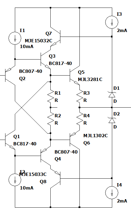

Here I corrected the schematic:
I also added transistor models for illustration.
The benefit is obvious:
Fast, high beta, low voltage small signal transistors can be used for the drivers because most of the power is in Q7 and Q8 now.
Also, pre-driver and driver transistors can be dual transistors in SMD package, thus thermal coupling between pre-driver and driver transistors is excellent.
My experience with THT components is that thermal coupling is good enough to maintain stable bias, whether pre-driver and driver are on a separate radiator or on the same radiator like the power EF transistors.
Obvious downside: Increased voltage headroom consumption due to the driver cascodes Q7 and Q8.
Risk that is not so obvious:
Increased DC offset due to mismatch of CCS I3 and I4, base currents of Q7 and Q8.
AC instability due to the cascodes Q7 and Q8. This is severe and rather difficult to tame.
Very few designers have successfully built such bootstrapping schemes. Once you simulate it, you will see why.
I will not take this adventure, and stay with the normal triple, it is a consolidated experience of mine, and it will work well.
But still, I have doubts about the injection point of the servo, this is my only problem.
It seems I must end up connecting it to the input, after the coupling capacitors, which is the only point reported in other schematics.
I still contend your proposed injection point will work as you intend.
I will gather some marked up sketches and analysis.

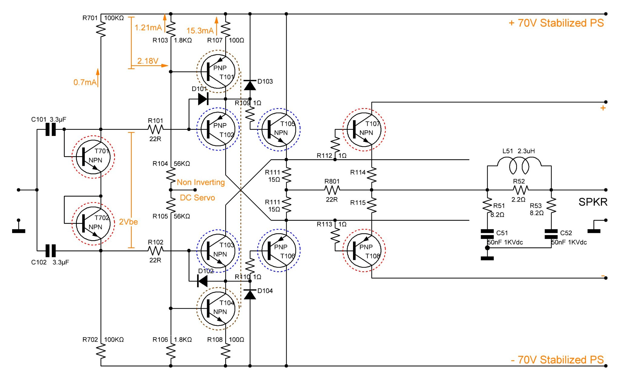

BWT, you comment that the input time constant is multiplied by transistor beta. Would you elaborate the reasoning?
Thanks.
I believe at 1KHz, the input impedance is roughly 50K, i.e. R701 in parallel with R702. There are bias currents flowing from T102 and T103, but the dynamic impedance from transistors bases is quite large. So I believe the input time constant is
100k//100k * 3.3uF//3.3uF = 0.33sec.
The corresponding -3dB corner is about 0.5Hz.

You should consider the VAS output impedance in your TC calculation.
Imagine C101 is a resistor to mass and neglect the current across it in static condition. Varying the current of T102's emitter (via T101) implies the base to push (or pull) its current to (from) its fixed voltage point of reference. So the "resistor" C101 is crossed by a current whose value is Variation of I emitter/T102's β.
Actually, C101 is a capacitor (still imagine the left side connected to mass) that determines a TC with other components. So the time C101 takes to discharge (charge) is βTC.
This is a very approximate argument, but more or less this is the picture.
I have a different perspective.
Note that T101 and T104 are both voltage-controlled current sources and they present high impedance to the emitters of T102 and T103. Cordell's PA book, 2nd edition, page 29, discusses CCS output impedance and describes a 5mA CCS. He estimates 290k output impedance; relative to your design, he uses base resistor of 5.4K (worse than your 1.8k), 400R emitter resistance (better than your 1.8k), and 5mA rather than your 15.3mA(less challenging with 5mA). I'm going to assume a SWAG 20k shunt impedance, which is I believe is pessimistically low.
To estimate loading originating from the speaker, I assume an 8 ohm load, and output stage Beta of 30, and driver stage Beta of 50--- again, I think pessimistically low. This would lead to an estimated 8*30*50 = 12K impedance at the base of T105. 12k//20k would yield 7.5k impedance seen by the emitter of T102. If T102 has Beta =80, impedance at base could be estimated as 80*7.5k = 600k. A similar 600k would appear at the base of T103, giving a net 300k input impedance at the T102//T103 pair. This would present modest additional load shunting the 50K bias resistance from R701//R702.
I believe turn-on transient would behave as follows: At the moment of power application, the input caps C101, C102 will have initial 0V and the PA will have near 0V output offset. But assume there's -10uA mismatch in the bias currents from the input transistor bases. The caps will begin to drift negative at an initial rate of 6.6uF/10uA = -0.66V/s and would continue until the 50k bias resistance load accommodates the offset current error, and drift ceases. If a servo amp is in place as you have suggested, it will intervene and will reach equilibrium when the bias currents are equal (no continuing drift) and the output is at ~0V.
Comments welcome.

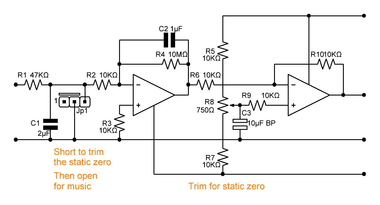

I still don't really understand why you abandoned the idea to connect the DC servo output to the CCS reference voltage.
It has been done before and should work:
Even if 50mV is a negligible offset (I agree with this), we cannot neglect the problem.
My last DBT has a 1mV offset moving slowly with the temperature. I couldn't appreciate big deviations because I didn't make the final pairs that hot. However, I used a servo the same.
In a buffer, you cannot use a feedback, loop in the audio band because the voltage gain is something less than 1.
So while we design a buffer, we have to think about a servo, which could be unnecessary if we are lucky, but we'll discover this when we power up the real thing. A good design must include the servo since it is conceived.
The Dartzeel NHB-108 has no servo but has trimmers to manually zero the offset when the alert light goes on. This is not acceptable IMHO.
This is the servo I was thinking about, made according to servos' best practices (B.Aloia, B.Cordell, and others). The jumper is needed to short the servo's input to mass in order to trim the zero. Then connect the servo to the buffer output by removing the short. In a particularly lucky chance you will leave the jumper shorted to mass.

I didn't know about others who tried the injection point I proposed. However, it IS in the signal path! At least in my schematic.
I'm not abandoning this idea, but I wanted to explore all the possible aspects. On the contrary, learning it was used by others, I am now convinced this will be a good solution.

I agree. A buffer has no voltage gain (which is the point). But, your servo sure does!
Just my personal viewpoint. Nothing wrong with a trimmer and as long as the drift is slow (which with temperature it is), and within acceptable limits, no problem. If you are chasing something that really doesn't matter in a practical sense, that may impair audio performance ... one has to wonder why?
Just keep it in mind in case you feel the servo is affecting sound quality. That's all.
Pete's (ostripper) servo is well thought out. Just keep transient behaviour in mind, which is power up and power down. Plus clipping events. Those may upset the applecart.
