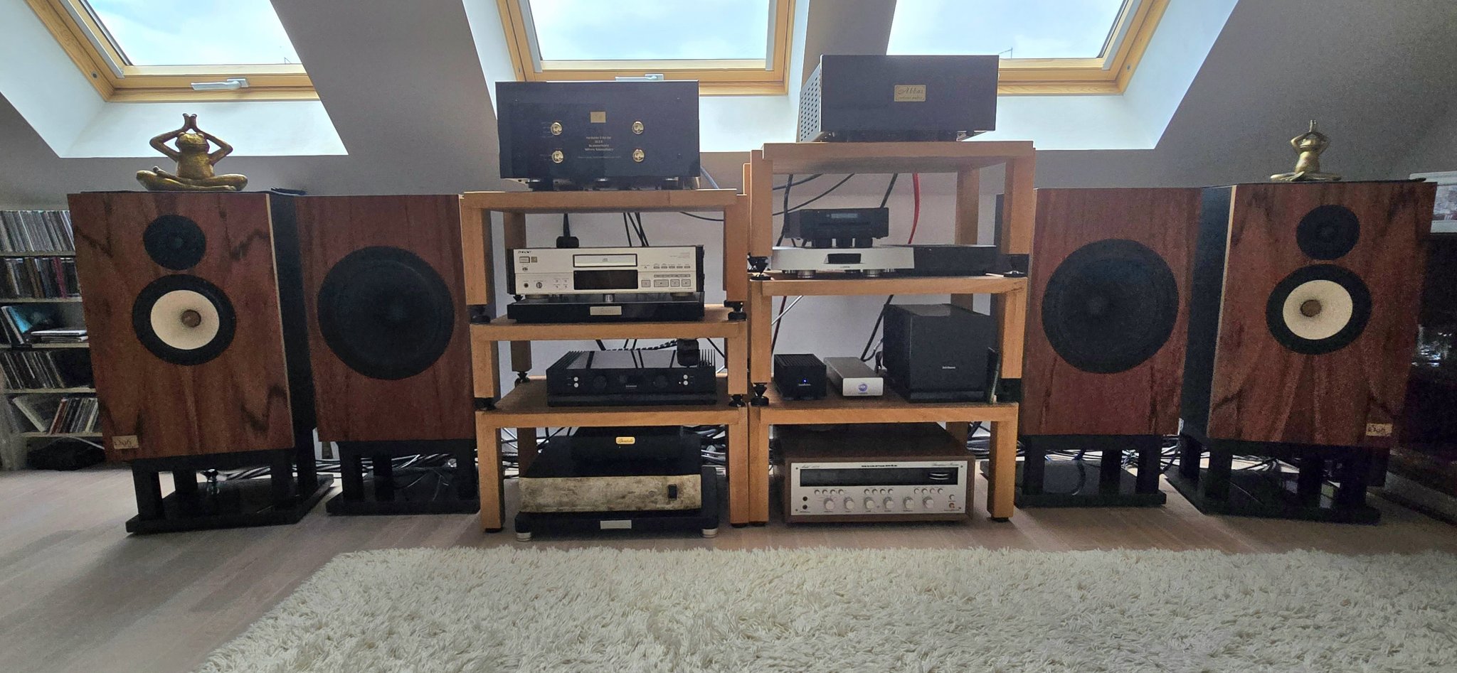

Used basic O96 Ref idea, just in a different way (call it: done right)...

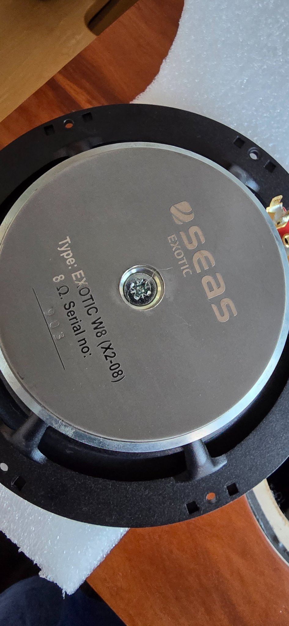

  • 8'' SEAS EXOTIC X2-08 AlNiCo (not the average ones ..)
  • Seas T35 X3-06 Alnico Hochtöner (way different league than Moral ..)
  • 35mm calotte from Dr. K. Müller Engeneering
  • High quality crossover
  • Active Sub: 12'' SB Accoustic SB34NRXL75-8 with Hypex FA251 (high gain used to 2way binding posts)
  • Build? By a DIY friend..
..very good, extra subs not needed they SEAS go quite low (30 - 3000Hz)! Of course the overall soundstage gets better with additional subs (i'm not somone bass-oriented) and makes the speaker in my opionion more 'complete'. Some have recommended to use hypex fa501, but for me fa251 enough.

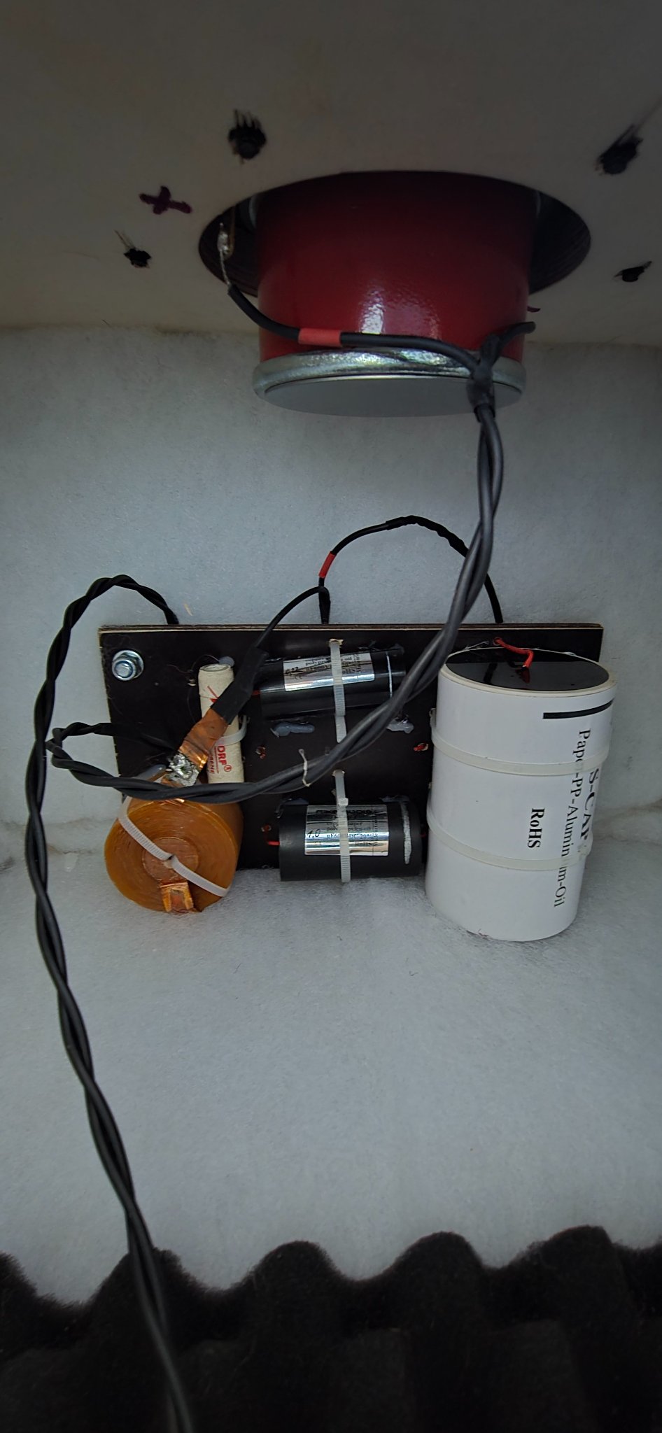

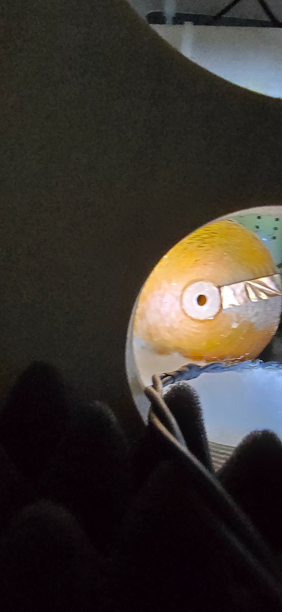

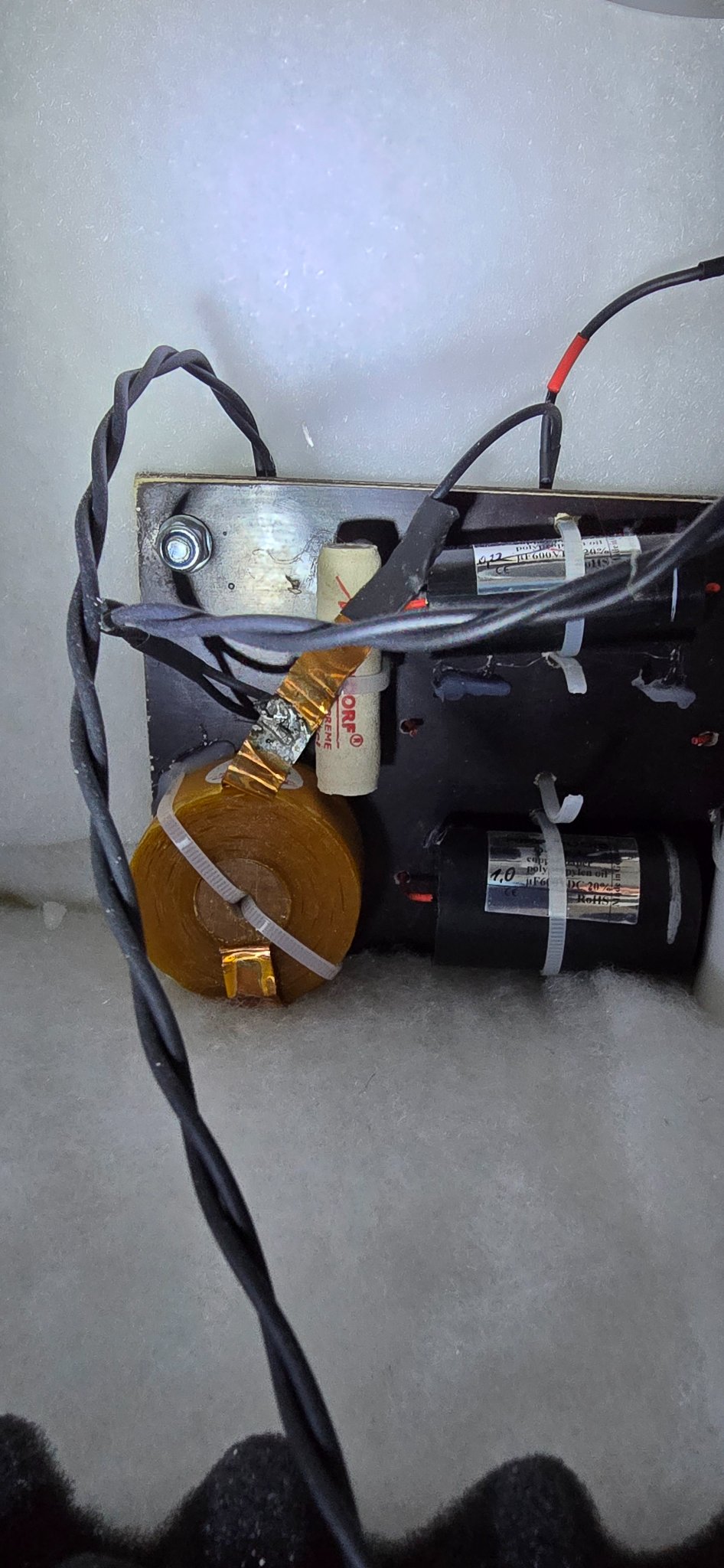

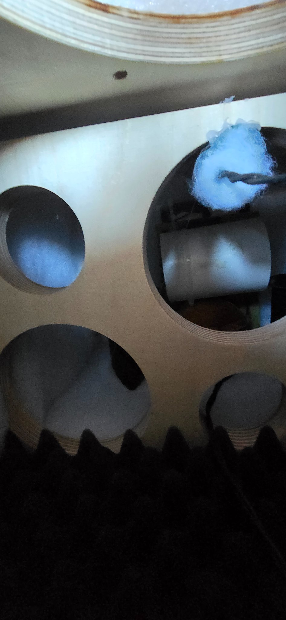

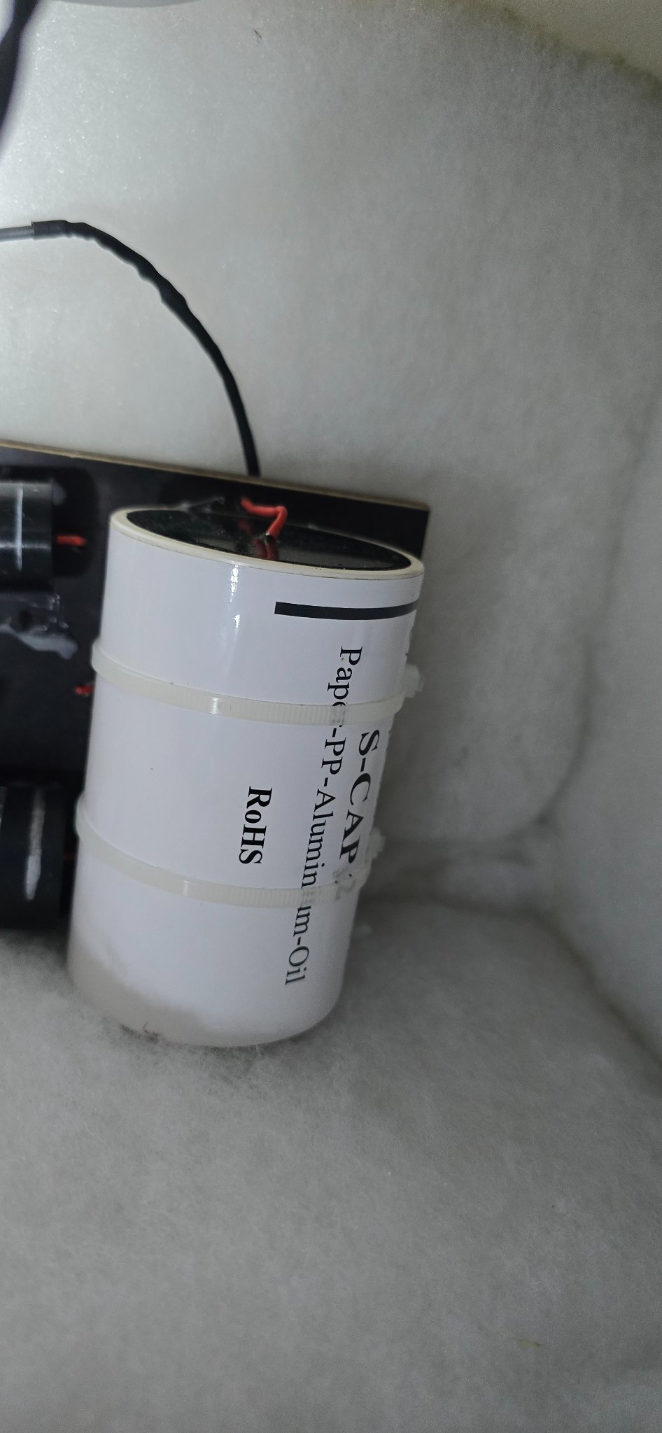

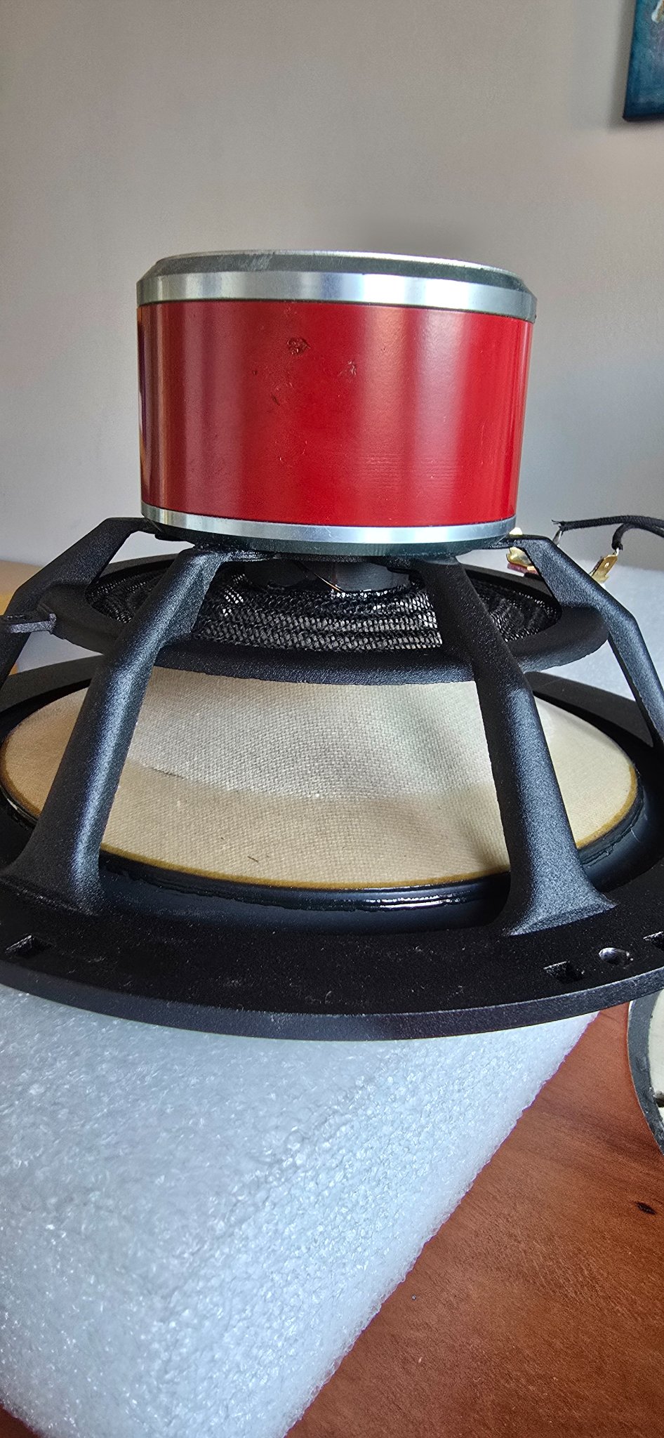

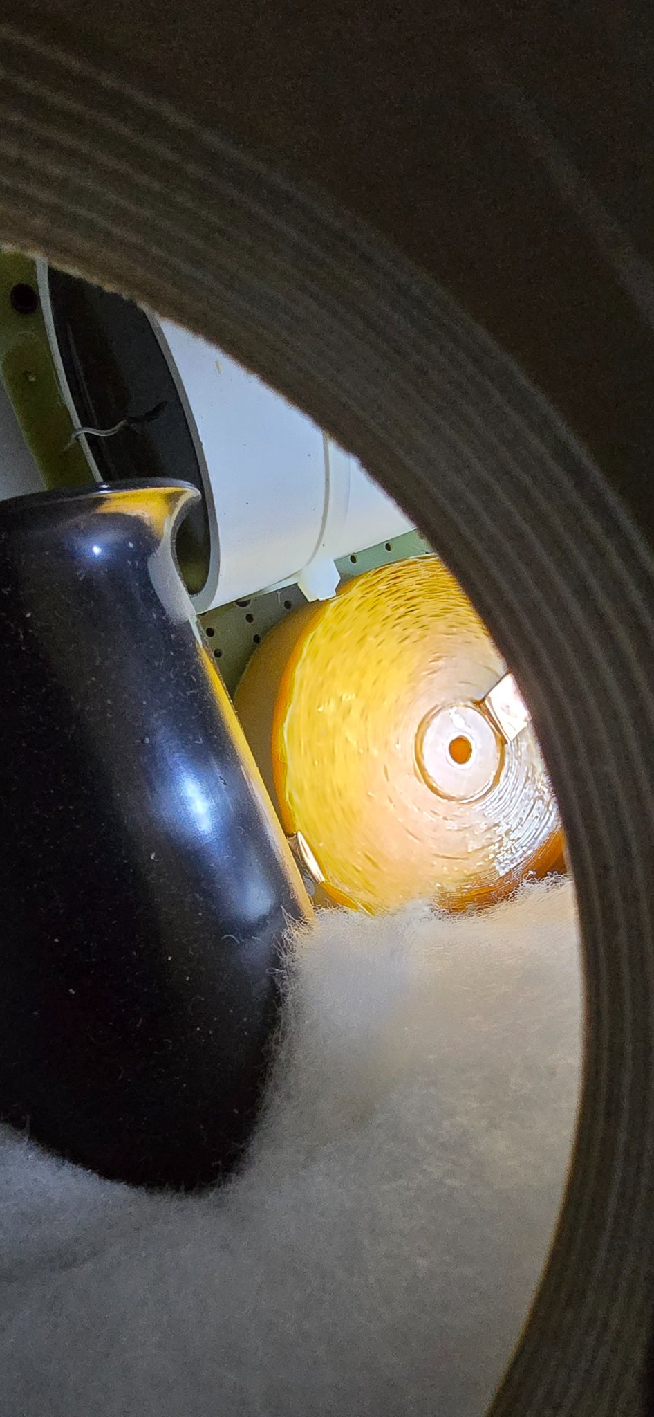

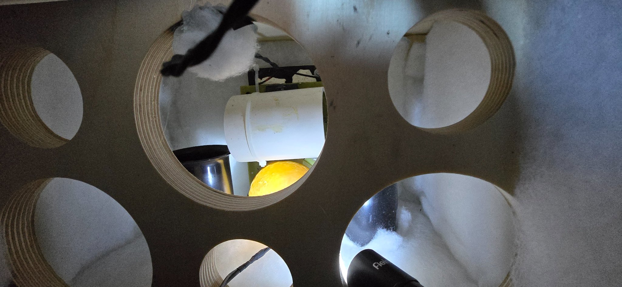

What are the length and diameter of the two rear ports?
I've not built it by myself, attached some pictures. Ports are generic ones 6cm (tube inside diameter) and length would~20-25cm.

Hi Dualuxe,
I know it's been a couple of years, but I'm wondering if you are still around and using these speakers.
Looking at your box alignment: You have two 3" X 7.5" ports, which UniBox calculates to be around a 40hz tuning giving a fairly broad 4db bump centered around 55hz. This does look similar to what was measured in the Stereophile review.
Did you tune this by ear? Or were you guesstimating based on the O/96 measurements?
I can see how this bump could provide some BSC-like FR shaping without sacrificing sensitivity.
Do you still use this speaker?
Have you done anything else you might share?
John
Yes, tuned by ear. I just made a bunch of ports of different lengths from about 5" to 8" and tested them.
