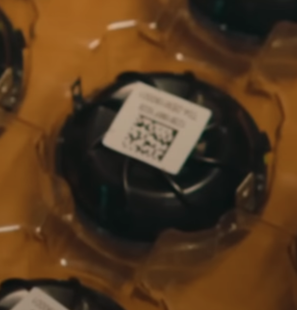

After all, Morel has been a regular for these clones. What do you think about using the Wavecor TW030WA12 tweeter?
Looks good on paper though
Interesting. Might be a good option for use with the simple crossover (running the woofer without filter and a first order electrical filter on the tweeter).
Too bad the faceplate is slightly larger than the CAT378, preventing a simple swap on the same baffle. Would be fun to try. (Not that I have any complaints about the morel, really.)

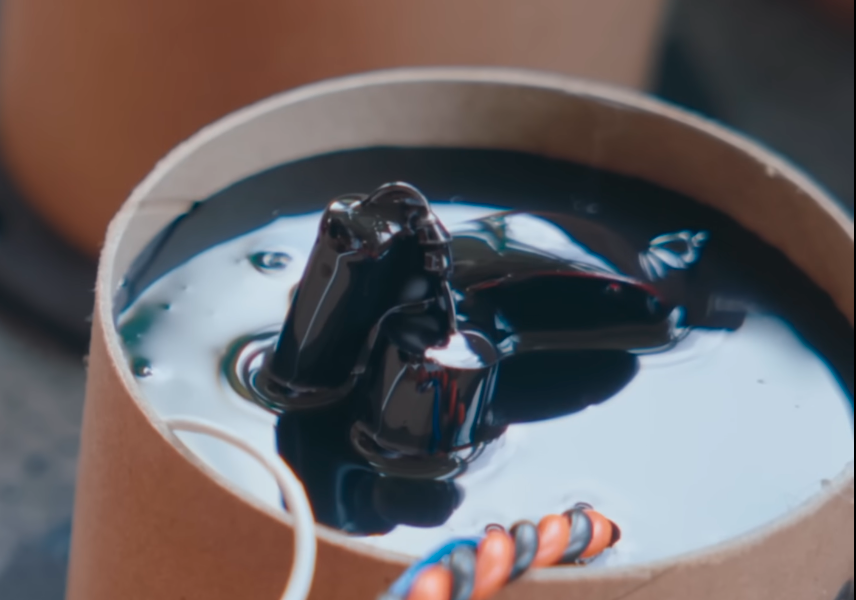

Would anyone here be able to share some crossover knowledge or suggestions? Truthfully it's not a strength of mine. Technical notes from Stereophile indicate a crossover around 2000hz. Unfortunately nothing revealing in the video as the crossover is completely encased in resin, but there is the presence of an inductor which deviates from the simple cap and resistor high pass most are using for the O/96 clone.
