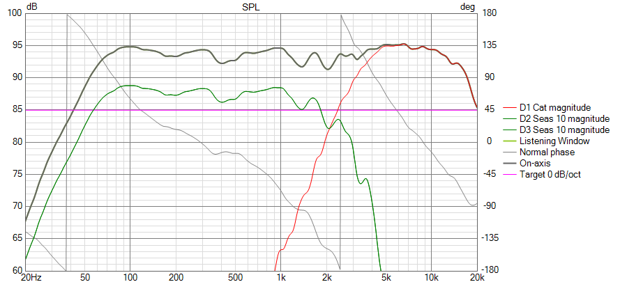

I am currently working with VituixCAD2 program on the crossover design for my Orangutan clone.
The CAT 378 tweeter looks exactly like the one used in the Orangutan 96 and 93. As for the woofer, I believe John DeVore that it is a special woofer made for him. It is easy to see that the Orangutan 96 and 93 uses phase plug woofers, like Seas Excel series, while SEAS Prestige A26RE4 have paper dust cap in the middle. SEAS A26RE4 have sensitivity of 89db, and it's impossible to reach with it the high sensitivity that John claims.
With the CAT 378 and Seas 26 I succeed to design 89-90db speaker. But I played with the idea of using 2 Seas 26 woofer on one speaker, and it was easy to design a balanced 95db speaker. Did anyone try to make Orangutan with 2 woofers? Of course it will look less like the original, but maybe it can be a better speaker then the 1 woofer clone? Any thoughts on that?

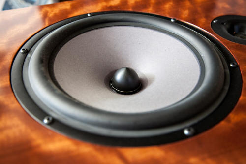

Orangutan 93 woofer with phase plug in the middle:
SEAS A26RE4 with paper dust cap in the middle:

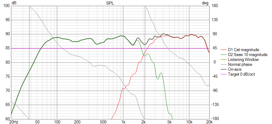

My Orangutan crossover SPL, 89-90db:
My Orangutan with 2 Seas 26 woofers crossover SPL, 95db:

The Devore offer uses a different magnetic as well. It looks like the same assembly as Seas uses for the exotic drivers.
Well, the Stereophile measurements show it's actually ~91dB..it's impossible to reach with it the high sensitivity that John claims.

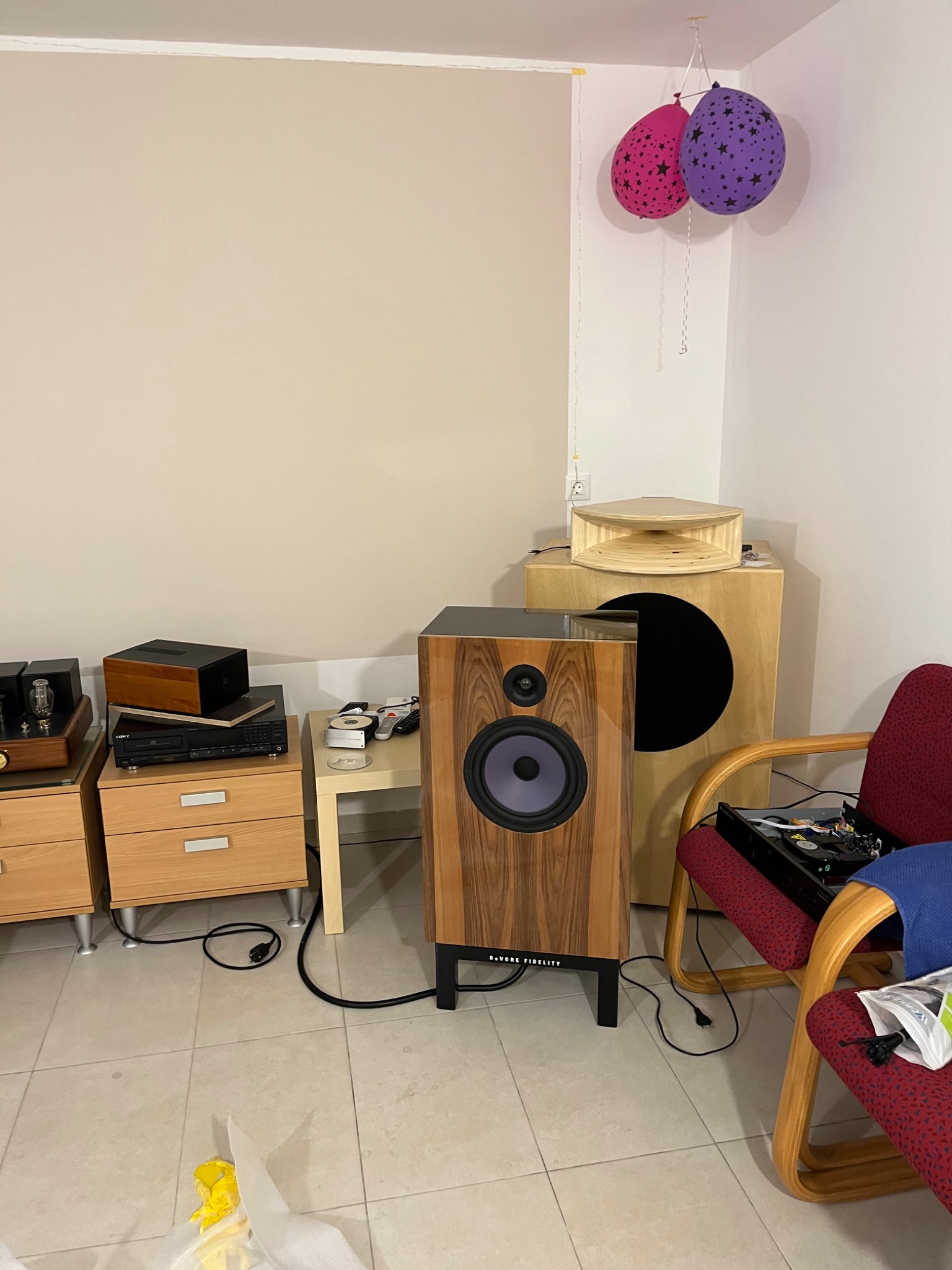

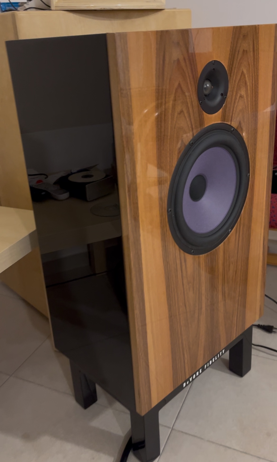

I have yet to finish the boxes, but I am happy with their performance.
I just completed the audio portion of this build, and am quite happy with them. It uses a pair of Dayton Audio RST28F B-stock tweeters that have been modified slightly, and a pair of Dayton Audio SD270A-88 DVC subwoofers. The box is 25 ltrs loaded with an RSS265PR tuned to 32Hz. Since one of my PRs is a production sample and one was off the shelf, I don't know whether that is one or 2 weight slugs per PR. Measure the woofer impedance in box for best results. The box has offset panels in front and rear to keep the PR recessed and safe, and make the baffle area for the drivers at 1.5" with a...

Think it is a great idea, 2 woofers really wake up the bass.My Orangutan with 2 Seas 26 woofers crossover SPL, 95db:
Pretty fun regardless to learn the software and what is possible these days.
As mentioned the real fun is simulating on the baffle with diffraction tool.
You will get off axis response and see full space losses. Then 2 woofers will really make sense.
Usually the tweeter is considered the listening position. So you use the X,Y coordinates
according to the distances the drivers will be mounted apart, center to center.
Then phase will be correct and the crossover can be designed.
Off axis is a whole new world and horizontal is easy, vertical will be the fun part.
Usually the lower woofer will have a lower crossover point, so the drivers dont cancel the top end.
Essentially 2x 10" woofers will behave like a 20" woofer in the vertical. You will see this.
It is why off axis is important to view and getting phase/distance correct in sim.
You will see why 2x woofer is very good idea with full space losses in the low end.
The second woofer and crossover point will fill in the losses.
Real life less EQ and nice snappy bass, no vertical cancelation. Often called .5 crossover
10" woofer will want a low crossover point for tweeter, so that is also the fun.

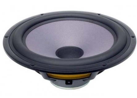

The midbass in these speakers is not a standard driver from the SEAS 10" range. Even if you find a schematic, it won't be worth much.

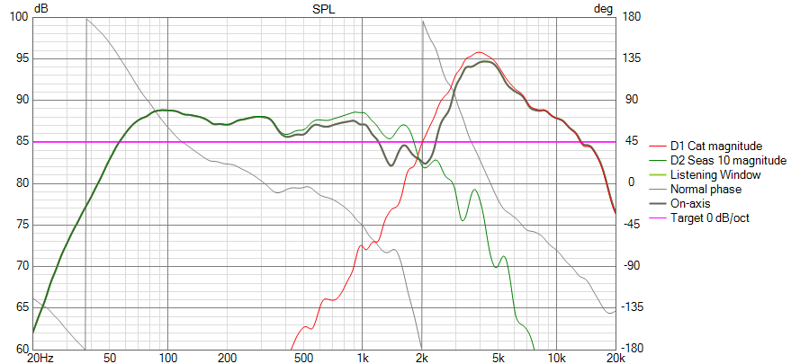

With the morel CAT378 tweeter and the Seas a26re4 this is what you're getting with the chatgpt crossover:
Those are really horrible results.
The drivers that are in the original Orangutan are not available to buy on shelf, so we can't know what the result will be with the original drivers.
