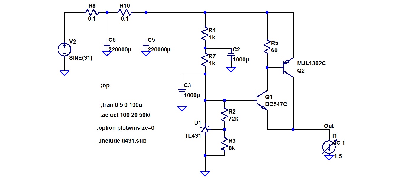

The simple cap multiplier circuits I tested outperform CLC by a decent margin.
The series regulated supply is virtually reference performance specs under all conditions.

Earlier I said that to improve voltage dropout I would use bipolars, but just now I discovered if you make a compound pair with bipolar/mosfet combination you only lose 0.65Volts instead of the usual 4 to 5 volts of most mosfets.

replace M1 with MJL1302A (PNP power transistor with ring emitter construction), replace Q1 with BC546C, and change R5 to 62 ohms. Presto, even better performance (wider bandwidth, lower output impedance) with zero MOSFETs.
And you may want to perform a few experiments to decide what is the optimum ratio of C2-to-C3. If the sum is constrained to be 2000 uF, is it optimum to divide the capacitance 1000+1000? Or is there some other ratio which works better? Using whatever definitions of "better" and "optimum" you prefer, of course.

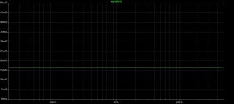

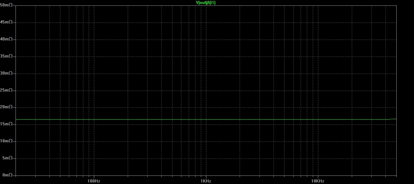

BTW, the professional EE way to display output impedance-vs-frequency, is with log log axes. Unless you're interested in less than one decade of impedance, i.e., not the ultrasonic behavior / 5th & 7th harmonic of 20 kHz.

Already been there done that,
This is just a better way to use mosfets.
I'll change graph to log-log.
I actually get much better performance with this combination than bipolar/bipolar compound pair.
