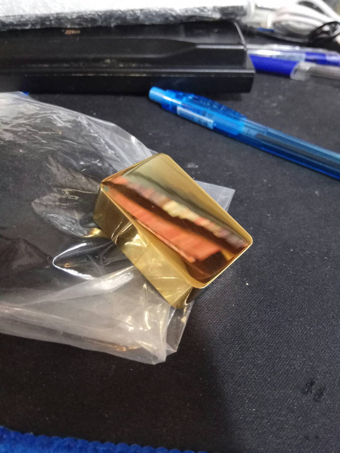

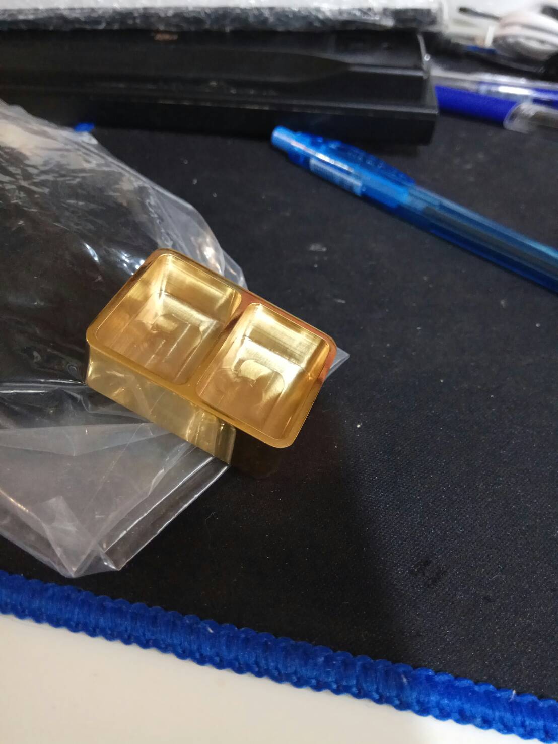

The easiest and cheapest way to fight EMI is the chassis, such as the photo below.
In order to deal with EMI, I am especially looking for someone to make Metal can using CNC, just to cover the XO that is particularly afraid of EMI interference. You can hear the improvement of sound by using the right means to fight EMI at key points.
