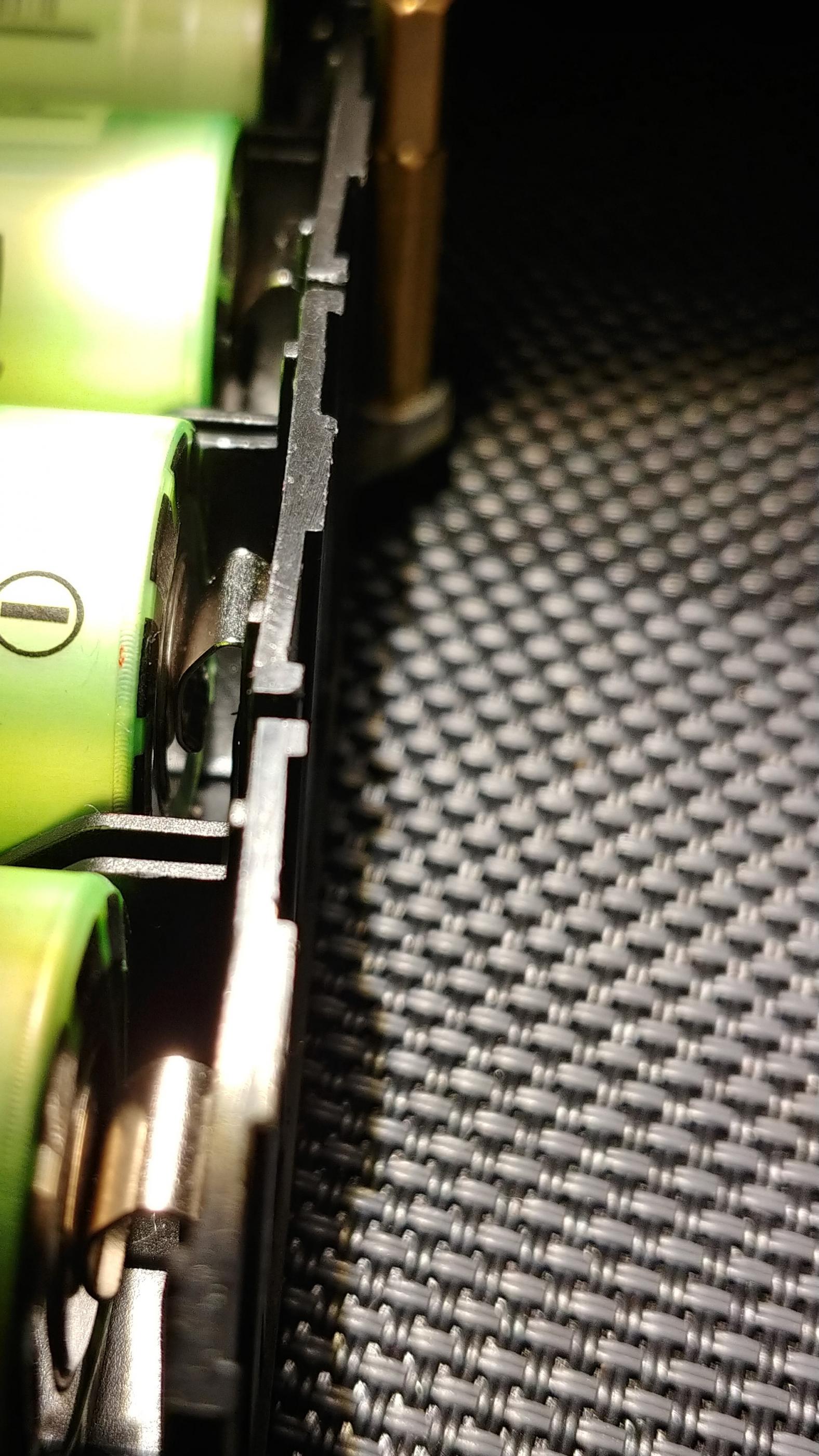

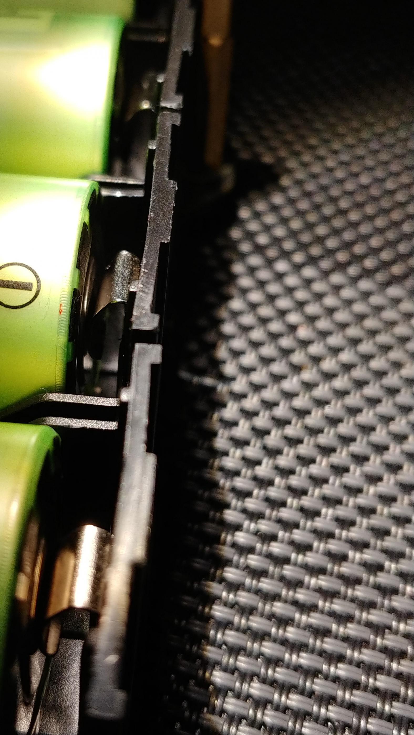

Here is what I discovered:
When measuring voltage from holder terminals, not touching the batteries but only holder terminal, all give correct reading of 3,25V (when unit is ON!).
But when pushing down and forcing the holder terminal against the battery, the power supply does similar clicking sound, like when turning on. This happens with multiple battery holders, but not all.
Also I'm able to create the same clicking noise while gently pushing the battery holder sides (+ & -) with fingers, pressing the terminals against battery.
So does that mean, that there is problem with battery connection to the holder terminals? Not sure how I can fix this. Tried to bend holder terminal to provide more force but this did not resolve the issue.
The plastic cover of the battery sticks out at the bottom so the metal plate effectively sinks lower and the battery holder terminal might not be making contact. It seems that has been a problem for few people and might explain the clicking sounds when you are pressing on the holders.
Just to be sure I re-soldered the battery holders. Pushed the holder terminal (metal part) down while soldering. I hope this is the right way to do it.
To be honest, I don't exactly understand the "barely elevated plastic in the center of the negative terminal causing discontinuity".

Visually all the connections look good, made some photos.
If the connection would be bad, then measuring from the terminal (when unit is ON) should give 0, but not 3,25V. All of the readings are OK.

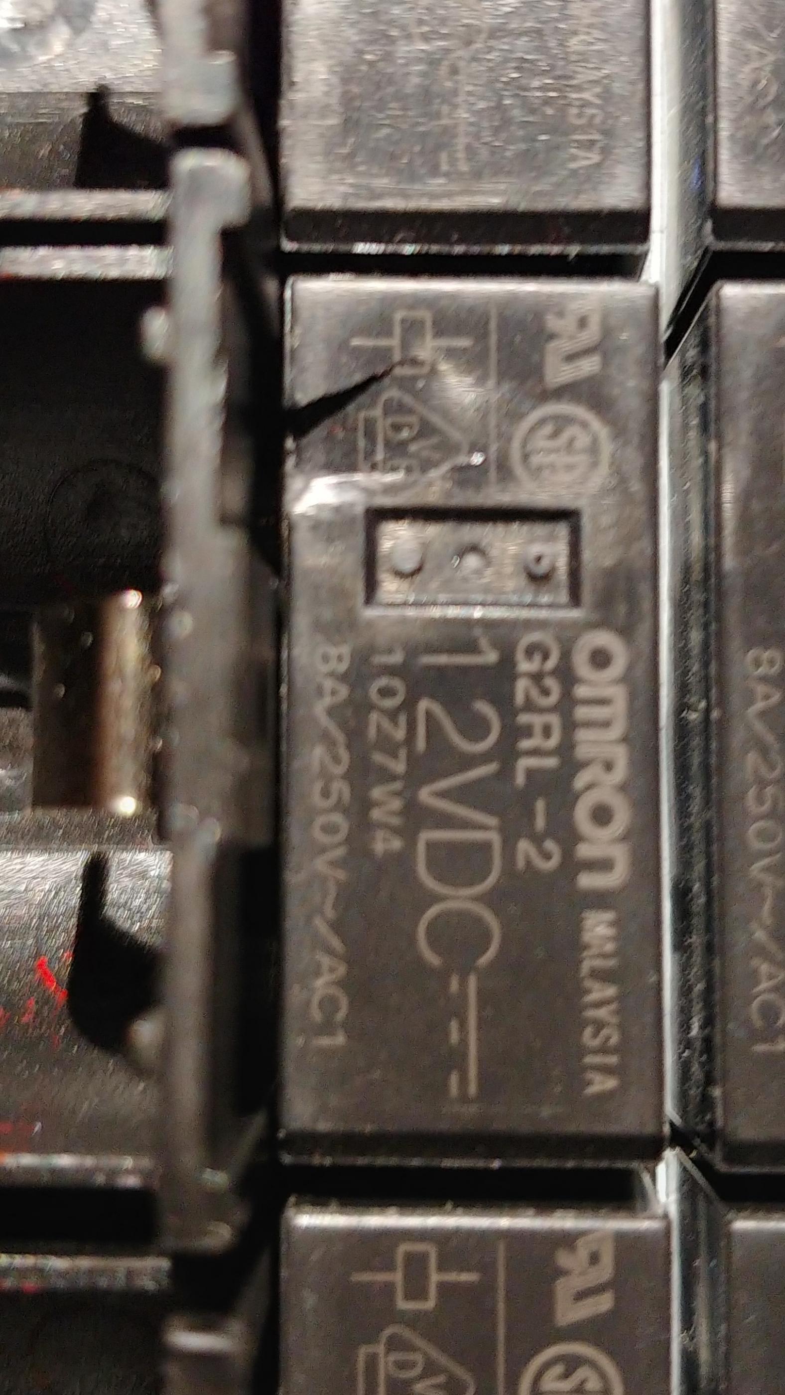

Re-solder all relays and see if it solve your problem.
Thanks for the suggestion. Did that, but no change. One of the relays seems to be damaged. I didn't notice it before, so not sure, how long it's been like that. Added a photo.
I should probably change it? Any hints, how to get it removed. It' has 8 connection points :)
Joined 2003
Having tried to do that, I found it is nearly impossible without damaging the board. I had used solder wick to remove all of the solder from the board bottom side of the relay pins and pins on the top side were still soldered to the pads there. I could repair the board, but don't recommend this.
Ian may have a better suggestion. Me, I'd go buy 2-3 of those relays, then use a pair of pliers to crush one apart from the top to see how they break. Then I'd VERY CAREFULLY do that with the damaged one on the board to get down to where I could unsolder and remove each pin seperately.
Wait until you hear from Ian before attempting this! Again, he might have a better idea!
Hi nielsek,
What happened to it? Poor relay:confused:
The PCB of LifePO4 board is very special. It has double thickness copper layers (For high current application).
What Greg said is correct, it's really hard to replace it. You will need a Vacuum desoldering gun. Can you access that tool?
Ian
This is the board where I accidentally put one battery in wrong polarity and blew a resistor (Post 642). Once I changed it, I got the the board working/charging. I only used the first two rails. Now when wanted to use the other ones, found out they are not working.
About the broken relay, I have no idea how it got physically damaged. Maybe, when I resoldered all the holders.
I have a simple vacuum desoldering device, but with that one it's hard to succeed.
Is it possible to check the relays? Both of the rails (J3 and J4) act the same.

@Nielsek,
Sorry about the issue.
You can find the datasheet from the P/N of the relays. So you may check the connections in both ON and OFF states.
Don't try to remove the relay if you don't have suitable tools.
Ian
I've found that components like the relay that are super difficult to get out in one go are best removed by very carefully completely destroying the case with something like a dremel. Reduce it to just the contacts with a cutter. That way you minimise the heating and can tackle one through hole at a time.
