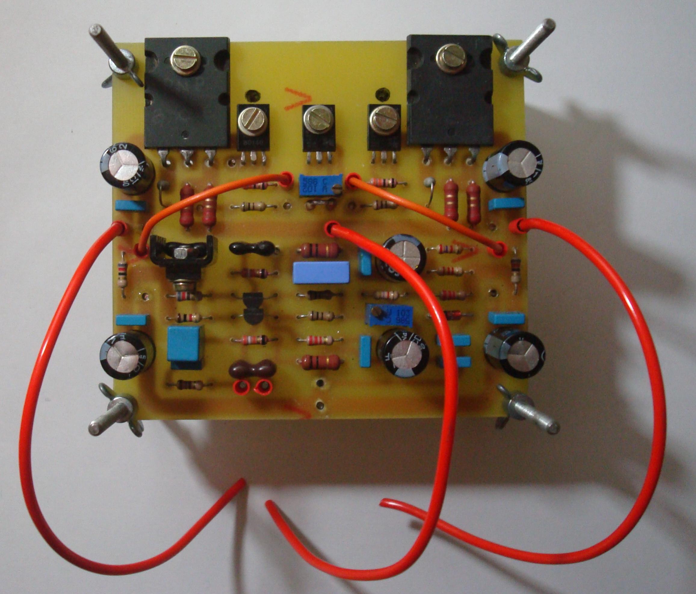

We still have people building the Dx amplifier
This was made last week in São Paulo.

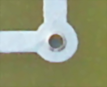

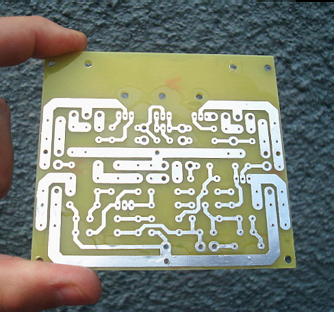

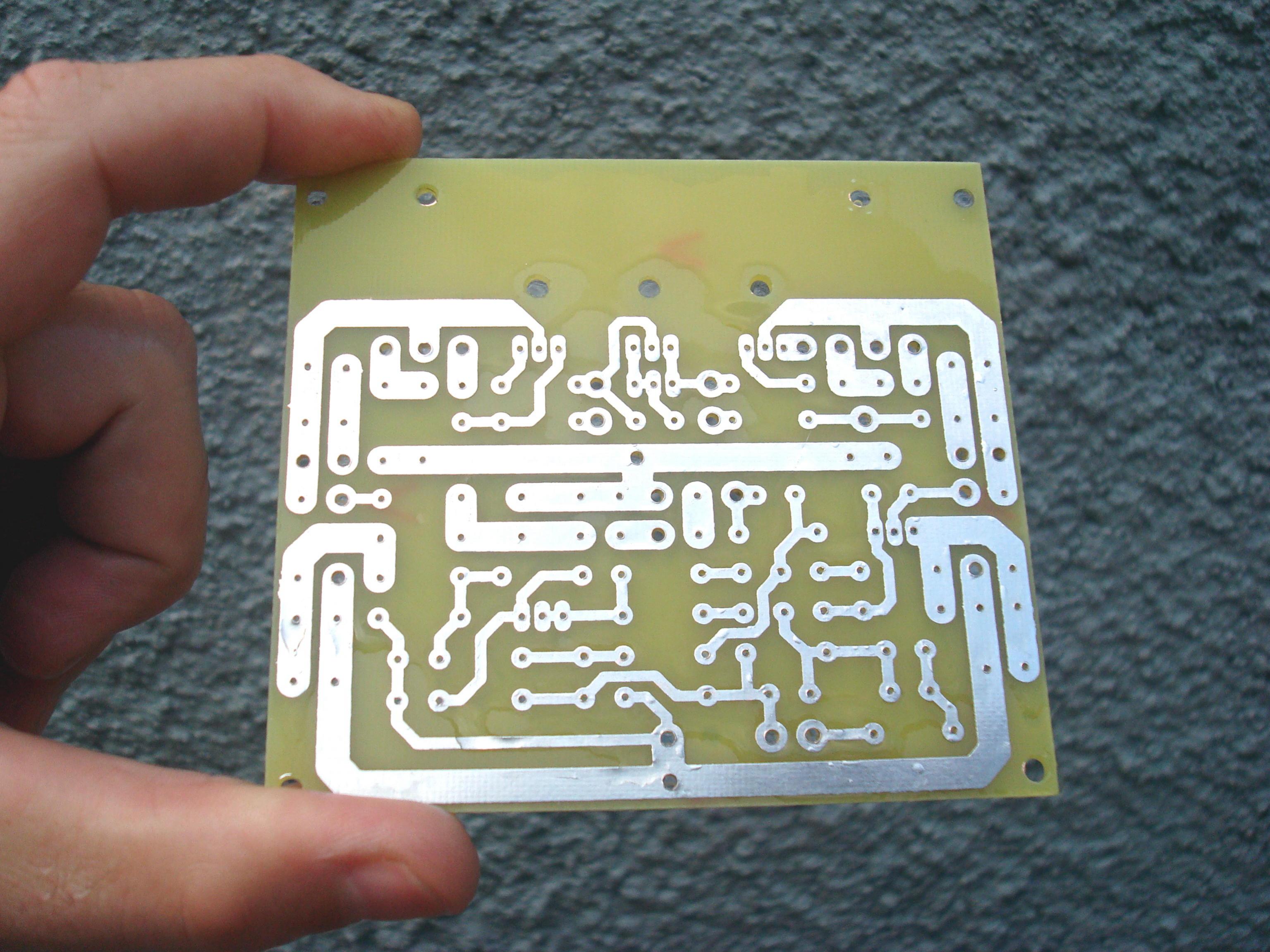

Herman will produce pcboards to the Dx amplifier
This is part of my effort to "cut out the wings of pirates".... having my own people offering they will be in troubles to sell their non authorized stuff...also i have asked Herman to offer by a low price.
If someone wants a "Classic" audio amplifier, from the seventies..then go direct to him, i do not need to know..this is in between you and Herman.
He is not that good with english but he has translator.
I will help and will give follow up....pcboards are from Herman but the amplifier is my son.
garudazero@gmail.com
regards,
Carlos

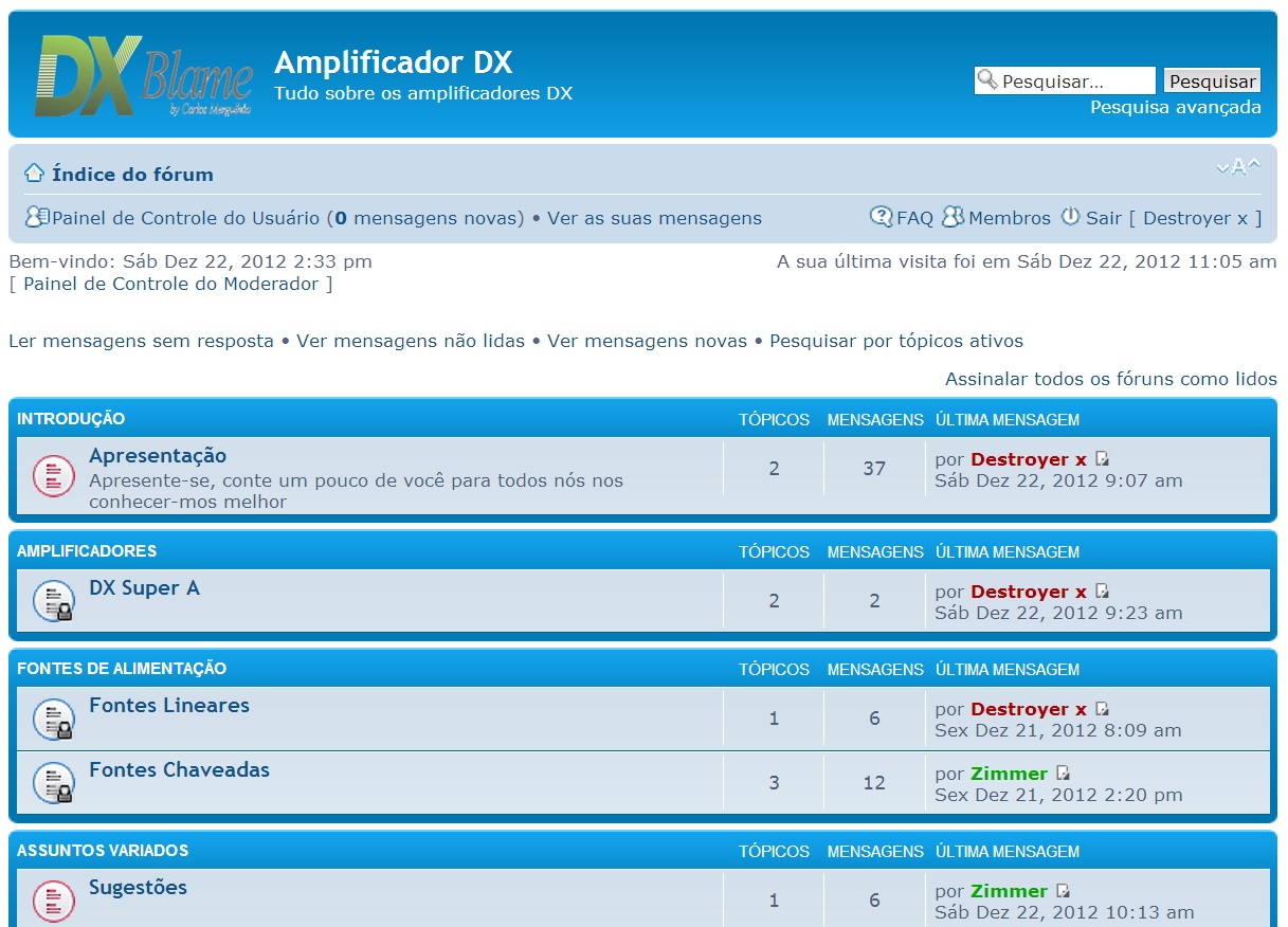

Uncle Charlie has now his own forum... Dx amp forum
Uncle charlie has a forum.
You are welcome...there you can post translating from google.... Dx Super A, Analogic power supply, Dx speaker kit + enclosure, Dx Zimmer SMPS Supply (Kraftwerk), and Mini MAKO (the amplifier from the hell...high power crazy machine) will be developed there.
I will not leave the other 8 foruns i am working with....i will just start mine own.
I week and 50 guys already there...very good for one week..i am proud about these results...this means i will have thousand in a year... 5000 in the second year and will reach the diyaudio fourm in 12 years
Please, subscribe to help uncle charlie to obtain great numbers of subscribers... even if you do not intend to be reading in portuguese...this helps...when people see big number of members, then they believe the forum is good....and this i not untrue...the good ones are really highly populated.
It is a new style.... it is forbidden to forbid... there you can have double registers...you can have double personality, there you can say words, to call people names...moderators cannot banish, great developers of circuits are more important than buggers and everyone manage his own thread.... can buy or sell... can talk about politics and religion, also can fight..no problems..you can be natural, human and no one will use cop hat there...pictures the size you want..if you want of topic...no problem....you will be tollerated till you perceive yourself the mess and will start a new thread fixing all the mess.... new projects will start there..will be published in other foruns with 3 months delay.
Here is the adress...you are all welcome to visit us.... it is in portuguese...but schematics, pictures and videos have no language..we all can understand schematic..having doubt i can answer you in Portuguese, Spanish, French and English..... welcome everyone from the International community:
Amplificador DX • Índice
regards,
Carlos

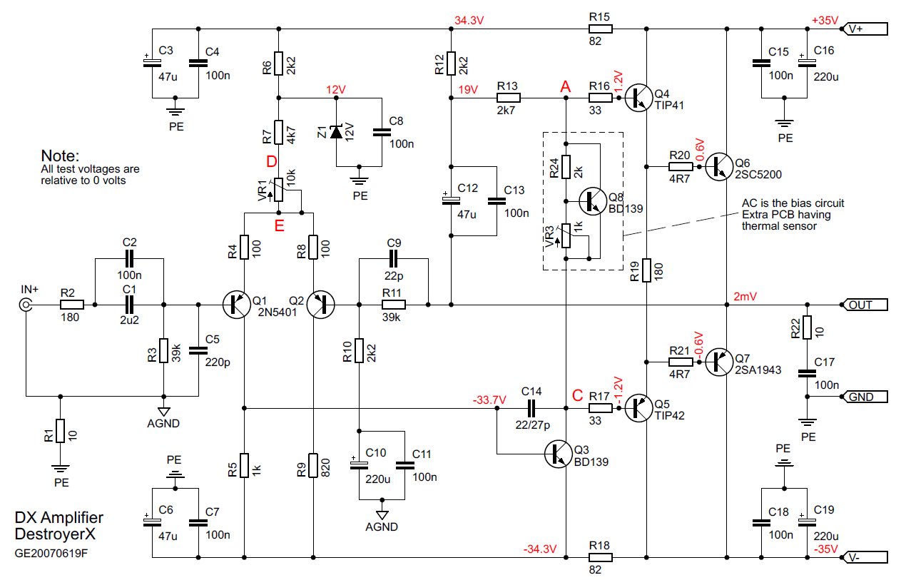

Hi all!
I want to replace the output transistors 2sc5200/2sa1943 a pair MJ15003/Mj15004!? What changes should I do in the schematics?😕🙄
Thanks for your help!
