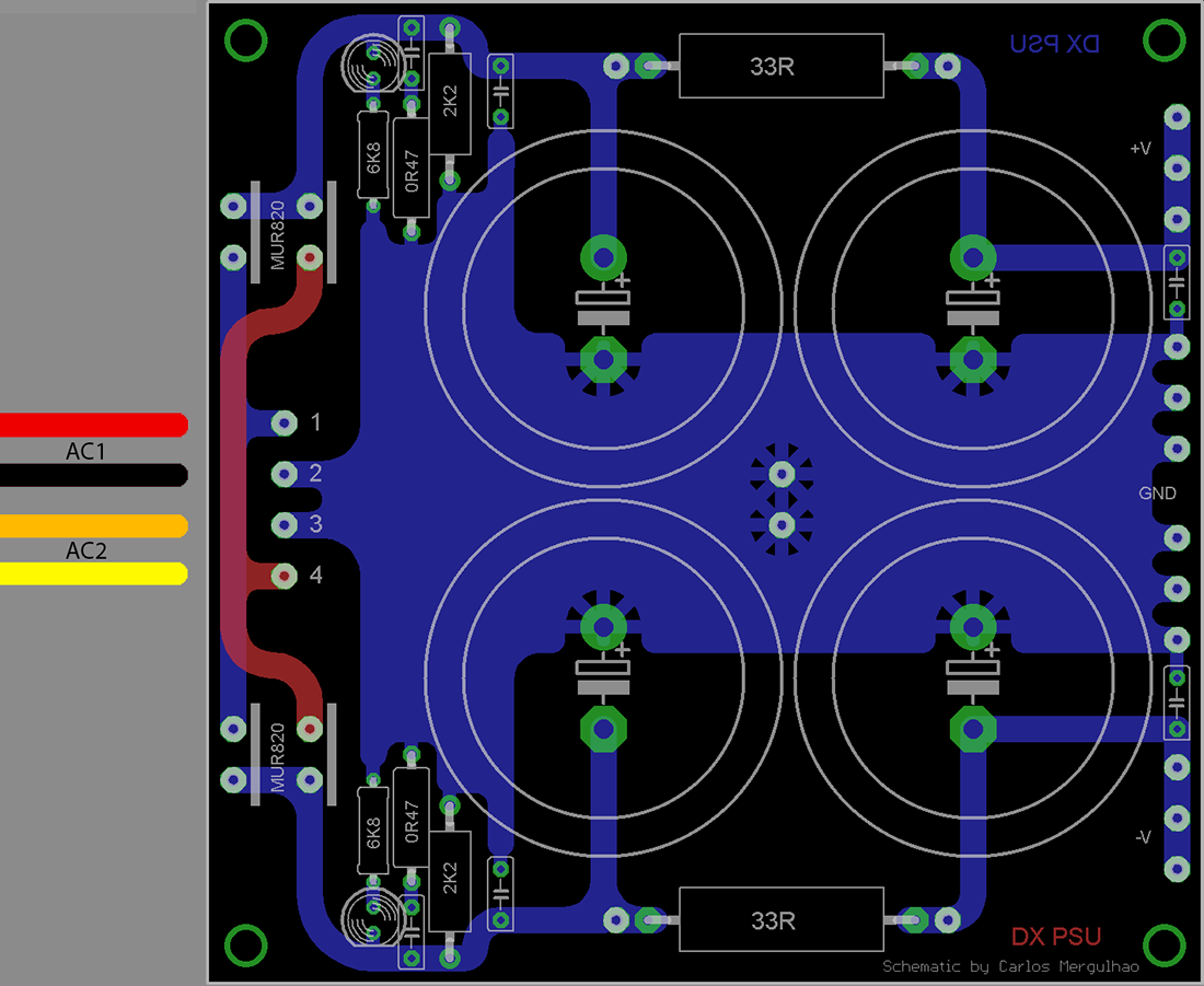

@vargasmongo3435:
Do not forget and post the attached picture - and: No: this PCB does not have any errors.

P.S. Wind a coil around the resistor (!!) - resulting in a PI-filter!

I wandering guys. what is the purpose of those inductors coils around the resistors I never ask before.
Regards
vargas
Regards
vargas
They are filters Juan.

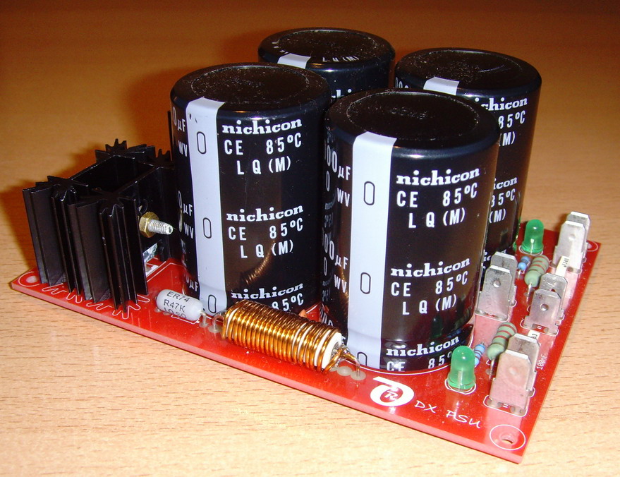

Carlos, in your psu bom, there are two sets of R7/R8 (3R3 and 33R). but first set is not shown in the schematic. should i omit the first set?
also i have 0.6 mm enamelled copper wire, may i use it instead of 1 mm? if it so how many turns should i do?
thanks..
thanks..
33 ohms is fine..... was an upgrade..... about turns
from 12 to 33 will be fine.... you decide if you want several layers or not.
Your wire will be good too...no problems..short lenght, even this smaller diameter wire will not create resistance.
This is not critical...it is there "just in case" you have noises in the rails...as usually we do not have noises in the rail...they do nothing almost all the time.

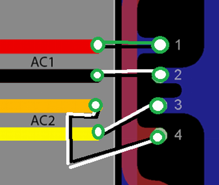

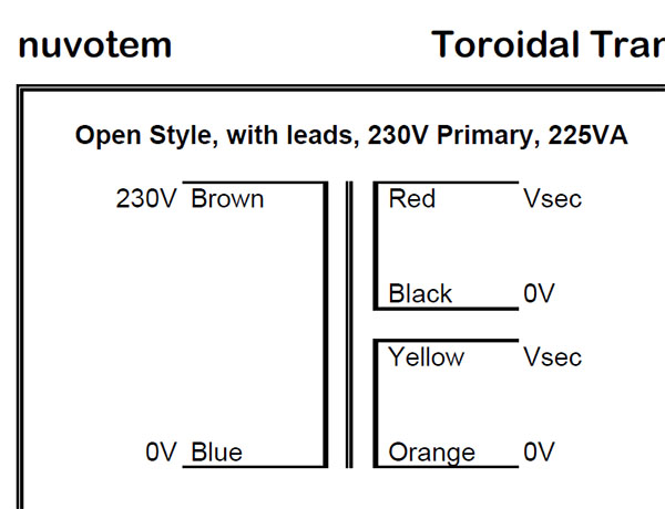

Hi all,
i have one more question about Carlos's psu.. i have this transformer which has twin secondaries and according to the datasheet, this is what i am planning to wire it to the ps board.. i'm not familiar with high voltages and double checking everything, so i need your confirmation.. thanks..
I am sorry about the delay to answer...i was too much busy
to be reading our forum.
regards,
Carlos
