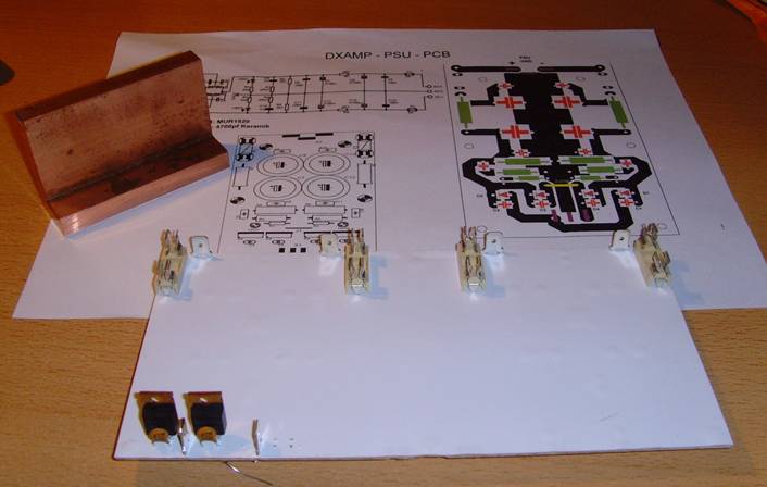

Rudi is producing a Dx Amplifier...at the moment, the supply is beeing planed

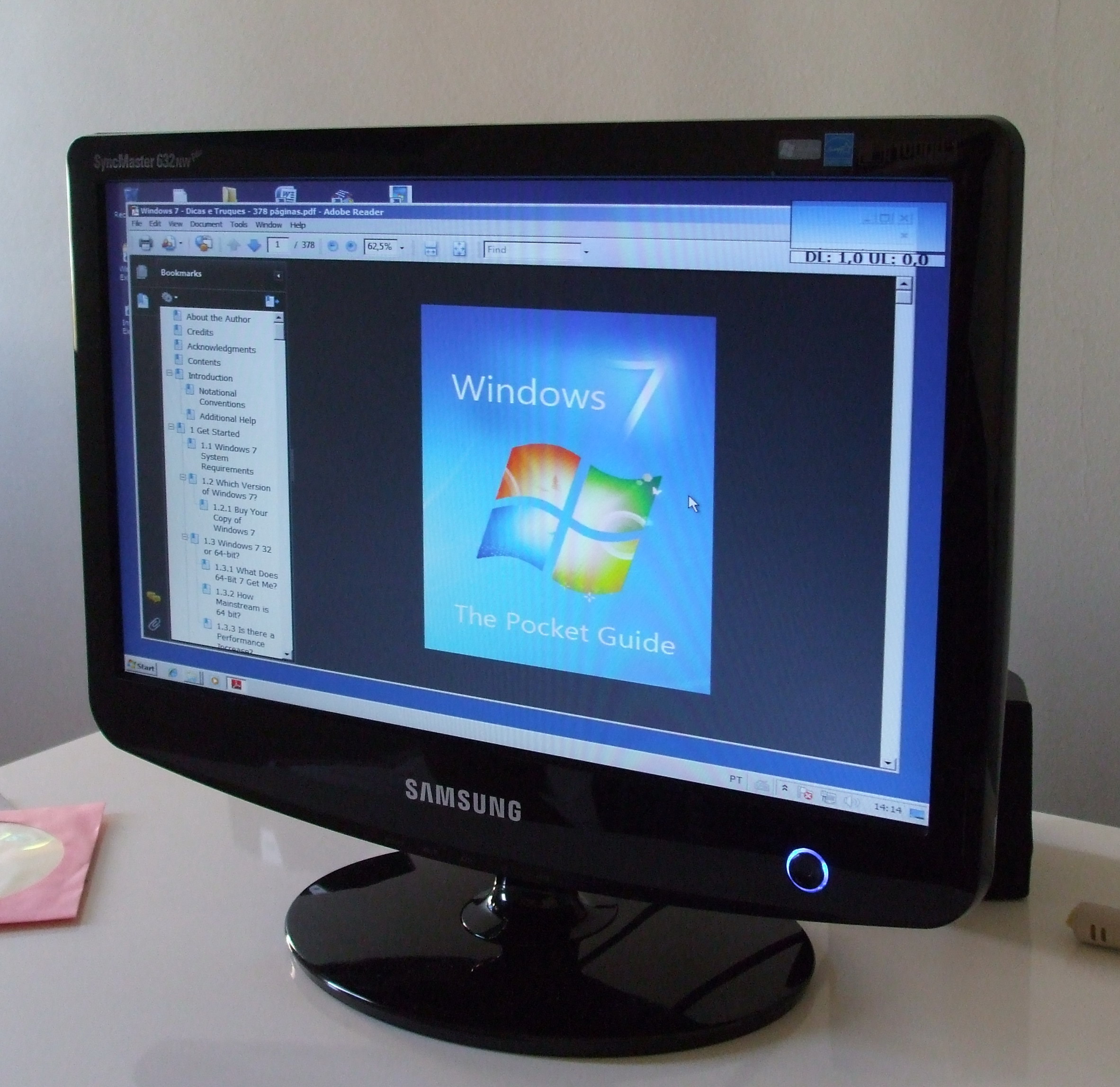

And i am working hard installing Windows 7.... troubles with audio drivers to my Asus mother board (KV8-MX, chip AD1888, soundmax).
Be happy folks...i am trying..but Windows is asking that..and a lot of other things..also asking if i am sure....and asking if i can be happy or not.
ahahahahah!

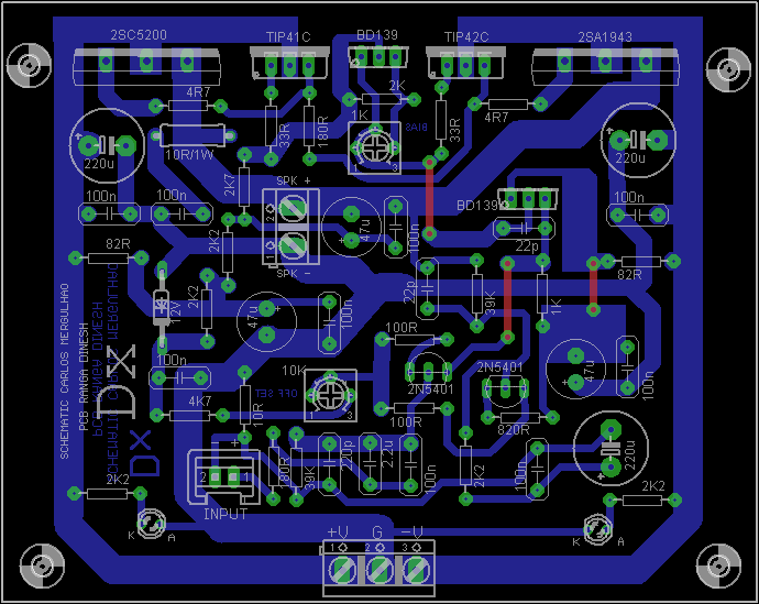

I never knew DX is such a good amp. I built it and powered.. you all have done a great job.. it produces sounds very balance to ear, no doubt why Dx rocks. My meters do not support millivolt range (minimum is 10 DCV). im gonna buy a new good one recently. until then I could able to adjust it by touching the heat sink and by giving a small input signal.. it works fine no much heat with 4 ohms load and no clipping no noise and no distortions.
I have a problem that my input sources are changing and they are not stable always. further my input audio signals are not balance always since I used to listen various sounds music, songs, sound effects etc from my notebook and the USB reader. when I play by my notebook, sounds so good. but my USB reader doesnt produce good bass as my notebook. So I'm thinking of a preamp which to adjust bass, tone and treble with left-right balance. I'm looking for a good project in DIY forums but still I couldn't find a good project like Dx. Can anybody help me with this?

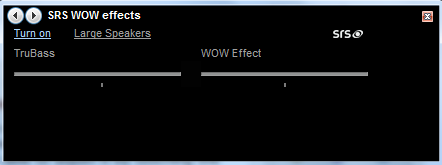

Dx further rocks with SRS WOW sound effect (SRS Labs) on windows media player. If someone knows a project to produce sound effects like that, please let me know.

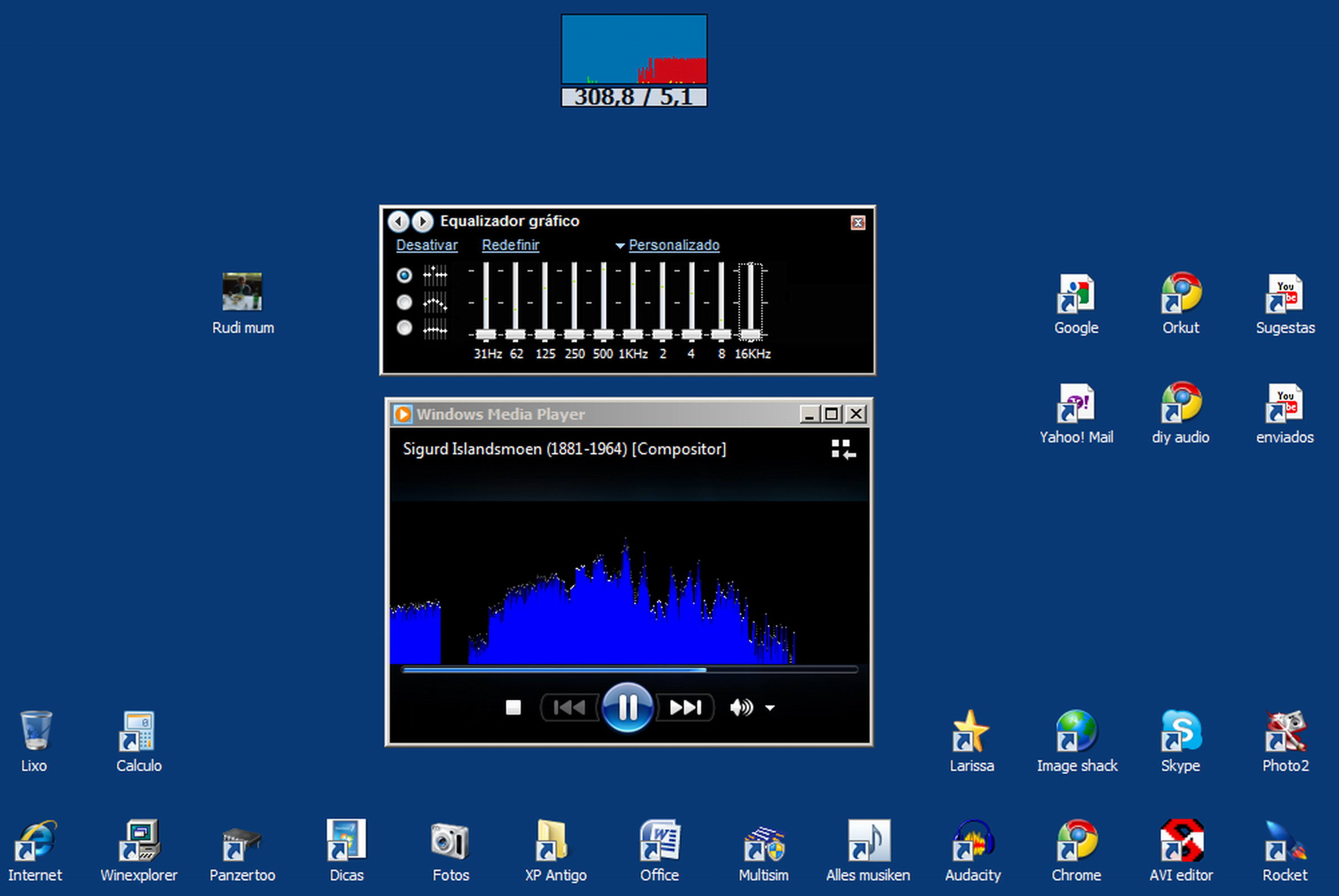

Sounds nice.... you can increase your bass using Windows Media Player feature.
I have fixed my trouble..but i found i have saturation while using equalizer (increasing levels)..also i found that high quality and high volume recordings produces awfull distortions..so...i will operate alike you see..to be rid from troubles and will introduce one gain stage into the TriAmp input.
My Windows 7 is Ultimate, build 7300.... was released a week ago... october 20... i am happy..it is precise...reliable...also fast with my old Sempron 1.6 Gigahertz (Sempron 2600)...and old Asus mother board...very old stuff operating fine using 1 Gigabytes of ram memory...a poor man computer, but working fast as a ligthning!

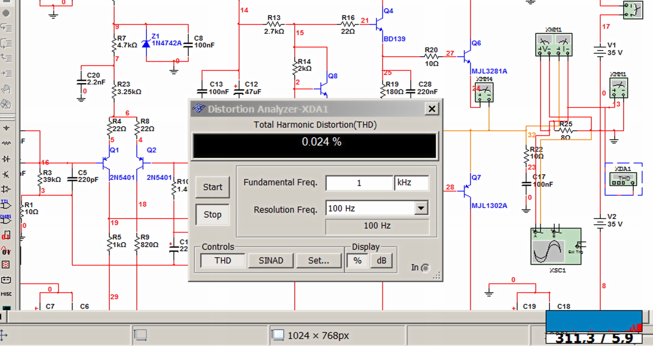

Dx Amplifier, the standard one, THD measured into the Multisim.
I really do not bother with that...but i remember was low...will simulate and will post the numbers for you.
Dx Amplifiers sounds good....maybe, and by accident, may measured good too..but i ensure you i have not worried about that when tuning the unit using ears....for accident... a lucky result..... not bad results on numbers.

THD numbers means the amplifier MAY perform fine.....not real...i have assembled a couple of thousands during almost half century doing.... and i found amplifiers with very low THD sounding bad...and i have found high THD sounding fine...in the reality..the higher ones use to sound more interesting to MY ears.
My amplifiers sounds very good.... the bootstrapp technologie sounds excelent...not mine creation..this was made down the seventies (1969 i think)...and several versions and copies are around..all factories..Pioneer, Kenwood, Marantz, Sansui ...well... all them have made amplifier with this circuit inside...now a days there are some that is doing this way... even chip factories...inside the LM3886....or other number..the circuit is not so different..has some CCS...has quasi complementary...but the style is there...the approved style..the good sonic style.....
In our forum there are many.....there are 11 alike....variations around the same theme...all them very good.
Here you have numbers..... for accident, i repeat, sounded good with those numbers....but usually, those small numbers shows stérile, liveless sound..alike food without salt.... alike a very beautifull and cold woman.
Usually people does not perceive distortion when it is bellow 0.2 percent.... i cannot...my threshold is this one.....ALSO...speaker distorts a lot more than that....hard to perceive 0.2 from amplifier when speaker is producing 1 percent or much more (magic speaker produces only 1 percent)

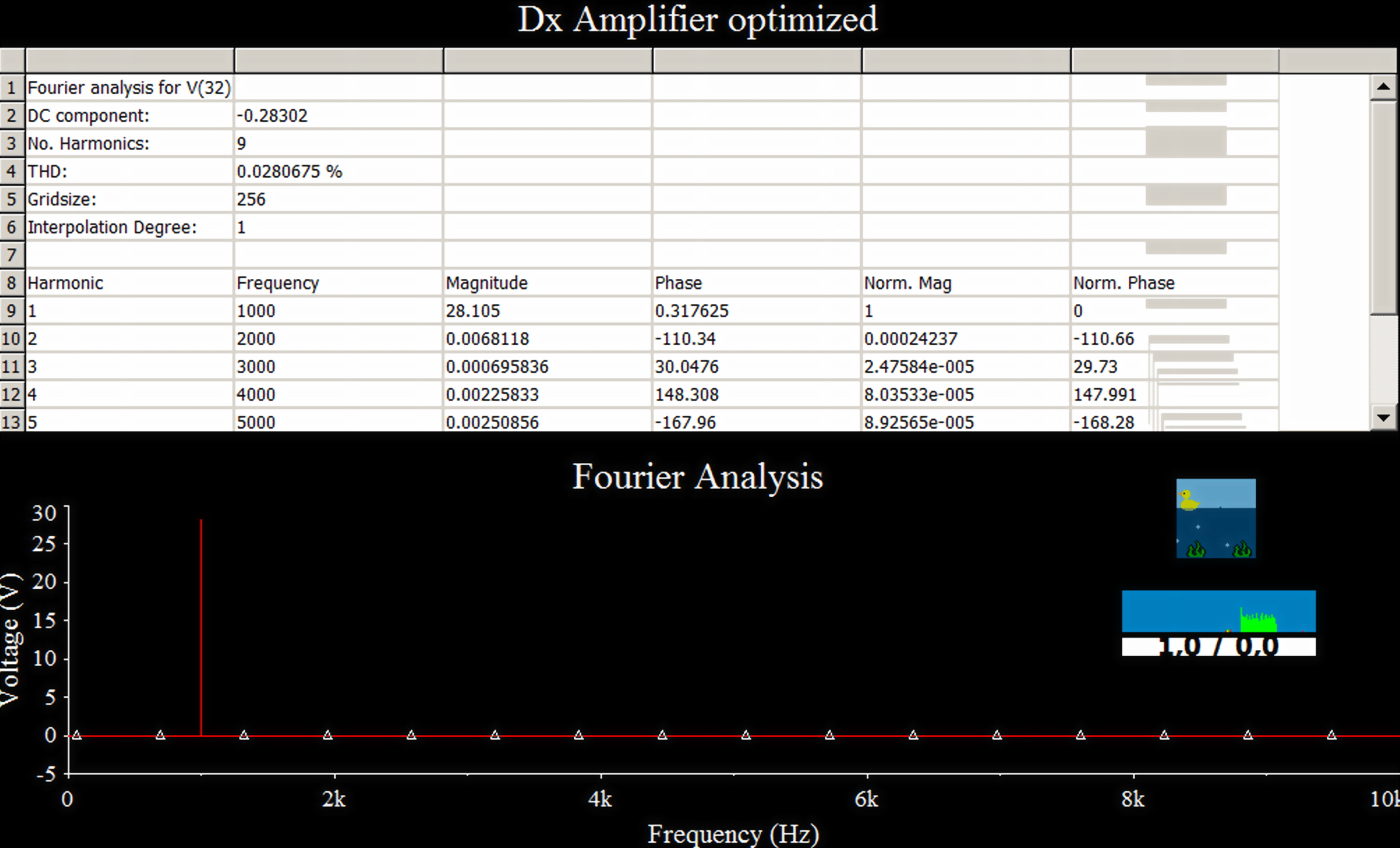

Nitrozx..... there are other amplifiers, in this same forum, that offers lowest
distortion numbers..there are chips offering 0.0002% or even less (sounding terrible...colour into the sonics).
Kleinschmidt made one very sophisticated.... also Bigun.... also Patchwork from MJL21193, also Ostripper, Quasi..and many, many others.....you have a superior one..the Krill sounds better....a little better...but this "a little" means price increasing 20 times..amplifiers jump from 1K US Dollars to 20K USD because this small increase in audio quality....Krill is very good.
To buy ready..... then go to Aksa.
My amplifier was not made thinking on small THD numbers..was not the target...i wanted lower than 0.5%..... resulted around 0.033% and a friend have made reseach to reduce it to 0.022%..... i found no difference.... Aksa may distort more and is unbeatable (my point of view, about sonics..not numbers).
I could beat Aksa...not because my amplifiers..because the TriAmp system...using smaller bandwidth to each one of those three amplifiers, i had, as a result, better sonics...i do not know why..maybe frequencies beating one each other...also i had easier tonal balance, but this, you can achieve with any amplifiers..the one you have will fit.....three Aksas in this same condition will produce better treble and mids..will loose into the bass only.

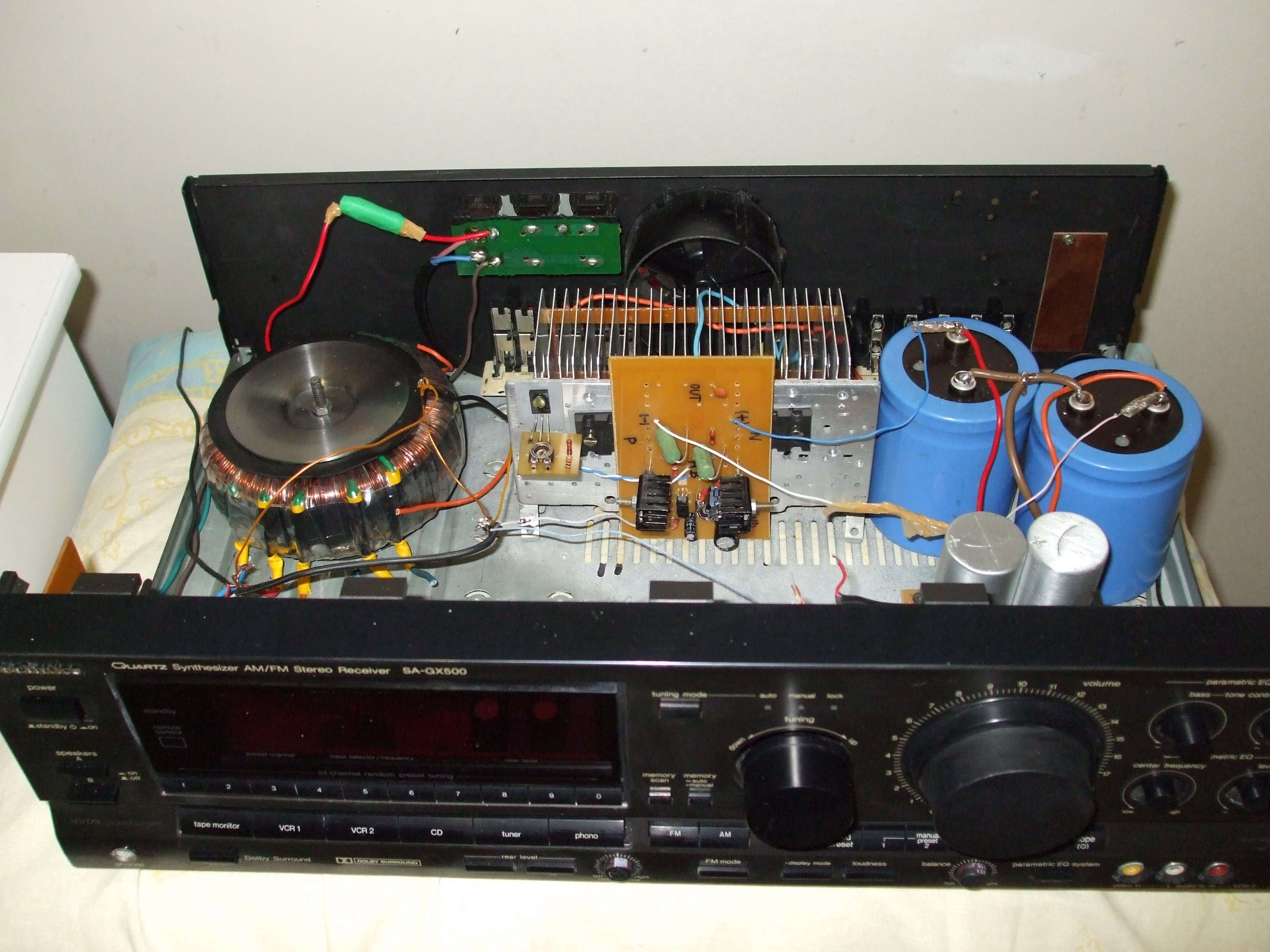

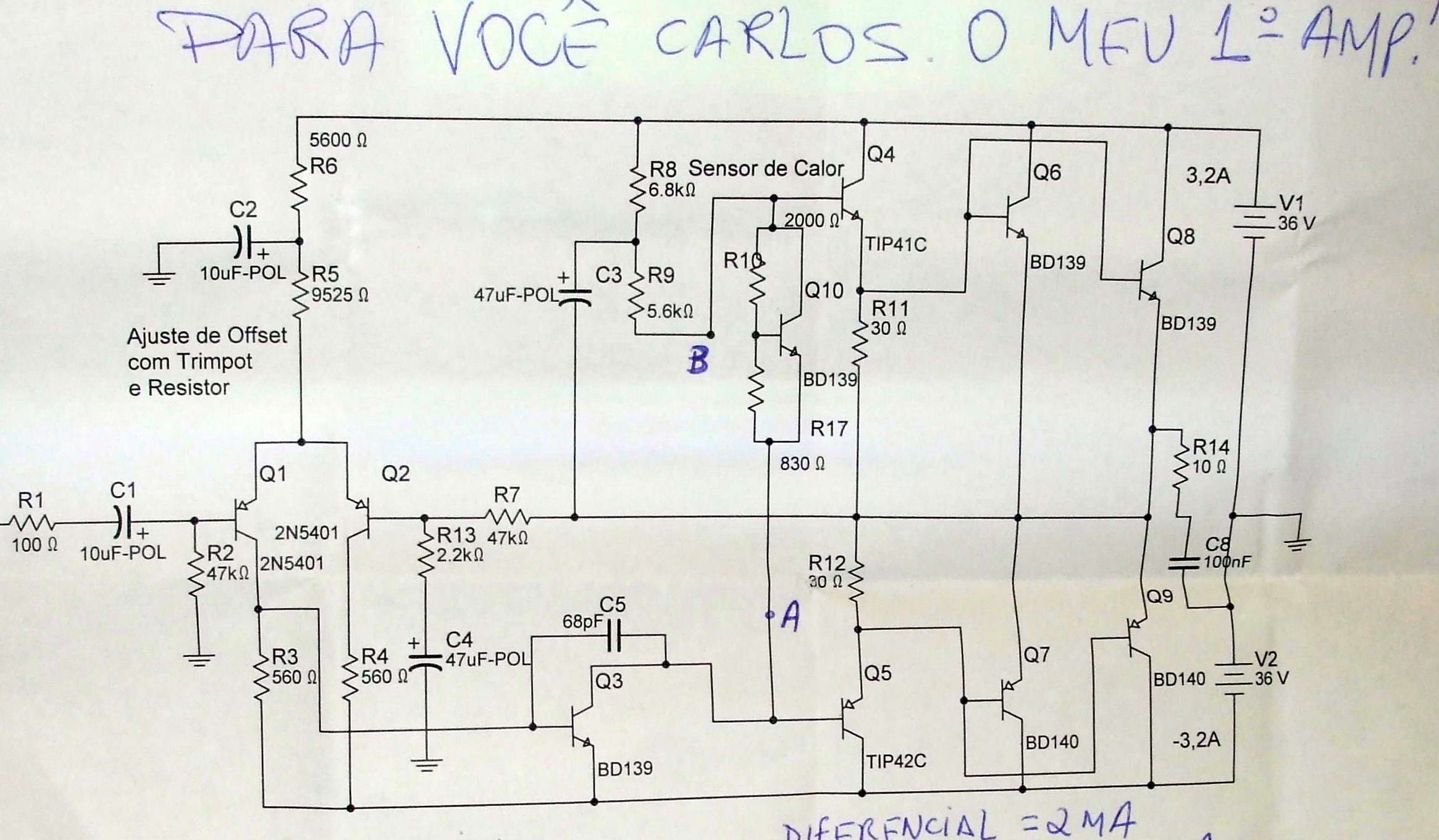

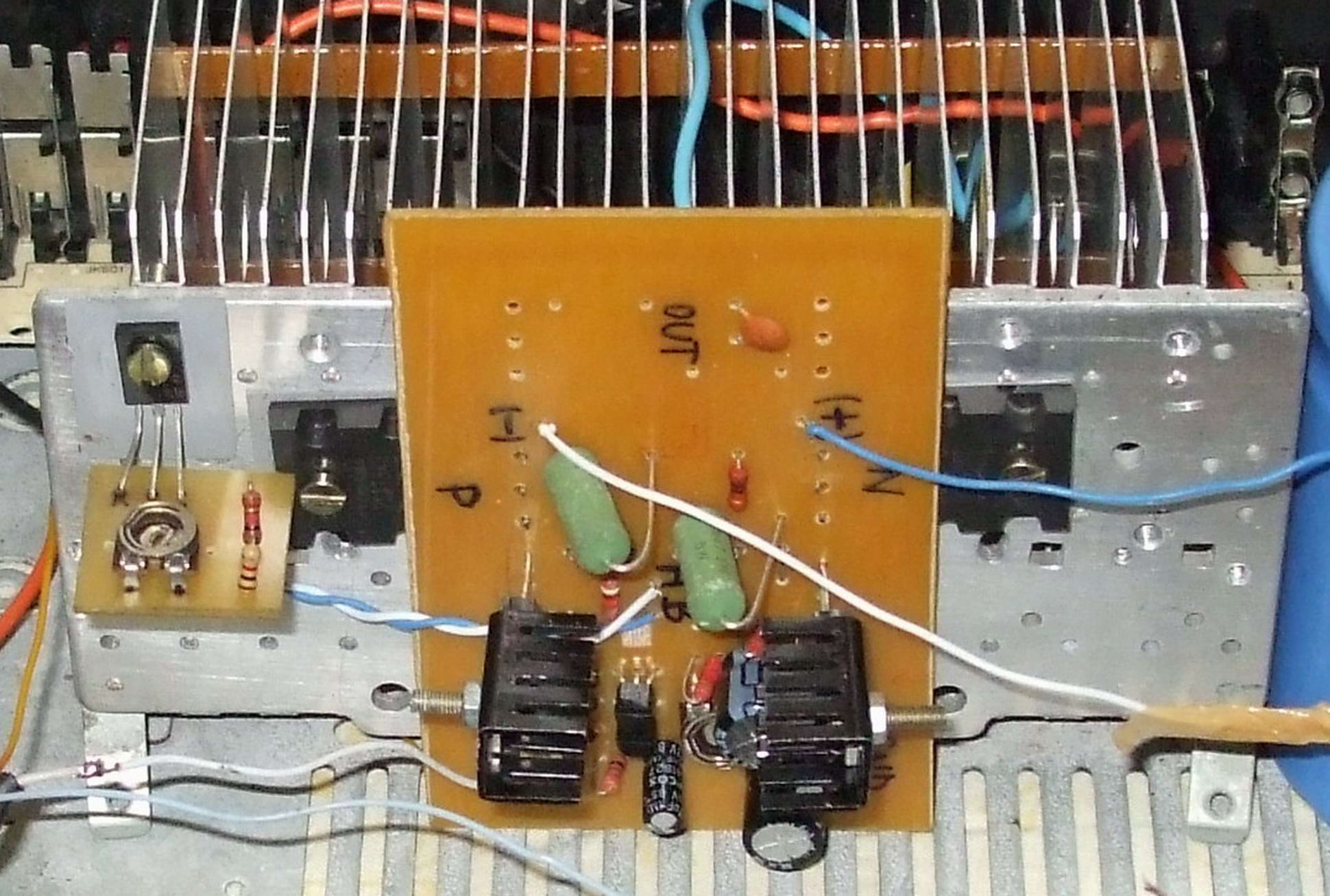

A friend, one Orkut student that use to visit my classroom, where i try to show them how to calculate simple amplifiers.
He made this one...i was listening the unit today.... He is from Amazon state, where we have the Amazon river.
This amplifier have not sounded good, there are errors in current, parts missed...well, just a basic thing to learn how to calculate and to transform an idea into a real sounding circuit.
Also the output used was not the one shown.
