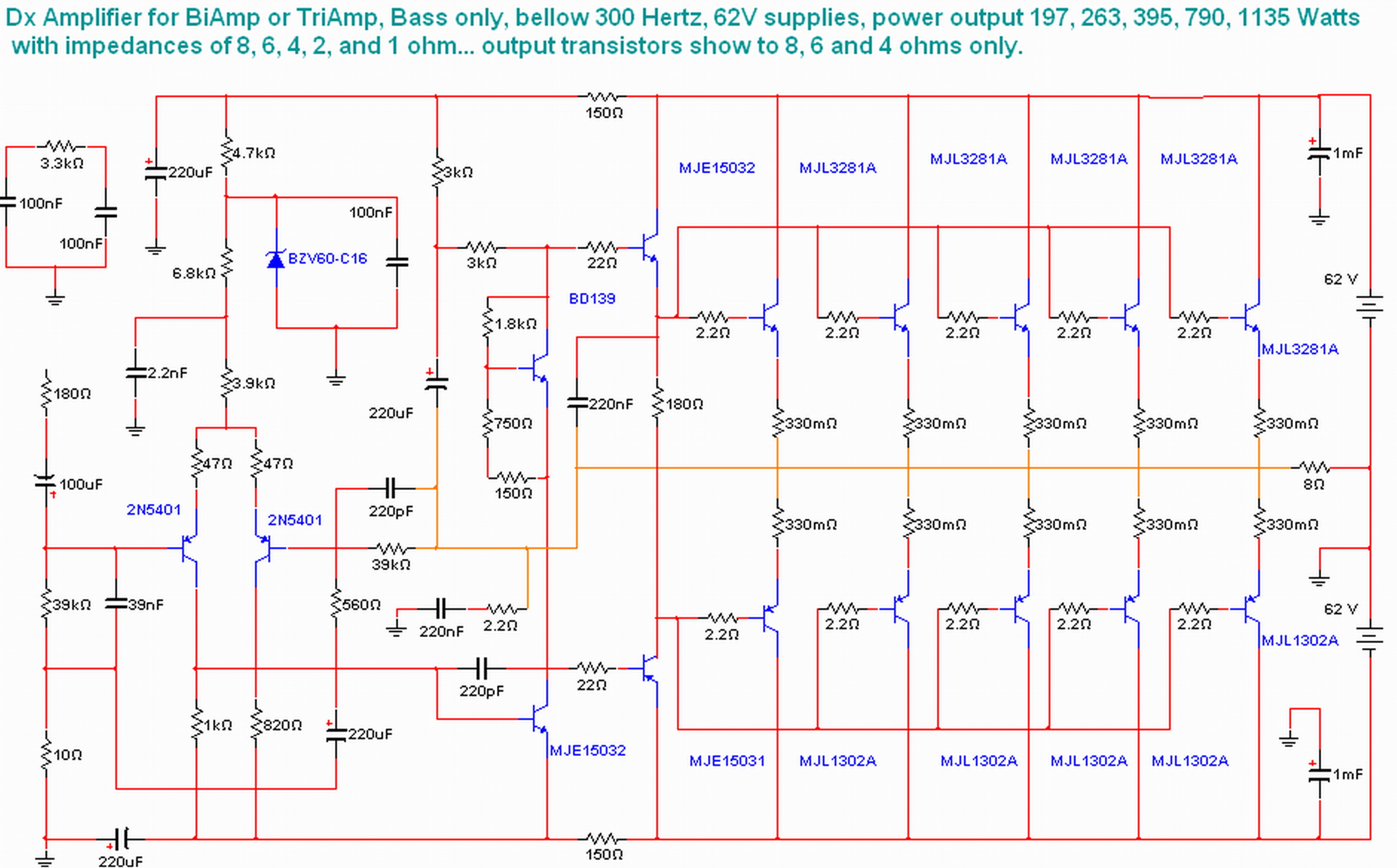

What a great idea uncle Carlos:bulb: DHR Turbo is a super amp that I have tested too and a power hunger that will a very good solution for a sub-amp. but If you can make DX to handle more power (by making it 62v) that will be a great idea for my purpose. Im looking for a clear punch like DHR turbo but a little bit of high bass level. I wanna destroy my 200W woofer :D
Dear uncle Carlos, my filter has 2 stages.. first stage it cutoff all high frequencies above 200. 2nd stage it has a potentiometer to select the desired frequency between 40-160Hz with a notch filter.. after redesign the DX to 62v, please tell me if there any modifications of DX to tweak which to fit my requirements because your amps are good for all bass mid and trebles.

Thank you Lycanlk...here you have the schematic.
I will post, very soon, a description about current, voltage, power, off set, adjustments , transistor suggestions and more details.
Schematic has some transistors, just to point you some..others may fit and i will suggest others than the ones show into the schematic.
Details will be posted soon...including supply condensers...long text will come!
Also will point parts outside the Dx Amplifier board...this is a Dx amplifier with some resistances changed..to use the same published board you can see into the Greg Erskine pages.... this is a Dx Standard, the one is super reliable, hardly tested and many times guaranteed, with the down signature made by several folks that have built.
It is for Bass purposes only.... 1 hertz to 300 Hertz (-3dB), uses a passive filter into the input.... parts that are not into the Dx Amplifier schematic will be marked colour and different values will be marked too.
Made to BiAmp or TriAmp...with passive input filter or active input filter..sensitivity was adjusted to 1 Volt RMS of audio into the input.
More than 1.1 Kilowatt of power is possible, over 1 ohms load, having 62 volts supplies able to put out 15 amperes to each rail...using 20 pairs of output transistors.

Carlos, are you planning to use MJE..and MJL.. instead of 2SC.. and 2SA... ?
No!... i am not planing to use other transistors than the ones i have
I have 2SC5200 and 2SA1943
Also i have Fairchild j4215 and j4315
Into simulators i use MJ transistors because my simulator had not other transistors than those ones.
But the standard power output transistors to my amplifiers are always 2SC5200 and 2SA1943
The standard driver transistor to high voltage units are 2SA1837 and 2SC4793
The standard driver transistor to low voltage units are BD139 and BD140
To the differential, BC556 to low voltage and 2N5401 to high voltage amplifiers.
those are guaranteed... to my own home things i use the ones are available, but i suggest to you to use, only those ones..because they are good and were hardly tested.
