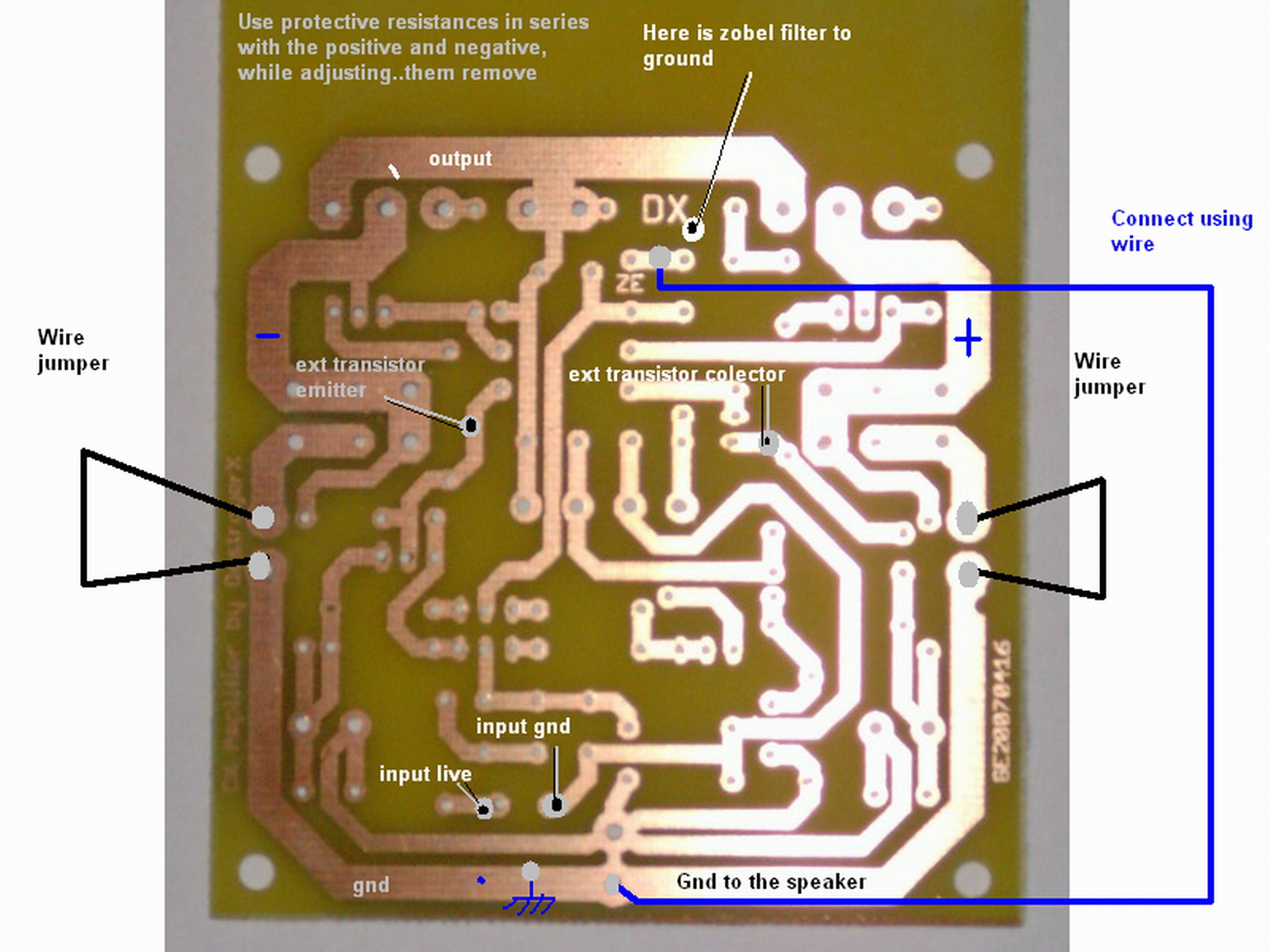

For a DIY - Newbie like me it is very hard to get into the DIY - business.
Since NORDIC's "shop" (www.dxamp.com) is offline, I decided to etch the PCBs myself. After a lot of time (and some failures) I finally suceeded.
Now I have to drill the holes into the PCBs, but since I only own a 1000 Watt drillhammer I have to buy some suitable equipment.
This morning I read that the layout of the PCBs which I took from Greg's site is not the current one.
In the meanwhile there exists a DXAMP II PCB-layout. 😱
Shall I continue nevertheless continue or wait for Nordic's return?
Best regards from Hamburg/Germany - Rudi_Ratlos

Dear Rudi...there are some connections under the board
there are two wire jumpers...also you have to run a wire from the zobel filter output capacitor to ground...you see the blue one into the image....the big blue one is the zobel filter capacitor.
also other indications are show into the board image..your board picture with something written over.

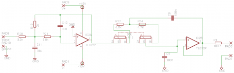

I'm thinking of DX with a bass filter
I'm was looking for a subwoofer amplifier a long time back.. Currently I have a simple Sub-Amplifier which is driven by TIP33c and TIP34c. But not that powered like DX for sure. This is an effort to redesign DX amp with a lowpass filter. Still not completed. AS I have mentioned I'm not a good designer and not good at electronics as well but just giving a try to do something that make me happy 😀
lowpass filter is my own creation with help of a lot of web stuff.. it is not tested.. pls do not try it yet.. wanna fine tune the board.. So tired looking at the screen..
Thank you Lycanlk....nice amplifier and very good low pass active filter
I hope you build and tell us how your unit sounded.
