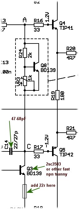

What's the need of that 22 ohms resistance into the VAS emitter

Hi dear DX,
The circuit I mentioned is not a SMPS, but it switches anyway, he, he...
http://picasaweb.google.com/lh/photo/rOgiSl8IVgPdqOcKLPkbNA?feat=directlink
I will use -ECdesigns-' own words to explain the circuit I robbed him for high power purposes...
I did not add yet the capacitance multiplier part of the circuit ( built until C2).
He has a potentially better "floating" version also.
http://picasaweb.google.com/lh/photo/UyHCdD9B2QkYmc8HPORBqg?feat=directlink
All active parts' values have to be increased to meet high power/high voltage demands.
I have posted a photo of this mod on the DX HRII thread before:
http://picasaweb.google.com/lh/photo/if0Yt3ku1R4vGDMHNErStA?feat=directlink
This mod enhances transparency, detail, and all the goods you mentioned about AKSA, but the bass and warmth became lesser (probably psychoacoustic effect of increasing the high of the spectrum). Now I am slowly increasing the bias and the warmth returned. I am now at +/-127mA for 630mV at the bases of the power transistors. Today I planned to go to 640mV at the bases.
The mod is done as per the schematics because I am not able to optimise it myself... 🙁
Hi max
Not to be taken as criticism, but I have never liked to increase bias on a AB amps
I know many people say that, about sounding warmer
But to me it just sound more muffled

Ehhh, original 2N5401 is PNP, and the substitute BC### is NPN, or did I get something wrong

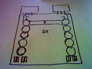

This is what I hope to achieve
Just have to squeeze in the DX curcuit
Several building consideration
We have become used to double sided and through hole plated boards
In my youth when I built my first amps, there were no such thing
Single sided boards needs special building attention
You cannot just solder a wire or component from topside
One could use solder lugs
But I dont like that, as bottom soldering easily gets disturbed
Well, mmaybe one could use different higher heat solder the lugs to board, and "softer" solder fore later soldering on lugs
A bit too complicated
Another point is mounting of power transistors and heatsink
Cant do it without good old heatsink angles
Makes building much easier, logic and solid
I usually NEVER use connectors
But fore this it is the best option

so with a little 22 ohm resistor , more people can build DX's (or call
it a DX+ , or a better amp, or whatever.)
It seems in europe / S. america ,BD's are more widely used , here is MJE , KSA/C , MJL.

This sounds fun, how small can we make it - I challenge you to make it smaller than my TGM pcb, which is single sided through hole and no links ! (and it works of course)
Designing a small board is just as challenging as assembling one... 😀
