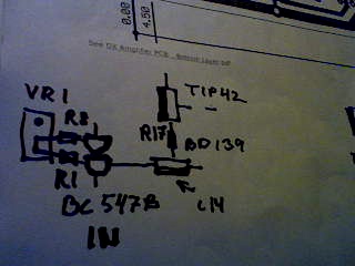

I think fore starters I will make a small board just with these components, input/dc adjust/TIP42
Ehh, and small supply caps etc
Mounted close to 2SA1943
Some resistors and caps hardwired
Groundplane wil be thin copper plate

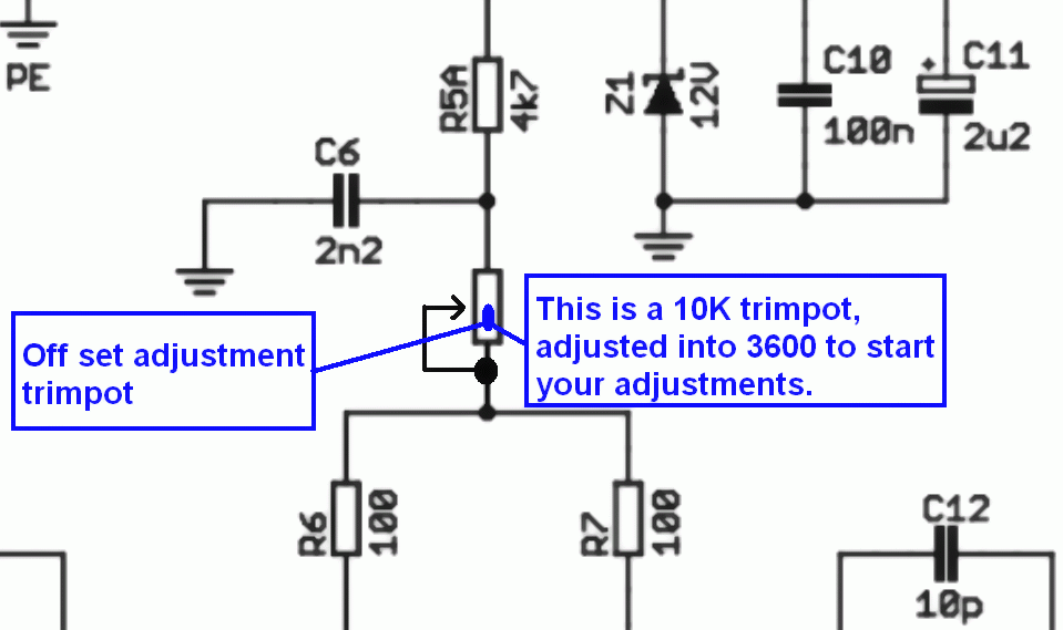

This is the off set adjustment trimpot
in between two resistances, it is a very good idea to have a capacitor to ground to avoid unstabilities...in our case, we need them very small in value, to be charged very fast avoiding the power on thump.

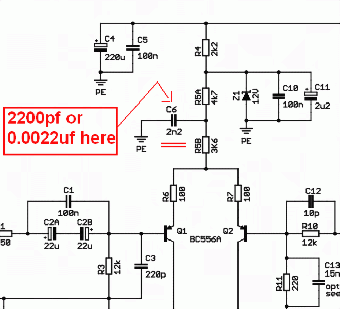

Re: This is the off set adjustment trimpot
Ooo, Okay i`ll put it 2200 pf like your suggestion.
Dx, i`m plan to use +64 0 -64 maybe next week and i`ll produce 2 new Dx Amp Board, i`m prefer to use 3 pair output transistor per channel or maybe 4 pair?, Toshiba 1302 and 3281, what do you think? i`ll change BD139 with MJE13005 and tip41c/42c with mje15032/33 what do you think?
SO what about VR2? its 1k trimpot there, should i change it to 2k? or parallel it with 1k trimpot plus 500 ohm resistor? Previous one will be running at +- 42 vdc and stable so my younger brother ask me he want that amp for home theater system so actually its hard for me to give it to him but he beg me.
SO i need new one, my plan to run it with +- 64 VDC since i`ve that toroid ferrite already running it with offline smps, we can make any ampere we like with that thing so its flexible, depends on trafo and wire coil to carry how many wattage we want. About the component and other thingy to make this, its because i`ve friend who has working as tv&radio repair here and another one is working for motor coils winding etc.... so i can get the stuff very cheap sometimes free FOC 😀 and at the same time they want the DX AMP too LOL 😀

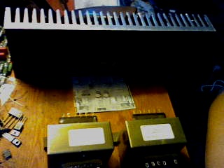

Very strong this one Norazmi.... maybe 440 watts RMS into 4 ohms
More than 220 Watts into 8 ohms.
the output is bigger than 42 volts RMS.... into 8 ohms you gonna need 15000uf each rail....and into 4 ohms you gonna need 25000uf each rail.
Hummmmm...very expensive!
I think three pairs will be good to 8 ohms...but to use 4 ohms will be a good idea to go to 6 pairs.
Heatsink will be enormous...and each amplifier will suck 5.5 amperes each rail... total of 11 amperes to each channel...... huge...very huge transformer....better to use two 700 watts transformers.

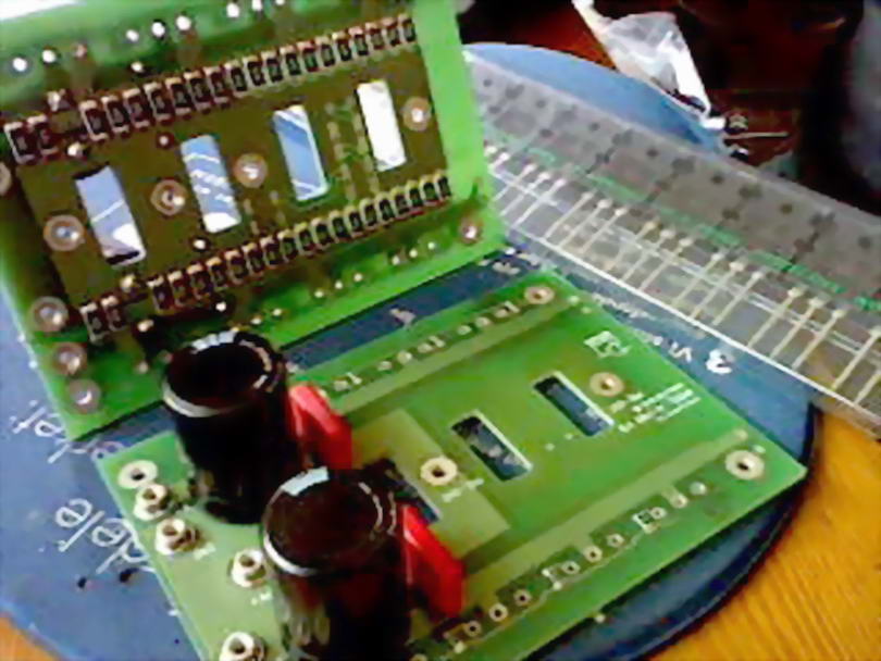

Those output boards
Well, they were made fore the amp modules I am listening to know
But I changed my mind and thought I would try a small amp, fore a change
I have no regrets
But cant get myself to sell those output boards, with matched On-semis
Im not ready fore switchmode and class-D
If I get a change to get it working, it will probably be fore woofer use only
Still working on my own DX board layout
Nearly gave up, but im getting there now
