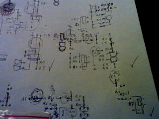

Trying to figure out which parts/components are important
In other words, which components belongs to certain curcuits

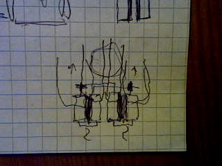

Anyway, been through some variations of layout, and ended with more and more below board mounted components
But it got more and more messy, and difficult to draw
So, I decided to try and do it right
I plan to have onboard supply, if I can do it
You know those drawings where you "just fill in the missing parts to see what it is" 😎
Ehh, as you can see, drivers missing

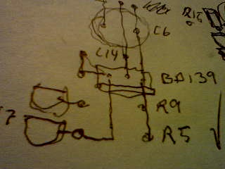

Does the bias adjust transistor matter, or should it best be BD139 too?
Also have doubts about bias points "A" - "B" - "C"
Greg suggest to connect bias board to "A" and "B", but as far as I can see "B" has no connection no more
Maybe it should be "A" and "C"? 🙄

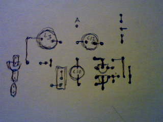

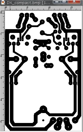

Hi , Carlos. Need a pair of rear channel amps for my "supersym". I have a 26-0-26 trafo , njw0281/0302 (OP) mje15030/31 (drivers).
I have to fit the DX amp , big filter caps (6800uf) , and bridge all on one board (3.5' X 5.5") . I did all the power supply and output section with half the PCB space left. No parts under board and I will include the output coil and isolated ground resistor(10R).
The rest of the amp is all DX 😀 (DX compact)
Here are the little VAS/driver heatsinks I will use..
They solder right on board (Attached) I will have this done in a few days , so ..tinitus hold on...
I chose this amp because it is so simple and can be made very compact , it is derived from the famous aska 55 😎 , and perfect to drive my little rear channel 8" speakers.

Definitely A and C.

Yes Tinitus...of course you can use other ones
those 2SC2922 i have used dear Tinitus ..they are the best possible option... the first Dx used those ones..i still have them..interesting...i do not use afraid to loose them... those ones are the only super strong ones i have...one more pair from Klaas is still with me..but another type number.
to the VBE multiplier you can use any NPN you find...i love to use those plastic ones..as no insulator is needed.
be confortable to try things...if something strange happened i will help you to fix..sometimes we have surprises when we install a very fast transistor... into the VAS, for instance...those MJ10031 or something alike (Motorola) resulted bad...oscilated... i felt myself scared with so many options you had... afraigthned you make the wrong choice.... you know..some bad luck combination.

A and B was used in earlier Dx amplifier schematics...was for a fixed resistance..and from B to C a variable.... those two resistances had made the bias control...there the voltage were developed to put drivers and output transistors into conduction.... the idea was to use enormous heatsink and a fan... not to use VBE multiplier..... this because i had that big heatsink and many guys had too..so.... not really needed the thermal control when we had infinite heatsinks to that power range.
Then i decided to use diodes and them the VBE multiplier.... now a days..only A and C are needed to the VBE multiplier.
Do not worry with that B..it is there only as some historical registration.

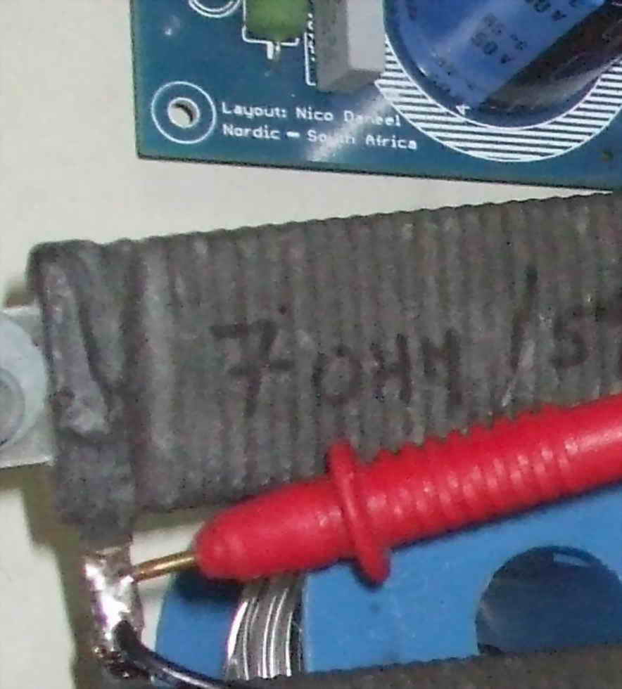

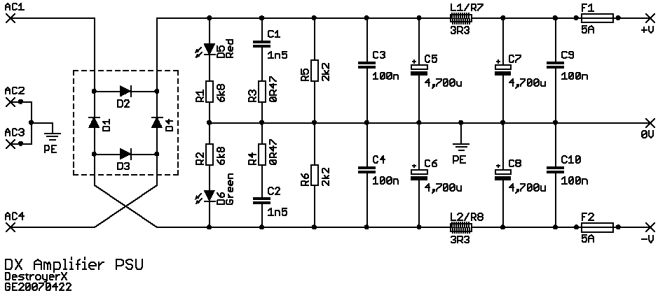

I use to ask folks to measure their supplies under load
Watch this image:
Watch this image:
Here is the text about...sorry, my word needs some adjustment
You see, i am testing this supply.
without load the voltage is 50V x 2,
loaded using 7 ohms x 2 resistances,
voltage dropped to 39.8V x 2
Observe both rails are loaded,
so, we have 5.68 amperes each rail.
This can feed an amplifier that will
pump 156 watts each channel, rms,
sinusoidal, continuous and unclipped.
This continuous power will happens
because the voltage drop under high
consumption.. and this is when the
speaker (or load) is 4 ohms.
But… when supply is not hardly
sucked in energy… say…moments
of low volume..musical silent moments,
the pianissimo moments, the supply
will charge the filter condensers and
you will have 50 volts for a peak of
power…not continuous…the supply
cannot keep this voltage continuously,
but you gonna have 248 watts RMS into
the peaks, undistorted power…and
if you accept some distortion you gonna
have your power doubled into the peaks.
And this is an excelent performance.
This supply is able to hold two channels,
each one of them producing 156 watts
rms, over 4 ohms, continuous, undistorted,
sinusoidal with the sinus frequency of
1 kilohertz….a 545 watts supply!
34000 uf will be needed to each rail to
feed two channels with that power..total
filter capacitance will be 68000uf.
Those 250 watts, each channel, are peak
power, transient power, a burst of power,
this will not be continuous, just for a
small moment…a brief burst of power,
but this is translated in our years as
quality and realism,
Carlos
Carlos

Hi dear,
Strange, tweaking the power supply reverts those aspects that you consider not as good as AKSA...
I refer to -ECdesigns-' charge transfer disconnecting circuit. It was meant to his low power consumption DAC but I adapted it to my amps.
Best regards,
M
I can say my toy is the winner into a bass competition with the Aksa..ahahahahahhaha..but loose in all the rest performance points...lost in sound stage, trebles, presence, clarity and focus.
Best regards,
M
Hello Max, do you have a suggestion..so post it here
Your cooperation is welcome.
Here is the supply i use together one Dx amplifier channel.
Explain your ideas with how and why... please...if cannot put in english, then write to me in spanish.
I hope not an electronic switching power supply... as i do not like that stuff... also, dear Max, Aksa uses a very simple power supply... i really do not think the audio quality difference is because of the supply.... switching power supply is not welcome..you are welcome..not the switching power supply...if that thing was really good, all good brands would use it..and they do not use..they try and fast they give up about those electronic supplies.
I know the reasons makes Aksa better..but i cannot tell folks...i have used the Hugh sub circuits and i could see i have matched his performance..but was not Dx Amplifier anymore..as a sligtly different, no power on thump Aksa...no more a Dx amplifier... and those modifications where not in the supply.
panzertoo@yahoo.com
regards,
Carlos
