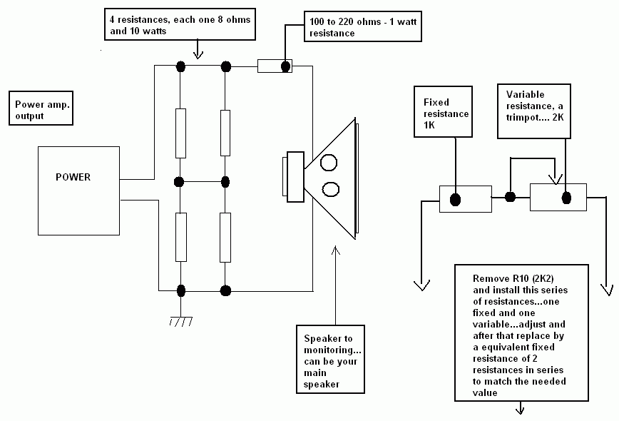

It is better to remove attenuator and do adjust the gain resistance
adjust your source playback level to 75 percent from it's maximum output volume.
Replace the gain resistance by a trimpot.... use 1K in series with 2K or 2K2 trimpot (the one you have available)
Them play music you know as very loud...some musics are not loud, or have "pianissimo" moments where the music is low in volume....so find some music that is loud and play it at 75 percent of the maximum playback volume (I hope you're not using Ipod..as it needs the headphone to filter the output...not good to plug directly into power amplifiers... the headphone coil makes part of the output filter... so it is good with earphone and bad without earphone).
If you have installed input potentiometer into your power amplifier, then turn it full clockwise, or, to increase the volume to the maximum to the power amplifier (if have assembled volume pot wrong way)
Now tweak your gain trimpot till distortion starts... clipping starts... you listen the sound of clipping...but be sure the clipping comes from the amplifier..sometimes the distortion comes from the speaker...this way the solution is to install 8 ohms array of resistances into the output to have good dissipation and to pick signal from another resistance to the speaker to monitoring...i will produce and attach a schematic about that.
Made the adjustment, them remove the trimpot plus the series resistance and measure outside the pcboard..... now install a fixed resistance with this value you found..if needed use two resistances in series to match the value you have measured.
I hope i was clear enougth.

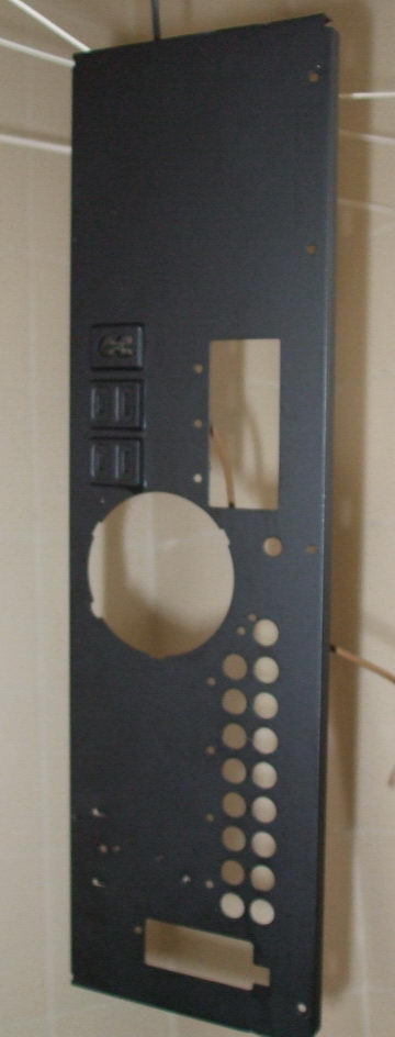

Enclosure just waiting to have something assembled inside
This one will have amplifiers inside, volume control and analogic power metering devices included.
Also will have four supplies inside:
63 plus 63 volts
35 plus 35 volts
20 plus 20 volts
12 plus 12 volts
An auxiliary adjustable power supply..symetrical and voltage adjustable.
A 220 VAC to 110 VAC...a step down transformer used.
Output sockets to 220 and 110 volts.
RCA connections for amplifier audio entering...speaker connector to speaker output and some RCA connectors will be the supply output to external amplifiers.

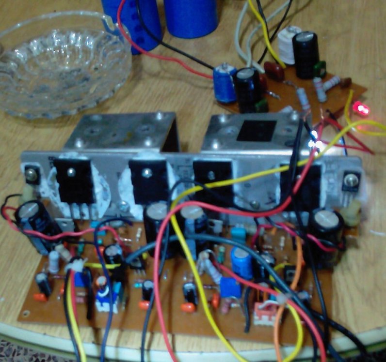

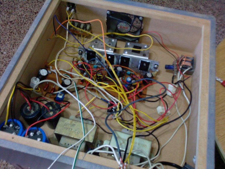

Now am having scratchy / noisy sound at every time turn the volume up or down and funny sound when turn the amp off
something like Zeeeeeeeek , for two seconds .
could be dust or something with the volume knob who causing that noise and about the Zeeeeeek , I think the PSU ...
something .
any help ?
something .
any help ?
Increase C14 value... try a 56 or 68pf capacitor there
If your case is wooden made..then you have a problem man!
Try to ground the potentiometer metalic back case..soldering a wire and run that wire to the transformers center tap..both transformer center tap must be connected one each other..the heatsink must be grounded too.... transistors (both) must be insulated from the heatsink...sometime you need to run a wire from the transformer metalic case too.... having not the metalic chassis you gonna have some problems and some special attention must be applied to grounding points.
Those two small heatsinks you are using are upside down.. also you have undersized heatsinks...you may have burned power transistors because of that.
Good luck.
regards,
Carlos
Good luck.
regards,
Carlos
I understand that grounding is an imporatnt case .
the heastsink , yes it is small to handle the amp but am rnuning fan to keep it cool.
Did play the amp for 2 hours and I got little heat at the sink .
I used canned compressed air and at the volume knob and the scratchy noise gone .
about the Zeeeeek sound , was a bad capacitor . Got it replace .
I will wire from the volume knobe body to the ground and the heatsink to the ground , too .
thank you
