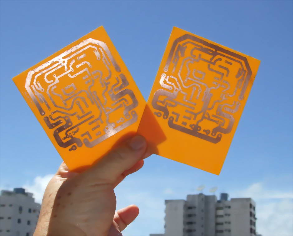

Using a metal rule as rail and scratching using sharpened screw driver
or metal tip...then i will have a mark..... after that you broke the board alike people broke glasses into factories.
The rule enters as a reference..something to avoid to scratch curves..the sharpened point goes scratching following the rule edge...to obtain a straigth line.
We can use saw too...the small one to hobby works.
file and sandpapper are used too..all manual work
regards,
Carlos

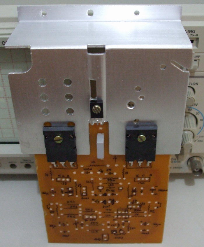

I have made those ones today
I have only to install parts and adjust...it is almost made.
It gonna be used into a tinny aluminium enclosure..so...dissipation will be made using the cabinet.
Also will operate with 27 plus 27 volts...power is smaller.
It is the Dx Amplifier.... unmodified....it will look better after the aluminium be sanded and polished.... and having parts populating those boards.
Showing the scope....because it is pretty..and the boards are not..so...the image beauty will have some "balance"..some "compensation"

This board result very ugly...bad cutted, pieces broken and are not finished..will became better when finished.

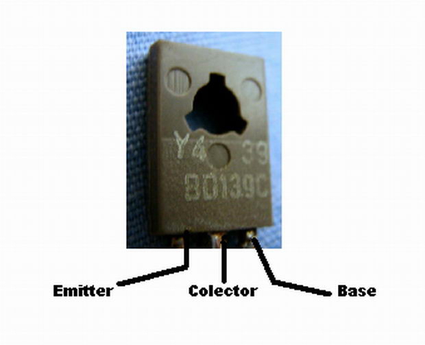

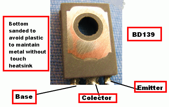

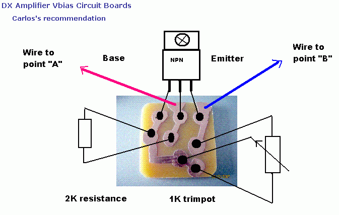

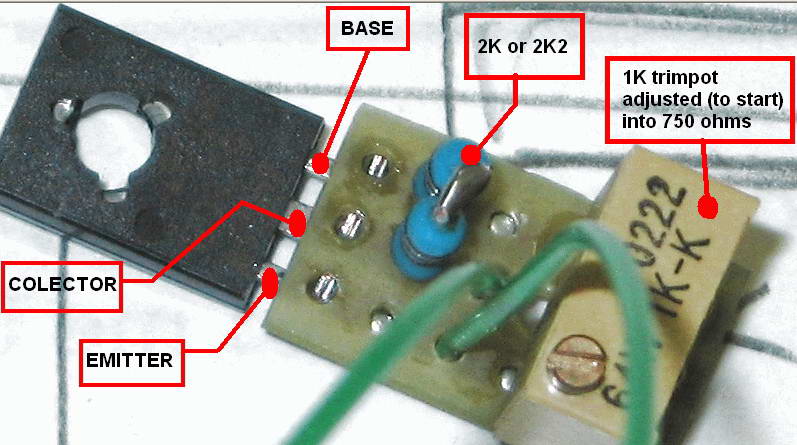

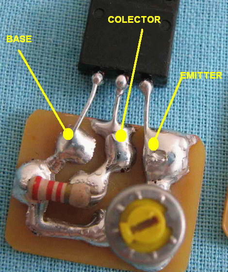

Are greg's bias setting pages right? He shows the bias transistor Q6 NPN BD139 front view left to right is BCE.
Greg's bias page
The data sheets for BD139 show the opposite
ST Datasheet
Fairchild Datasheet
Phillips Datasheet
Greg's bias page
ST Datasheet
Fairchild Datasheet
Phillips Datasheet
Greg's pic shows a To220.
The BD139 is a To126.
The pin order is reversed between these two case styles.

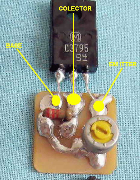

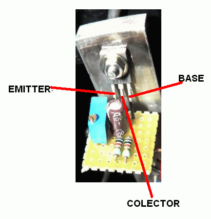

lgreen said:Are greg's bias setting pages right? He shows the bias transistor Q6 NPN BD139 front view left to right is BCE.
<<Edit>> Damn, speedy Carlos replied 5 times while I was typing this!
To elaborate and clarify, the illustrations on
this page are showing different methods of constructing the Vbias PCB. The first shows Carlos' PCB method which uses no holes. He is clearly using a different transistor, not a BD139, as Andrew has mentioned.
The next picture down is Greg's PCB version which matches the DX Amp schematic on Greg's website. That is the one you should be following, I think.
The 3rd picture looks like it would be the top side view of Greg's Vbias PCB. Note that the BD139 is inserted on the underside of the board, so make sure the transistor is facing the correct direction and the pinouts haven't been accidentally reversed if you follow this.
One last thing, you mentioned Q6. That is the designator used in the HRII circuit, the DX Amp uses Q8 for the bias transistor. (Just mentioned in case others are trying to follow along.)
..Todd
