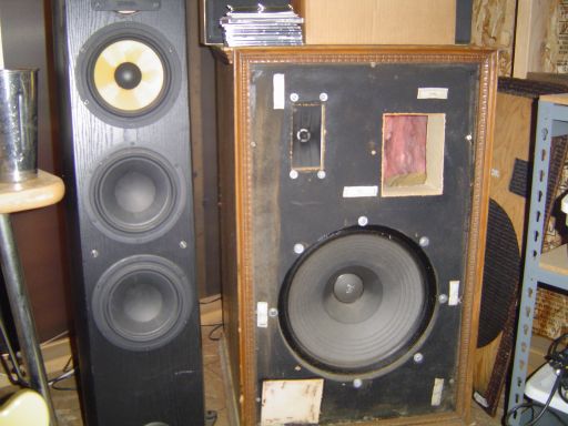

Listening tests--HarmonKardon cd player, dx amp, jbl p40 consumer grade 2 way speakers.
Stravinsky Pulcinella, Naxos 8.553181. Wonderful work. Smaller chamber orchestra with voice. Strings, brass, woodwind. I want to hear what these instruments sound like before I play scratchy records and poor recordings.
Fantastic sound, really remarkable. The bass never sounded so good through the jbl's, which are nothing speciaL You can hear the flute player gulping breath, and the pads articulating the notes hitting the flute. Some of the dynamics, contra-bass, some brass swells made me jump a little bit. I managed to rescue some highly efficient electro-voice speakers I'll test next. Woe betide he who plays 50 watts through those.

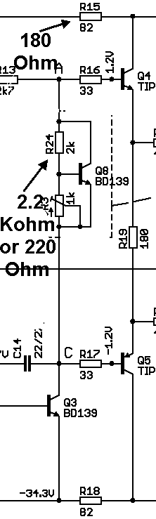

It is obselte , does that mean instead of using R24 as 2.2 kOhm should I use 220 Ohm as you mention cus am using 35x2 volts for power supply which mean 42 plus minus on both rails

what I meant to ask you is that am using 40x2 volts plus minus
instead of 35x2 .
About the Bias circuit , should I use 220 Ohm ( R24 in the schematic ) or keep on using 2.2 Kohm .
and what about the R15 R18 instead of 82 Ohm , using 180 Ohm .
Thank you
Keep 2K2...sorry, but 220 is wrong.
my mistake.
180 ohms turns the amplifier better in quality but looses power.
As you gonna use 40 volts, no problem to use 180 ohms into the positive rail.
This amplifier can operate, without modification, till 42 volts..so...your supply voltage is good and will not ask any kind of modifications.
Just assemble it correctly and it will play immediatelly.
regards,
Carlos

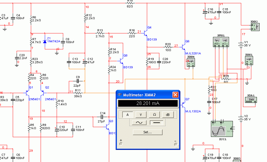

HELP ...... HELP ...... HELP

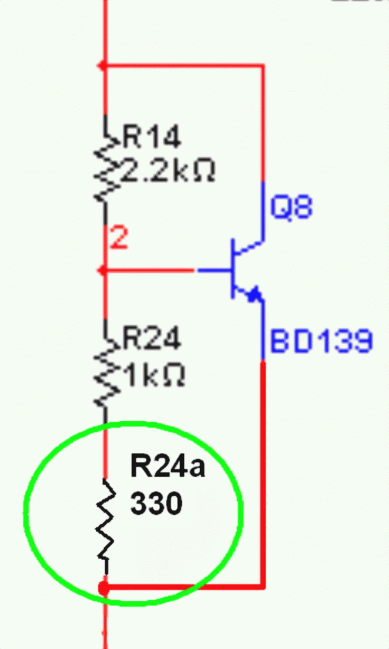

Yes , am following Greg website instructions on adjusting the DX bias, and trimming DC offset
I measured 11.2 volts around the protective resistor on the positive rail with the trim pot on 1 kohm ( turned to the max ) .
and when turning the trim pot lower the voltage go higher
I didnt complete the adjusting cus something wrong .
I will double check the circuit board and soldering joint and the transistors , Anything else ?
:hot:
:bawling:
Take it easy.... relax because things are better than you can imagine
Your bias trimpot is adjusting...this seems the circuit may be fine...some differences in transistors, resistances, some minor errors can cause this.
Try, in advance..as first try, to include a resistance in series with your trimpot.... place a 330 ohms for instance..or 220ohms if you have it...can be even 390 ohms,.
It is normal when you reduce the bias trimpot resistance to obtain increasing in current...so...your bias trimpot is operating...this means bias circuit is fine and bootstrap resistances are too..and also VAS transistor is conducting.
In advance to check the all stuff...try to include and try to adjust once again.
I hope this voltage is over 10 ohms resistance..because if not.... everything will be different...current is the result of the division from the voltage you have measured by the resistance you are using...so.... 1 Volt into 10 ohms means 100 miliamperes (0.1A) and this is acceptable!!!..better if you find 600 milivolts or less, and over 10 ohms resistance.
11 Volts means more than one ampere... this is too much!
Relax man... everything gonna be all rigth..i am here...and never fear when Charlie is here.
regards,
Carlos

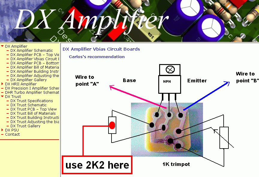

I think you are talking about the Dx Amplifier, the Dx Standard
the one (the main one) we are exploring in this thread.
here you can see a simulation with the trimpot into 1K... you see the current value.... this means some resistance you're using is diferent than the standard value..or some transistor gain.... but relax... soon you will find the guilty.
If the 330 ohms resistance inclusion did not satisfy..them go checking all amplifier... measure all resistances.
regards,
Carlos

When you increase the bias trimpot resistance
You will have more voltage drop over this resistance... this means base to emitter voltage willl increase.... when this voltage increases, the resistance from colector to emitter decreases...decreasing the colector to emitter resistance the voltage drop from colector to emitter also decreases.. this will produce less drive voltage to the output transistors, as a result they will conduct less..current will be reduced.
When you decrease the bias trimpot resistance, you gonna have less voltage drop over this resistance..and this have as result the reduction of base to emitter voltage... reducing the base to emitter voltage you gonna have increasing into the colector to emiter resistance.... this increase in resistance will cause an increase of voltage drop from colector to emitter...this increase in voltage will drive the output transistors more.... and this will cause more current consumption.
So... reducing the bias trimpot resistance, in this circuit, you gonna have more current into the output stage....and increasing the bias trimpot resistance will result in less current into the output stage.
Circuit is the published as standard...a NPN transistor... a 2K2 resistance from colector to base and a 1K variable resistance, a trimpot, from base to emitter..and this one, as standard to start adjustments, must be pre set measuring 750 ohms resistance.
This is good to almost all cases..but depends the bootstrapp current, also how driven is the VAS transistors..the transistors gain and the supply voltage.
regards,
Carlos
Thank you , Thank you , Thank you which isnt enough for being you here to help .
the Guilty was TIP 42 , short transistor and now am playing the DX amp with the volume almost all the way Up high and soon I need to get a new glass for the windows here in my room .
