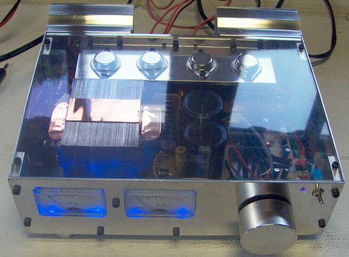

The Dx Corporation is pleased to inform
that we have Mr. Silveira, an advanced audiophile that now is in the Orkut Dx group.
The amplifier i am showing you is a Leach amplifier, and you see the quality of his construction, and, in special the material used.
Near future, Dx Amplifiers will be built by Mr. Silveira.

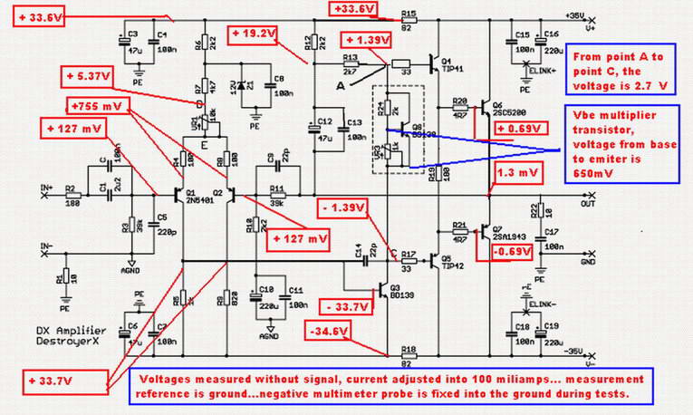

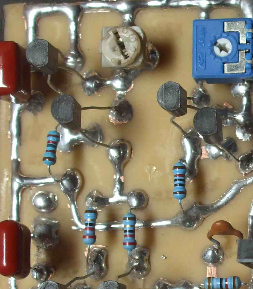

Prototype PCB: The Carlito's Way
It is more than a PCB - it is a (live) soldered schematic!
Please keep going Tio Carlos - we are all cheering for you!
D
destroyer X said:parts are soldered into the copper side...this is the simple way i use to do (since 1969)
destroyer X said:...
It is ugly...but will became better near future...doing... slowly but doing.
D

Re: Evolution prototype picture
I do my circuit boards with through-hole components soldered on top of the traces, too. It's not as durable, but it is easy!
It is a very good idea too my friend.
My board style is nice when you have shorts.... those copper traces, reinforced with melted solder can hold 30 amperes without explode...it is an ethernal board...i have some boards here made 13 years ago...and mounting and dismounting back again and they are fine to be used.
It is not easy to reach over temperatures to the copper rail, as solder will dissipate... we gonna melt the surface and copper lines will be keep cool and glued into its place without complains.
regards,
Carlos
regards,
Carlos
