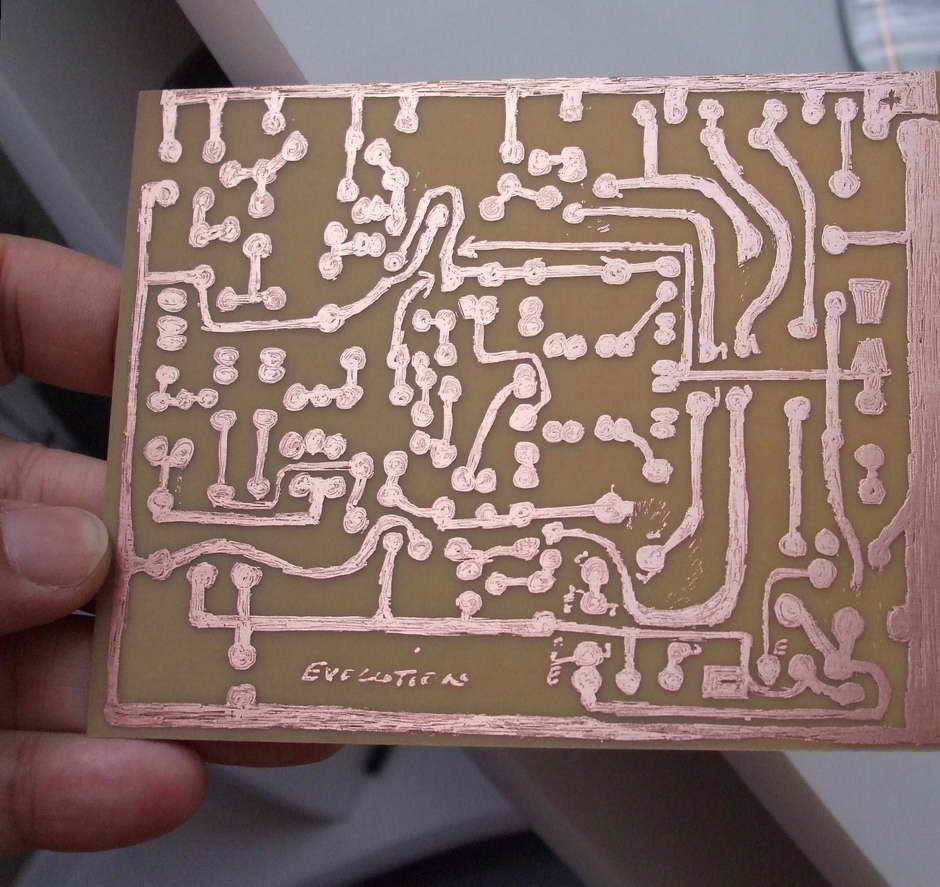

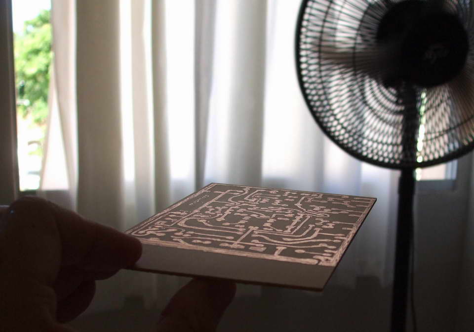

I have to check this board to see if i have shorts or descontinuities into the copper
lines....just a check up and them i will melt solder into the copper lines... final work is to clean with Kerozene (Petrol Solvent... Jet plane fuel)
regards,
Carlos
regards,
Carlos

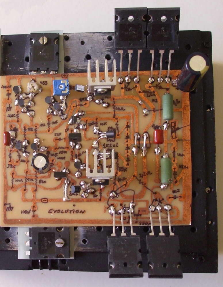

Board measures 12 centimeters by 9.5 centimeters
Driver and power transistors goes out from the board and leads will reach the board.
VBE multiplier transistor goes into the heatsink.
You can see the upper left corner, how the parts will be soldered.
regards,
Carlos
regards,
Carlos

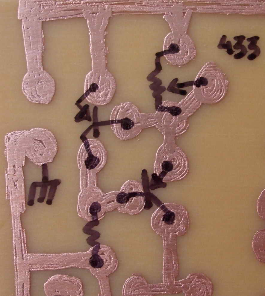

Prototype board with parts painted over.
parts are soldered into the copper side...this is the simple way i use to do (since 1969)

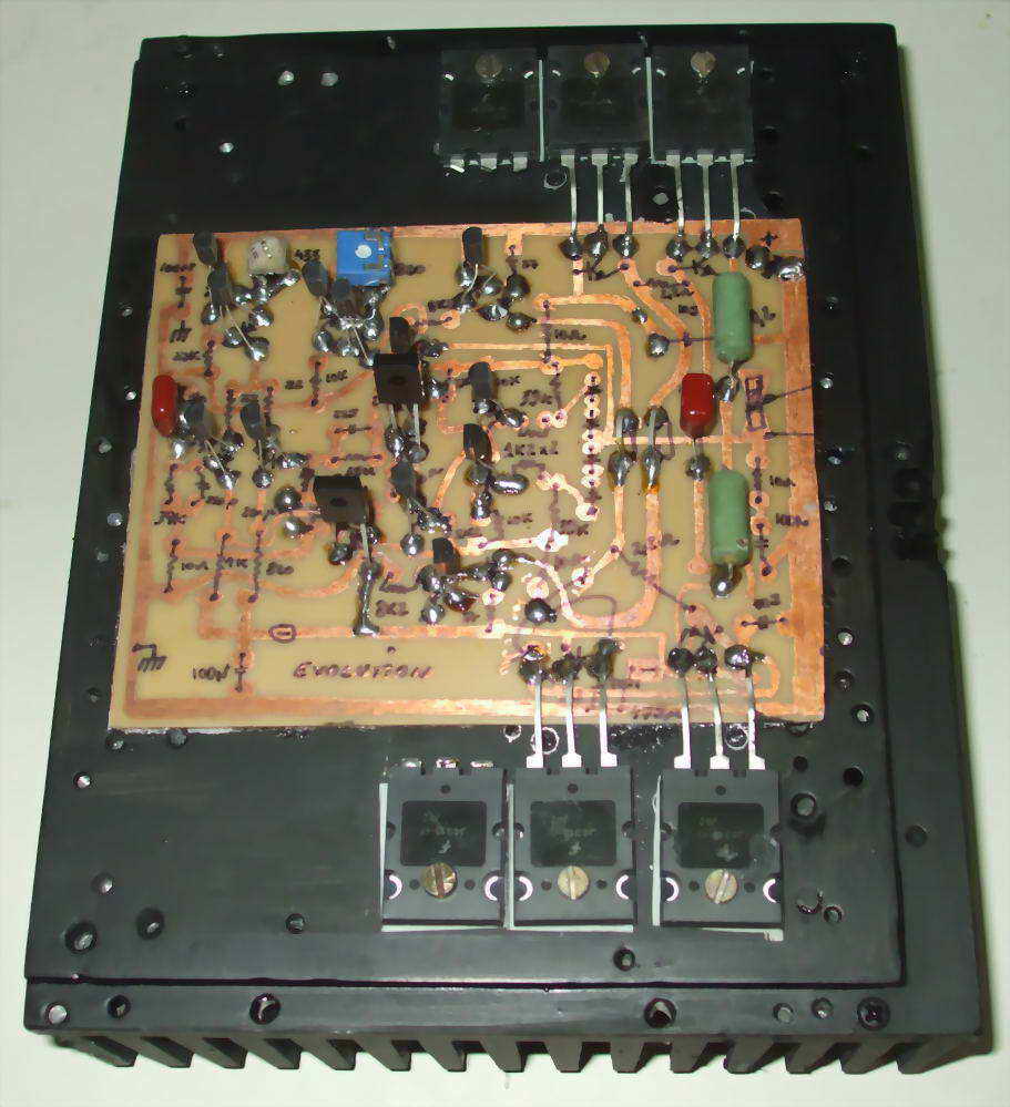

I will turn the board 90 degrées and will produce new screw holes to change power
transistor position.
I will not use 2 pairs into the output..not needed...i will use those power transistors as drivers because they are high gain units (180) and also they are matched.
The heatsink will have only 4 power transistors and a BD139 as thermal sensor...maybe high current CCS (to drivers) will go to the heatsink if needed.
It is ugly...but will became better near future...doing... slowly but doing.
regards,
Carlos

I have worked a little bit more into the amplifier...now looking better... and not finished.... construction is into 30 percent only.

I think i will be adjusting and listening this amplifier today
at least i hope so.
Board will be cleaned after tweaking..also copper lines will be covered with solder..but this is a final makeup
regards,
Carlos
at least i hope so.
regards,
Carlos

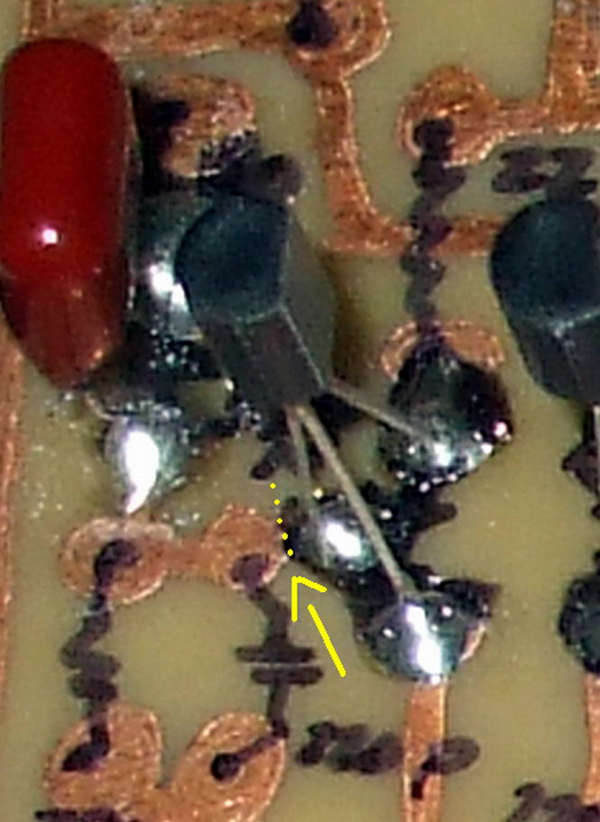

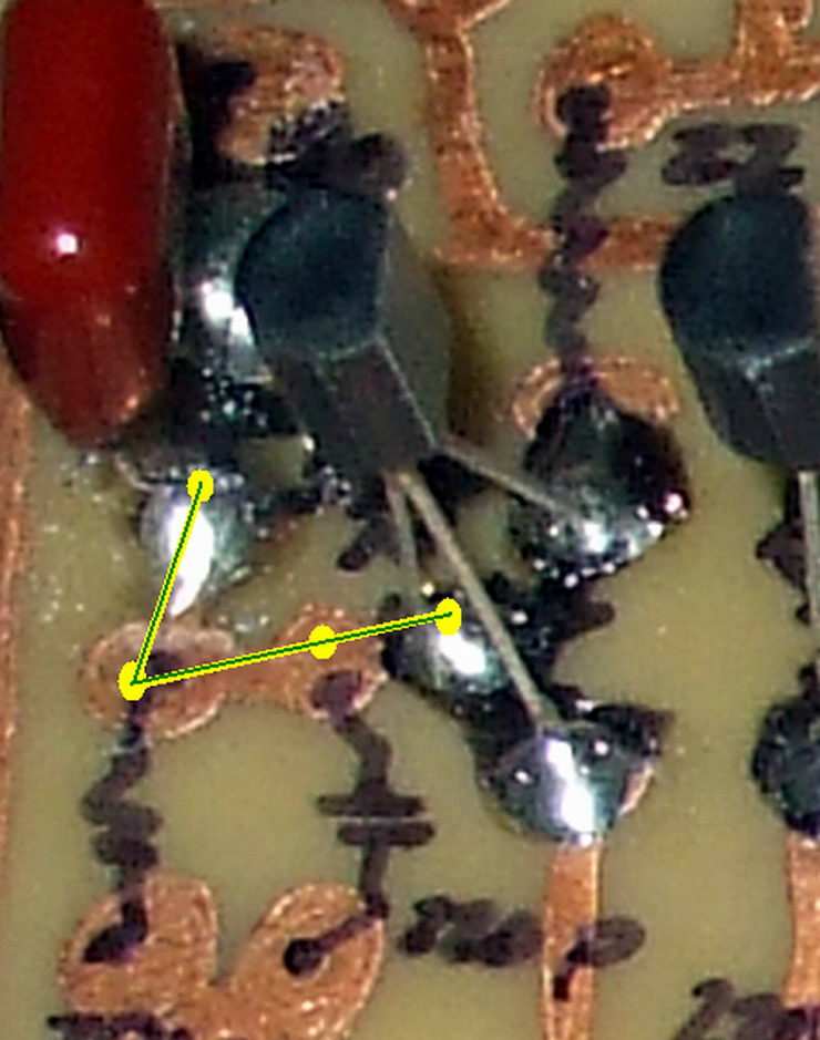

I was observing the board, some places seems that we have a short circuit...in the reality this happens because board is not cleaned and copper lines are not covered with solder.
regards,
Carlos
regards,
Carlos
In the reality, there you have a very normal and standard connection
the same you can see in thousands and thousands of amplifiers...the first transistors base to ground biasing resistance and the Radio Frequency "eater" capacitor to ground.
It is normal there... in the reality there's an electrical continuity there, and this is what we want to join base with base resistance together the base to ground RF filter capacitor.
regards,
Carlos
regards,
Carlos

Hi Carlos, please not too much solder, less is better 😉
Now you know I look at whats going on here
But you may have to realise that members come and go, and some of your friends and supporters may not be here forever
or they may shift interest looking at other things
