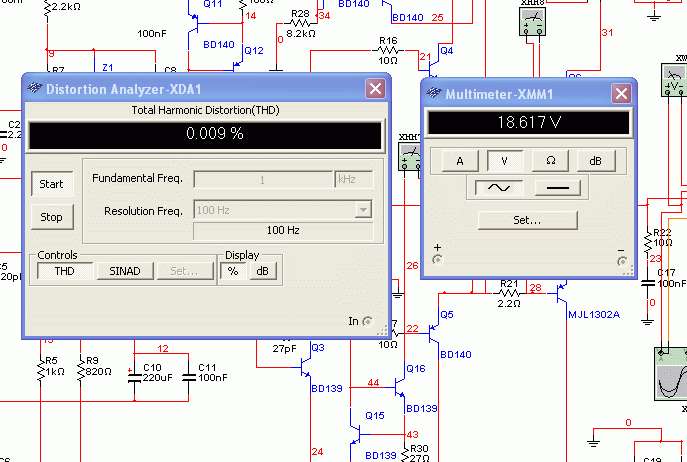

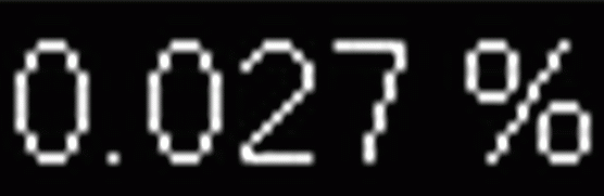

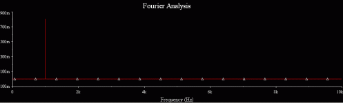

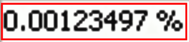

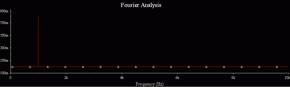

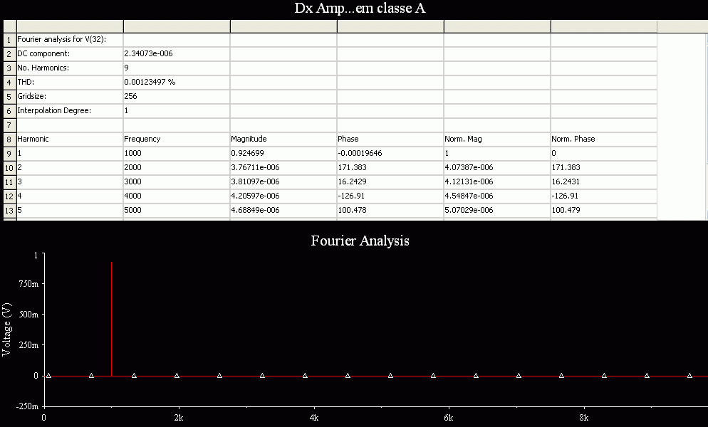

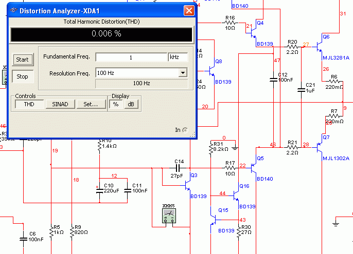

Dx Amplifier using advanced bias point (500ma) is beeing tested
It is not a class A...but has advanced bias point...some AB with more bias than normal.
Distortion, total THD is 0.00123497
But i found other numbers too:
More real i think:
20W...............0.003%
30W...............0.005%
40W...............0.1%
Was not assembled (for a while) but will be tested soon.
Also a class AB with very small distortion....something alike 0.002% at maximum power is under testing.
Sounding fine..but i cannot say nothing as i have not compared those three ones...one of them was not even assembled.
Just playing with simulators..but i really do not think this can result much better...only nice numbers that may produce some passion in some folks.
regards,

Numbers are nice..they can be a very good advertising
I wish it represents good sound into the real world too.
Well... with speaker distorting 100 percent more... i have troubles to believe this means something.
At least will make some folks happy...nice numbers to instruments.
regards,
Carlos

Now i am starting to understand why people loves simulators
It is so easy to arrange the circuit to nice distortion readings that may stimulate...it is nice for sure..but hard is to make those things sound fine.
This measurement (simulator) is full power... THD is the measurement.... under standard simulator analisis arrangement (multisim 10)
This is the main problem....real things.
regards,
Carlos

Now we have automatic bias...from class A to class AB
Input impedance - 39k
THD - 0.0029%
Output power 50 watts RMS into 8 ohms
Sensitivity - full power with 1 volt into the input
audio bandwith - from 20 hertz to 100 kilohertz full power no losses
audio bandwidth - 3db - 5 hertz to 200 kilohertz
full power distortion into 20 Hertz - 0.038%
full power distortion into 20 kilohertz - 0.989%
full power distortion into 1 kilohertz - 0.004%
full power distortion into 5 kilohertz - 0.038%
1 watt into 1 Kilohertz - 0.001%
1 watt into 10 kilohertz - 0.004%
10 watts into 1 kilohertz - 0.01%
10 watts into 10 kilohertz - 0.013%
Stand by bias is 757 miliamperes each rail... this goes reducing depending to the audio level going to the drivers... it is sensed and changes the bias circuit internal resistance...sensors are actuacting both rails audio polarities simultaneously.
This amplifier was not assembled and tested..some transistors may change and some options may be included as current sinks and current mirrors as optional to comparison.
If results fine listening them a thread will be opened with Dx Evolution name...based into the Dx Standard having some features from the Precision and from the HRII.
Bias control was inspired, copied, adjusted and tweaked from a Brazilian Gradiente amplifier from the eigthies..considered the best amplifier made in Brazil.
Intentions are..beat forum amplifiers (some of them).... produce something that may sound good and also measure reasonably good... one idea is to create an amplifier than can be a Dx Corporation legacy, because my health is turning complicated and beeing an impeachment to do those things... my last try i think.

How this auto bias works?
It is not complicated.
Watch the diagram attached.
You see that current comes from a CCS and will develop voltage over the series of resistances represented by the upper NPN transistor (left), the fixed resistance (that is the VBE multiplier) and the lower (PNP) transistor.....
This series of resistances is have a resultant that is three resistances added one each other in series..first i the resistance from the NPN upper left transistor, it is not saturated.... second is the fixed resistance from the VBE multiplier circuit pré adjusted into stand by mode...third is the PNP transistor that is not saturated.
Those resistances will develop the voltage needed to bias the output darlington transistors (alike darlington, those two emitter followers)... and into stand by mode the bias will be big..around 780 miliamperes each rail.
Observe that audio enters the drivers...also observe that we have diodes to the output line that is zero volts...so... you have a zener regulation effect into those diodes that will try to keep 1.2 to 1.8 volts measured from drivers base to ground.
Audio entering, if large enougth, will develop more than 1.2 volts into the diodes and this will trigger the red circuit (-1.2 volts will trigger the green circuit) that will drive the left transistor (in series with the bias current..the ones have a fixed resistance into the middle that represents a pre adjusted VBE multiplier resistance) into saturation...when those transistors, not only the NPN but also the PNP are driven into saturation, the colector to emitter resistance is reduced..so, the series resistance will also reduces as an effect..and this will reduce bias...this way, having high power, the amplifier will work into AB.... having small audio, or no audio level it will work into class A.
I hope this is clear enougth... i tried to make is simple to be easy understandable.
regards,
Carlos
The circuit is not complicated... hard is to tune all those things
to avoid distortions (numbers) and to sound fine...this is the real hard work.
Circuit was published by JVC in 1979.... Brazilian Gradiente used into 1981 (licensed)...and i have tweaked down 2005.
Now i will build and adjust the whole thing.
give me some time.
will keep Dx crew informed about what is going on.
regards,
Carlos
