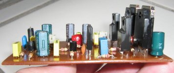

Related the bias diodes.... alike Doctor Leach...i prefer diodes...and using 4 units things turns even better...having one with a small trimpot in parallel to adjust.....some amplifiier can hold 4 diodes and a series resistance....and those multiple junctions work better than a transistor i think...well..this is a result of experience and practice.... maybe theory can be different.
Triple darlington used in output will hold six diodes...to "create" enougth bias to 6 transistors...each one hungry to "eat" more than 500 milivolts each one.... yes...i have tested triple darlington...problem is that they are easy to oscilate....and i am hardly afraid of that...in special is a hard problem related our responsabilities if we publish things that may oscilate easy....errors made by constructor, misadjustments, board capacitances and inductances can create enormous mess...reason why i use to run from triple darlington as fast as devil may run out from the cross sign

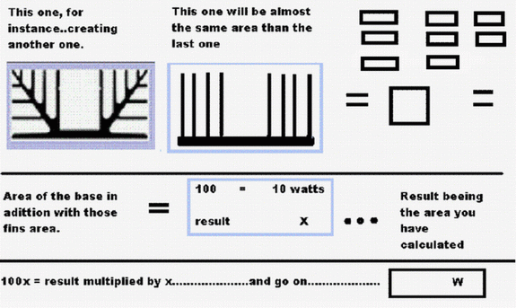

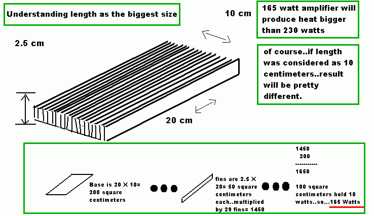

Dear nephew Nordic
I do not know how to make those calculations as i use my own style of analogies to deduce those things....i use to evaluate using vision and sometimes i use a rule to measure... normally i can do it faster than someone that make it using some calculations or after the guy finish to type numbers into those handy calculators..and this is not mine monopoly of knowledge...many old folks can do that, not because we are special...but because we have made it thousands of times.
But this amplifier power is not too much different from Symassym...try to obtain the value used in those C/W there.
Observe Nordic heatsink...that one is small to our environment...able only to transfer heat for DX amplifier working with 8 ohms speakers....and that image Klaas has published show the heatsink for one channel only...this may be a good visual reference for you.
I think i had published in this forum my tricks and references to fast calculate heatsink dimensions....not precise of course...but errors are not too big as i have tested those things thousands of times.

Nordic, 1 c/w is similar to what i'm using.
I'm like Carlos, i don't calculate heatsinks to death, i try to use common sense (experience).
At 1 c/w i would strongly recommend using the thermal compensation (3 diodes) to avoid thermal runaway.
Looking at the pictures my guess is Carlos' heatsink used without thermal compensation is ~3 times bigger, maybe more.
Without thermal compensation higher temp=more bias=higher temp etc...
Your heatsink should be able to dissipate this without running hot.

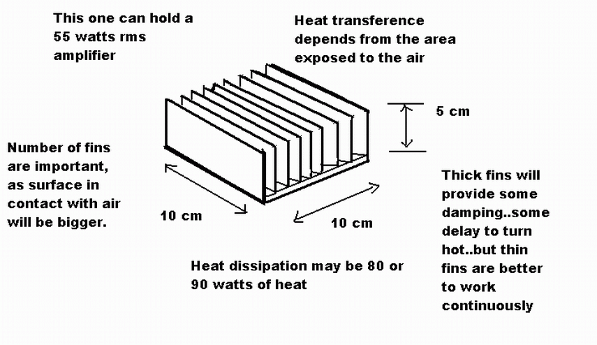

How many fins do you have Nordic?
You told us that heatsink dimensions are 10 X 10 X 5 cm... This remembers me the standard 2N3055 heatsink... was very standard here for a single transistor or for double transistors during the sixties and seventies.
Fins were very thin, and i do not remember if 8 fins or 6 fins.
Now a days i cannot find them anymore.

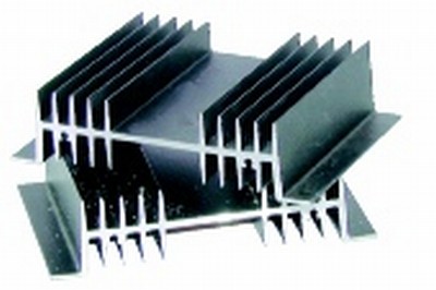

Let me know if your is this one, with more fins, and without that space over...needed for the transistor instalation.
Inform how many fins and i will be able to tell you something about.

Re: How many fins do you have Nordic?
Hi Carlos,
Is this it? They used to be pre-drilled for TO3s in the good ol' days.
Search for HH-8560
http://www1.jaycar.com.au/index.asp
Some heatsink technical information here:
http://www.conradheatsinks.com/technical-details.html

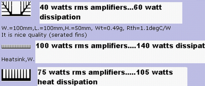

destroyer X said:Fins were very thin, and i do not remember if 8 fins or 6 fins.
Hi Carlos,
Search for HH-8560
regards
W.=100mm,L.=100mm,H.=50mm, Wt=0.49g, Rth=1.1degC/W
It is nice quality (serated fins)
Heatsink,W.=200mm,L.=100mm,H.=25mm,Wt=0.55g,Rth=0.9degC/W
L507511-01.gif,PI,1654,671, Heatsink,W.=100mm,L.=150mm,H.=40mm,Wt=0.746g,Rth=0.86degC/W
Greg, I have a sink like that I plan to use on a low power chip sub...
Yes Greg..those ones...watt values will depend the dimensions and fins numbers
Nordic.
The second one had length strange to me...as length normally is the bigger dimension...well...i have evaluated using the length you informed.
Of course things turns very different with other dimensions.
The idea is to dismount the heatsink...having in that second sittuation, 29 plates of aluminium (fins) and the base.....calculating base area, it will be added to the 29 plates area....result will enter calculation of a proportion...a ratio...using 100 square centimeters beeing 10 watts rms amplifier (140 heat transfer)
This is not precise...eye evaluation...fast and simple calculations..dismounting and evaluating...having a reference.

All those heatsinks look like Fischer heatsinks.
Edit: could be aavid thermalloy too.
1st sk88, 2nd sk42, 3rd sk120.
Thermal resistance is similar for all three, so i'd choose the one which is most convenient.
The one i use is sk85, has a thicker base (better for spreading heat) , base = 10mm.
I'd use one per channel, i think Carlos' calculations are too optimistic. Even with one per channel, i'd use the thermal compensation.
Example: if you are aiming for a maximum heatsink-temp 20 degrees bove ambient, a 1degree/watt heatsink can only dissipate 20 watts.
In reality it's even worse, because most manufacturers state their figures at a heatsink-temp of 80 degrees celcius.
Hope this helps,
Klaas

Yep Aavid !!!!!!! expensive, but I compared a cheap sink to one of same dimentions from them... big diffirence in wheight, finish and surface area due to serration...
Well...optimistic or not, they are working fine those last 35 years
And practical world thing is what interests me.... if working, correctly rated or underrated do not bother me...if C/W is rigth, if is above 10 degrêes of environment or 20 degrees...not burning my transistors i feel good with them.
I started to do tests about 1971... since them i am using those strange numbers as reference to me.
Those early days we had not all informs needed...so..we had to discover the adequated size to the power you will have in your amplifier.... informations were obtained just observing what factories were doing about...and tests could confirm some reference numbers you could create, or discover, to reference your work.
Of course not precise...i do not want to compete with those calculations made to modern heatsinks... just i prefer my old and easy way.... and it is prefered because easy, i know how to make it...and the other complicated calculations i do not know... also, i am living those years without the need of this knowledge.
Also...my finger sensors understand, and my brain ligth the red emergency ligth related "Heat!" when heatsink temperature rises above 50 degrées celsius.... interesting that computer chips also are keept under that temperature too.
Nordic
All your heatsinks will work fine with a single channel...i think you have one that is able to hold 100 watts...this one may hold two channels at normal listening levels...of course..continuous tone is another sittuation....not music... steady tones are used for test signal purposes normally.
Those sizes, obtained during practical work, were checked with amplifiers constructed...many heatsinks were tested....and since they were not burning transistors...reaching some stable temperature that will not raise more than that one.... good!...I think.
To my place... 29 degrees average... they work fine...but of course, receiving heat, they turn hot.....not infinite heatsinks they are...just heatsinks.
Here is another sketch...showing the tricks i use.... area exposed to air is only one side... 10 centimeters side aluminium...square aluminium, will hold amplifiers working without steady tones...playing musical signals....non heavily distorted, 10 watts will be happy with that aluminium...of course, it needs the adequated convection position to cooling.
Please, do not add both side areas during calculations....of course both sides will work...but for calculation purposes, each fin need to have its length multiplied by its width... acumulate all fins together and add with base area...them... each 100 squared centimeters obtained will be enougth to a 10 watts non distorting audio amplifier.... and so on... 2 aluminum plates with that dimension will be enougth to a 20 watts amplifiers..easy calculations i am trying to provide... as worked for me those years.
