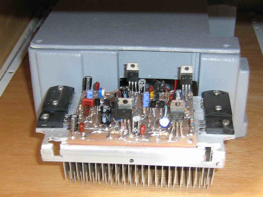

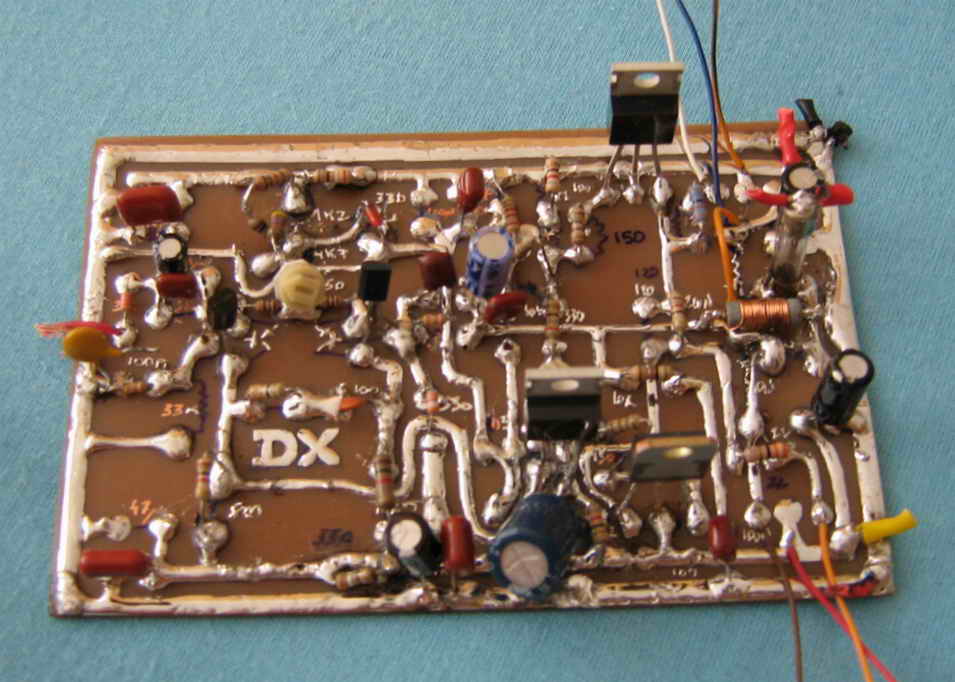

Destroyer x Amplifier...Dx amp...my amplifier
Dx amplifier did not landed in my place in a parachute
Was a result of experiments and hard work.

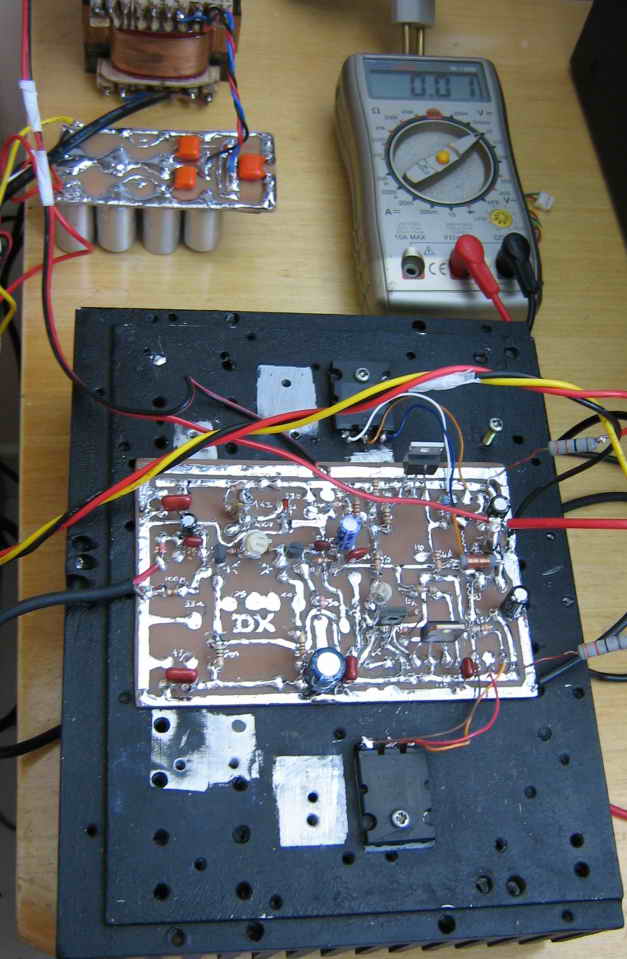

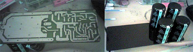

Here is progress on the etched board....
Appart from the PSU caps I guess you only need the rectifiers to go before this... I have big 25A case mount rectifiers I could use....
Its clear I got too used to regulated supplies... I feel totaly nekid looking at the bare supply arrangemebt for this amp...
What would you suggest, or is there some parts I missed?

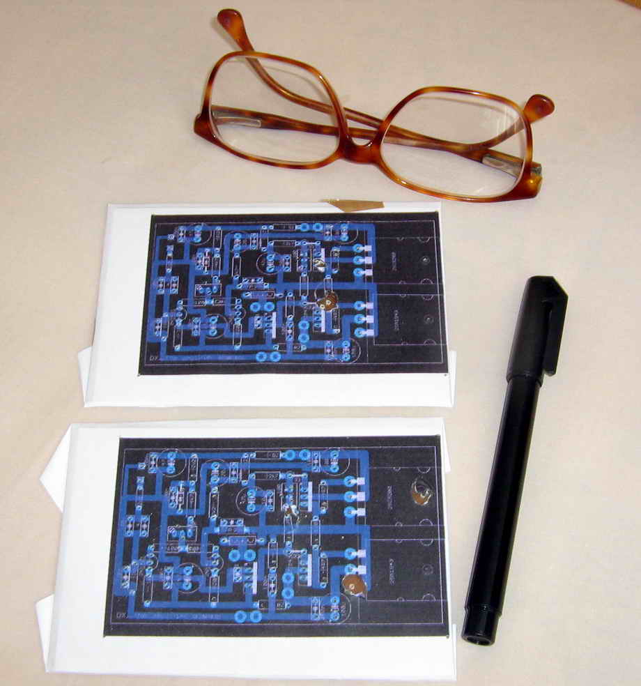

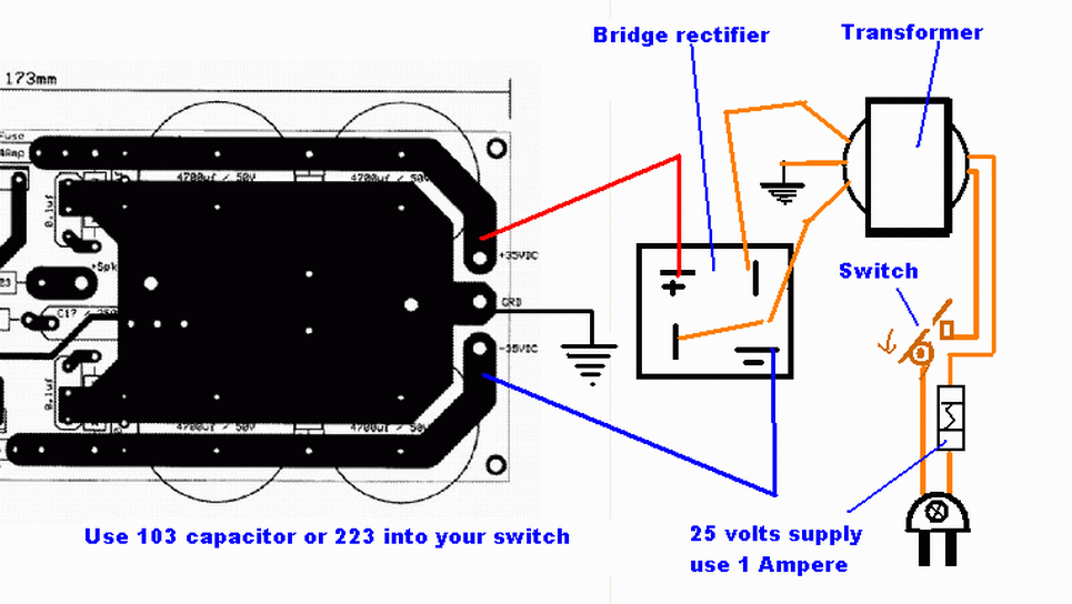

This board, produced by RAJ, was not tested...at least Raj did not came to me to tell me nothing about his construction.
This makes this board untested.... it is possible that you may face some error......maybe not.
The supply schematic is beeing provided because i did not understood your needs related that stuff.
regards,
Carlos
I hope i could face your needs

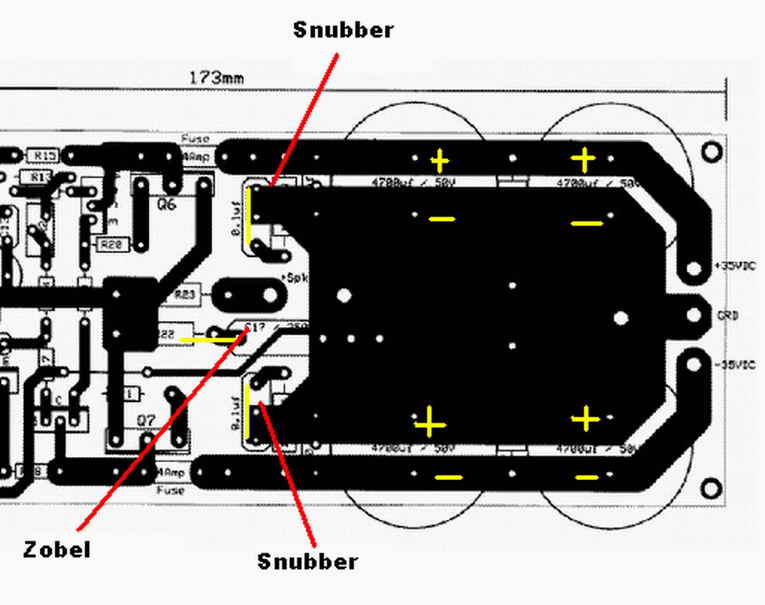

Snubbers are connected from positive line voltage to ground...also from negative line to ground.
It is made with a small ohms resistance in series with a capacitor...normally high voltage capacitor and this needs some calculation.
Well...i have not perceive sonics on this...but....not disturbing...may be good.
In the center you have the Zobel filter.... very alike the snubbers.
I hope i am helping you someway.
Fuse is small as you will have smaller power... you will use 25 volts DC symetrical.

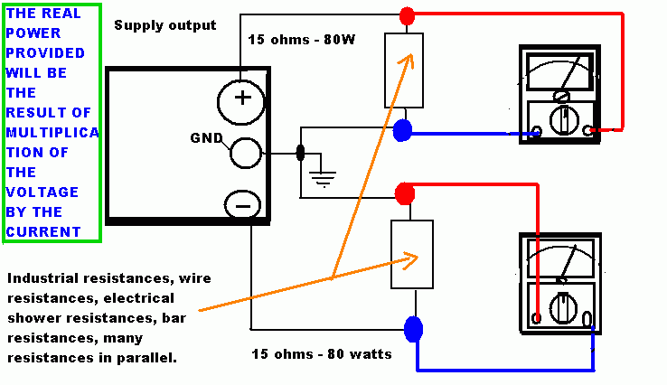

A 320 watts transformer...or a little bit bigger will be enougth.
This means that you will have to install 15 ohms - 30 watts resistance into each rail and measure more than 32 volts under this condition.
Under loaded conditions, not to have more than 10 percent of DC voltage will be the best sittuation...but....many times, those losses goes around 30 percent...this means voltage will go to 29 Volts under load.... those numbers are not precise...around those numbers.
Not the best sittuation...but acceptable...power will reduce a little because of that, of course.
100 watts power over 4 ohms and 50 watts power over 8 ohms depends that your supply keep those 36 volts stable...real world is not that way....voltage losses happens...reason why people prefer to use a little bigger transformers...bigger voltage without load, as losses will happens...so...42 volts DC supplies may work better to provide 36 or 37 under hard driven conditions...or..stabilized supplies.
Loading your supply with resistances..you will measure what is really happening with them, and you will be 100 percent sure what is the power it will provide you....if enougth or not.
Of course you can do it with your amplifier...inserting music sources and working it till distortion starts...them measure this current...if hard, install sinusoidal generator into the input.... when the clipping starts, sonics of the signal will change enormously and you will perceive when clipping...even without scope this is easy to perceive..sounds turns strange immediatelly.
This is what you can do to discover your DC supply power...if enougth or not..... factory informations of course will be interesting (they lye!).... and "eye calculations" may help too.

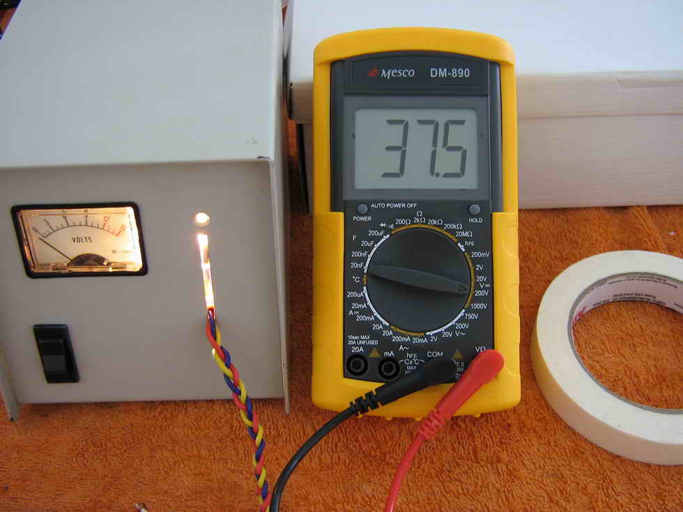

Using 35 volts supplies... stable voltage...virtual supply
2,3 plus 2,3 amperes will be drained from the supply during audition into clipping....with steady tone the measurement turns easier...and over 4 ohms loads
The consumption will be around 150 watts each channel and output power will be 100 watts each channel...needing a 320 watts supply.

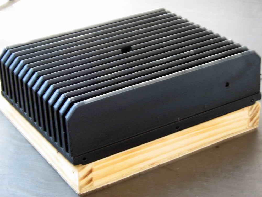

Two output heatsinks...insulated if installed into metal chassis will be a better choice...as thermal transference will be better without insulators....mounting transistors directly over heatsink will be excelent!....
Also sand your transistor back side...that pretty chromium may disappear...transistor are not flat...use sandpapper, waterproof, number 500...grain 500....over a glass (flat surface) sand it till you observe that the surface turns flat (watching is very easy to understand that)

Yep I do the sanding thing.. the process is called lapping, like lapping soup up with your tongue... use water paper glued to a mirror... old trick I learned with overclocking computers... and dealing with general PC heat on hot summer days... 40C.
And use arctic silver no5 as thermal compound in stead of pads..

I was talking about DC..... good condensers, or bad condensers... expensive condensers or junk condensers...all them will sound nice with this amplifier.
A very good will amplifier.....will not create you problems.... the only need is to avoid shorts, connection errors...inverted leads transistors (those BC639 are easy to make mistakes)...inverted power leads may destroy everything...well.... having care with it...using protective rail resistors...i can give you million percent guarantee that will work fine.
Of course, i cannot guarantee under hard errors..so... check it twice or three times...measure resistances from positive to ground and negative to ground...check all condenser polarities, as those standard boards, shown as transparences may create problems of invertion with misunderstanding it when observing the polarity....when watching over the board...watching the parts side....up will be positive...and down will be negative.
Resistance may be big...more than 30K....and invert your measurements probes.... logical results will appear from positive to ground compared to negative to ground.... remove rail condensers during measurement...and carefull not to do as i use to do...when re-installing condensers (board rail condensers) do not install them inverted as i use to make....hehe...they will explode with the gauge .22 long rifle sonics.
Always use protective glasses when first power on if you use to make mistakes (as i use to make)

Will be enougth for 8 ohms purposes...in the 4 ohms sittuation
normally the comercial transformers do the same....they loose enormous voltage when you drive the unit into 4 ohms.
You can compensate using good sized electrolitic condensers in the supply... 20 thousand each rail will maintain enougth voltage to face some interesting 100 watts peaks of power over 4 ohms....will not hold continuous power...with steady signal generator into it's input..but will hold nice peaks of power..more than 100W of peak power for sure.... each channel...over 4 ohms
This may let those 2SC5200 happy...as it will work in the limit using 4 ohms...so....having losses of voltage....parfait!
Those testing resistances will be used for a second only....just to check voltage readings....so....even hardly under powered to continuous use....for instantaneous use they may survive.
